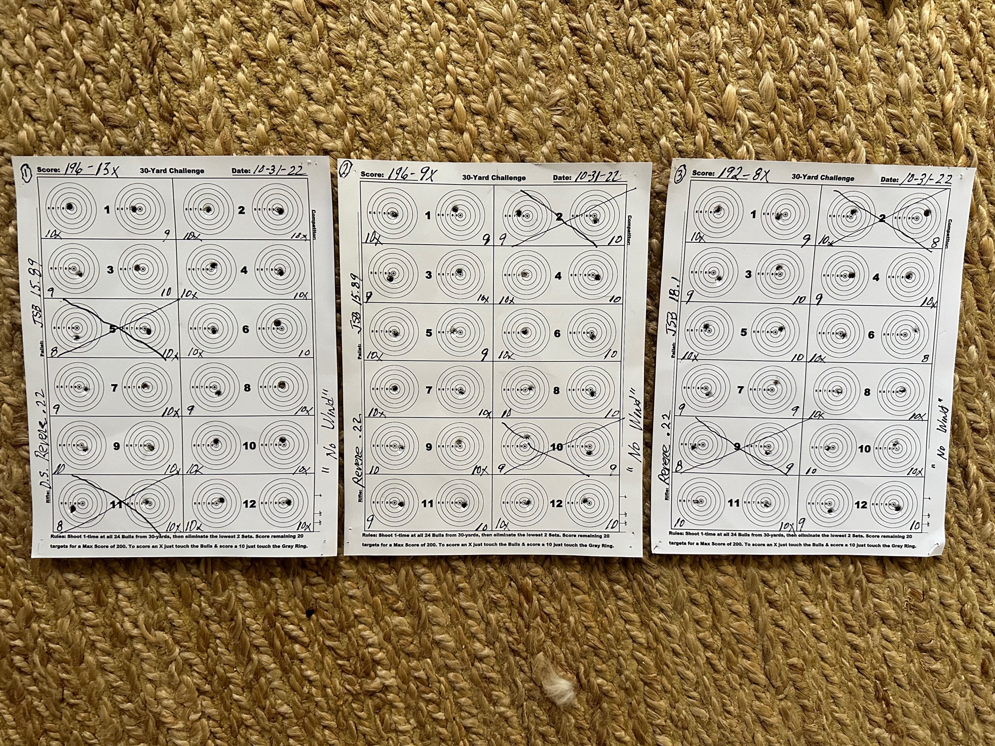

Went out to the local outdoor range today, perfect weather. 70 degrees and absolutely no wind. Got there at 8:30am
I brought the new "we the Plinkers" Revere .22 with Athlon 4-14-40MM FFP scope. Shot three 30 yard challenge cards and one N50 card at 50 yards. Very pleased with both the JSB 15.89 and 18.1 pellets. Both pellet weights are very accurate, but I have to give a slight edge to the 15.89 which is flying at 880 FPS on the FX Radar chrono.
Athlon Scope - very good, considering it is included in the package, but I need a bit more magnification at 30 yards for the challenge. The FFP MOA reticle covers up the 10 ring at 30 yards, on 14X magnification. So, my holds are a bit tricky for me because I was aiming constantly at the 10 ring, with various holds on the ring line ( i.e.,12'clock, 9, 7, 4, etc ) adjusting for the slightest of winds. Maybe 1/2 MPH or less. The scope is great for backyard squirrels, but for target shooting the FFP reticle is larger than I want/need.
Shot a 192-8X, 196-9X and 196-13X for the Senior's class nomination. Also shot an N50 card at 50 yards with the 15.89's and I was really pleased with the accuracy and scoring. I was zipping through the N50 card at a very fast pace as I was in a hurry and a bit late for doing some other errands. If I slowed down, I really think I could have shot a 240 card. Today was the day to try because of no wind.
Here are the cards:
I need to add that the N50 cards are scored with a .035" scoring plug, but the 30 yard challenge cards are scored with the .224" scoring plug.

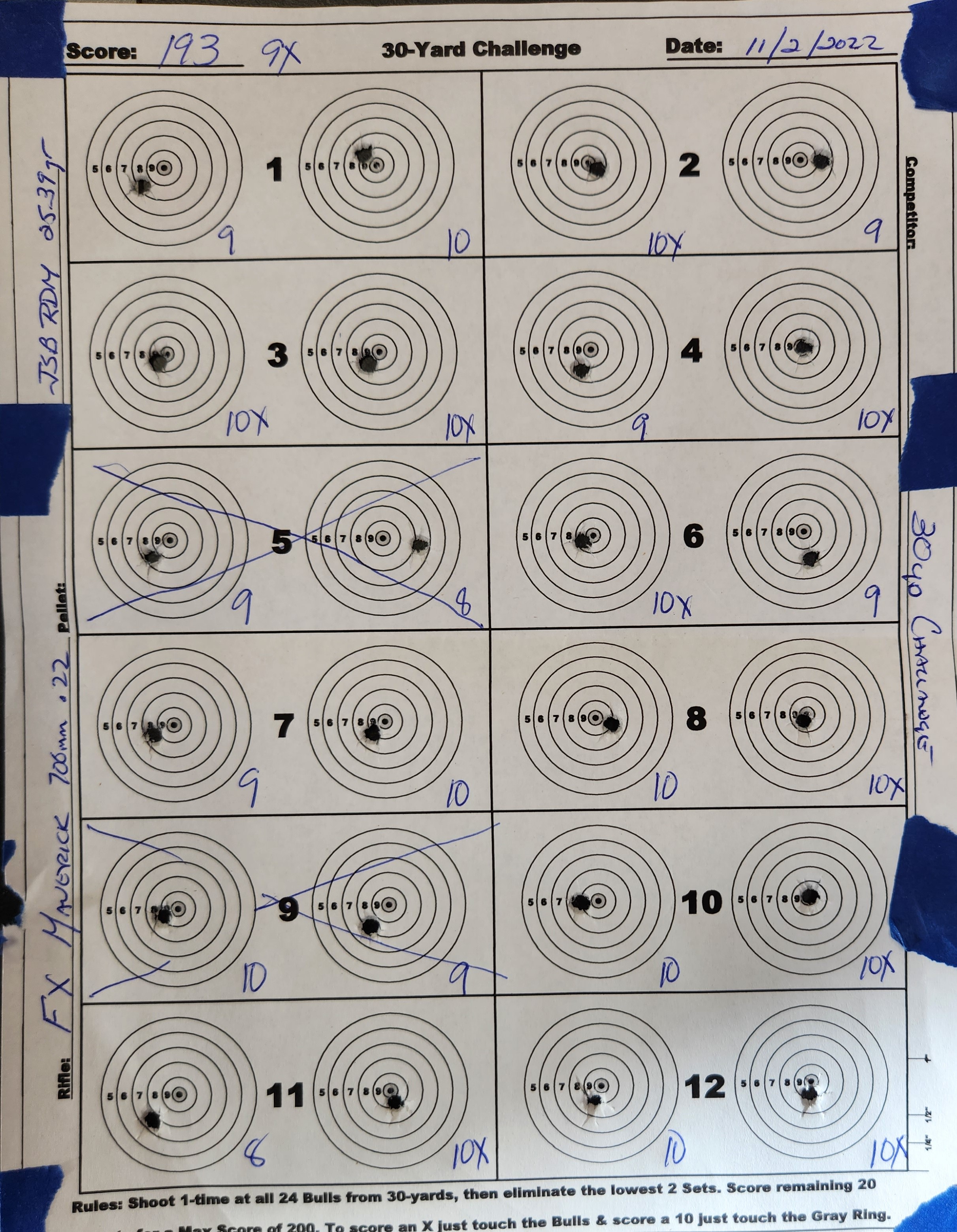

My best card yet! Even though today was cloudy and windy (6 mph with gust to 15mph) things worked. Maybe it was because the wind was at 350 relative so shooting into it. This was the Maverick shooting the 25 grain JSB RDM's at 910 fps. That is the sweet spot
with this rifle as the SD is1.5 and ES 7. Scored with a .22 aluminum scoring pin - which seems to be generous. But I will take it.

Greg,
193 is a good, solid card. Candidly, as I reflect back since shooting these 30 yard challenge cards since March 2022, I have difficulty scoring anything higher than low to mid 190’s in any wind greater than 3 mph. I use flags and shoot with clean barrels, but the wind gets me on a few shots every time. It is so easy ( for me anyway) to get three or four 9’s and an one or two 8’s with wind.
So, if you shot this in 6 mph wind, that is really blowing hard in my mind. Gusting to 15 mph, I would be going home.
You are definitely doing well with that 193 and reading the wind. Keep at it!
