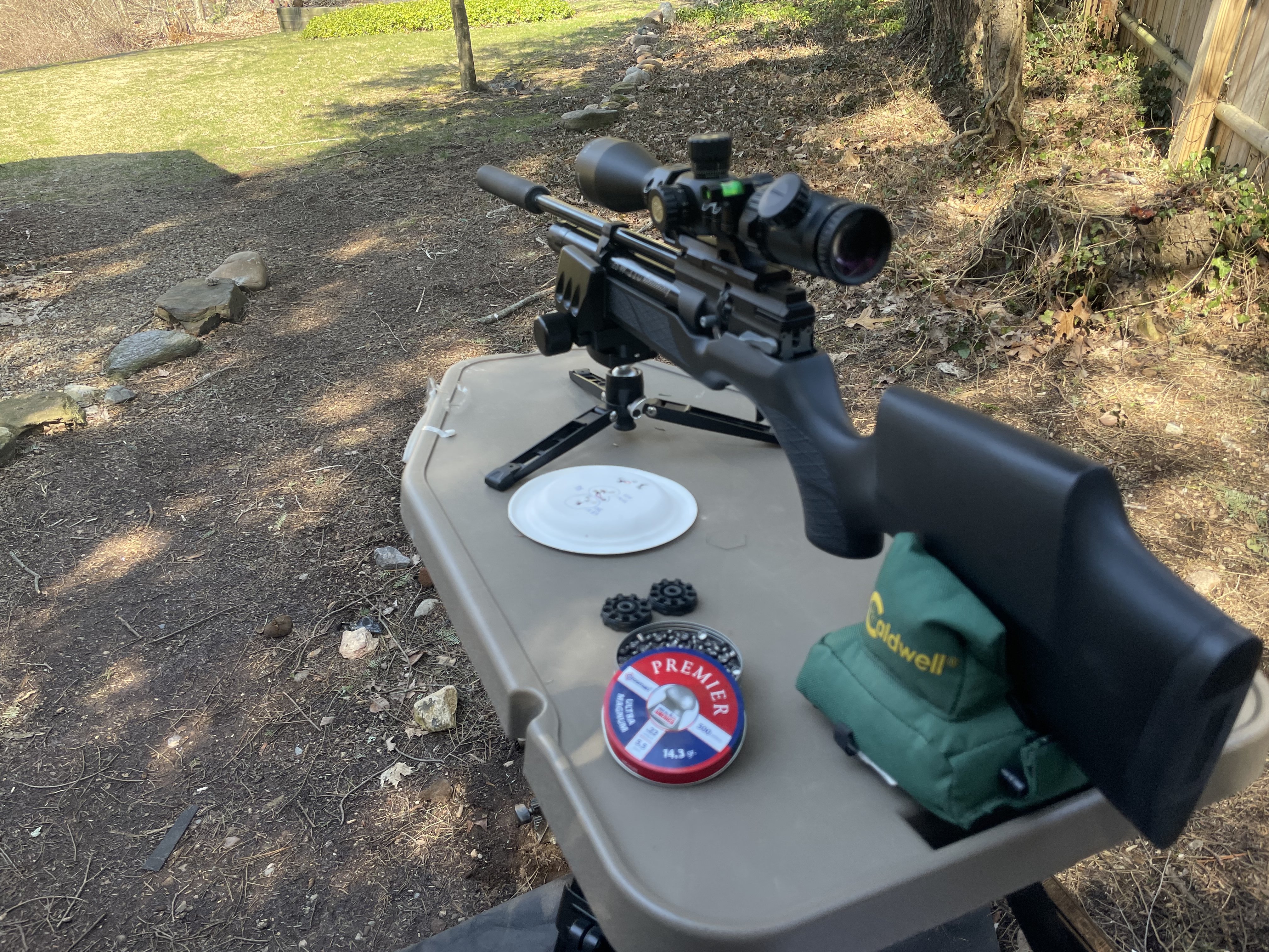

I’m just playing around with the Crosman in the HW110. I was running some shot strings with them and thought “damn those groups look tight for Crosman”. I measured the 7 or 8 five shot groups on the paper plate and was able to draw a 1/2” (!) circle around every group. Only 2 flyers on the paper plate.
At that point I got the idea to try to shoot 190 with them on this challenge. H&Ns are great - I expect no problem getting 190+ with FTTs.

Thought I’d share my “fish story” regarding attempting to score 190+ with CPHP 14.3s and my Weihrauch HW110.
As I’ve shared, my HW110 started life as a “FAC” 600mm barrel version shooting JSB 18.13s at 840fps and getting about 40 shots on the regulator (factory set at 150 bar). I’ve swapped the barrel to Weihrauc’s shorter 410mm and swapped the FAC hammer spring shuttle to the UK spec shuttle. I’ve dropped the regulator pressure to 90 bar.
Since I put on the 410mm barrel, the rifle shoots CPHP stunningly well. Now I know that these are just plinking pellets, but I was getting consistent 1/2” groups at 30 yards (and one zeroing group yesterday that measured .08” ctc !) … so I figured I’d try to score 190 with them.
Yesterday, I put up a 30 yard target and used the 1st 6 targets to rezero the HW110 with CPHP - as I rezeroed to shoot some JSB 13.43g the day before). Then I started hitting 10s and Xs. I had to go across 2 cards because I used the 1st 6 targets to rezero. The result was a 196 8X with CPHP !!
I wasso excited that I put up another fresh target…. And proceeded to shoot 185… dang… still no official 190+ with CPHP.
One other interesting thing. Previously, I was shooting the CPHP 14.3g at 700fps and also tried 740fps. Because I kept the JSB 13.43g tune yesterday, I was shooting the CPHP at 650-655fps for the “phantom“ 196. I think I will stick with this rather slow velocity when I resume my pursuit of 190+ with CPHP. My HW110 has not shot less than 181 with the CPHP (best was 186) across about 6 or 7 targets now.
Wish I had the rifle zeroed when I started that 196 miraculous target…

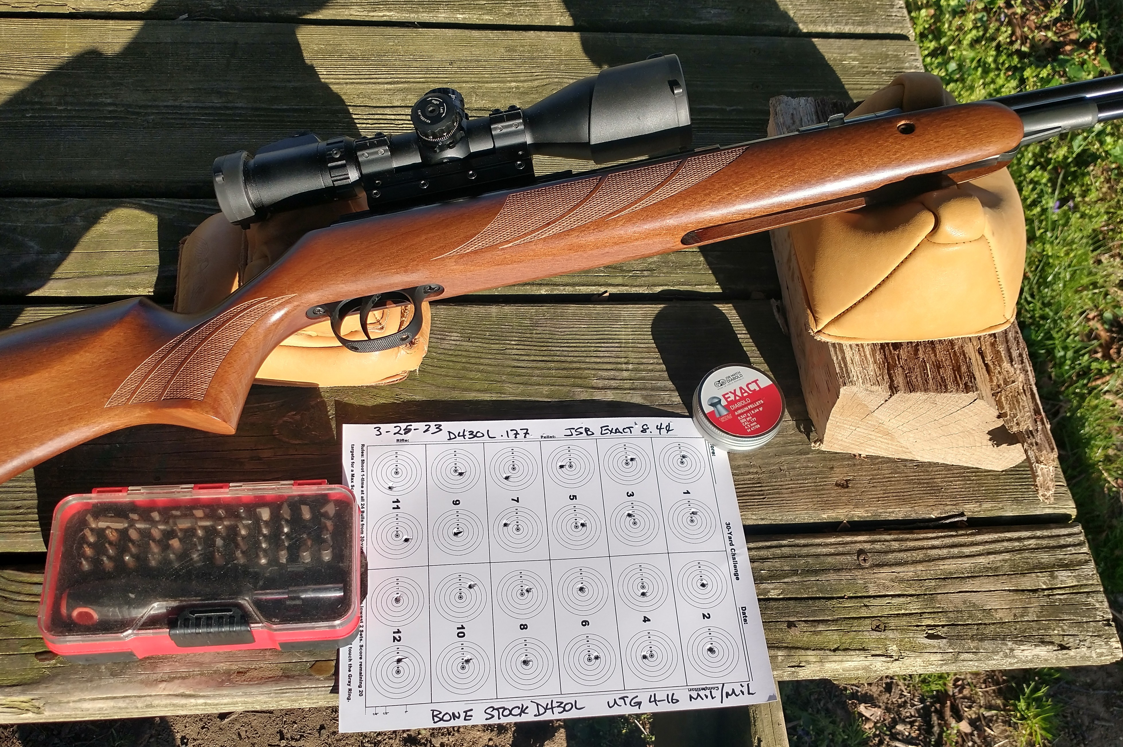

I got out the bone stock Diana 430L that I have not had on the bench for over 2 months. It was a bit windy, something like 8 to 15 mph mostly at around 2 o'clock. I shot this target. Scoring without a scoring tool I make it 182 and 6x. Not bad for a spring rifle that hasn't been shot in 2 months.

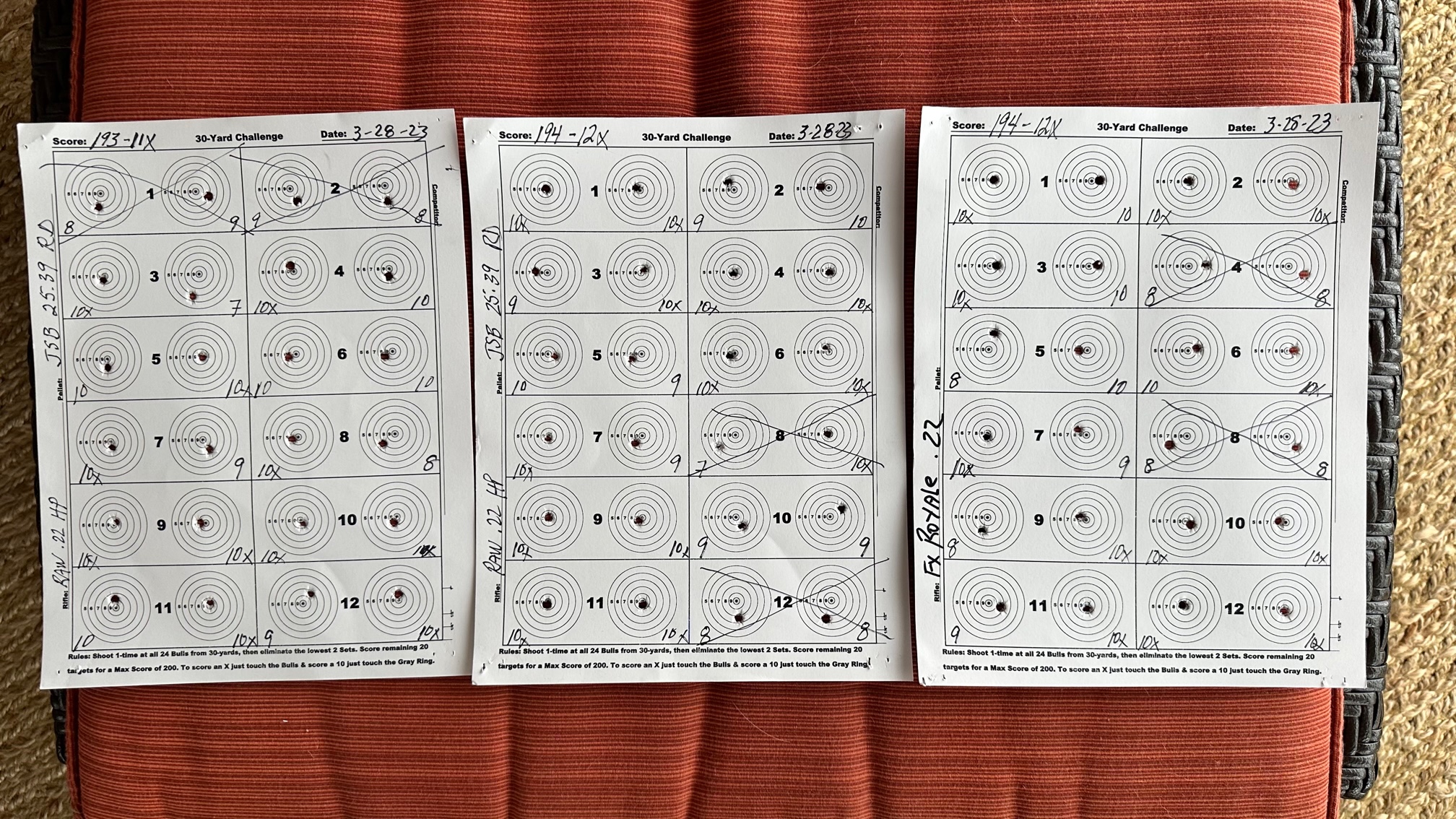

Swapped some scopes around, then I shot some 30 Yard Challenge cards today…
Did pretty well with the Dreamline .177. Shot 193 and 194.
Had not shot the Cayden .22 in a while - shot a 191 with it.
Shot a 188 with the HW110 - used H&N FTTs. Took a break from the Crosman pellet challenge, lol.
Shot a few cards today with both the RAW HM1000x .22 HP and the FX Royale .22. Both guns shot well, there was a light wind at 1-2/3 mph.
I will submit the 197 for the Royale. I have an excellent Leupold 6.5X20X40MM EFR 2FP on the Royale and the glass is very clear with the duplex reticle. Have the Midas Tac 6-24 X 50MM on the RAW.
Shot one 50Y N50 target with the RAW. 239, which is pretty solid, but the wind got me a few times as you can see.
