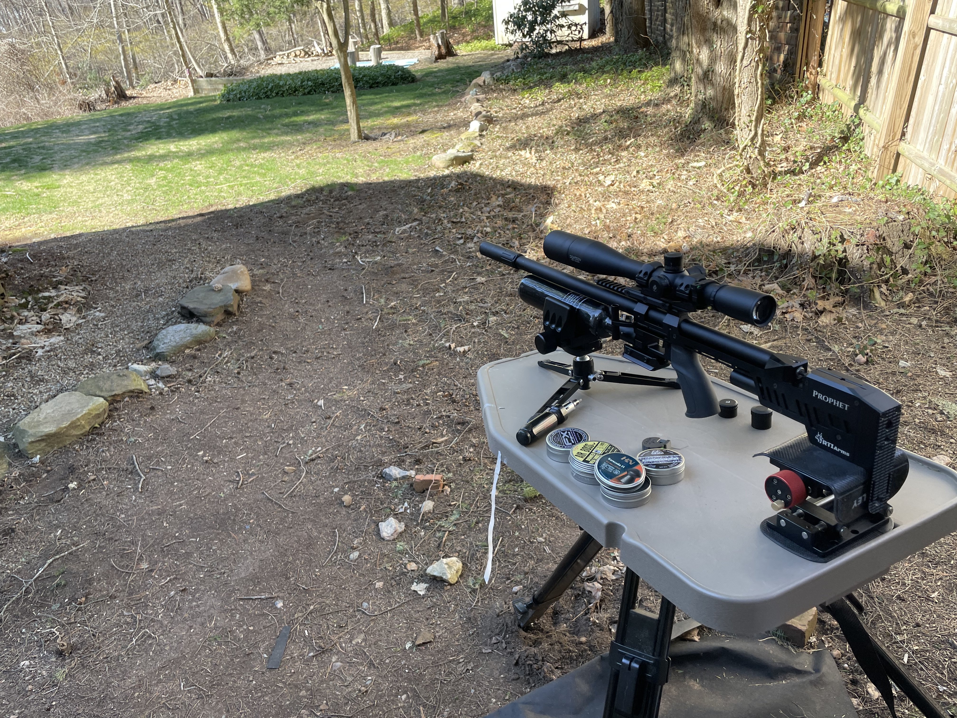

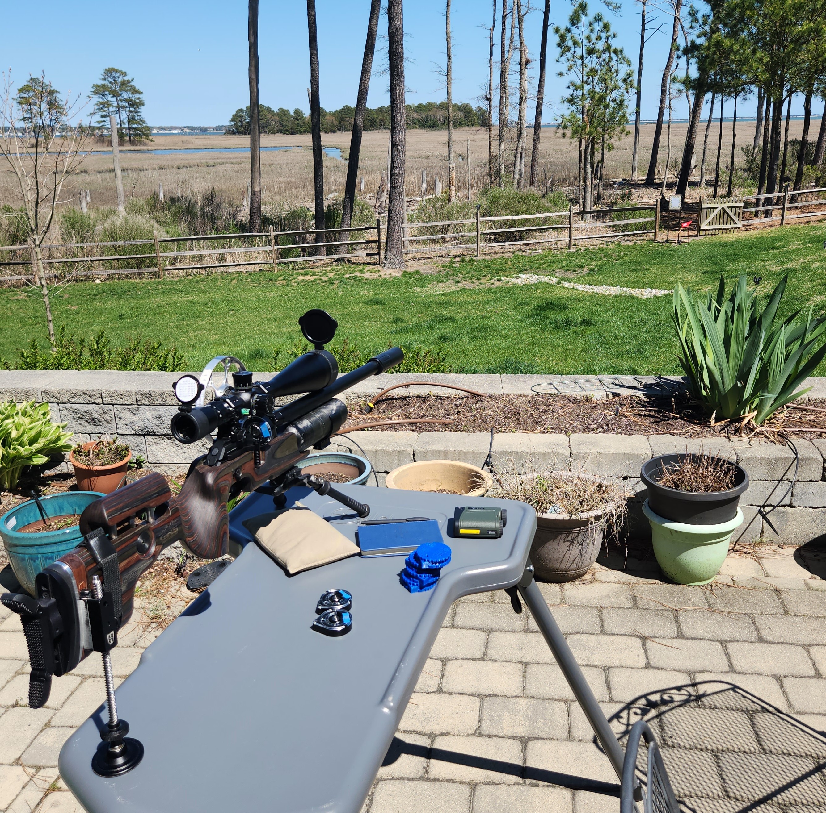

Took a picture of my backyard range. I really need a more sturdy bench. Planning on adding a deck this summer. I will have to build in a bench and disguise it as something else to keep my other half happy. Maybe a fancy, sturdy plant stand?
Cheers,
Greg

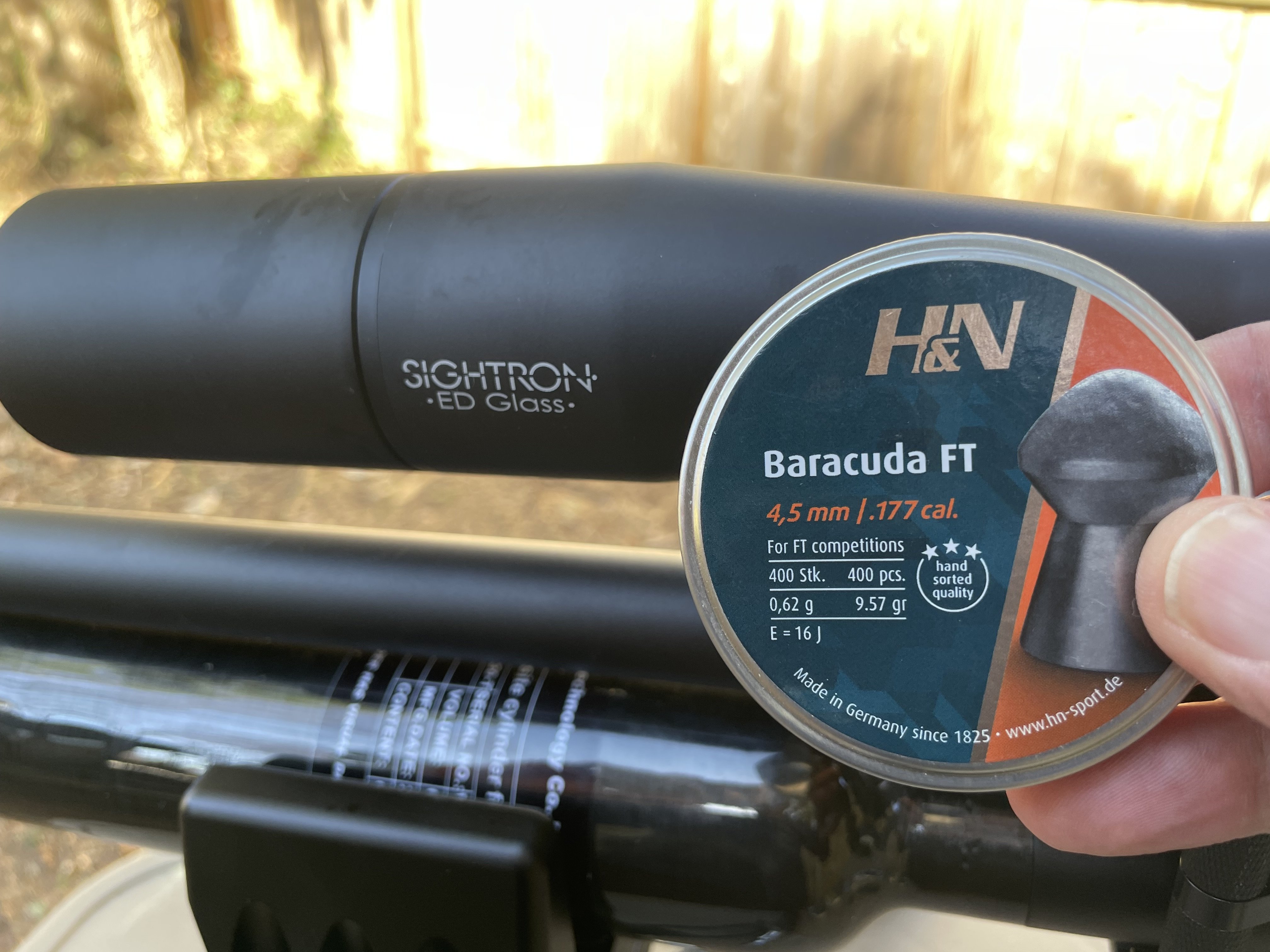

I shot 191 6x, 181 7x and 187 10x with the RTI Prophet Performance using .177 barrel. I used 2 types of pellets: Apolo Air Boss 9g and H&N Baracuda FT 9.57g (a very high quality pellet).

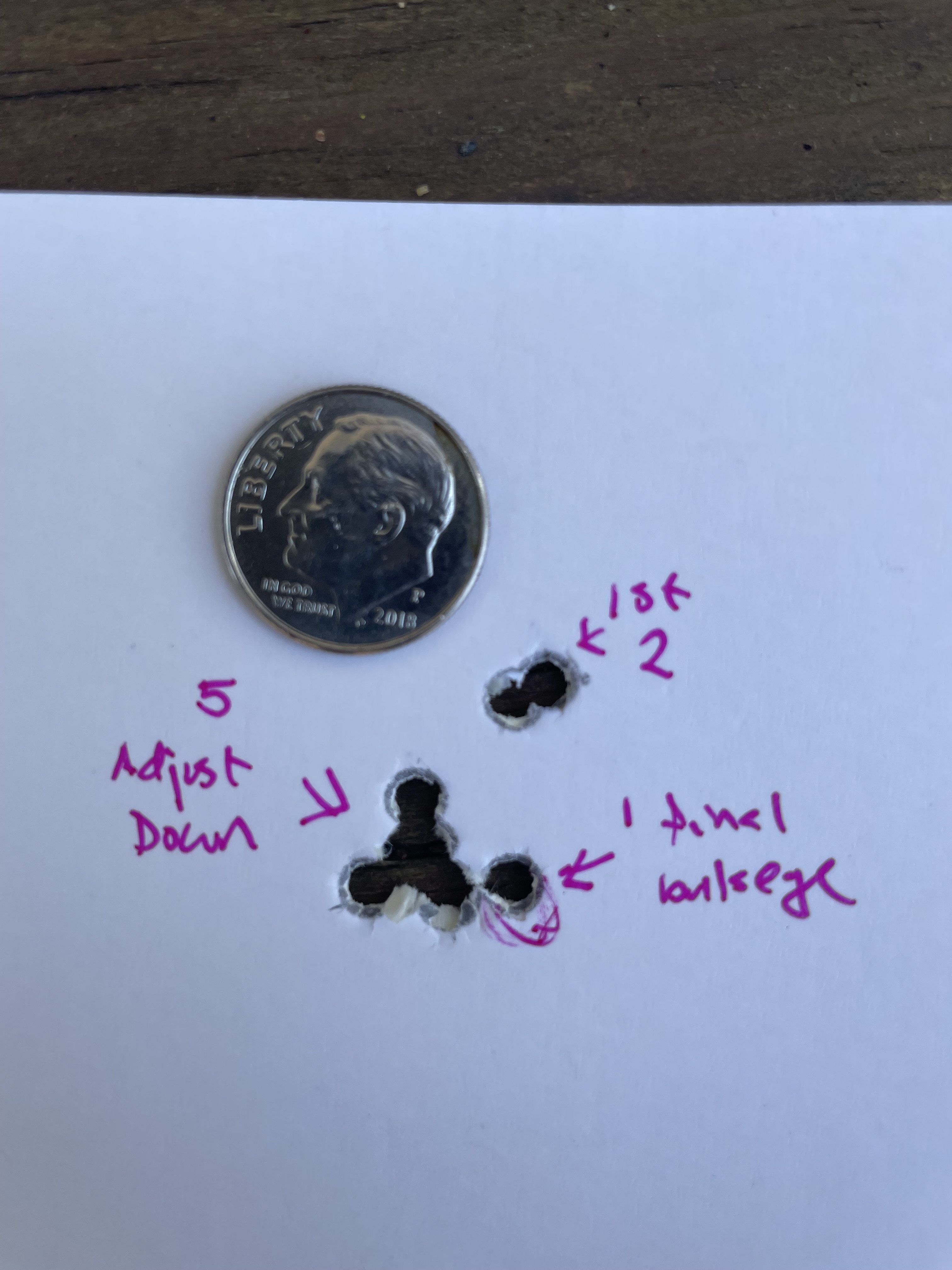

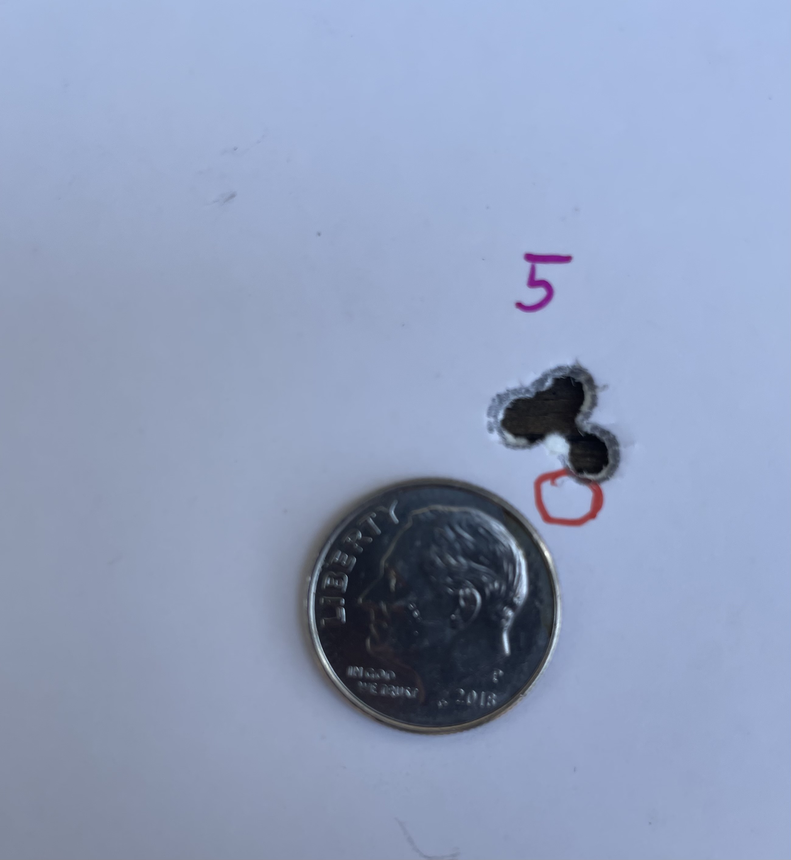

I’m showing some pictures of typical groups I’m getting with both the Prophet and Dreamline with various pellets. They are tiny groups at 30 yards.
It seems ashame now that I’ve got the Prophet dialed in with its .177 barrel to pull the barrel and swap in the .25 LR polygonal barrel, but that’s what I’m gonna do - going to my brothers Friday to practice at 100 yards. I’ve never shot further than 60 - but the crazy Sightron 45x target scope should help. Will also bring my Prophet.22 LR and perhaps the Daystate Wolverine R HP .22. So all 3 LW polygonal slow twist barrels could see action at 100 yards.

Great shooting Greg but hey, I love your set up and scenery, what a great view.

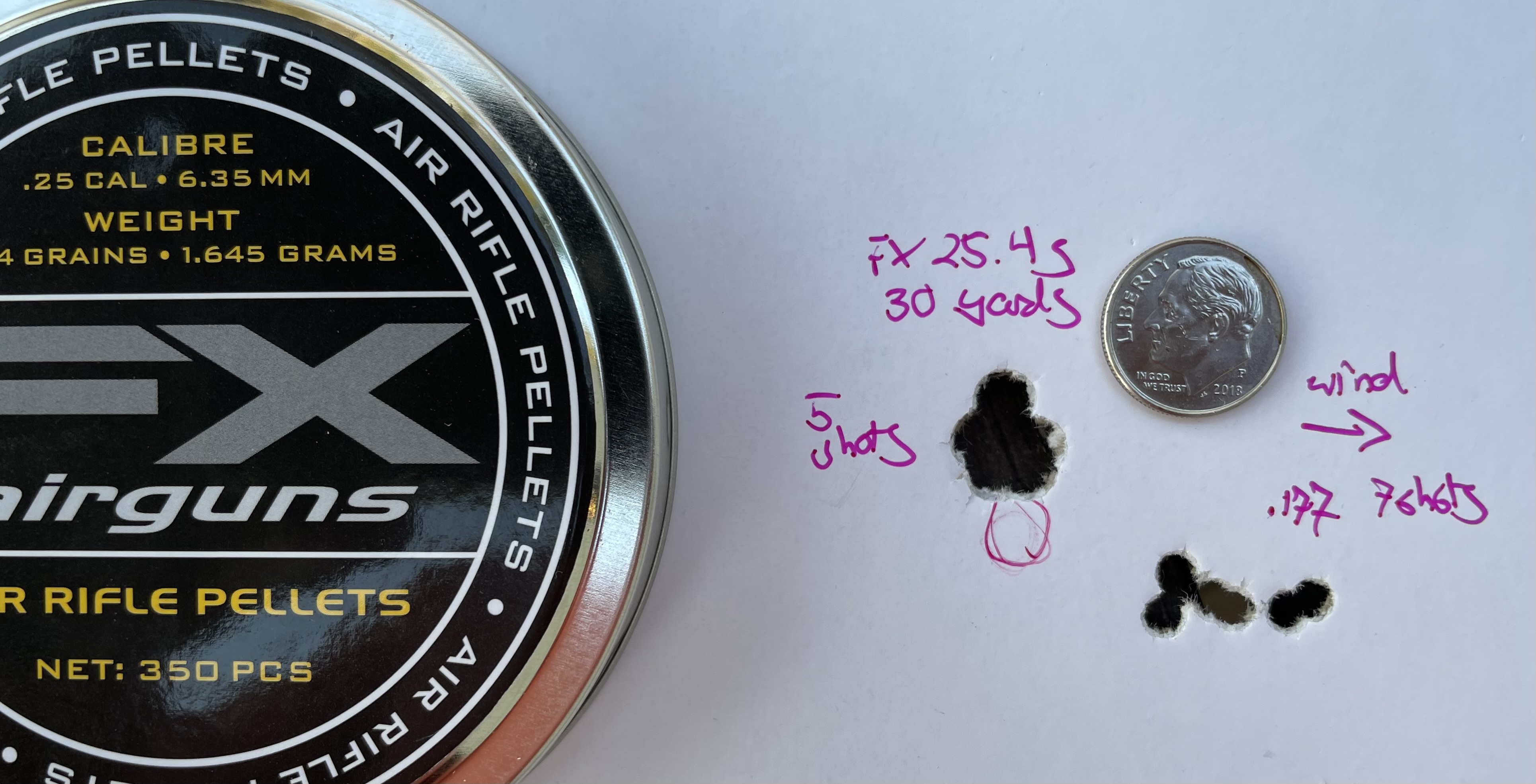

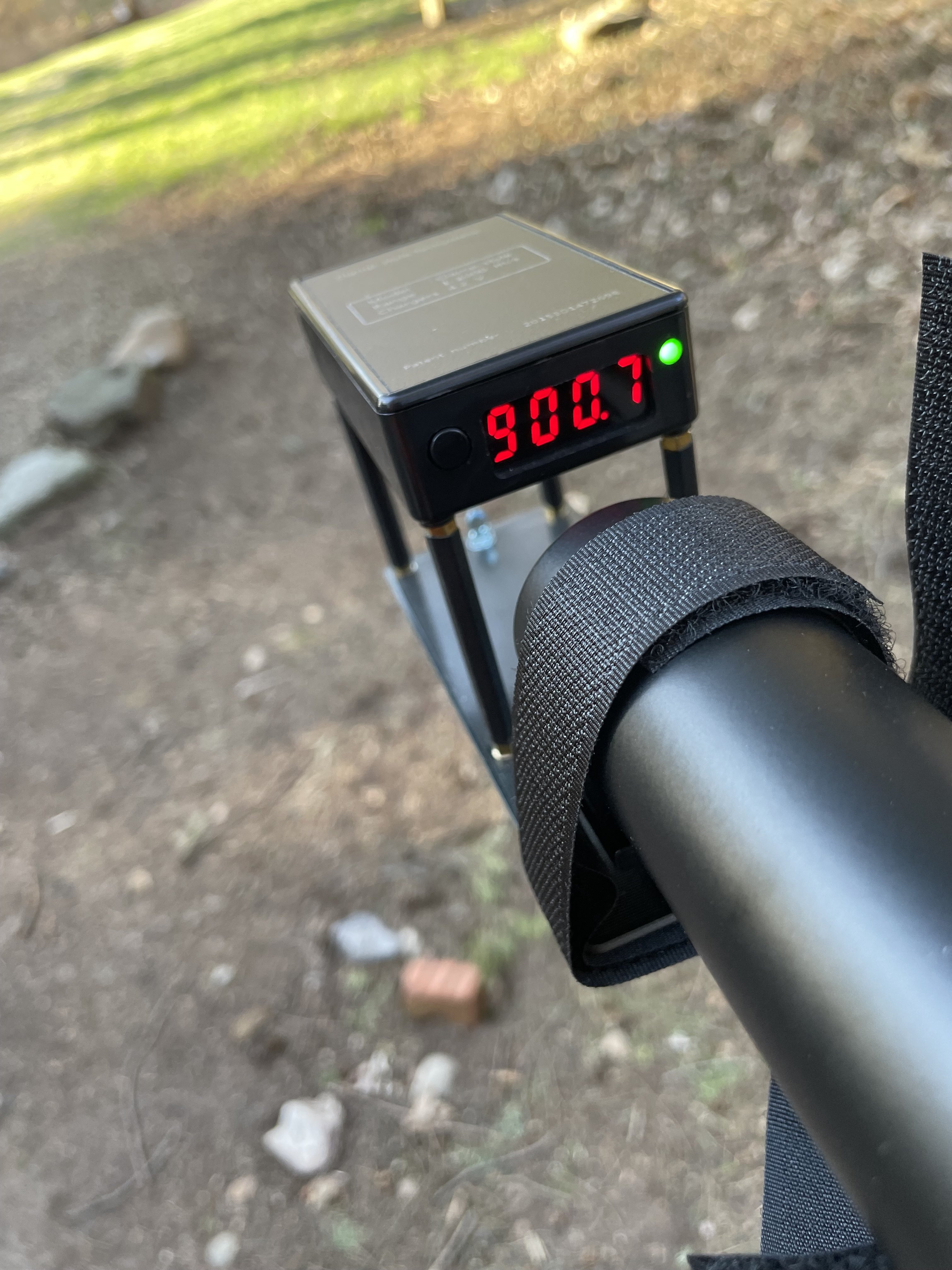

I swapped the .177 barrel out of my Prophet Performance V1 and swapped in the .25 Long Range barrel.
Going to shoot 100 yards for the first time Friday.
It quickly dialed in at 30 yards, but I had to swap my nice mild custom spring I made for .177 back to the stock RTI stiffer spring. I left out the Delrin spring guide, so its a bit milder than the full stock spring setup.
I raised my regulator pressure to 100bar and it quickly was slinging 25.4g pellets at 900fps - with ease.
I put a huge Neil Clague moderator on it, its quiet at the muzzle but the rifle is much more jumpy pushing so much air.
Perhaps a higher reg pressure will calm her down?
She grouped one hole at 30 and 40 yards, but I miss my .177 already…. She is now a beast!
