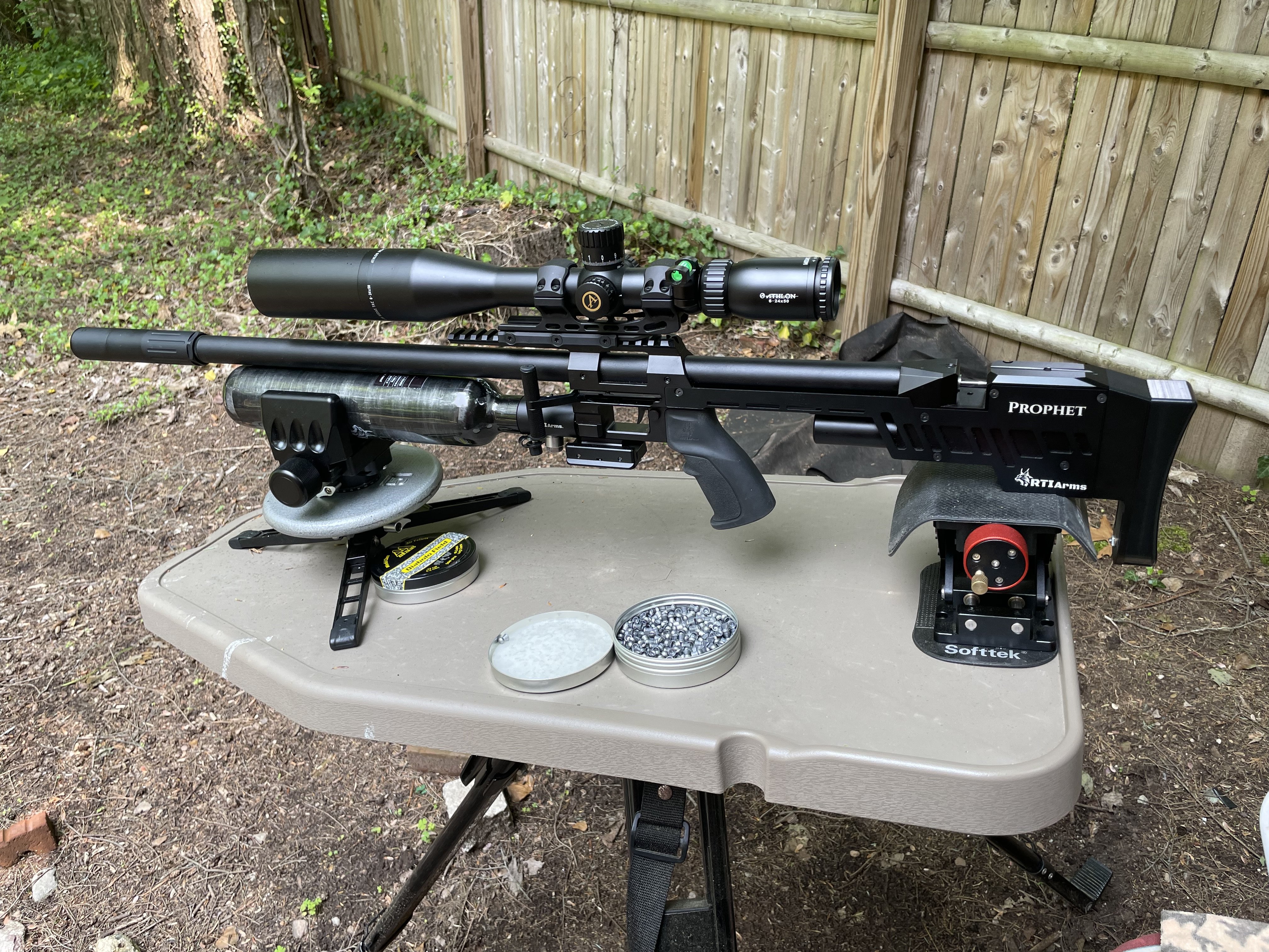

My 2nd and likely last 30 Yard Challenge card tonight.
This time grabbed my Prophet Performance V1 .22 LR. Shooting FX Atomic 15.89g pellets (same as JSB Hades) at 915fps - they were smacking the cardboard,lol.
Shooting well tonight- this is a 196 15x ! It does not beat my 197 11x with the Prophet .22, but I sure like the 15X over the 11x !
-Ed
An experiment using my 15.89g tune (895fps) with 18.13g in my RTI Prophet V1 with .22 LR barrel.
It shoots the 18.13g 815-820 fps with this tune. Seems to have excellent accuracy at this somewhat slower (than I usually shoot) velocity.
-Ed

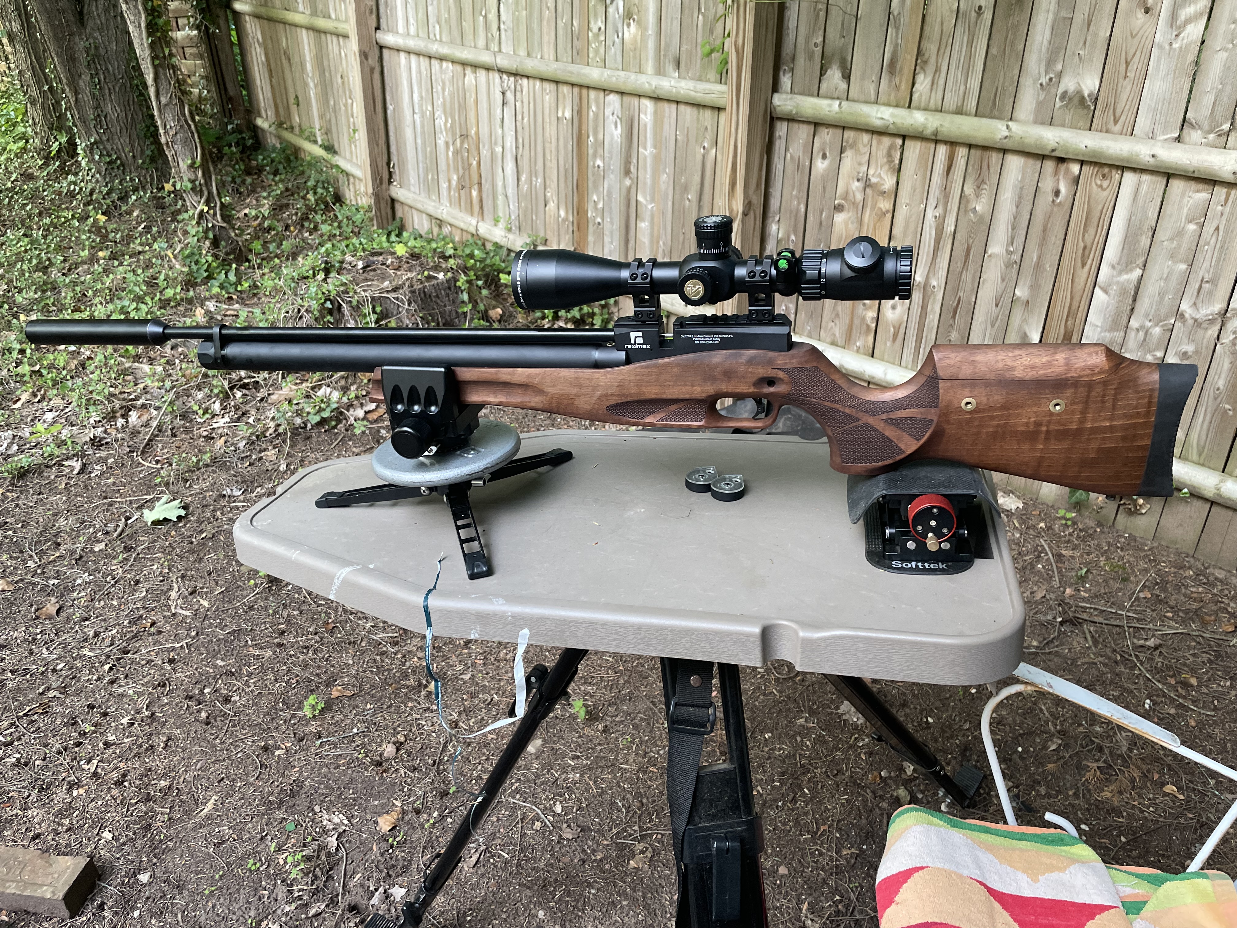

I surprised even myself tonight shooting this challenge with my Akela in a storm, lol.
Reactions: tommyb
Nice recovery on this card…
Took my 1st shot and realized my Prophet was not zeroed - had last shot 18.13g at a different distance.
Rezeroed and then finished the card shooting 196 13X - heck, that’s one of my top 3 scores with the Prophet .22.
I did break my rule of no “sighters” once you start the card - I had no choice but to rezero with sighters after the 1st target was way off.
I like the way I finished the last row - 4 Xs !
