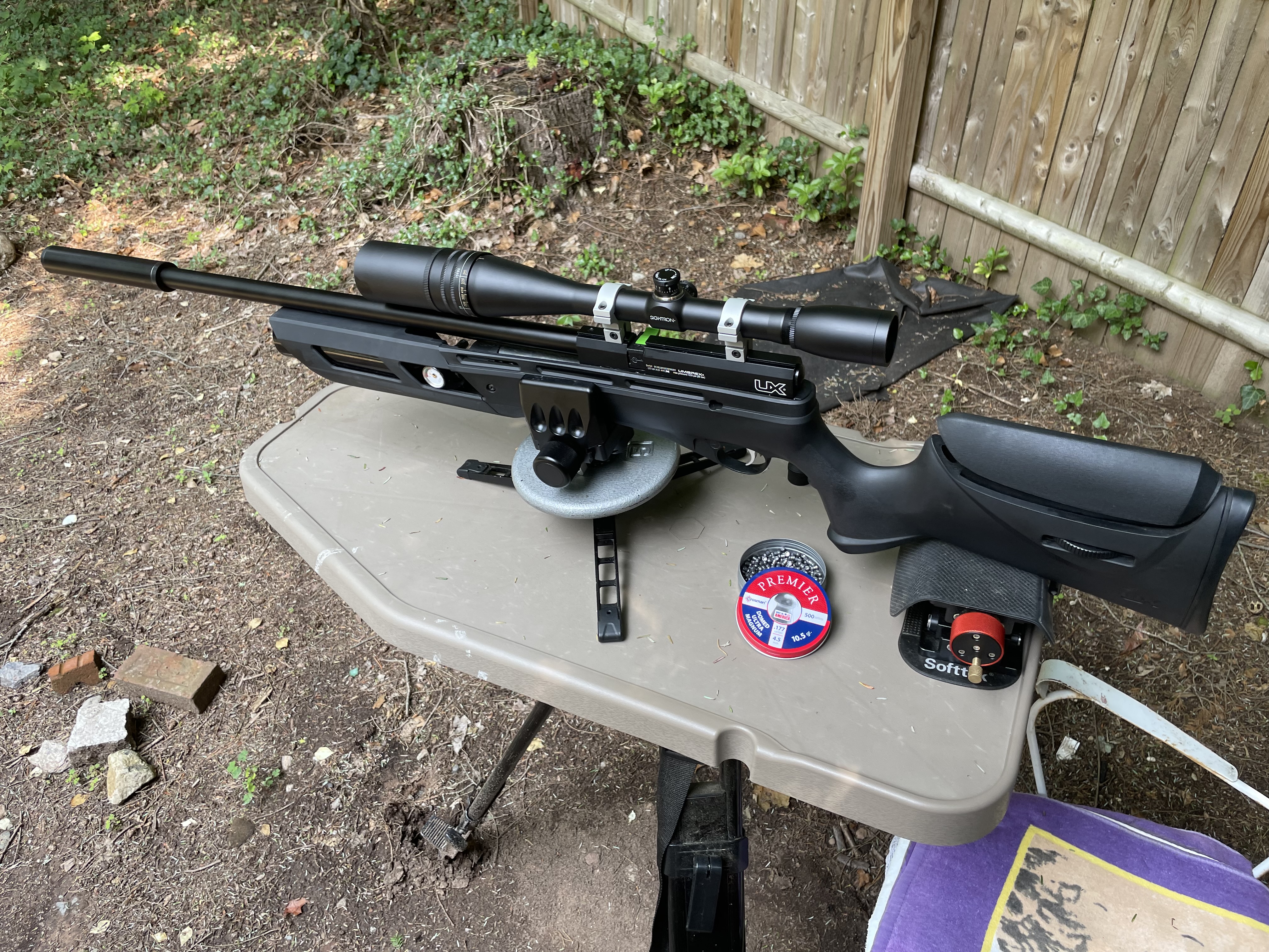

I’m still recovering from the shock of my Umarex Gauntlet with Crosman 10.5s.
I shot 198, 196 and 197 consecutively. I have not shot her since. She had a smile on when I put her back in the gun rack - she winked at the $2,000 rifles.

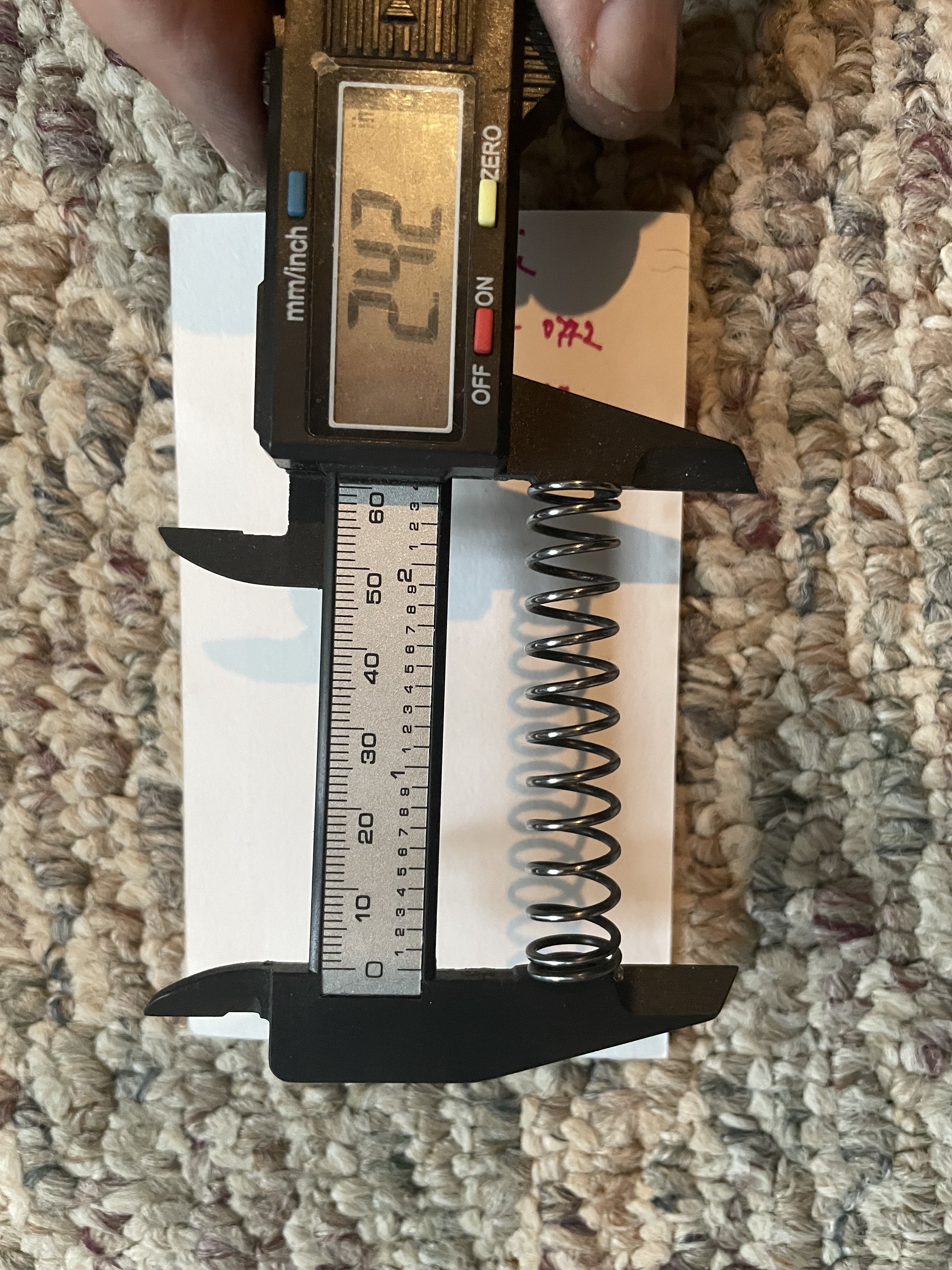

I’m currently running a 2.42” length hammer spring in the Akela (cut down from the 3.5” stock spring).
I shot this 198 with a starting fill pressure of 1,750, dropping to 1,400. I chronoed one shot after finishing the 198 and it was 849fps - so I’m getting an amazingly flat shot string across 2,500 to 1,400 psi with the 2.42” hammer spring. I posted some long 140 shot strings when I was running a 2.57” spring in the Akela, I’ll have to run another shot string with the 2.42” spring at 850fps velocity range.
Hope this info helps other .177 Akela owners.

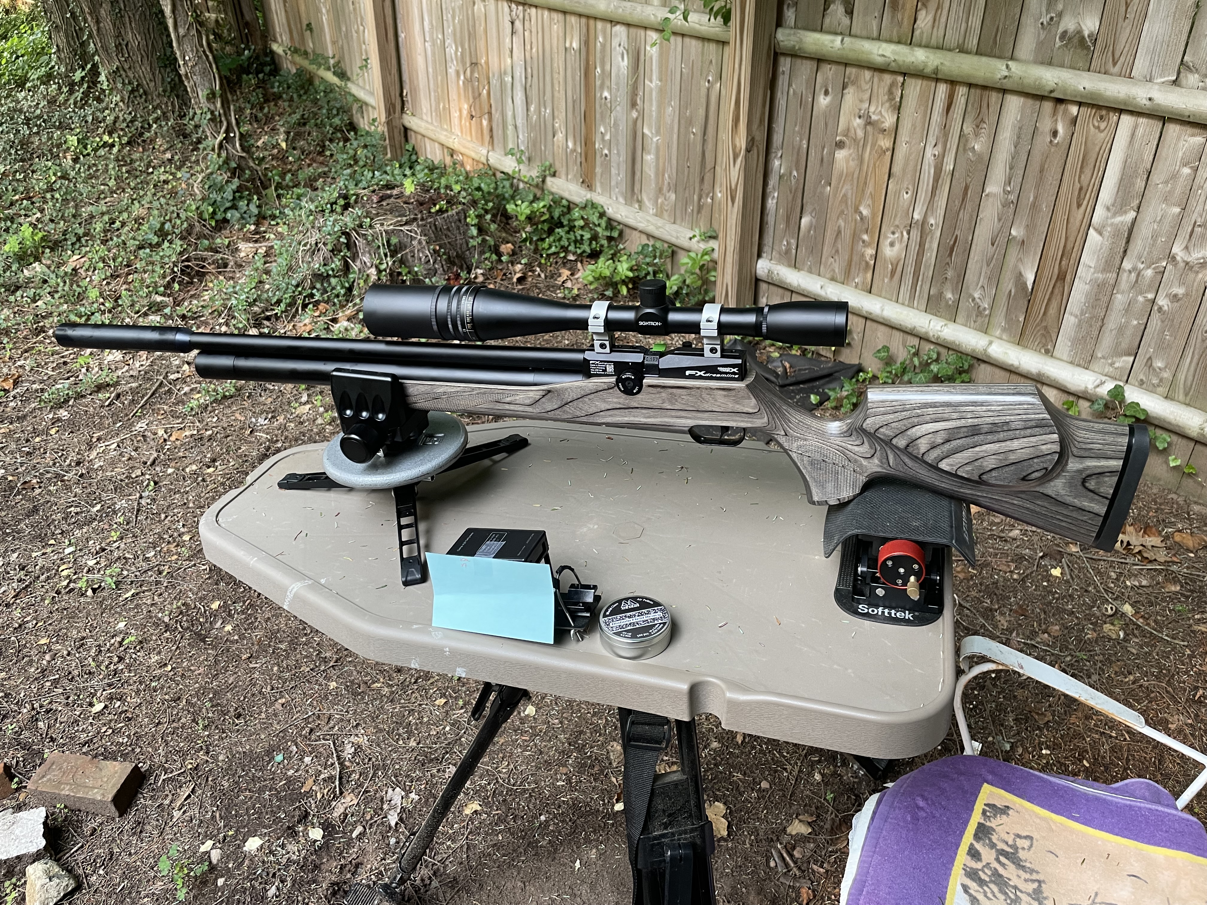

I put the Sightron SII 36X on my Dreamline Classic - currently using .177 barrel.
Dreamline was not grouping tight enough for 30 Yard Challenge shooting FX 10.3s at 885fps. I dropped velocity to 840fps and immediately was getting .25 groups needed.
1st card with Sightron is this 198 11X - I submit this for the leaderboard as it bests my previous 197 with the .177 Dreamline.
As you can see, I was not zeroed in completely when I started the card - so I wound up discarding Target groups #1 and #2. Might have had a shot at 200 had I been fully zeroed at the start.
The Arken EPL-4 6x24 I had on the Dreamline is great at 24x, but the Sightron is much better suited to the precision required.
-Ed

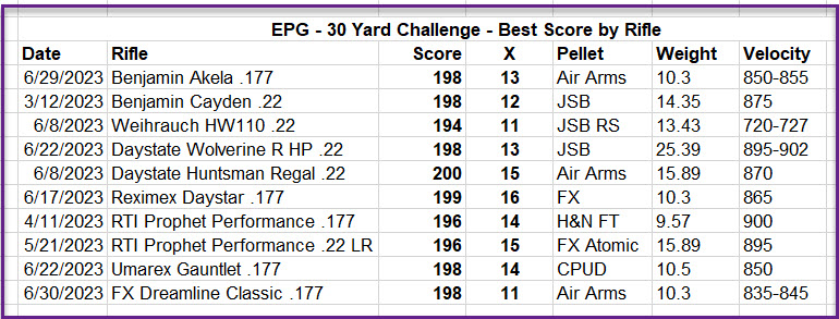

I noticed tcarson777 who runs the 30 Yard Challenge leaderboard has not posted in a while…
I thought I’d share my top scores with each of my rifles - to make it easier for him when he gets around to updating the leaderboard, lol:
Yeah, I can’t believe I’ve got at least 5 196+ cards shooting Crosman 10.5g domes with a .177 Umarex Gauntlet. The thing loves those pellets!
-Ed

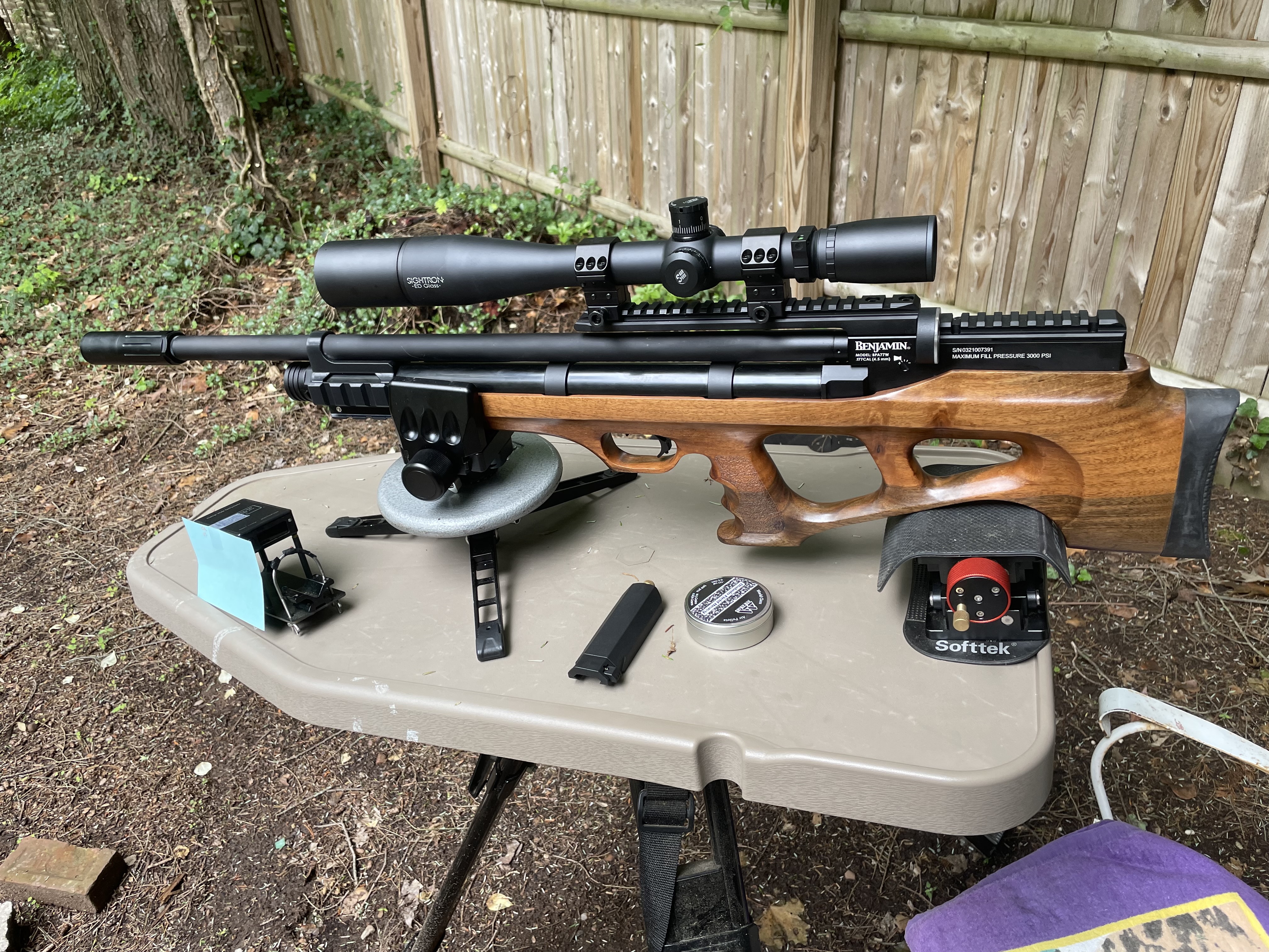

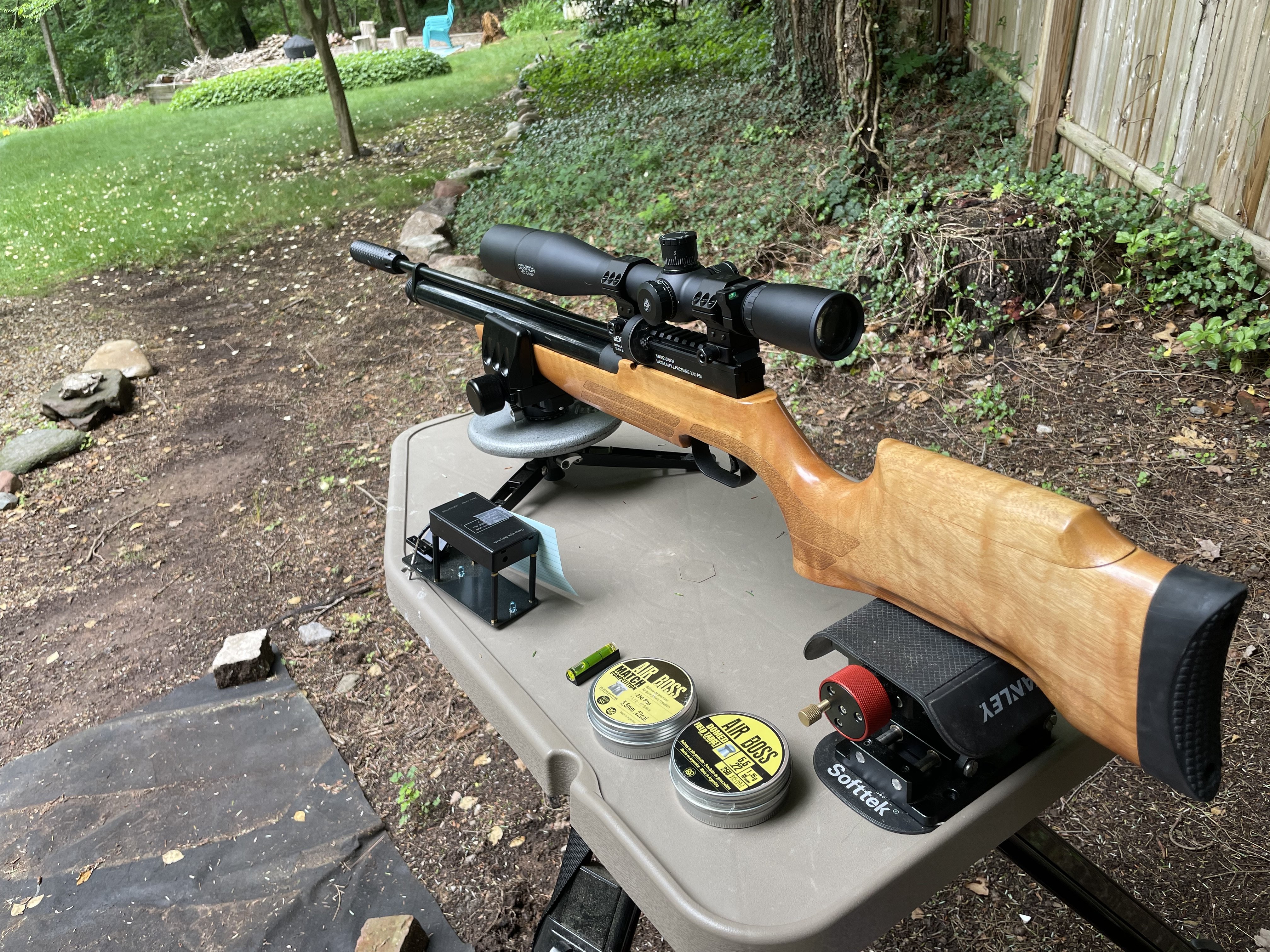

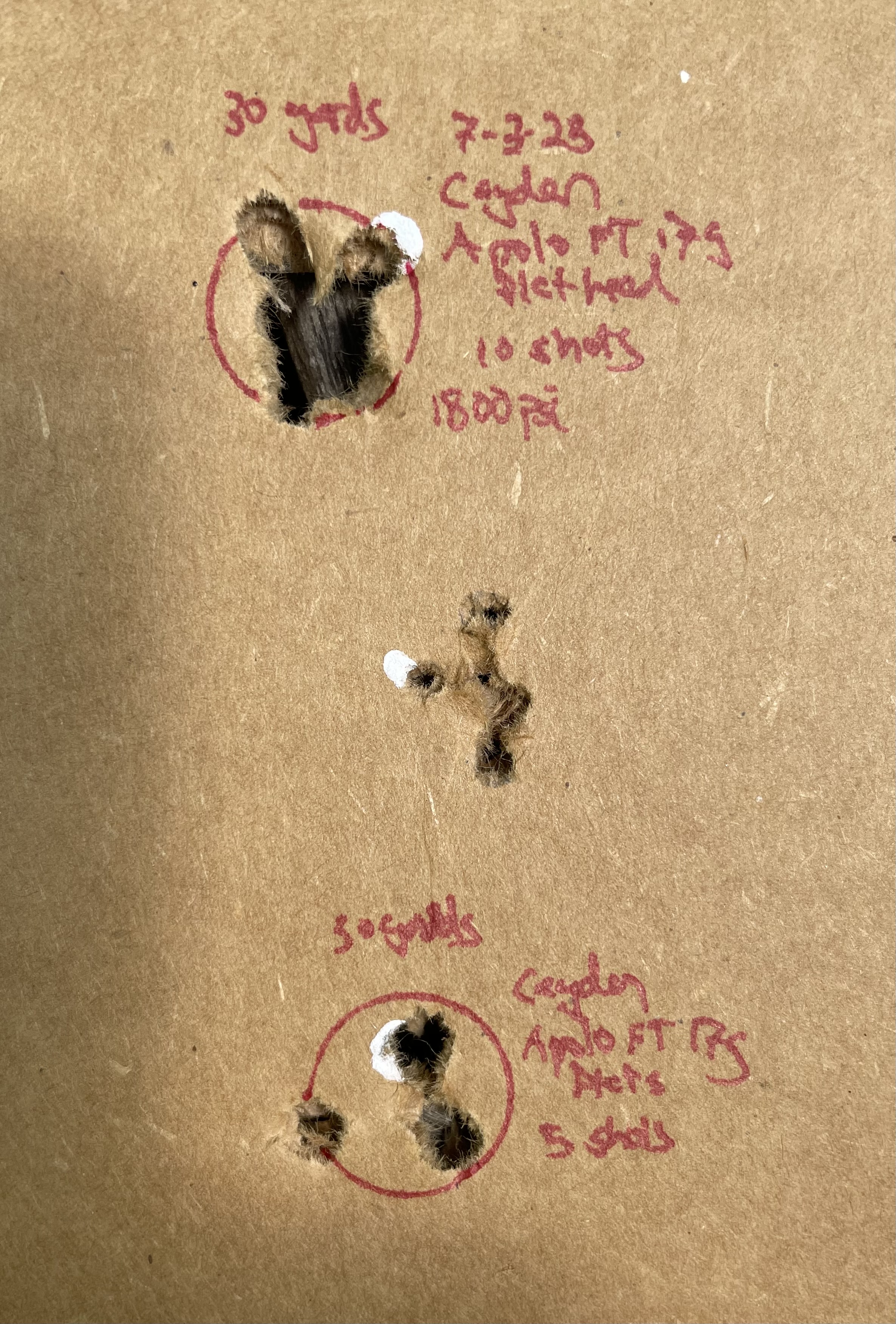

Doing some testing of some “Air Boss” .22 pellets - with my Benjamin Cayden.
Midway sells the Air Boss. I believe Air Boss is the premium line of the Apolo pellet brand. They are made in Argentina.
I’ve found them to be good shooting, consistent pellets. As good as H&N and JSB? Well, close - perhaps as good if you sort them. I’ve found them to be a bit less consistent shooting straight from the tin - but they can put up some remarkable scores.
Today I shot the 18g domed field targets and the 17g Match Competition - which are flat headed pellets - they make a nice round big hole in the target, lol. I didn’t know whether flat pellets would remain stable at 30 yards and 790fps, but they seemed to do OK.
Shot the 18g domes at 771fps and the 17g flatheads at 790fps.
Shot 185 7X, 188 11X, 195 8X and this 196 12X with the 18g domes.
Shot 186 4X with the 17g flatheads. Perhaps I lost concentration a bit on Target #12 - might have scored a point or two higher if I hadn’t.
You can see the 17g flatheads were grouping well enough (10 shots under a dime) to try the 30 yard challenge with - I wasn’t sure what to expect from flatheads with any breeze…
-Ed
