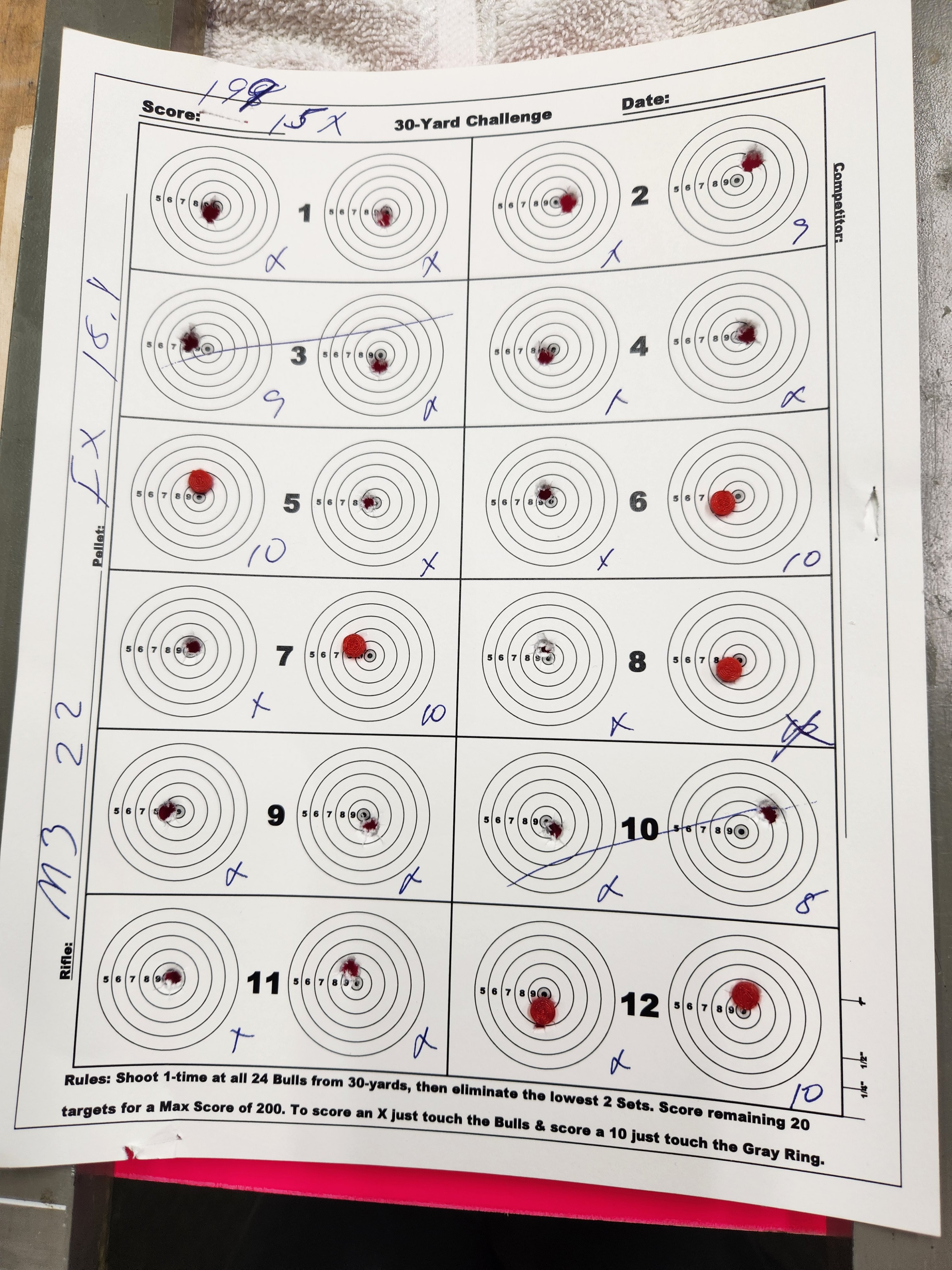

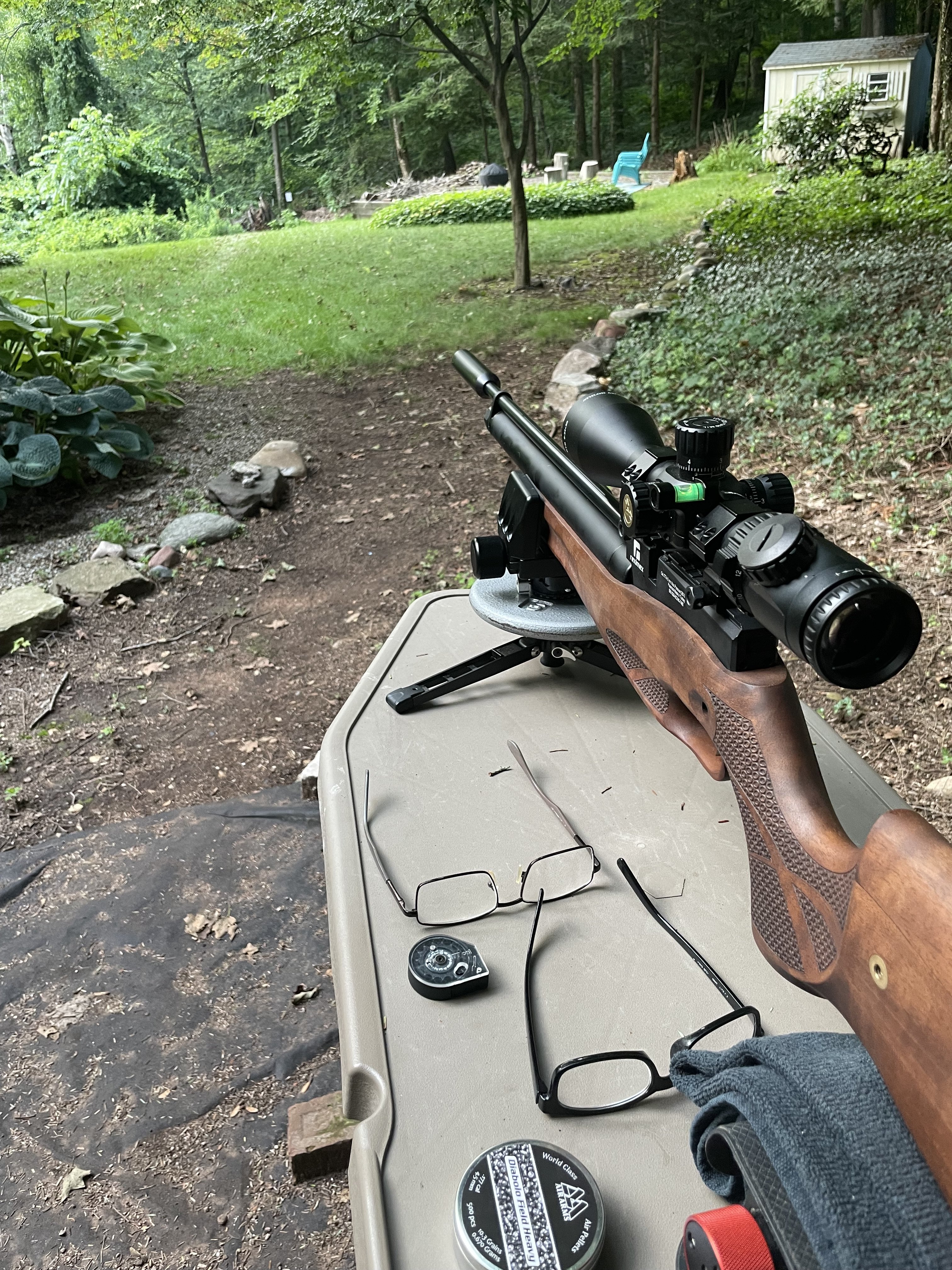

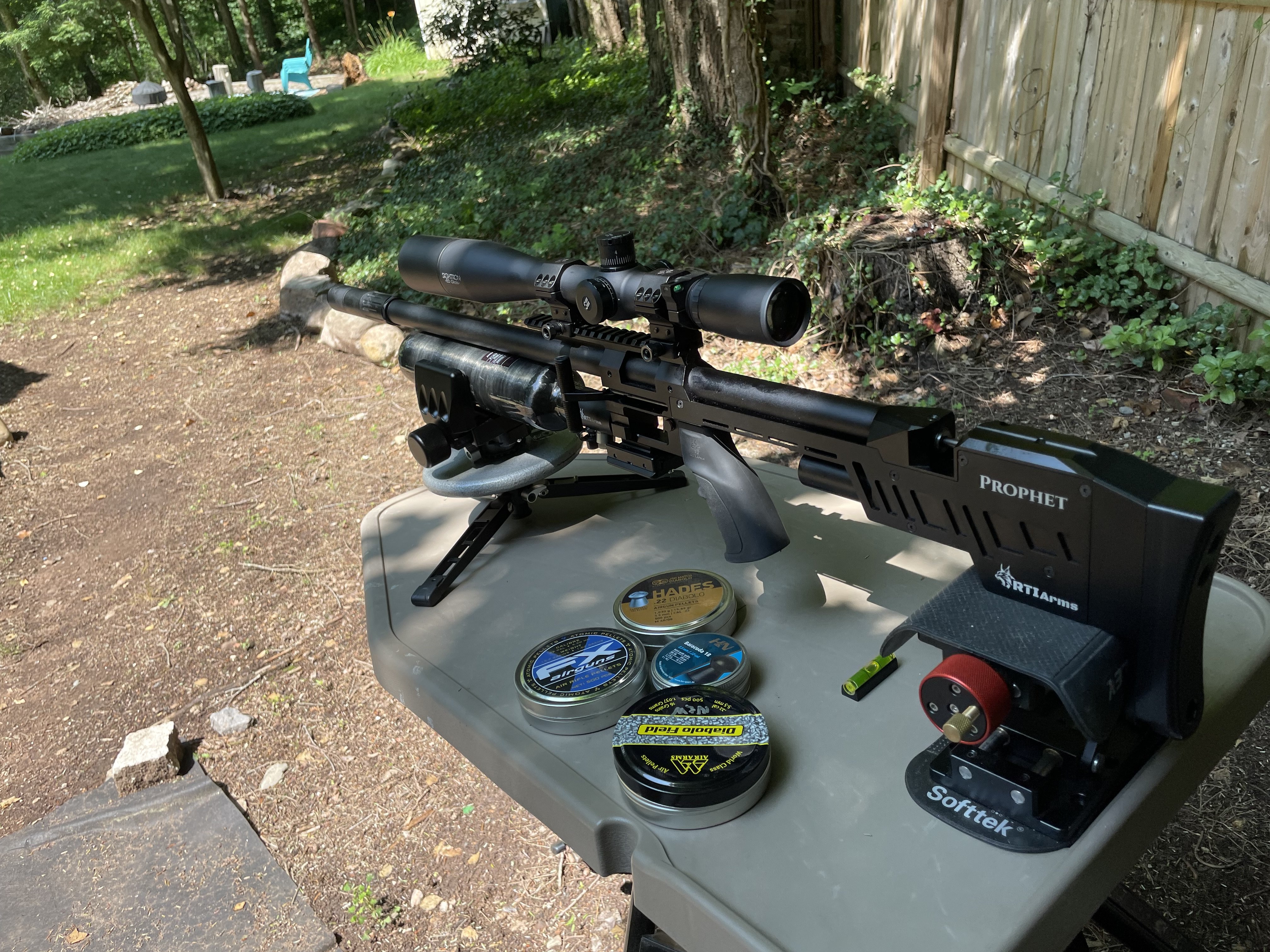

1st TYC card of the day, and 1st with Sightron SIII ED 36X on Prophet Performance .22 LR.
I’m happy with 195 14X, but this card felt higher… I didn’t shoot as well on the last 2 rows.
Love this scope, incredible detail!

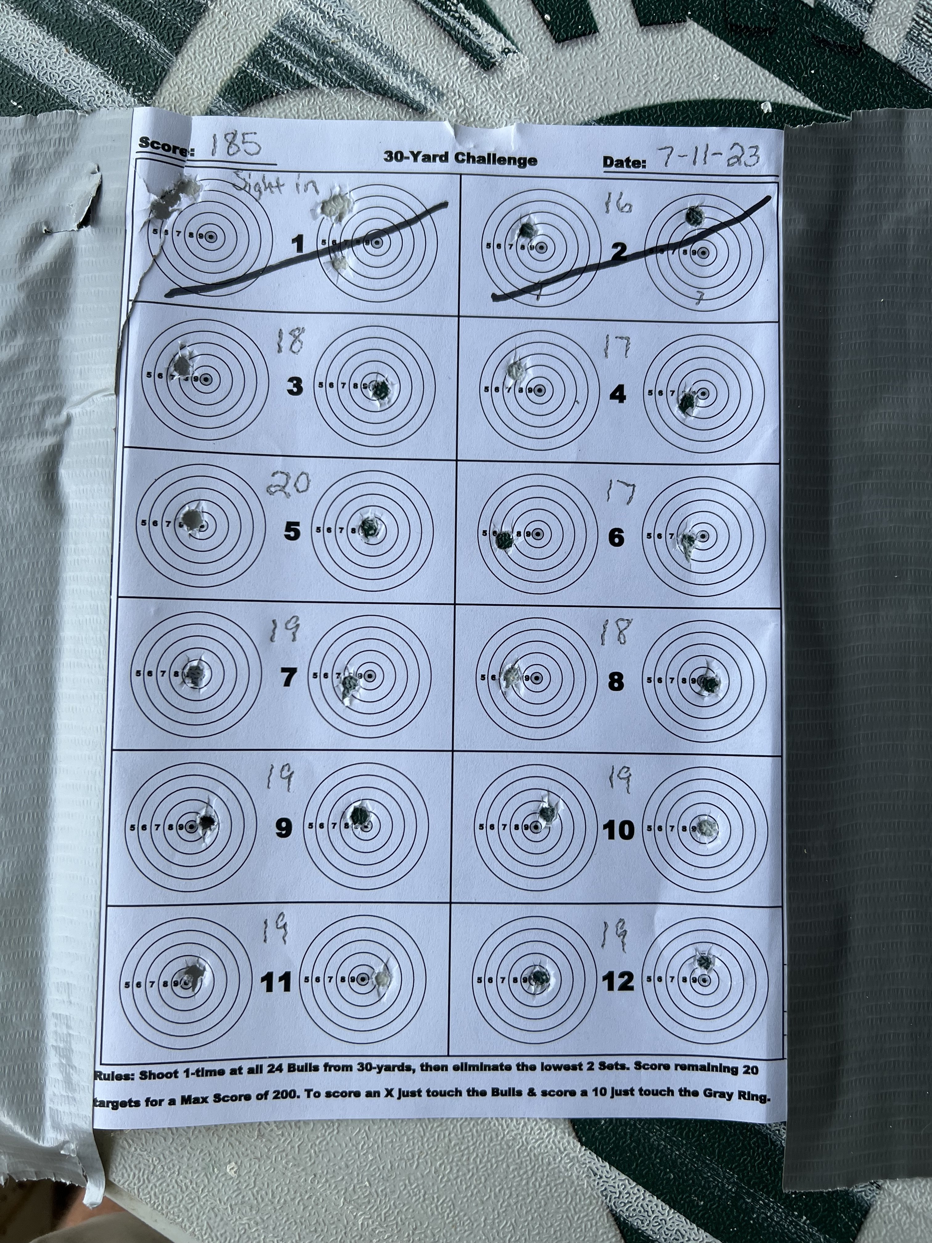

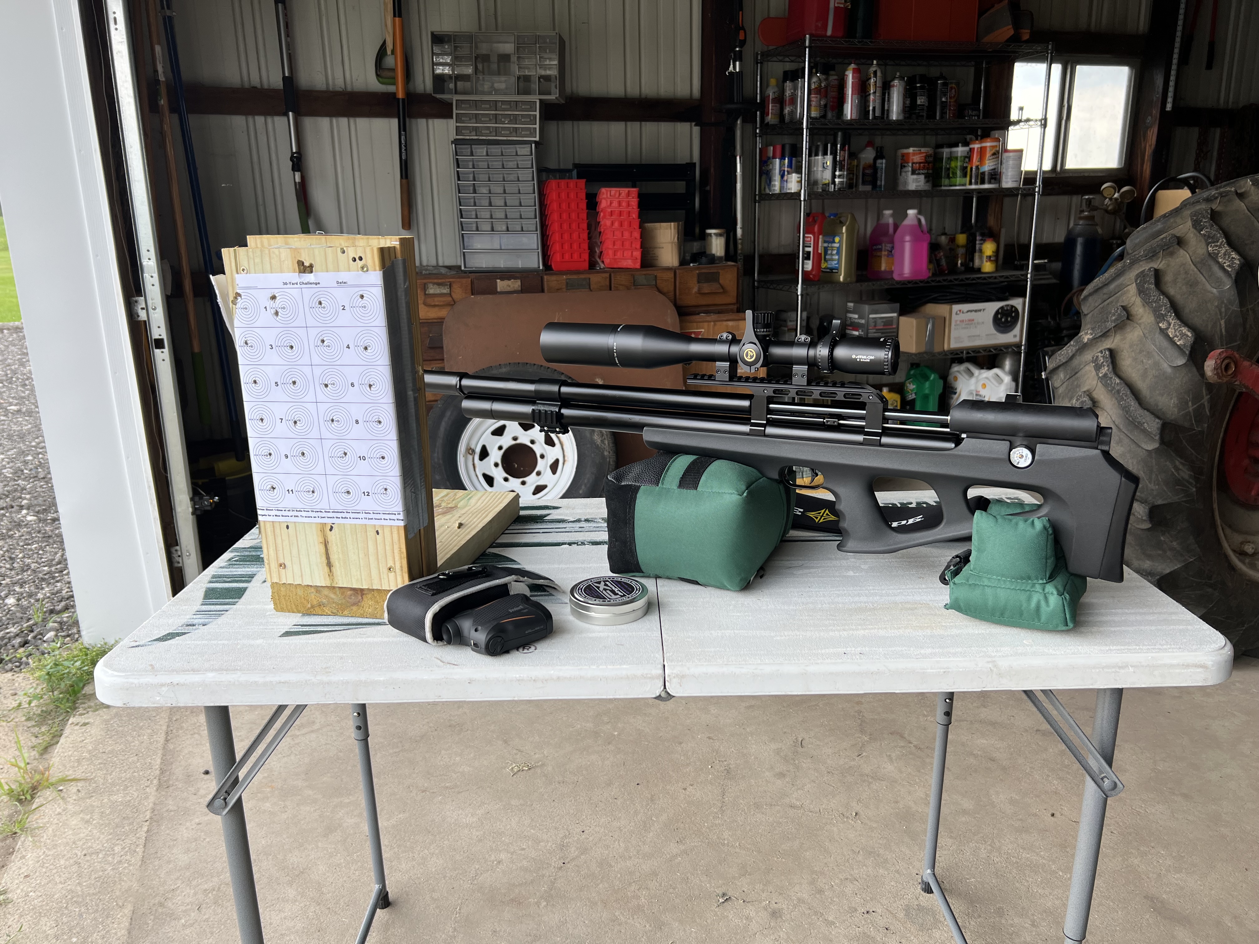

I shot 3 targets today. Springer Class
  1. 30-yards - bench
  2. Front and rear bag
  3. TX200 MKIII .177 with 3mm spacer
  4. Vortex Diamondback 6-24x50mm
  5. AA Field Heavy 10.3 (4.52mm) sorted to 10.4 grains with wax lube
  6. Wind 5 to 10 mph largely 6 o'clock
  7. 93°F and it was HUMID
  8. These were scored best edge touching using ARA .22 plug (pic)
I held up for the for the first 2 targets and then my concentration failed. I am out of practice on 1 per bull targets. I did shoot a 50-foot version this winter. However I have since gone to a 10-shot 50-yards shooting style for the last couple months. I am not sure it helped.
Target 1: 184 (6x)
Target 2: 189 (7x)
Target 3: 174 (2x)

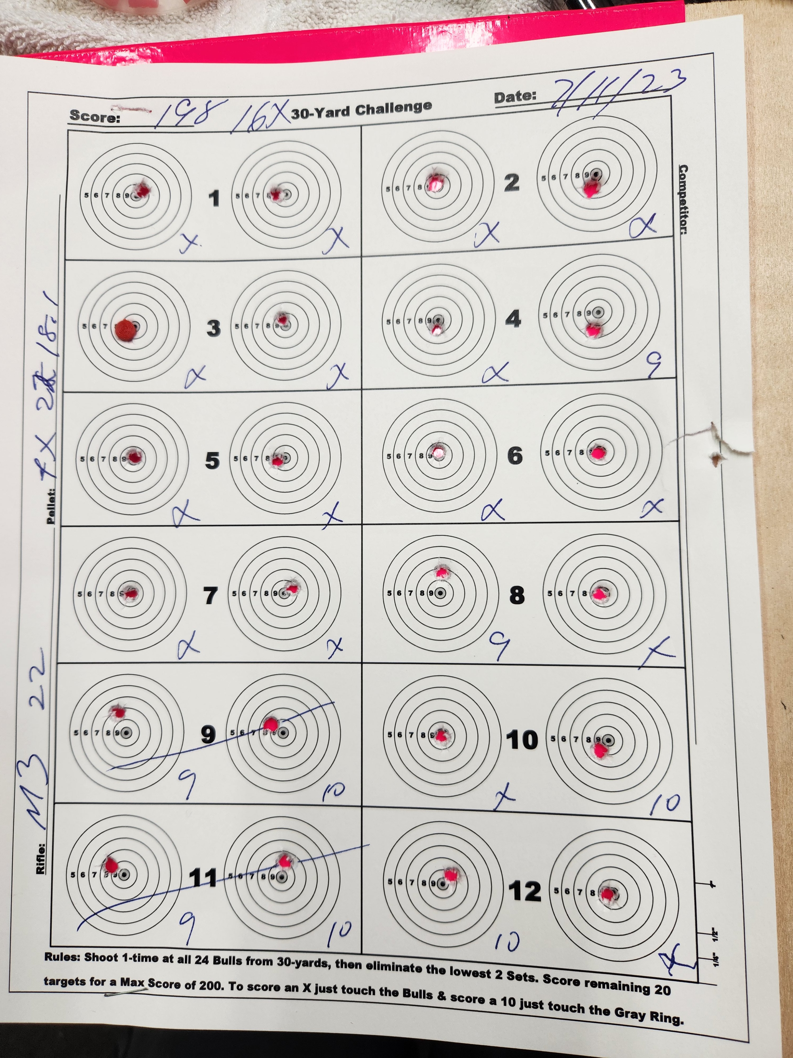

I got some fresh targets printed yesterday and was trying to figure out my interaction with my new Ghost 22 hp shooting 26g pellets. Not much luck still a work in progress, 192 max. So I had to shoot my M3 22 to boost my ego a bit. It still shooting better than me. A couple of 197"s a 198 and a 199 made my day.
Reactions: EPG and drpietrzak

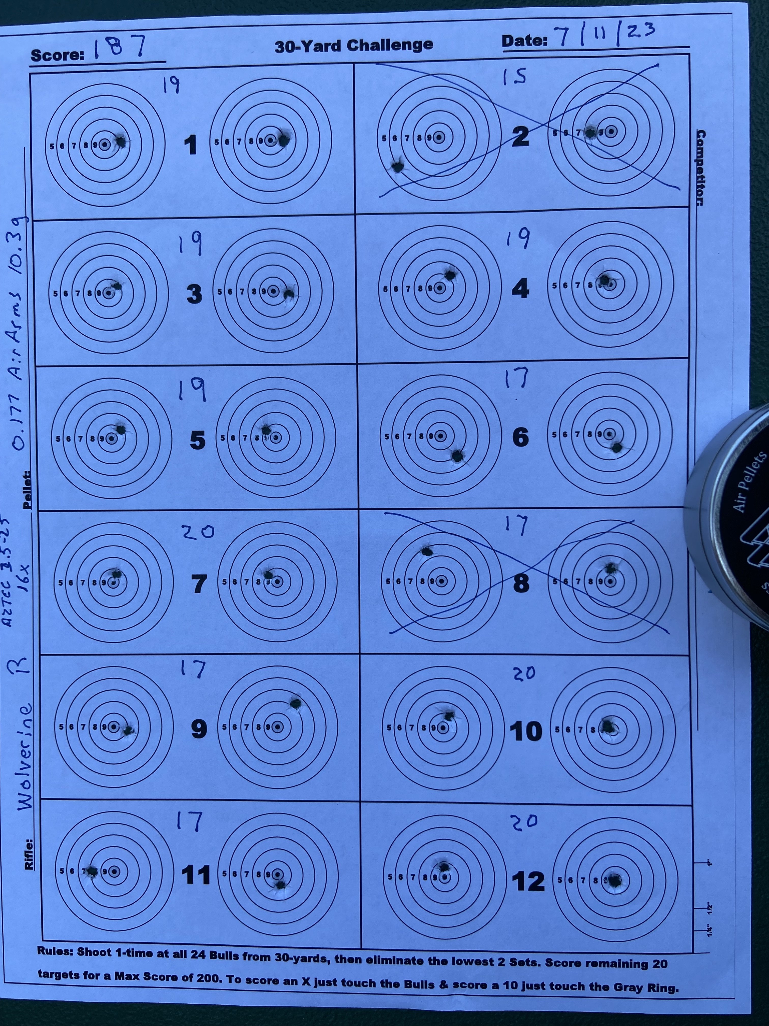

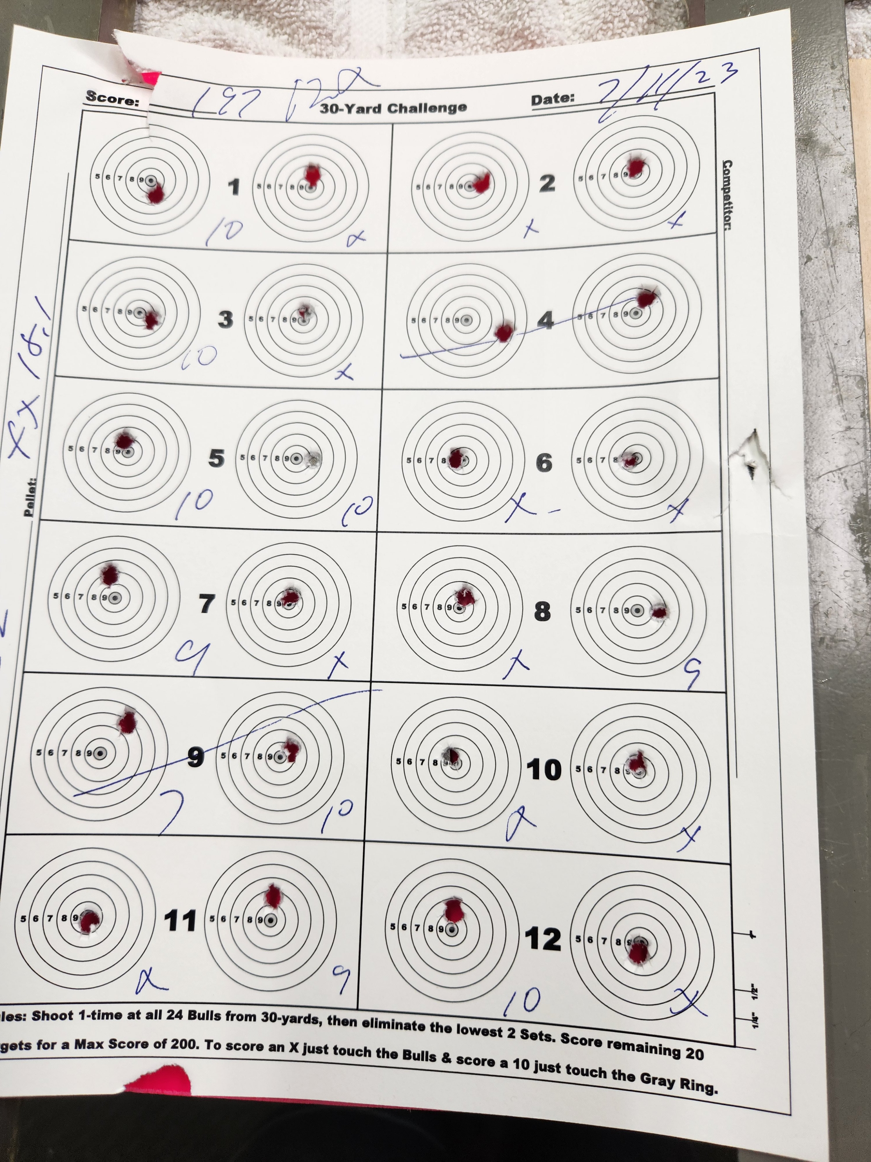

Here are my results. I shot the first target a few times to figure out where I needed to aim. I was using heavier pellets that I almost never use to help with the wind. Definitely can do a lot better on a calm day. And I know everyone is using .177 or .22 but my .177 isn’t here yet, so I used my .25 cal Wildcat MK3. Dreamline .177 will be here tomorrow. So once I get it all set up and shooting how I like I’ll be posting new results. This was a lot of fun. Great challenge for when I want to shoot but don’t have a ton of time to do so.

Wolverine R is a great rifle and you are using what I think is a great pellet.
187 is a solid score, this challenge is tough - especially with your max magnification of 16X. What is your trigger pull weight?
Keep at it, try to minimize pressure / forces that you are applying to the rifle. I’ve found that a lighter trigger weight (8 ounces or less) and a light hold helps. You are tryingnto hit a .02” bullseye at 30 yards. When you start shooting that Wolverine in the 190s consistently, you will notice that the 30 Yard Challenge has improved a number of things with your shooting.
-Ed

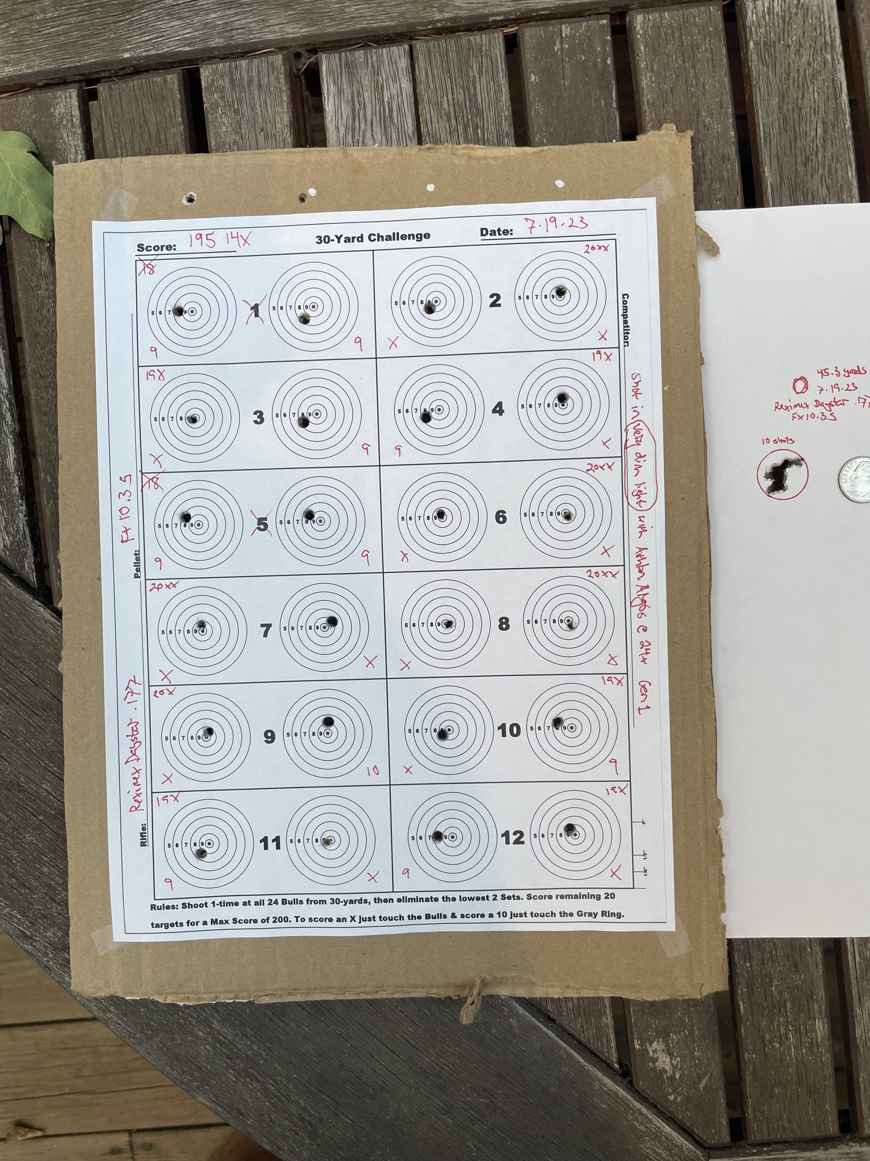

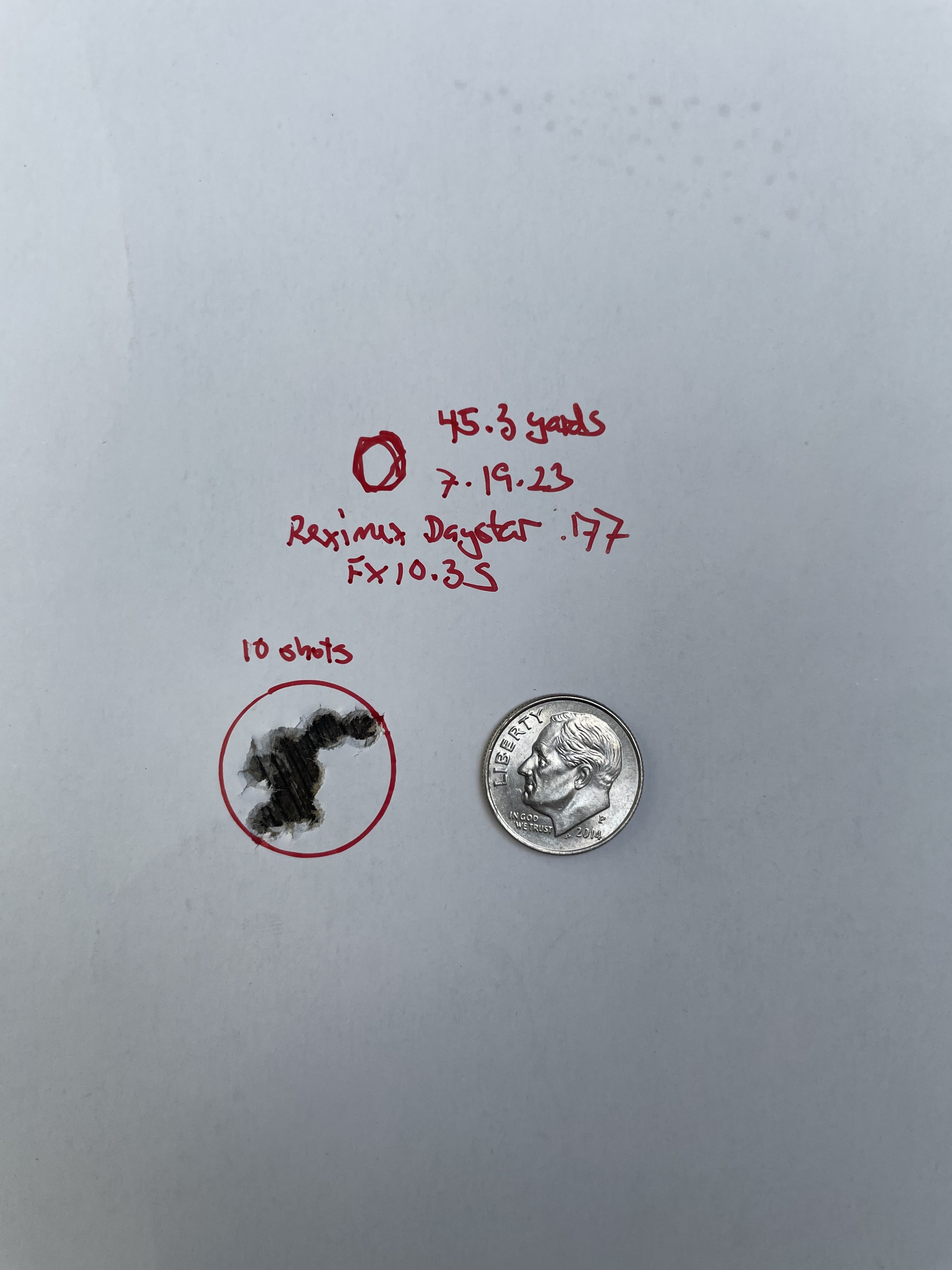

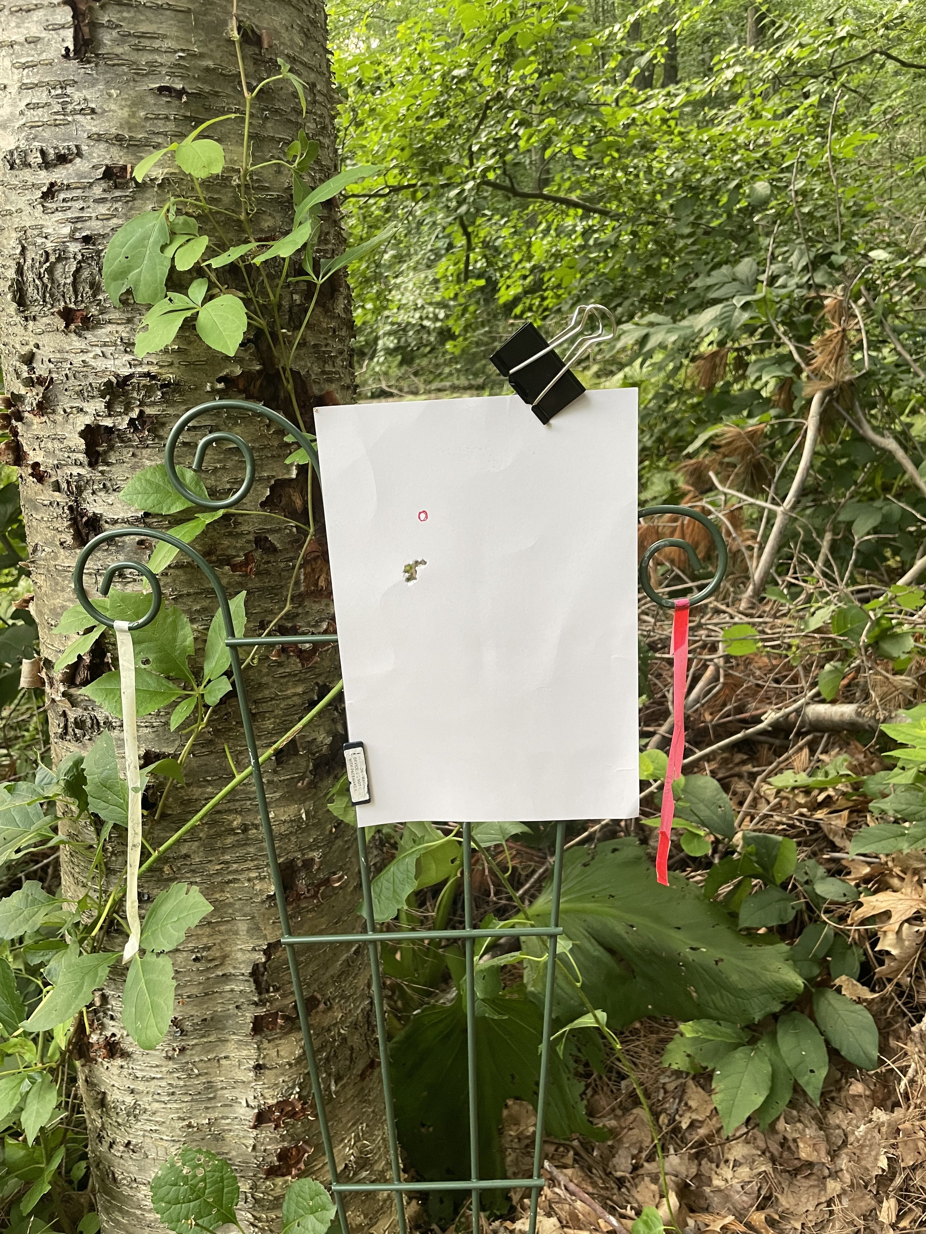

Perfect shooting conditions tonight.
I put a modest Athlon Argos Gen 1 on the Reximex Daystar and shot a 195 13X on the 30 Yard Challenge card I shot.
Then I wondered, what type of grouping would I get at 45 yards with little .177 10.3g pellets. So I shot this 10-shot group. Only group I shot (I’d rather shoot targets).
Damn, I’ve got this Reximex (essentially a .177 Cayden) shooting so damn accurately.
I’m happy with 10 shots under a dime at 45 yards with an inexpensive scope and $15 UTG rings, lol.
-Ed

Shot this in dim light with the Argos Gen 1 @24X on the Reximex Daystar. It sure was tougher to know where you were shooting vs. using a Sightron 36X target scope.
I’ll take 195 14X in dim light with my unregulated .177 laser - love this rifle! Bought it “used” off the AGN classifieds - it hadn’t been shot much and needed my usual polishing up, but it’s incredible now - keeps me from buying a .177 Huntsman, lol.
-Ed

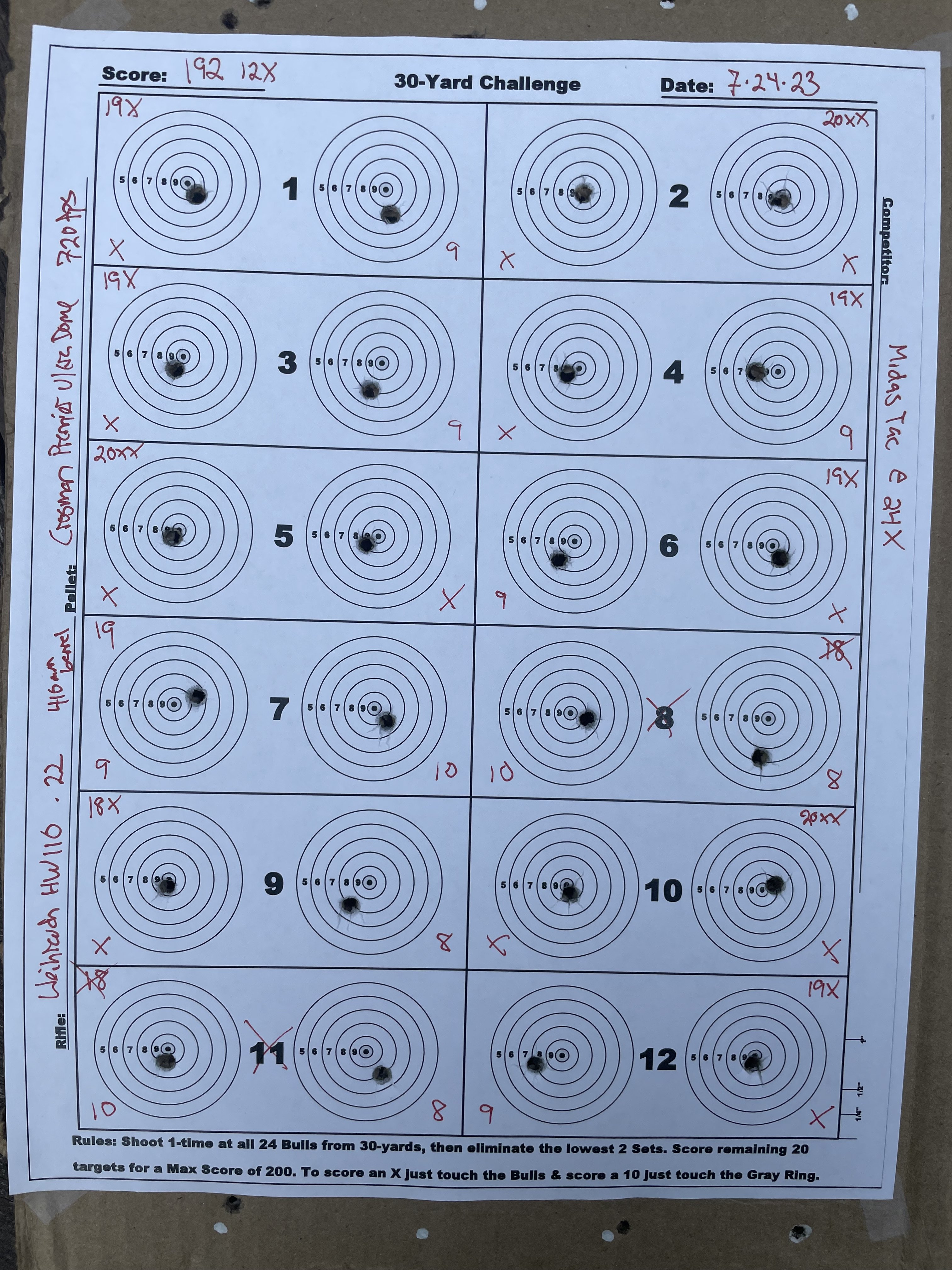

I’m very happy with my lunchtime card!
This Weihrauch HW110 .22 is the 2nd rifle that I’ve been able to top 190 with using Crosman pellets. (Umarex Gauntlet .177 shoots the Crosman 10.5g lights out - shot many 195+ scores with Gauntlet using them)
This was a 193 10X using Crosman Ultra Dome 14.3g at about 700fps. “Crosman Flyer” on Target #4 kept me from shooting maybe 195… but ya gotta expect Crosman Flyers shooting these cheap pellets straight from the tin.
Maybe now I’ll see if I can shoot over 190 with the HW110 and CPHP 14.3s…? Who knows, it may be possible, lol
-Ed

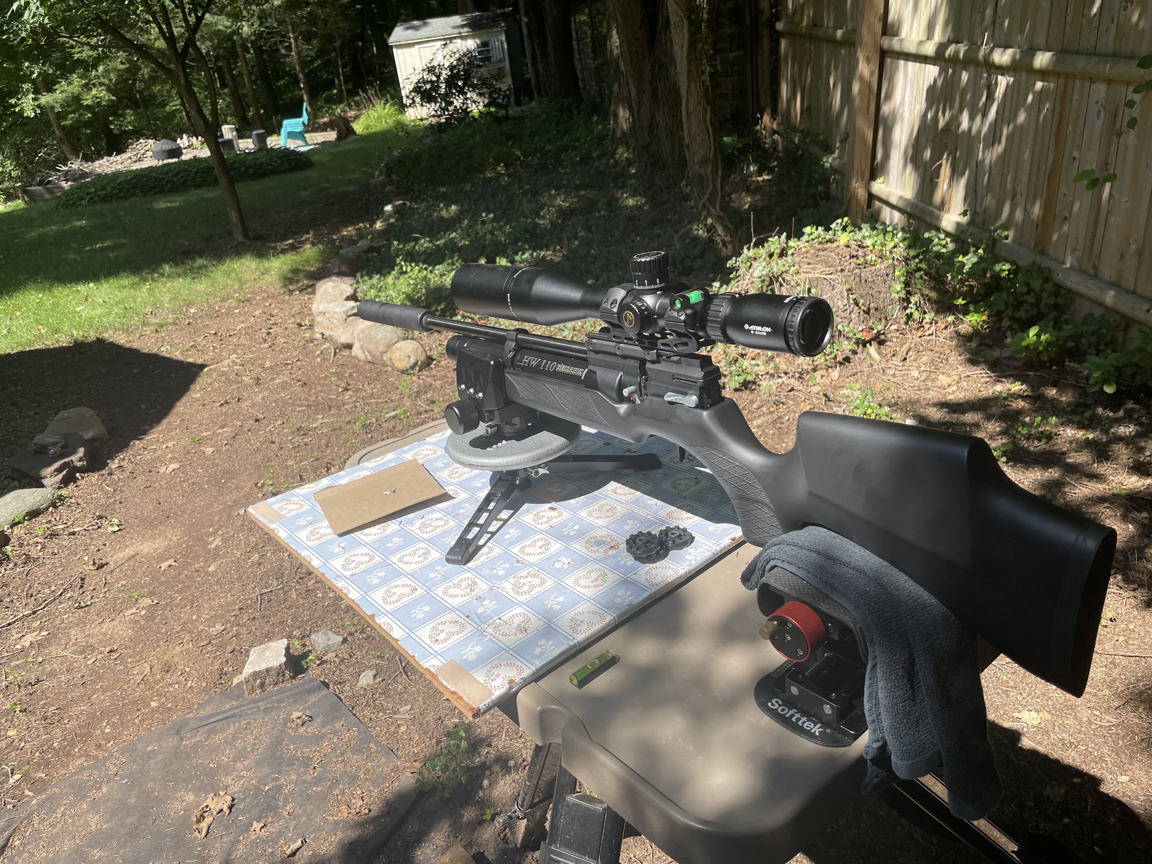

Very happy with my lunchtime card today…
Weihrauch HW110 .22 using Crosman Premier Ultra Domes 14.3g. Shooting at 720fps. So shooting a mild 16.5 ft/lbs.
192 12X - with no significant “Crosman flyers”, across all 24 targets, lol. Shooting the Crosmans straight from the tin as always.
I made an adjustment and the HW110 seems even more consistent with cheap Crosman 14.3s - note that there were no “7s” on this card.
The HW110 is close to silent at 16.5 ft/lbs, and its an awesome backyard rifle if it can keep shooting 190+ with Crosman pellets!
-Ed
