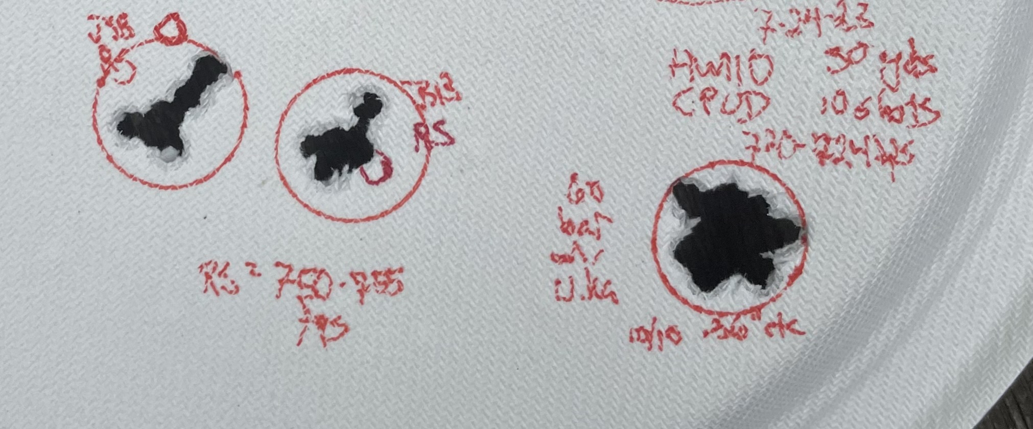

Hi TommyB,
Well, to arrive at the current 720fps I have done the following:
Changed barrel from 600mm to 410mm
Changed reg pressure from 150 to 90 bar
Installed UK spec hammer spring shuttle.
The UK spec (12 ft/lb) shuttle has a surprising amout of power. I bought it from a UK store at the same time I bought a FAC (US spec) hammer spring shuttle, so I know I have one of eash.
Both the US and UK shuttles have 6.25 total turns of adjustment. I’m close to max on the UK shuttle - I think I’m at 5.5 turns out - so less than 1 turn from max.
My HW110 is my most finicky rifle. It shot 18.13g JSBs best when using it the waynit came new - FAC hammer spring shuttle and 600mm barrel with reg at 150. At those settings I got 40 shots with the 18.13s at 830fps. It shot the 15.89s at 895fps. The problem was it would always throw flyers with that setup. It was frustrating because some groups and targets were outstanding, and then it would throw a shot 1/2” off.
I absolutely love the trigger on the gun, so I figured I’d detune it close to European spec - because perhaps it was “stressed” at 150 bar reg pressure. Its an absolute pleas to shoot, but I have not found a way to get it to shoot above 194.
I thought it might be the barrel, so I bought it the shorter (much shorter) 410mm barrel that comes on the European rifles. This barrel is much more consistent. The gun is also so nice and compact now.
I didn’t have the trigger guard installed, which allowed the action to be loose in the stock - I just reinstalled that this morning after months of shooting without it. I immediately shot 192 with the crazy Crosmans.
I bought it some JSB 13.45 RS pellets, thinking that is the weight they shoot in Europe with .22. I shot a few 193s and a 194 with them, but no higher. I’m going to try them again now that the trigger guard is in place and the action is not moving in the stock. If I don’t break 195 with the 13.45s, I will likely retune for 15.89s. No sense buying special pellets just for the HW110 if they don’t shoot much better than the Crosmans through the rifle.
I think the 15.89s are JSB’s best .22 pellet, so why am I not using them…? I was hoping for a super accurate lower power tune that would get me 90 shots on a fill with the lighter weight pellets. I almost got there, but still can’t consistently hit 194-197…
-Ed

Ok TommyB, I’ll stick with this tune and see if I can break 195.
With this 16.5 ft/lb tune and the reg at 90 bar, it comes off the reg extremely gradually. I have run shot strings of 120 shots that are all usable - below 30 fps spread - incredible from the tiny cylinder.
I wasn’t sure whether to keep trying to find a “better” tune - perhaps go towards 14 ft/lbs…?
I think the Europeans shoot .177 and 8.4g pellets with these rifles, so that they can get around 800fps with their 12 ft//lb restriction. Since we are shooting .22 with no restrictions, I think my 16.5 ft/lbs is a similar tune to their .177 tune - as it shoots the 13.45g JSB RS pellets at 755fps.
Perhaps sometime we can do a call and discuss these HW100/110 rifles? Lots of thoughts. They get rave reviews in Europe and yet its my lowest scoring gun in this challenge.. even my miracle Umarex Gauntlet shoots 198 - with Crosman 10.5g, lol.
-Ed

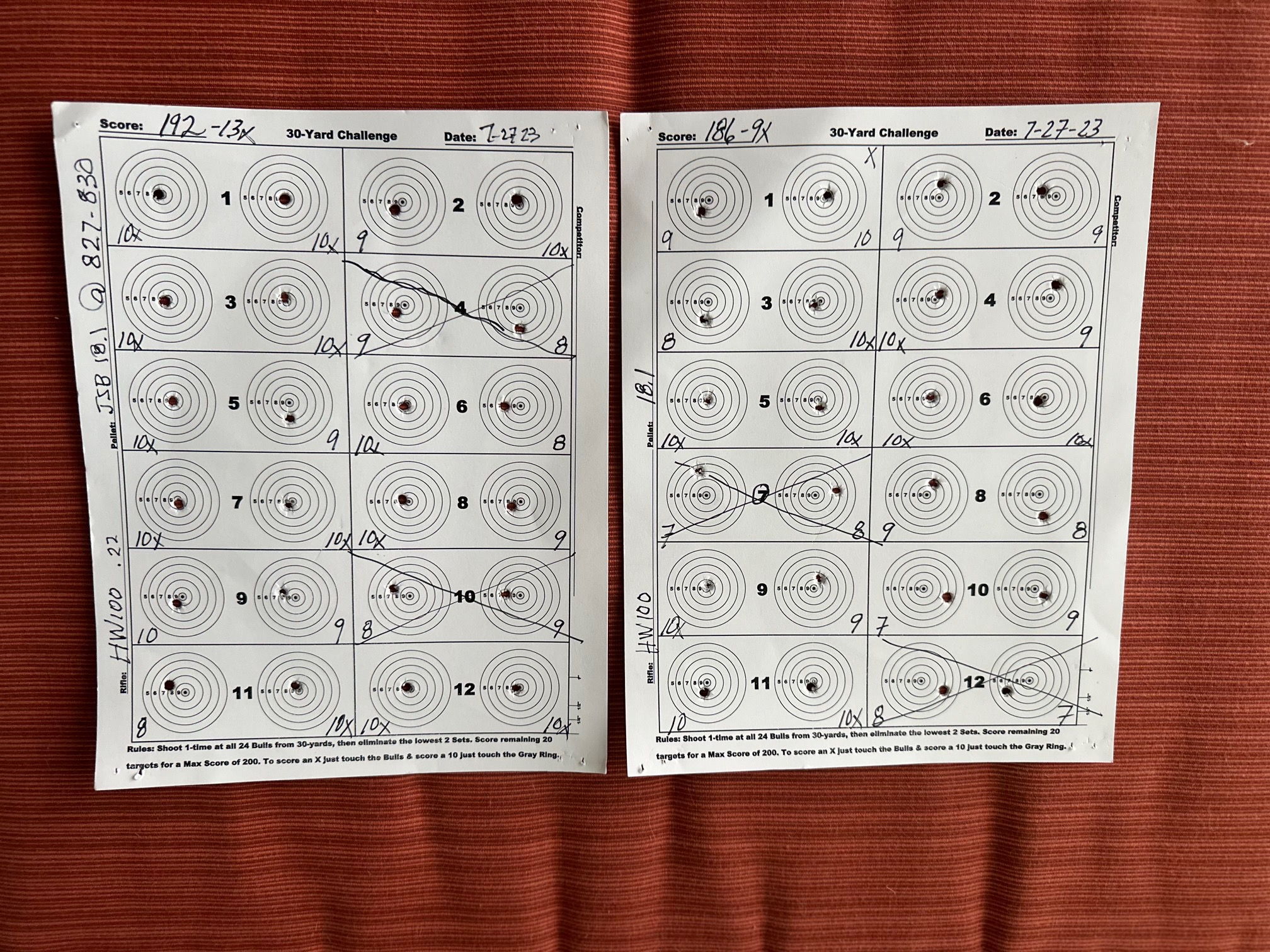

Finally got back out to the outdoor range this morning, before it got too hot here in NC.
I shot (4) 30 yard challenge cards; two with the RAW HM1000x .22 and two with my Weihrauch HW100 .22 caliber. A couple of observations on each platform:
RAW .22 is probably my most accurate air rifle in the safe. I decided to clean it with patchworm yesterday, and I am glad I did. Normally, I get two patches with visible lead sediments, and then a couple more wet patches with some black, then two dry patches and the rifle is good to go. Yesterday, I actually got "5" patches with visible lead sediments. I was using a 1 & 1/4" circle patch and it was coming tight through the barrel, so I know I was getting some lead out with the Gunzilla. Shot a 198-15X and a 200-15X, which I will submit for this cycle. I was 'purposely' taking my time between shots and trying to be patient on the wind. It did pay off today. Wind was 2-4 mph, and 0-2 mph at times; tried to shoot when flag was a bit more still. Had a tail wind.
HW100 - Shot (2) cards and wind started picking up one hour into my session. Nothing big, 2-4 mph, tail wind and R-L and L-R at times. My first card was a 192, but the second card ( 186) I admittedly was rushing as I had to pee. Lol... I have a Sightron 3-16X 42 FFP, which is a good solid scope. But, at maximum magnification at 16X, it was difficult for me to judge my holds. As I recall, I was holding between the 10 and 9 ring at 1 o'clock, 3 o'clock and switched back to 7am between 9 and 10 rings. Was having some difficulty with the wind ( had one flag at 6 yards from muzzle ). I am shooting at approximately 825 fps, with the JSB 18.1 pellet.
Minor edit on HW100 - As Ed knows, I have been all over the world on trying to identify optimum velocity for the JSB 18.1 with this rifle. I have chrono'd everything from 775 FPS to 850 FPS, with various ES spreads ( mostly too big ), but I am now at 825 FPS @approximately 115 on the regulator. B4 I left today, I wanted to zero at 30 yards and I shot ONE 5-shot group ( seen in picture below ). .224" CTC, essentially a ragged hole at 30 yards. But like Ed, I may experiment at some future point with lowering my HST back into the low to mid 700 - 750 range and try the Crossmans and get a better shot count. Why would I do this, I have no idea!! Ha Ha, thought you would like that Ed! :)
Next outing with the 30Y challenge the FX Royale 400 .22 with my Leupold 6.5X20X40 EFR duplex reticle goes up against the Revere .22. This should be good.
Tom

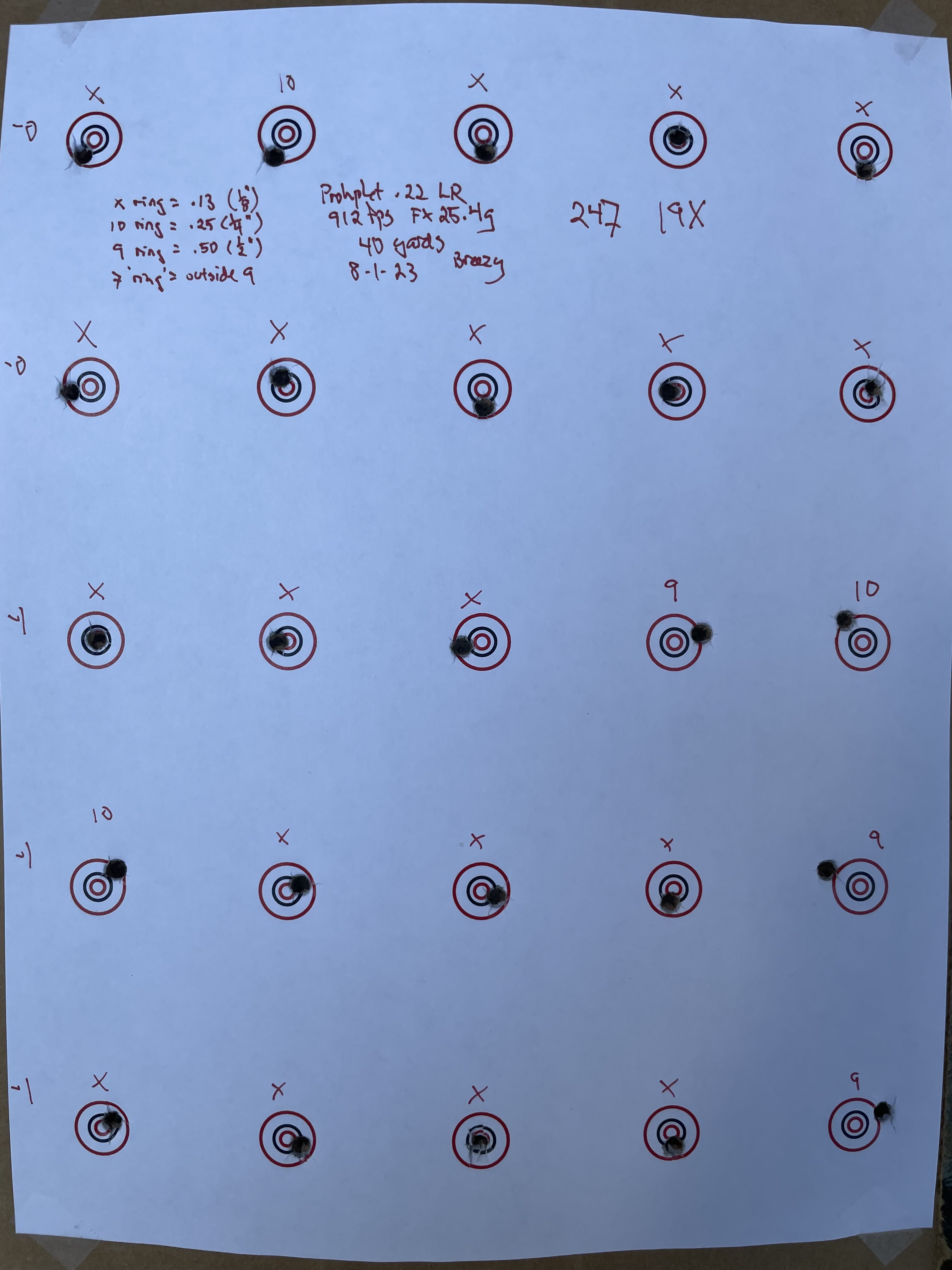

I’m very happy with this, thought I would share here…
I cooked up a “40 Yard Challenge” for myself. .13” (1/8”) X-ring, .25” (1/4”) 10-ring, .50” (1/2”) 9-ring. Any shot hitting outside the 9-ring scores as a 7.

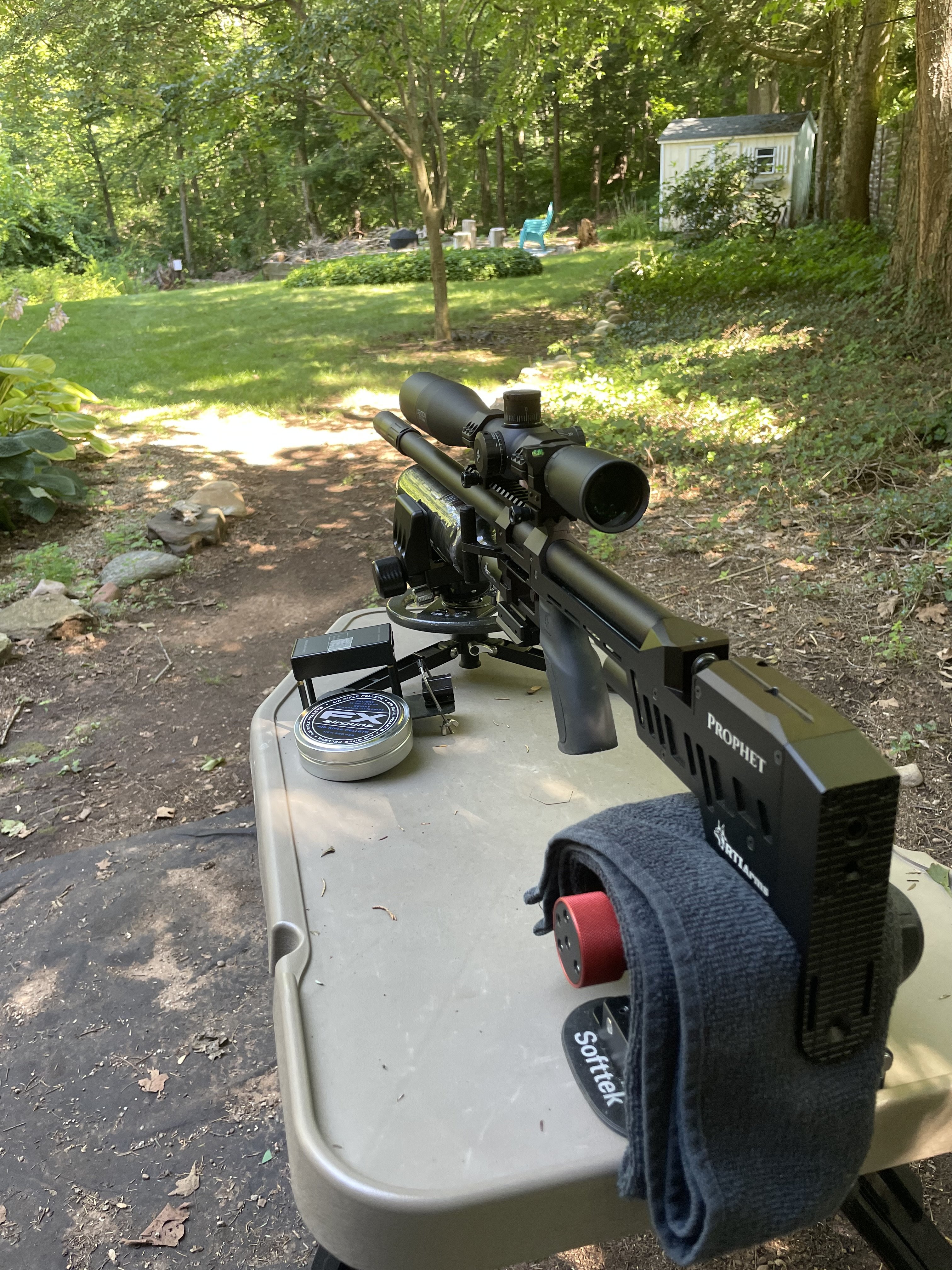

Today is the 1st card shot with my RTI Prophet Performance V1 .22. Its set up for 100 yards - shooting 25.4g MRDs at 912fps. So I thought I’d see how my 100 yard “tune” worked at 40 yards (laser measured from front of bench to a millimeter)…
In breezy conditions, I shot this 247 19X ! Straight from the tin as I always do with no sighters once the card starts.
My previous best was 241 15X with a Daystate Huntsman Regal .22 with AA 15.89g.
I shot a 5-shot group prior to the card at 45 yards and it measured .23” ctc - so it seems 912fps is a good speed for the MRDs - reg is only at 120 bar.
I’ve got .25 and .30 barrels for my Prophets when shooting 100 yards - but perhaps I’ll give the .22 MRDs another try at 100.
I spaced the targets far apart on this 40-yard challenge card - as moving the rifle aim point quite a bit between shots seems to add to the challenge.
-Ed

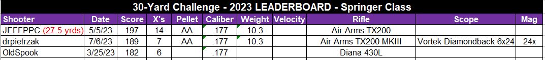

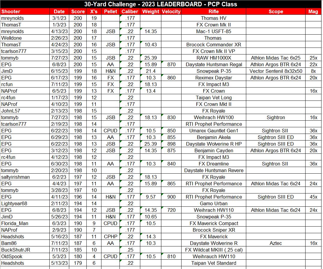

LEADERBOARD UPDATE:
Shooters, the last leaderboard update was posted in April - Page 65 in this thread.
I’ve gone through page by page and believe I’ve captured all leaderboard submissions in this update. If I missed any, please let me know. I even guesstimated the number of “X”s for submissions that didn’t include it.
In the spirit of AGN information sharing, we have expanded the leaderboard data to capture additional information regarding pellet type, velocity, scope and magnification used. If you have this info from previous submissions, let me know and I’ll update the board.
The objective of this data is to help fellow shooters “tune” and setup their rifles to maximum accuracy at 30 yards.
Rules for Thirty Yard Challenge (TYC):
.177 or .22
.25 if it's all ya got… “unofficial”, lol
.30 or bigger - go shoot some elephants…
If your rifle has both .177 and .22 barrel kits, you can submit for each caliber.
30 yard distance is measured from front of shooting bench. You are trying to hit a match head sized bullseye at 30 yards, so a couple yards matters - measure your distance accurately.
Scoring is with a .22 scoring plug. If plug touches edge of scoring ring, you score the higher ring.
There is a scoring plug available at Freeland Sports if you don’t have one. The one I use (also available in .177):
Another option from Freeland:
If ya got a springer, dust it off & shoot a TYC card and submit results. 30 yards is a great distance for springers - challenging. We need more springer results.
Finally, yeah I shot a 198 with a Gauntlet Gen 1 using Crosman 10.5s straight from the tin, lol. Shot 196, 198 and 197 consecutively. Have not shot it since. Felt like the Priest in Caddyshack that day - perfect round. Feels good to see it on our leaderboard!!
If you have suggestions, let me know.
-Ed
