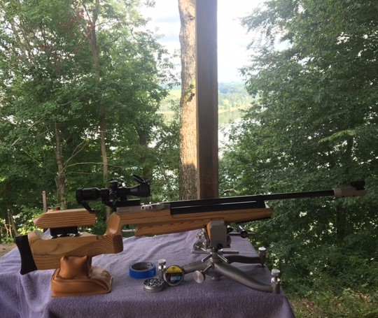

no wind , hold dead on , rested , look at bubble level , all looks good ! take up first stage ,exhale 90% , exhale last 8 percent release second stage trigger , inhale ,hold position 5 seconds . remove rifle from rest , cock and load, set back and position for next target. I know Boring !!!
my range is part way down an embankment so no wind mostly , the first half of my range in under the screen porch outside the basement

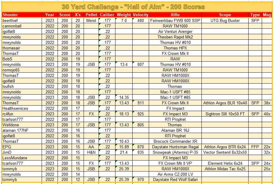

I like the "Hall of Aim" addition Ed! About evenly split between .177 and .22 calibers achieving 200 scores. I think 14 .177's and 15 .22's, if I counted correctly. A lot of good data compiled here for background, which is helpful for analysis.Weekly TYC Leaderboard Update

Notable is that beerthief achieved this result with 7g flathead .177 target pellets at a modest 480fps velocity. He showed an excellent front and rear rest, and mentioned his breathing technique as part of the overall consistent “rhythm“ he applies to each shot. Also interesting is that because his rifle is a single stroke pneumatic (SSP) vs. the more modern pre charged pneumatic (PCP), he must remove his rifle from his rest and cock it between shots - putting even more demand on the setup for each shot.

i think it is also the wadcutters flat head cuts such a clean hole , there is no doubt where it lands . just bought Norma match .22 flat head and H&N sport .22 in flat head .I like the "Hall of Aim" addition Ed! About evenly split between .177 and .22 calibers achieving 200 scores. I think 14 .177's and 15 .22's, if I counted correctly. A lot of good data compiled here for background, which is helpful for analysis.
I tend to agree that maybe slower is better for this 30 yard challenge. Or, at worst, it doesn't stop anyone from scoring a perfect score with a relatively low velocity compared to much of what we see on the forum.
I saw that Beer Thief removed his rifle after each shot to cock it, and now this becomes even more amazing to me! I still cannot get over how exact/perfect each of those shots are on the X ring.

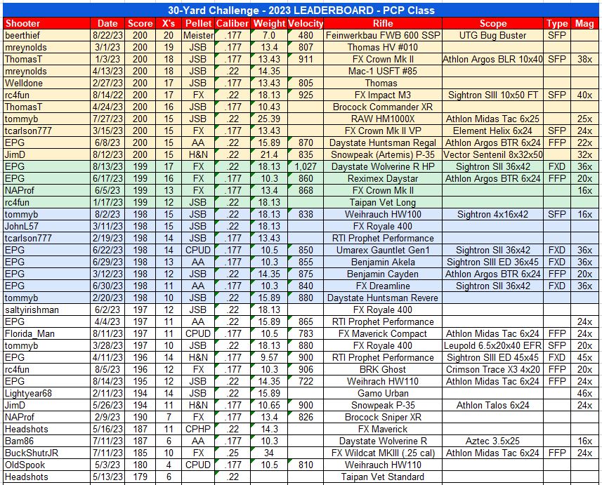

Great target, it would be great if you could score it by eye - then I can add it to the leaderboard.
Once scored, I will add it to the PCP leaderboard, as your SSP air rifle is pneumatic - kind of a single pump PCP. Its not a spring piston rifle, so I think it fits better with the PCPs.
It would also be great if you could provide Pellet Brand, weight and velocity. Also cool would be if you could provide the Scope brand, model and magnification you used while shooting the target.
It looks like Targets 1,5,6,8 and 10 are the only possible 10s (depending on how you choose to score it). In any case, it looks like you score 200 - just the number of bulls (Xs) is up to how you score.
When you get a scoring plug, we can always update the score you provide.

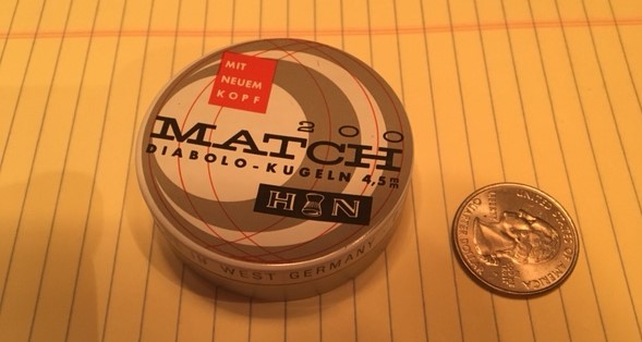

thankyou the pellets i used were manufactured by H&N in 1970, i sent this picture to H&N and they replied . I bought a sleeve of 10 cans at Midwest showHello @beerthief
