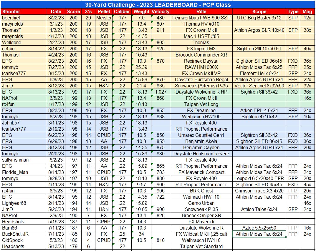

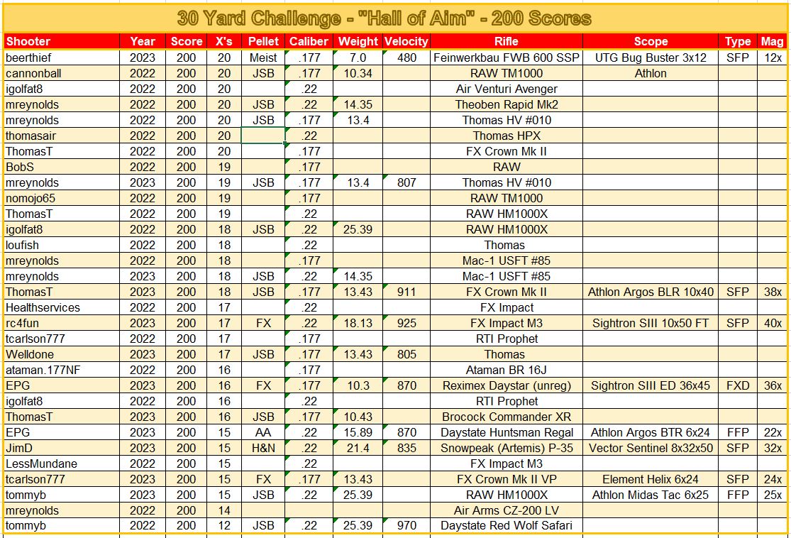

Weekly TYC Leaderboard Update
This week’s submissions were both by EPG (that’s me, lol)…
  • 200 16X with Reximex Daystar .177 unregulated
  • 198 16X with FX Dreamline Classic .177
The 198 with the Dreamline ties my previous high with the rifle - but has more Xs.

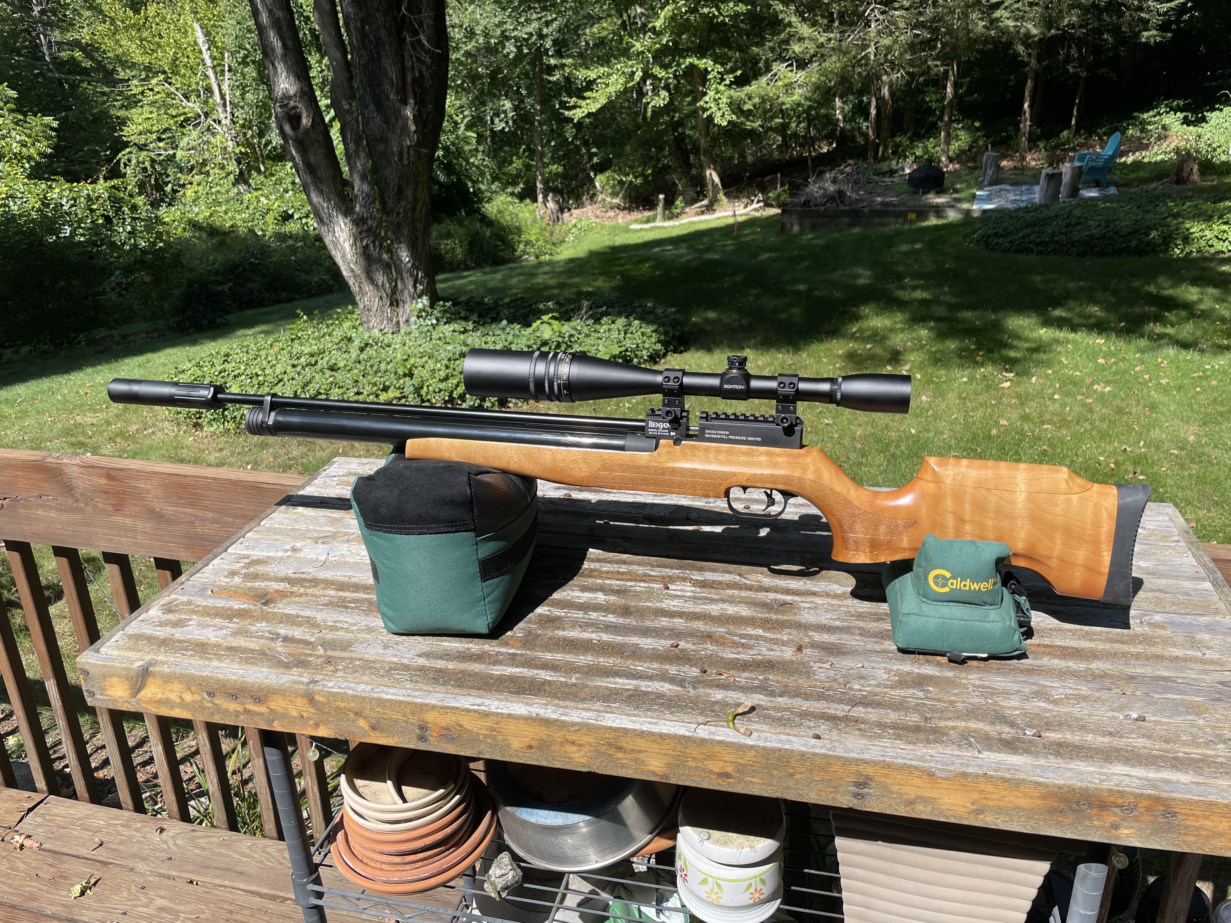

Thought I’d share my recent Benjamin Cayden tuning experience - perhaps it can help others…
I’ve shot as high as 198 with this Cayden. It likes H&N Baracuda pellets more than JSB.
Current mild tune has the rifle shooting Baracuda 15s at 835fps, 18s at 785fps and Baraduda 21.14g at 735fps. All three pellet weights will group consistently around 1/4” at 30 yards.
I recently tore down the Cayden to polish the hammer - polished it to a gleam as well as polished inside the hammer where the hammer spring slides, polished the hammer spring itself, etc. The velocity is very consistent shot to shot. I’m using a 2.75” hammer spring (rifle is massively oversprung with 3.5” factory-length spring).
Even after polishing, rifle was still shooting 190 (4 190s and 2 186s across six TYC cards).
Interestingly, the vertical on these 190 cards was very good- the misses were all horizontal left and right of the bull.

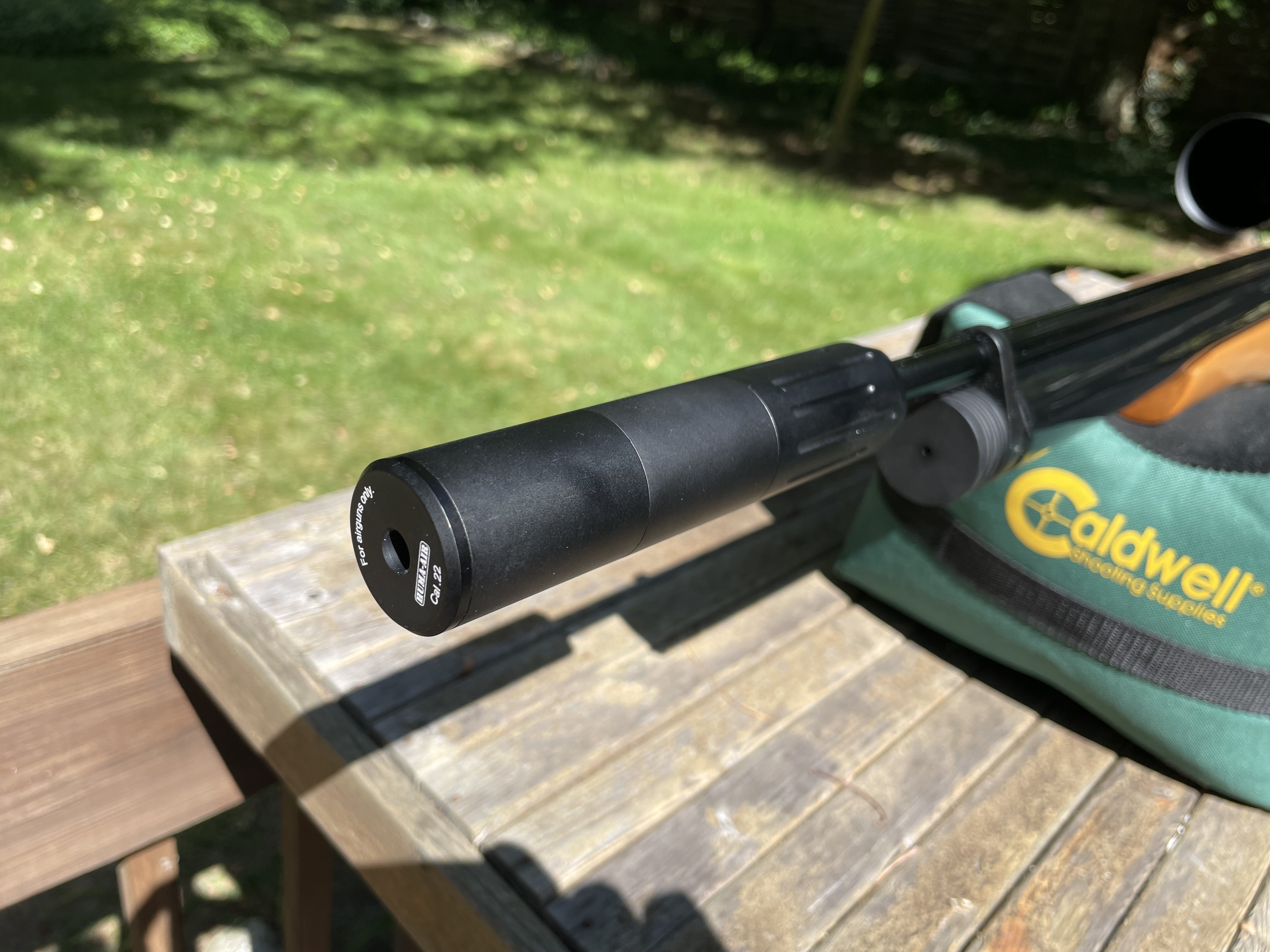

So, I thought I recalled that I used to use a different moderator on the Cayden… I swapped on a Huma Mod30 (using just 3 sections) and PRESTO - 195 12X on the 1st card with this moderator!
Has anyone else experienced something like this - where the moderator appears to have a significant impact on a rifle’s accuracy?
-Ed

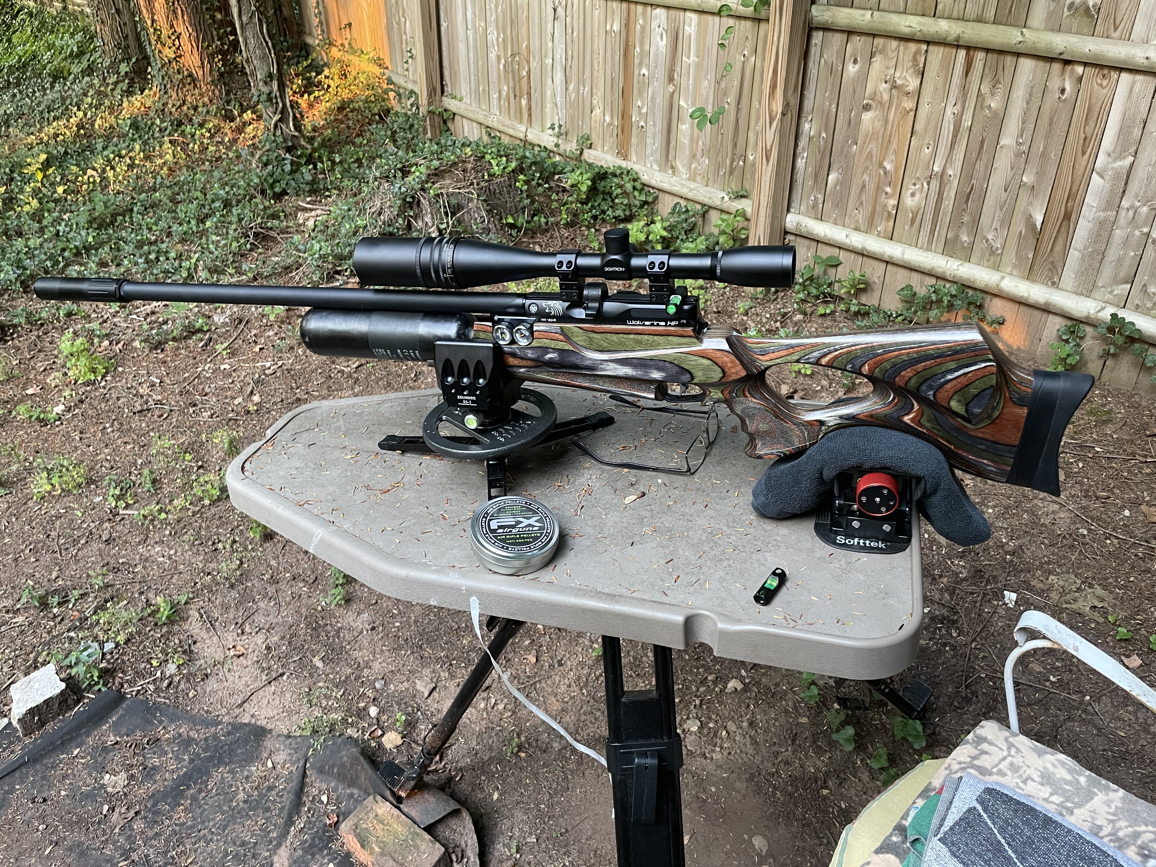

Shot moments ago in dim, fading light…
Leaderboard submission:
200 16X
with my Daystate Wolverine R HP
FX 18.13g @ 1,025 fps
Sightron SII 36x target scope
This is my first 200 with a regulated rifle, lol - the other two 200s were with unregulated rifles.
Note the typical EPG lost concentration on the last target pair #12 - I was pretty certain that I’d already shot a 200. I’ve had 4 199s and a 198 with the Wolverine on about 12 challenge cards - the thing is incredible.
I think I can get 200 20X eventually with this rifle, its that consistent. I had not shot it in at least a week, took 3 sighters to confirm zero and then these 24 shots for a 200.
Gonna treat myself to a work night bourbon now !!

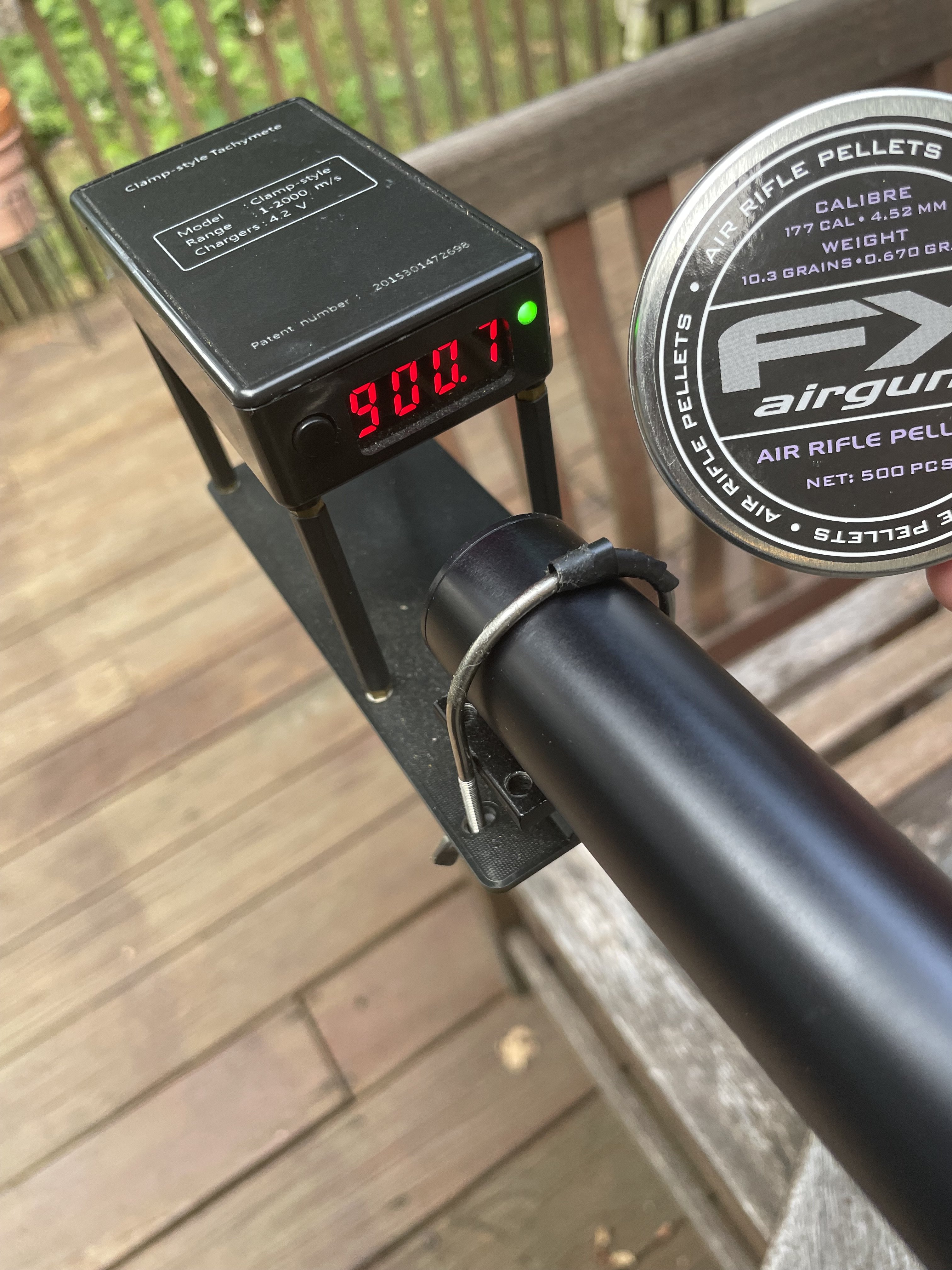

The 198 13X with the Dreamline is the story. I had been experimenting with the Dreamline at 12 ft/lbs (720fps with 10.3g). It could shoot very small groups at 12 ft/lbs but scored 187-190 in the TYC. I was getting vertical up & down misses. I think you really need to weigh your pellets if shooting low power like 12 ft/lbs.
So, then I took the stock off, turned in the hammer spring two full turns. Velocity was 901 fps. Thought I’d try that -higher than I’d been using the Dreamline.

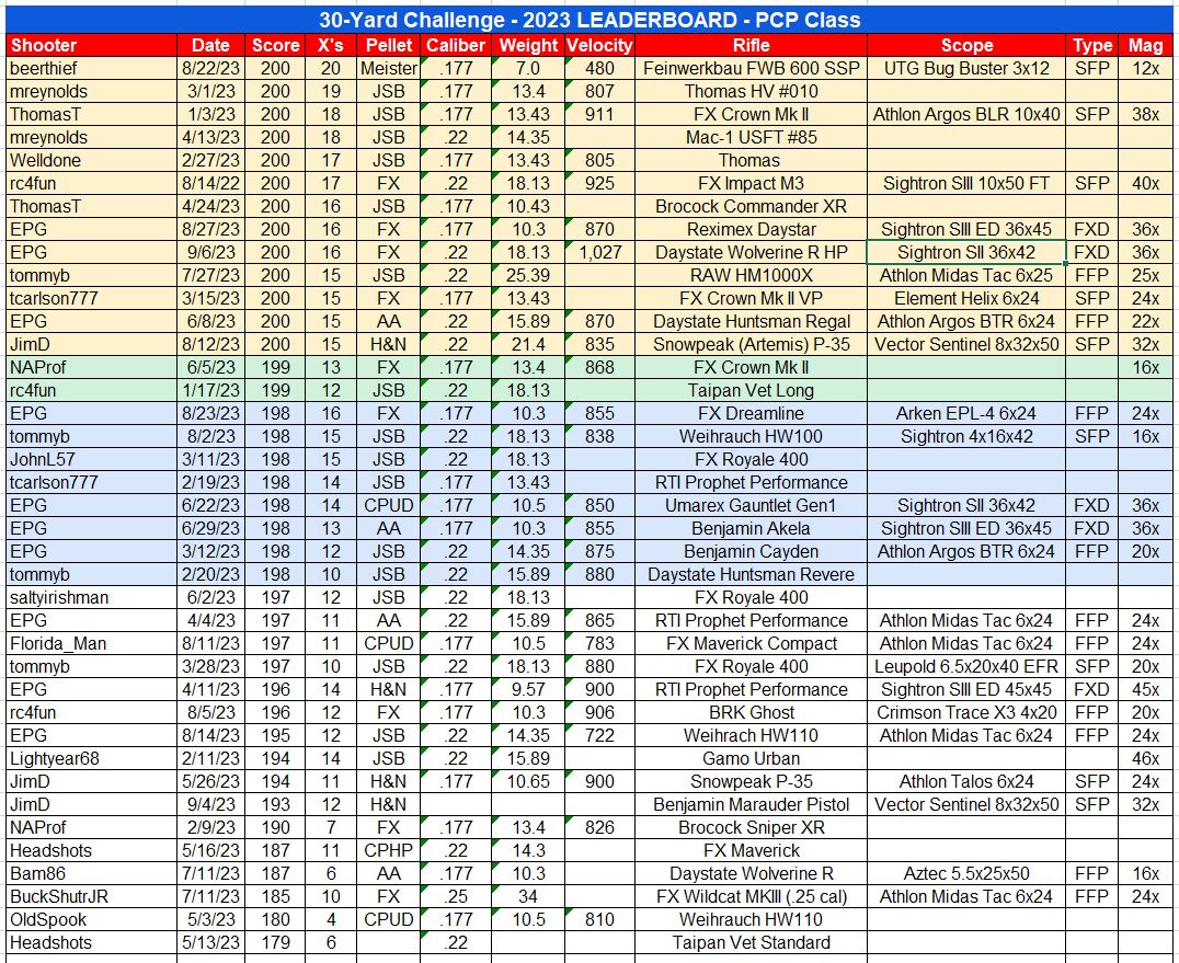

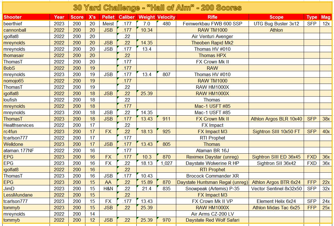

This week’s submissions and notables…
  • 200 16X - EPG with his Daystate Wolverine R HP .22
  • 193 12X - JimD his Benjamin Marauder Pistol
  • 200 20X - Beerthief does it again - another perfect card with his ancient Feinwerkbau SSP rifle (which he needs to sell to me when he gets bored with it)
  • 191 9X - Florida_Man braves the wind shooting during Hurricane Idaila
  • 198 13X - EPG stays out in a thunderstorm to finish a card he thought could might be a 200 with his Dreamline…
Keep up the good shooting !
Not rain, sleet, heat, wind or lightning should get in the way of our relentless pursuit of 200!!
