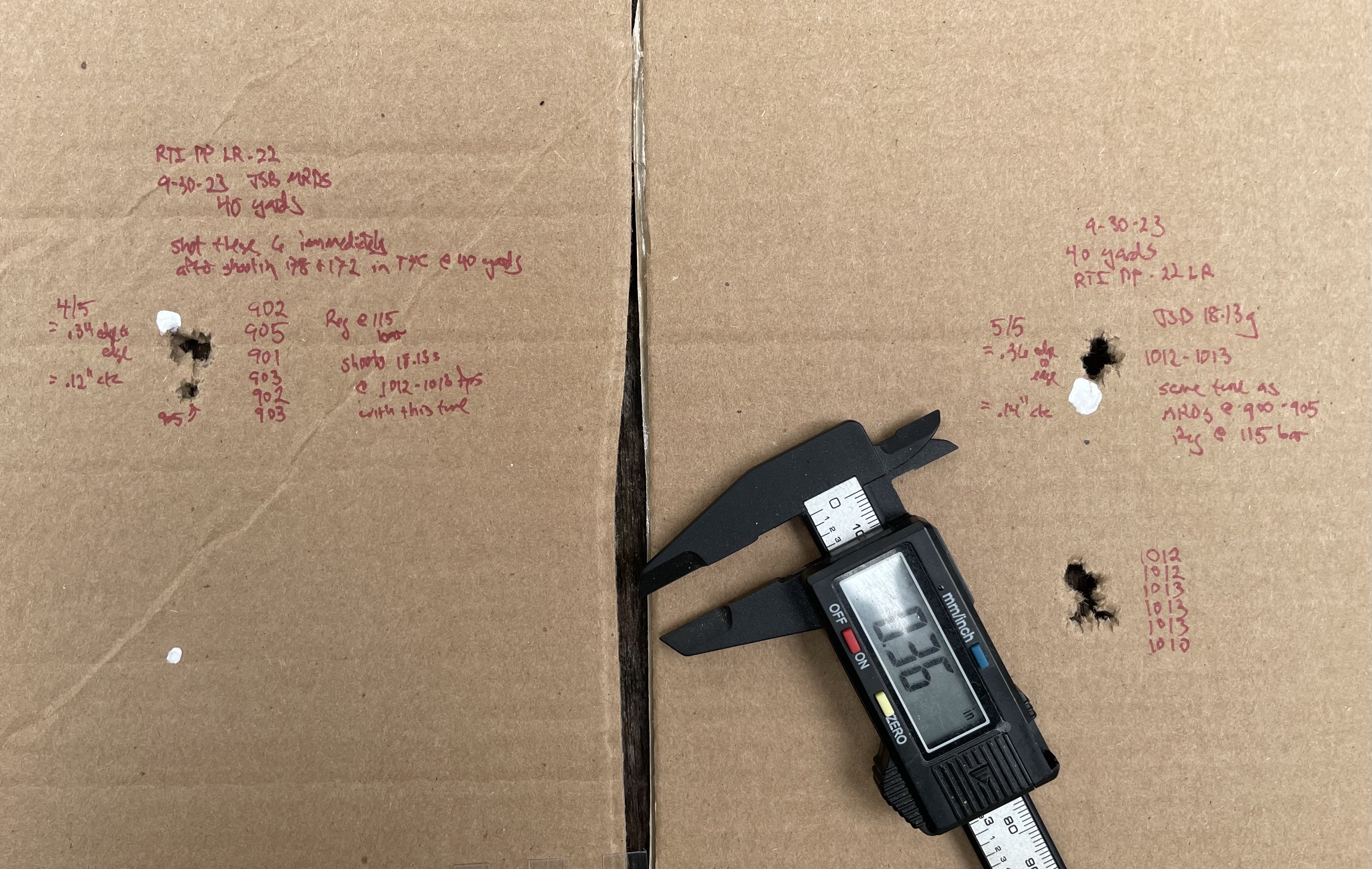

Used MRDs @ 900-905 fps for the 1st two cards and shot 178 5X and 171 3X. I was hungover from too much bourbon, but I was surprised at the low scores.
I then immediately shot two groups @ 40 yards and they were great - .12” center to center for 5 of 6 shots - but one shot dropped low (even though it had the highest velocity of the 6 shots). So the MRDs were a bit inconsistent at 40 yards, even though they grouped excellent.

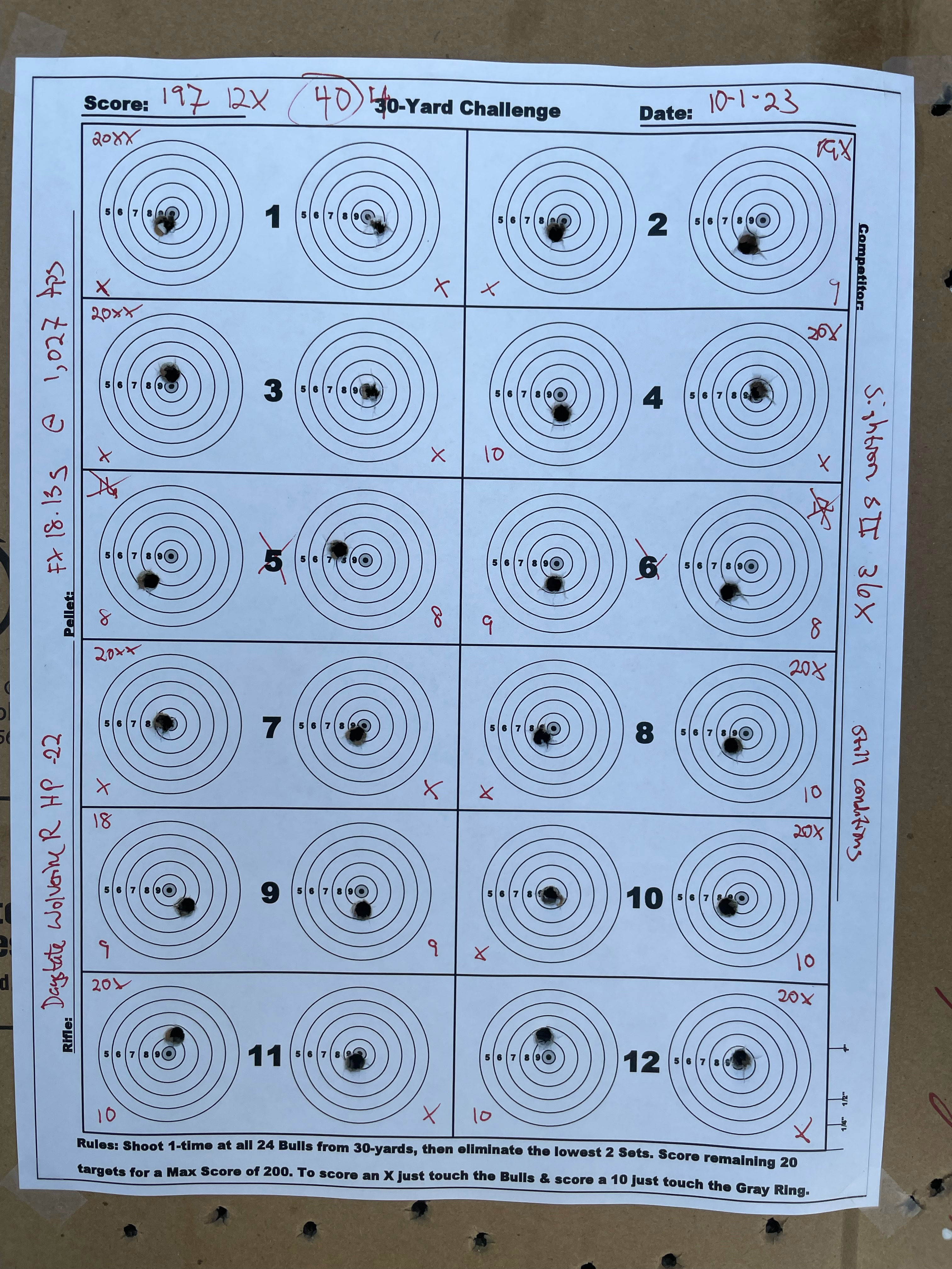

My last two cards of today I shot the Daystate Wolverine R HP .22 at 40 yards:
189 9X
197 12X (!)
Using the usual FX/JSB 18.13g that I feed the Wolverine - 1,025 fps.
DAMN!! I was not expecting to shoot a 197 at 40 yards - at least not yet. Wolverine is absolutely amazing shooting 18.13s at that high velocity.

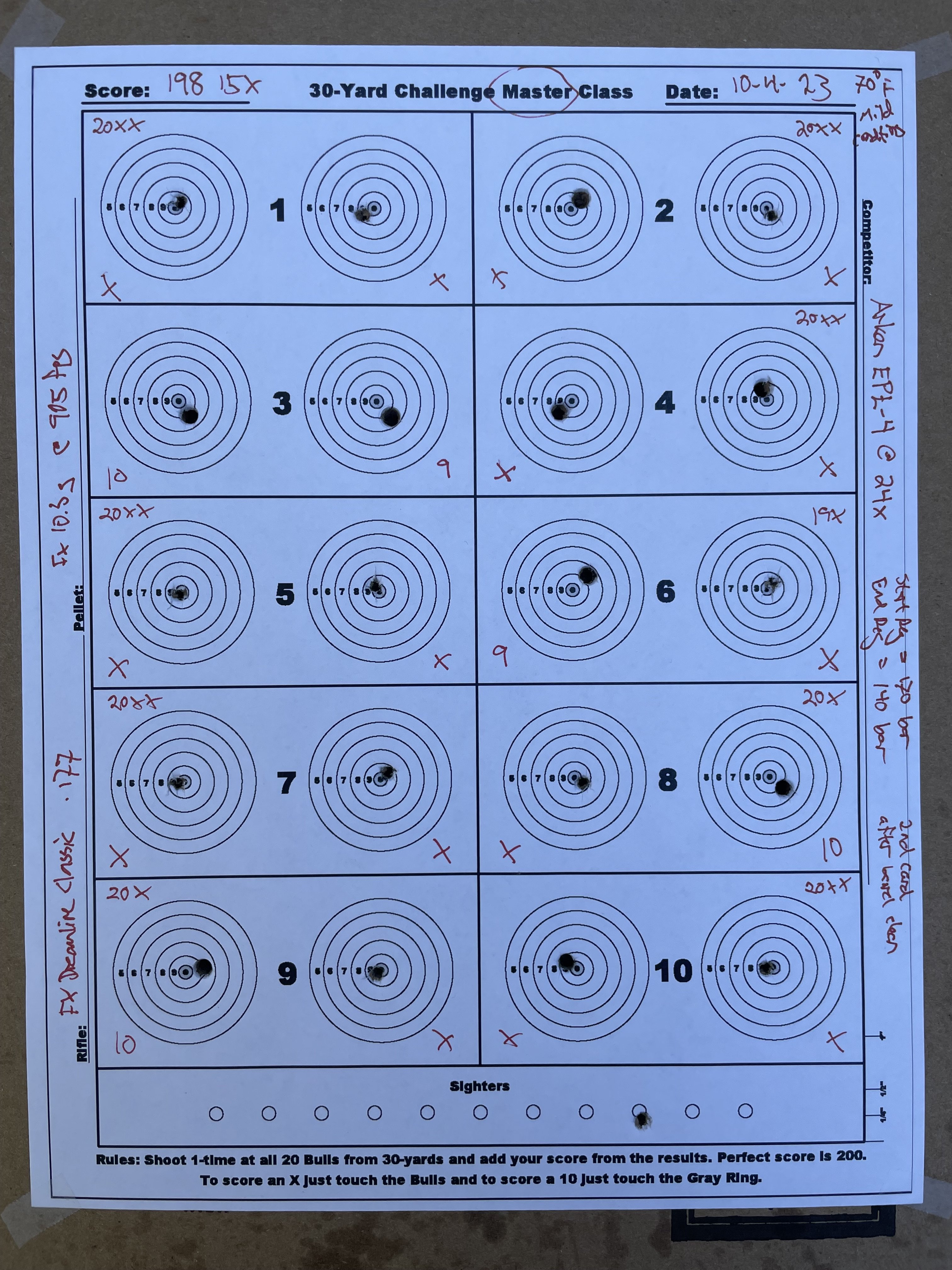

Was shooting this challenge at 40 yards today - even tried the .177 Dreamline at 40 yds. It was too breezy for .177 - especially for the 2nd half of the card - shot a 180 6X.
So then I rezeroed the Dreamline at 30 yards (4 shots to zero) and shot my 1st “Master’s Card” - notice that I didn’t even shoot any sighters - 20 straight shots. I was thinking “hey, maybe a Master’s 200” until Target pair #7 - felt myself pull that one slightly. Light was getting dimmer (see photo) and the breeze died down from earlier in the day and…
196 16X !! I’m really happy with that for my 1st time shooting a Master’s Thirty Yard Challenge card.
For fellow Dreamline users, my reg is 95 bar and pellet velocity is 907.2 fps. This Dreamline has been awesome shooting 10.3g at about 905 fps.

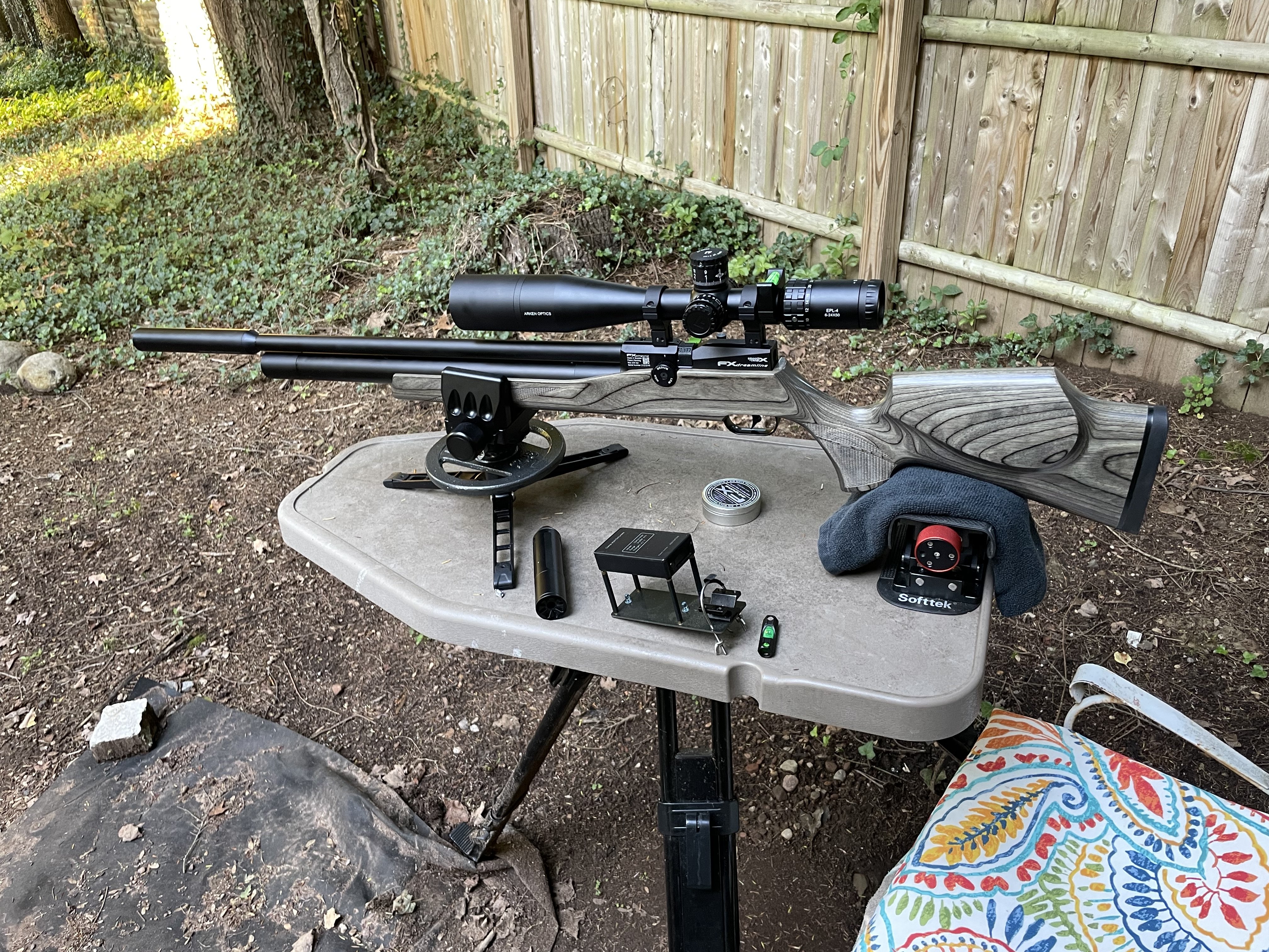

I got serious about dialing in the .25 Prophet Performance today…

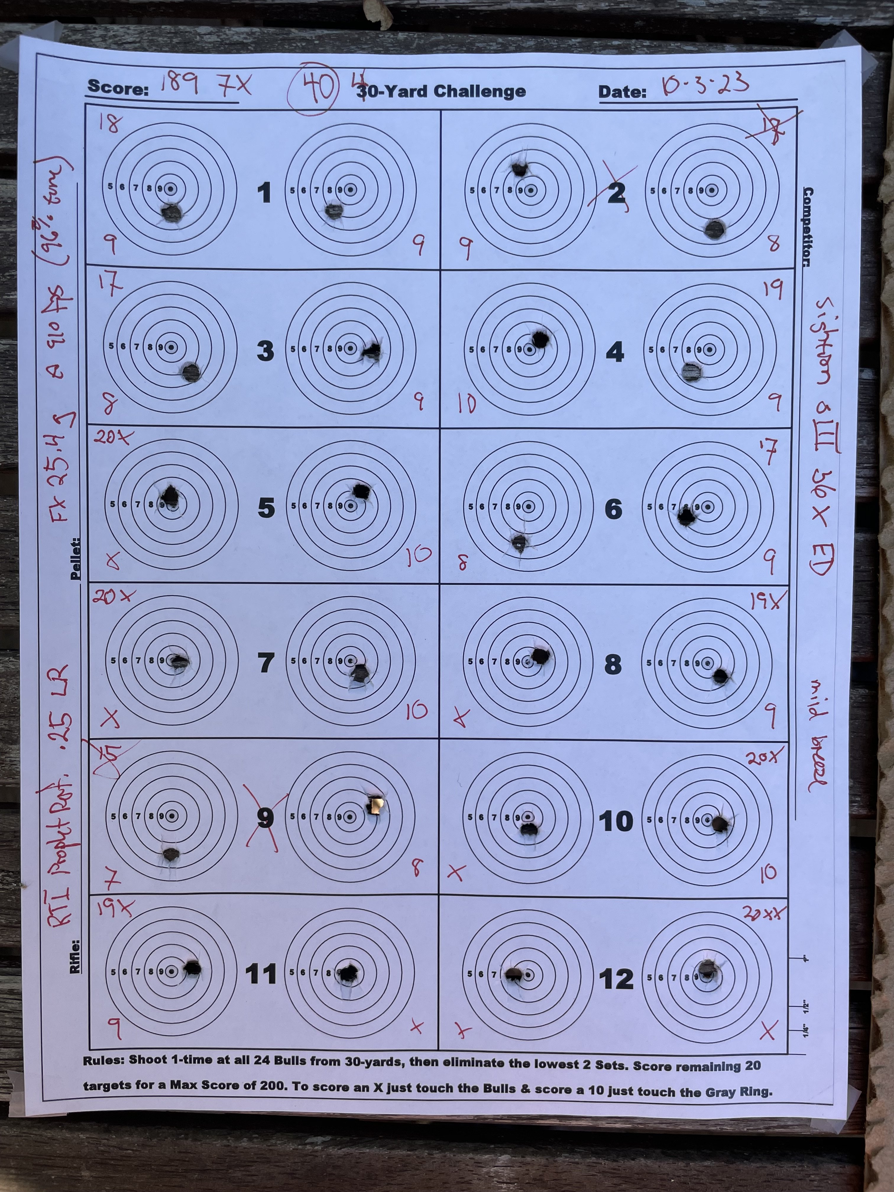

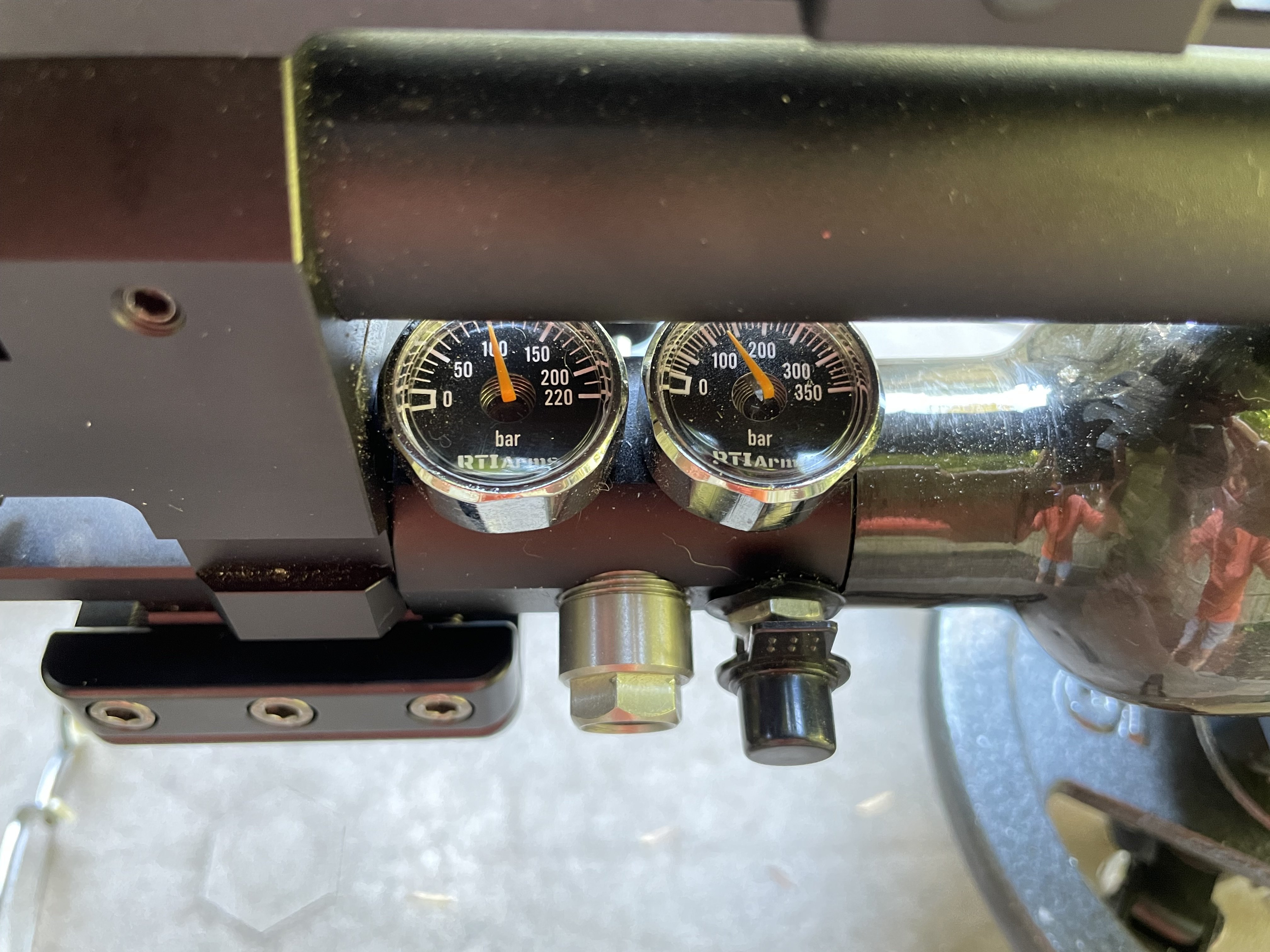

Tuning method and data: I am using the stock RTI V1 hammer (36.5 grams) and stock hammer spring - WITHOUT the delrin spring guide spacer. The spacer is not necessary to achieve most any velocity - and removing it makes cocking nicer as well as reducing pressure on the trigger sear - making the trigger pull lighter.
I have my reg pressure at exactly 100 bar (see picture). At this reg pressure my max velocity with the 25.4g .25 pellets is 950 fps. I then dialed my hammer spring preload down until velocity was 910-911 fps. It was very stable at this velocity through 10 shots.
910/950 = 96% - this is dead in the middle of the classic 95-97% tune suggested for PCP rifles.
Immediately I saw improved results shooting the .25 caliber Prophet at 40 yards in the challenge.
First card was 189 7X, second card was 193 12X. I was actually still zeroing the Sightron SIII ED 36x scope while shooting the first couple rows of the 189 card.
I’m excited about 193 12X at 40 yards. Also, efficiency with this tune is excellent, noise level is low, trigger and cocking lighter.

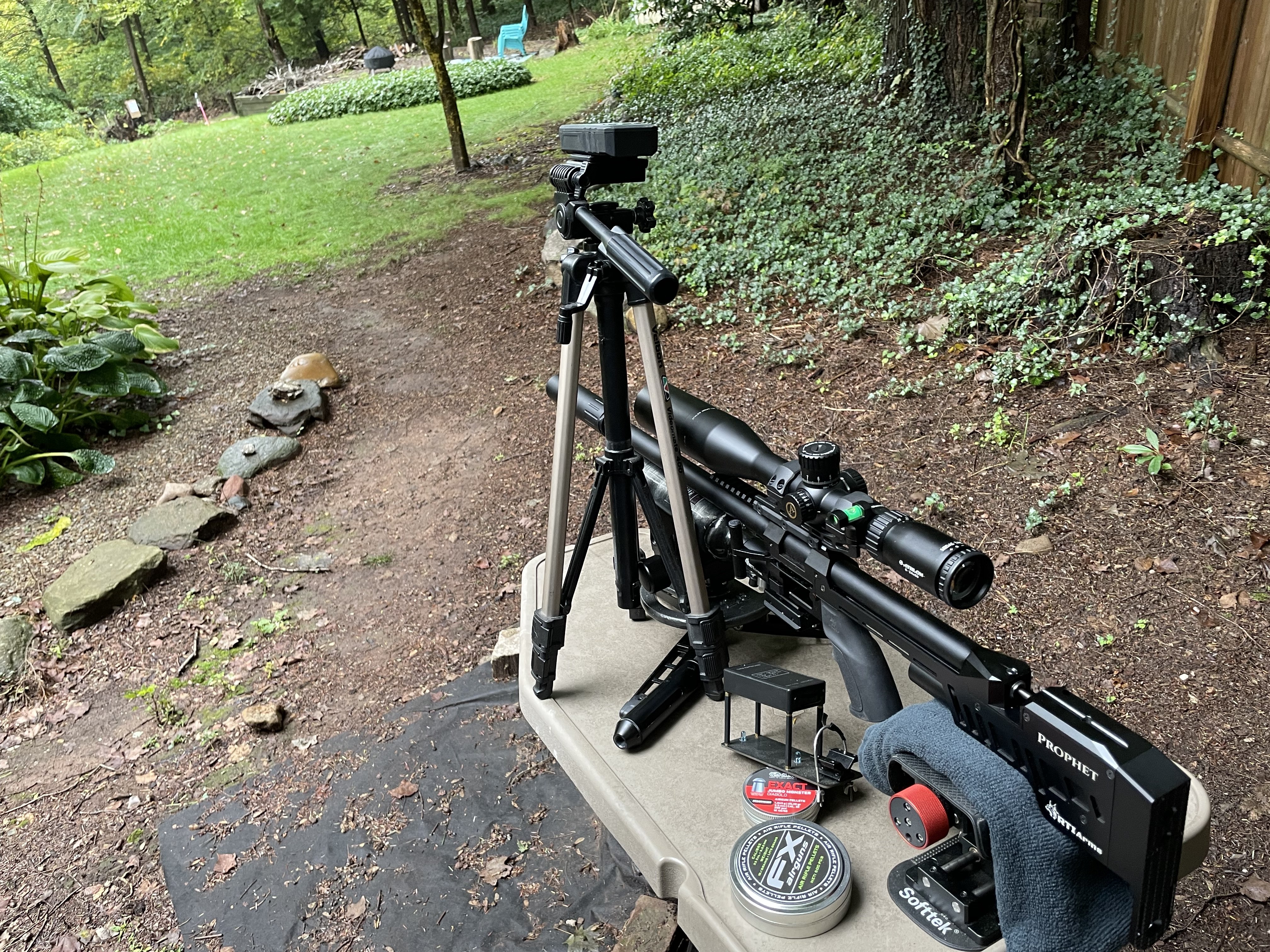

You can see that I’m shooting this accurately from a less than stable table and chair situation, lol - it just adds to the “Challenge”.
Hope this tuning info helps others shooting a .25 caliber Prophet Performance.

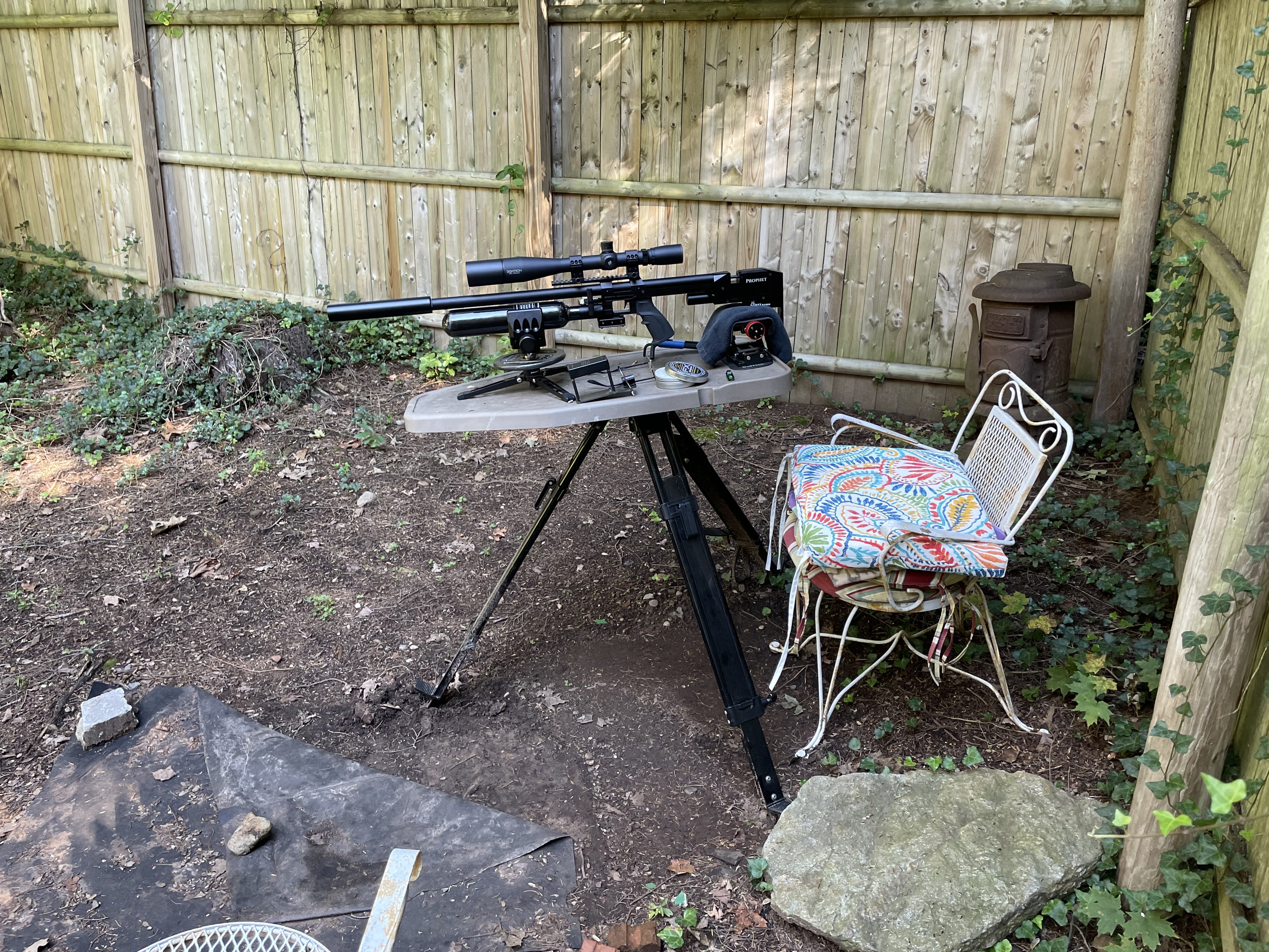

Well Thomas, its all I really know. The “ironing board” top vibrates pretty bad when you release a shot, but it doesn’t seem to effect accuracy - I’m shooting scores most every card that I’m happy with. Perhaps the ironing board is actually training me to be a better shooter as I must be extremely still and not put any pressure on the rifle other than pulling the trigger straight back - or the board moves.
The bigger issue for me is the chair. As you can see, it sits crooked on the unlevel ground and I’m always stacking more pillows and towels to get my eyeline to the scope where it feels correct.
Despite the “obstacles” I’m having a blast with my new airgunning hobby. I’m relentless and unafraid - I tore down my 2nd Prophet moments ago, did a quick polish of the hammer and hammer spring, dropped reg pressure to 95 bar, got rid of delrin spacer, etc. All because the tune I put on my other Prophet today - 96% tune - felt so much better than the tune I had on this Prophet (that I recently shot 193 at 40 yards with). I’m learning all the time - the data from the 30 Yard Challenge is so valuable to making adjustments to improve.
For example, When tuning Prophet #2, I was adjusting velocity constantly and shooting at a white spot at 30 yards while turning allen keys and watching chrono readouts. I wasn’t “super aiming” and velocity varied from 865fps to 975 fps… below is the group - Despite the massive velocity swings - I’m aiming and holding pretty good, lol - that’s like 25 shots while adjusting and chronoing…
-Ed
