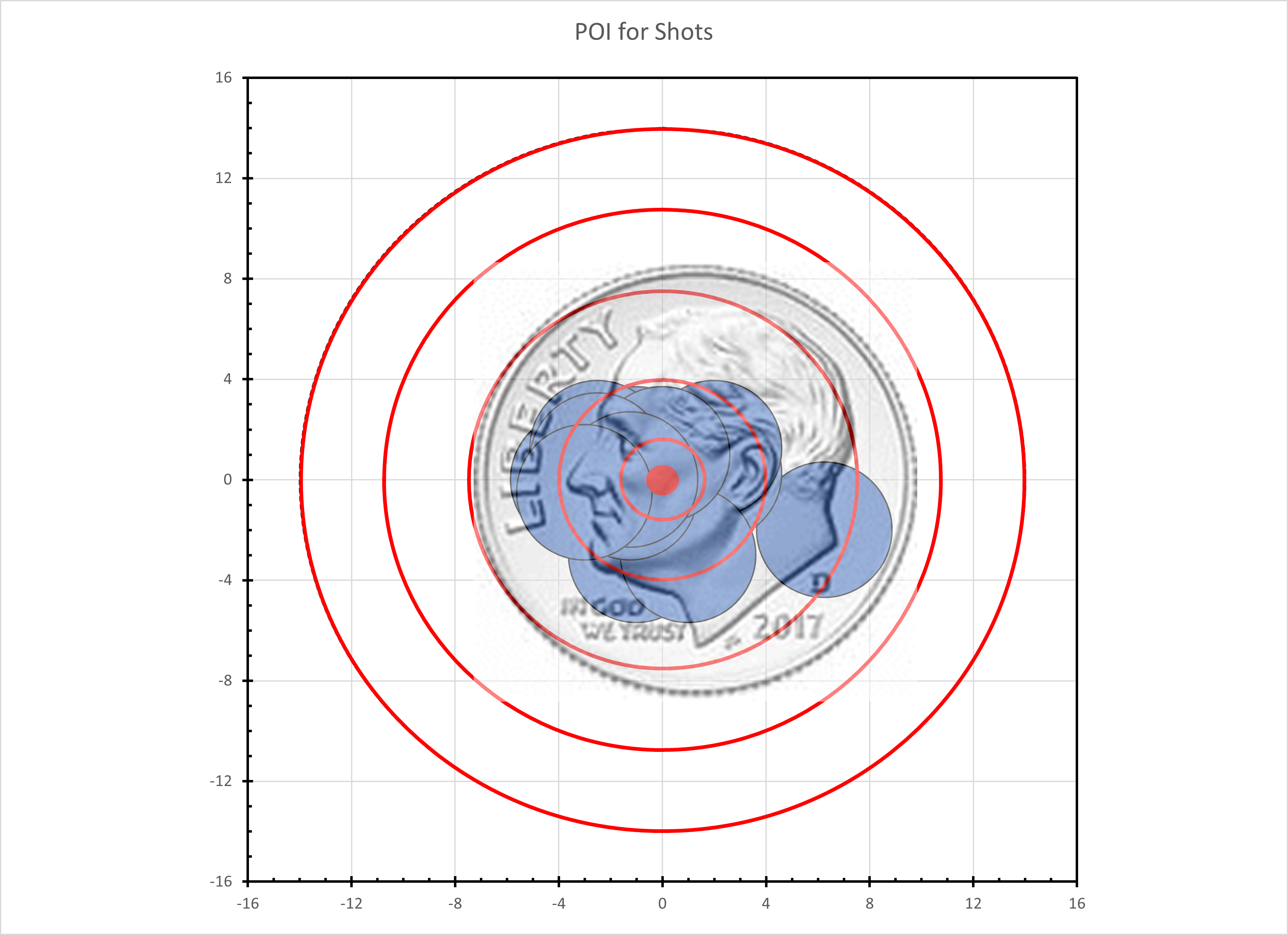

Hi Guys,
Glad you liked my Excel efforts to get my head around why I was having so much trouble with the 30 Yard Challenge. It takes some effort to produce those charts. I would be happy to post an Excel template for anyone who wants to try. But at the end of the day it requires you to measure (as accurately as you can), the windage and elevation offsets from the Bullseye. I try to do it in 1/4 mm increments which is about as good as I can get from my scale and estimating the center of the hole in the target. I then use the size of the scoring pin to determine the score. For the pin I am using (for my .177 to look like a .22) the diameter is 5.66 mm. I scale the circle on the charts to get that size. That's why the holes look big for a .177.
I am including a screen capture of the analysis chart for the best card I shot (199 -19x) just to show how good you have to shoot in order to get those really good scores. I still have not rung the 200 bell. But I keep trying - and now need to try at 40 yds!
Cheers,
Greg

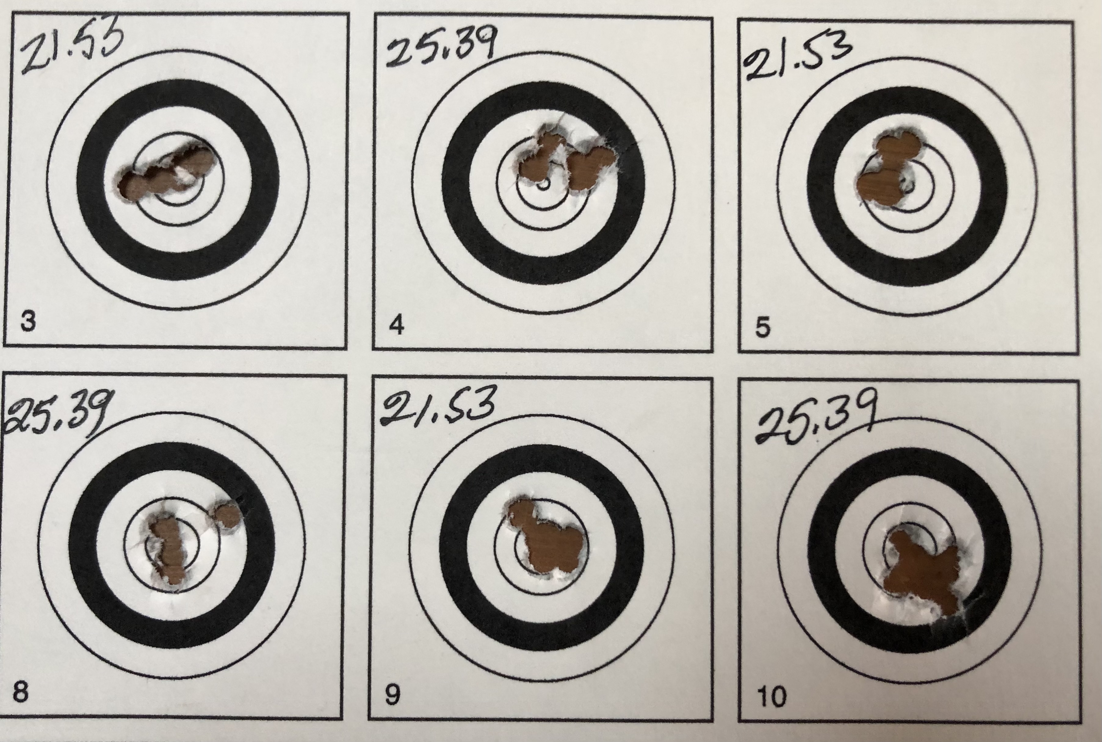

Well, you tell me does consistency in pellet weight matter for accuracy? Up until this presented itself, I have been a pellet weigher in .005 grams or .1 grains, 0.1 grain is equal to .006 grams. Pellets would be sorted to either .1 grain groups or .005 gram groups. That was before this.
I have found that my Red Wolf HP .22 likes all the JTS pellets the best, so I am shooting 18.1’s on low power which is around 1010 fps and on med 21.53’s at 1030 fps and still on med the 25.39’s at 960 fps.
So where am I leading? Let’s start with the fact the 25.39 pellet is 3.89 grains heavier than the 21.53. Now lets looks at some groups shot on medium power for both the 25.39 and 21.53’s with absolutely no scope adjustments.
Wind conditions were very mild both days. Pellets were taken from the tin and rolled on my oil pad nothing else did not even visually inspect them. The 15 match targets are 21.53 while the sighter row extreme right is 25.39 do not include the bottom 2 targets in this row. This was several days ago.
Today I shot these 6 targets in this order 8, 9, 10, 5, 4, 3 - 5 shots each alternating between 25.39 and 21.53 with NO scope changes.
This was not expected from pellets that weight 3.89 grains difference so how could 0.1 grains or 0.005 grams make a difference.
What are your thoughts.

Hi oledawg,
I have a Wolverine R HP .22 - it has the exact same barrel as your .22 Red Wolf HP. My Wolverine does not have the same high power capabilities as your RW, but it shoots the 18.13g at 1,025-1,030 fps.
Thats an extreme high velocity - while still keeping the pellet stable in flight. It must be an extremely FLAT trajectory at this > 1,000 fps velocity.
My guess is that this extremely flat trajectory with high velocity is what makes our rifles somewhat “immune” to differences in pellet weight. I‘m also going to guess that as you get into more “normal“ velocities of 800-900 fps, differences in pellet weights would impact PoI more - especially at 40 yards (and greater distances).
So, our high velocity Daystate HP rifles are a bit unique (IMHO). The only other rifles I have that can maintain accuracy at 1,000+ fps are the .22 LR and .25 LR barrels for my RTI Prophets. These are Lothar Walther polygonal rifling barrels with slow twist rates - very similar to our Daystate HP barrels.
-Ed

Yea Ed I’m sure this does not hold true for every airgun. I appreciate your insight.

Greg,
This is an awesome depiction of what it takes to shoot a 200…
… a 200 requires a lot more accuracy than putting 20 shots under a dime at 30 yards…
… it actually requires that you put 20 shots on Roosevelt’s FACE at 30 yards !
I shot a 188 9X on a 30 Masters card today with the .177 Prophet… suddenly that feels really good, lol.
Thanks for sharing the great graphic !

Measure head diameter and check hardness. Harder pellets are usually slower same when slightly larger

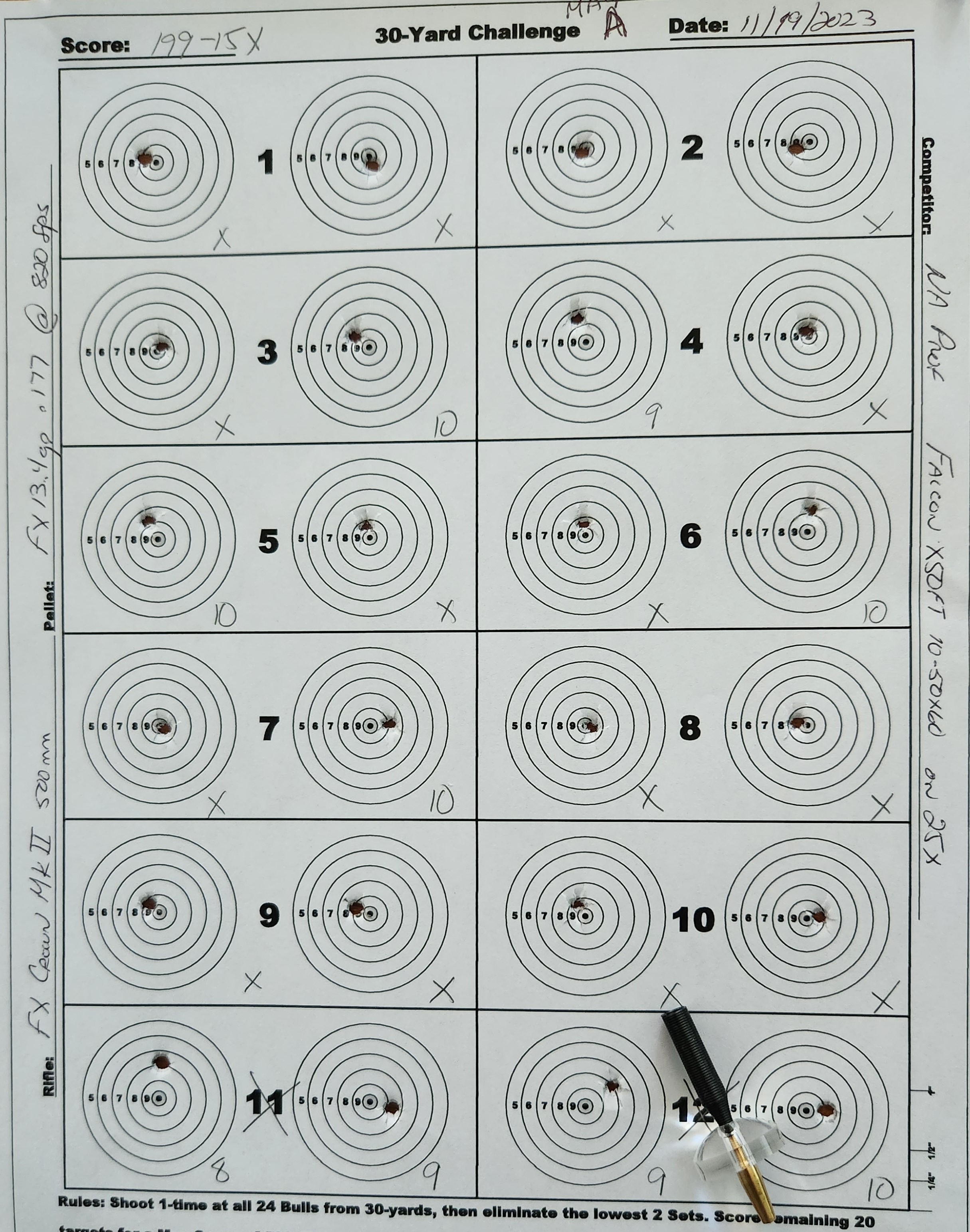

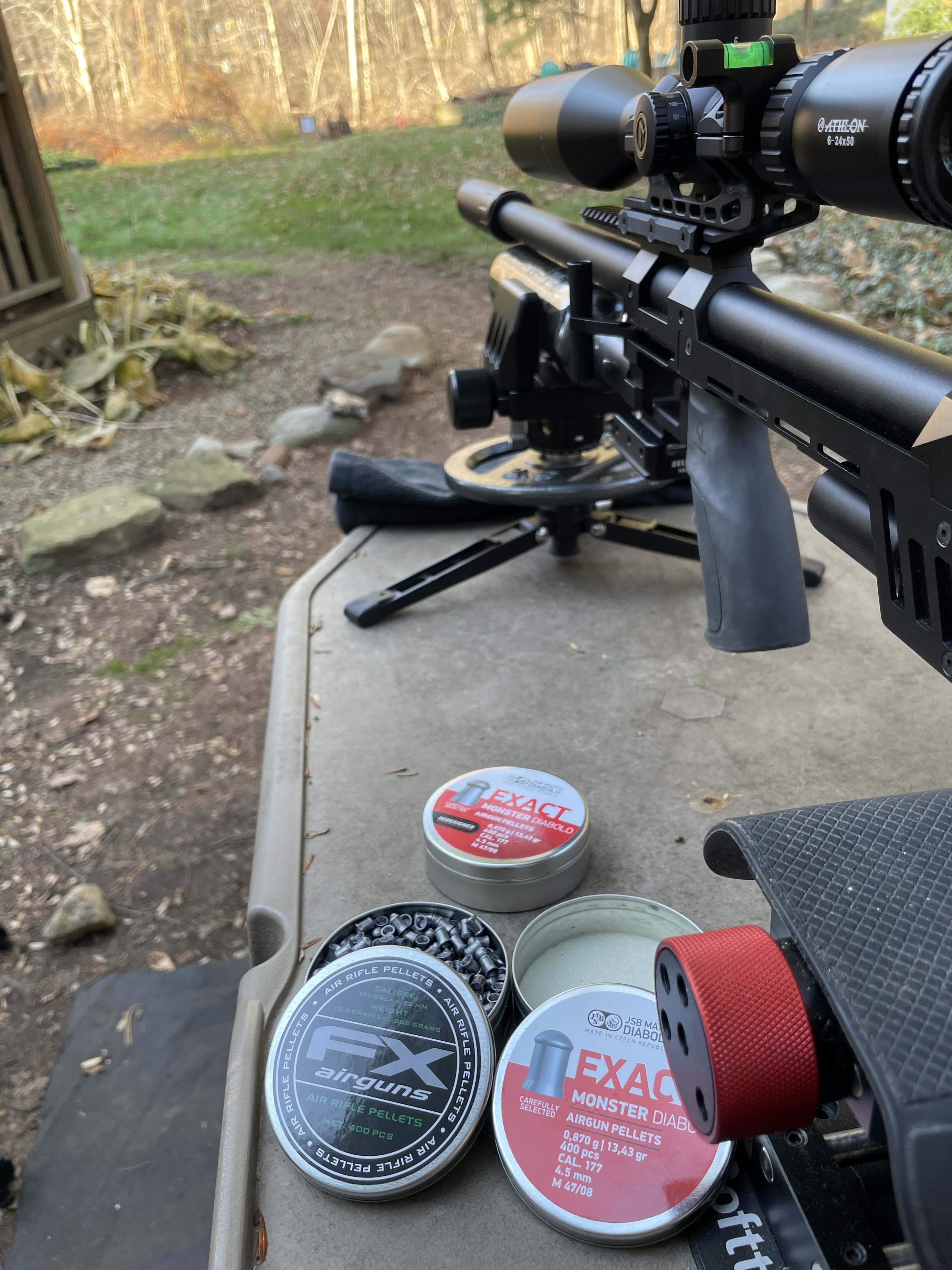

Hi Guys,
Had a very interesting session today. It was a perfect morning for shooting these targets - sunny, high 50's no wind (don't get that much here near the ocean). Anyway, my purpose today was to check out for myself something that I had seen on Sub12Airgunners. They typically shoot the 8.44 gr JSB in their Sub12 rifles and found that the FX Panthera magazines were deforming the skirts when cycling pellets. So, in their usual fashion, they showed how to modify the spring tension in the mag and where to look for burrs to file, etc. Then they showed that after the mods the pellets did not see the same kind of deformation. I shoot the FX 13.4's (same as JSB Monsters) which have small thin skirts also. So, I modified one of my Crown mags for a check. I also have a couple of Stud Loader magazines that really are meant for slugs, but I threw one of them in the mix.
The check consisted of shooting a 30 Yd Challange card with each magazine. Since the mags hold 22 shots, I used the same type of magazine for the remaining two shots. Here are my results:
First, the modified magazine (the two shots at 12 were with a non-modified mag). Really good card at 199-15X
Next came an unmodified magazine. Woopie! I finally rang the 200 bell! And yes, I recheck 11-1 because when I took the pick some of the paper folded back into the pellet hole. Also forgot to note that 6 and 10 were the pairs I chose for my Mulligans.
Finally, the Stud Loader Magazine. Yep, it was definitely worse, but not horrible. Though compared to the first two it was really weak at 191 - 12x.
So I can't say from this that modifying the Crown mags was worthwhile, but maybe tonight I will do what the Sub12 guys did and cycle some pellets through each and inspect before and after.
But now that I managed a 200 on the regular challenge, I am going to have to work on the Masters and the 40 yd Challenges.
Cheers,
Greg

Congrats Greg! Feels great doesn’t it.
You had three great cards.

Hello @NAProf
Beautiful shooting on all cards but super on the 200, kudos (y) (y) (y)
And thanks for sharing the information.

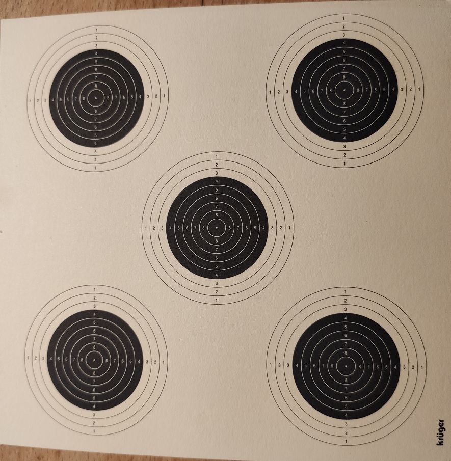

I think come Saturday, even if its just1deg C above freezing, i will bring my Vulcan 3 to my friends place and give this a go.
Mind u i do not have a printer but i do have a few of these 5 dot papers, i recon they will do.
I will put them up at 27.5 M which i believe are 30 Yards.
The 10 ring appear to be 4.5 / 5 mm in diameter, so should correlate OK to the print you guys are shooting.
If thats not good enough, well you will just have to flunk me
