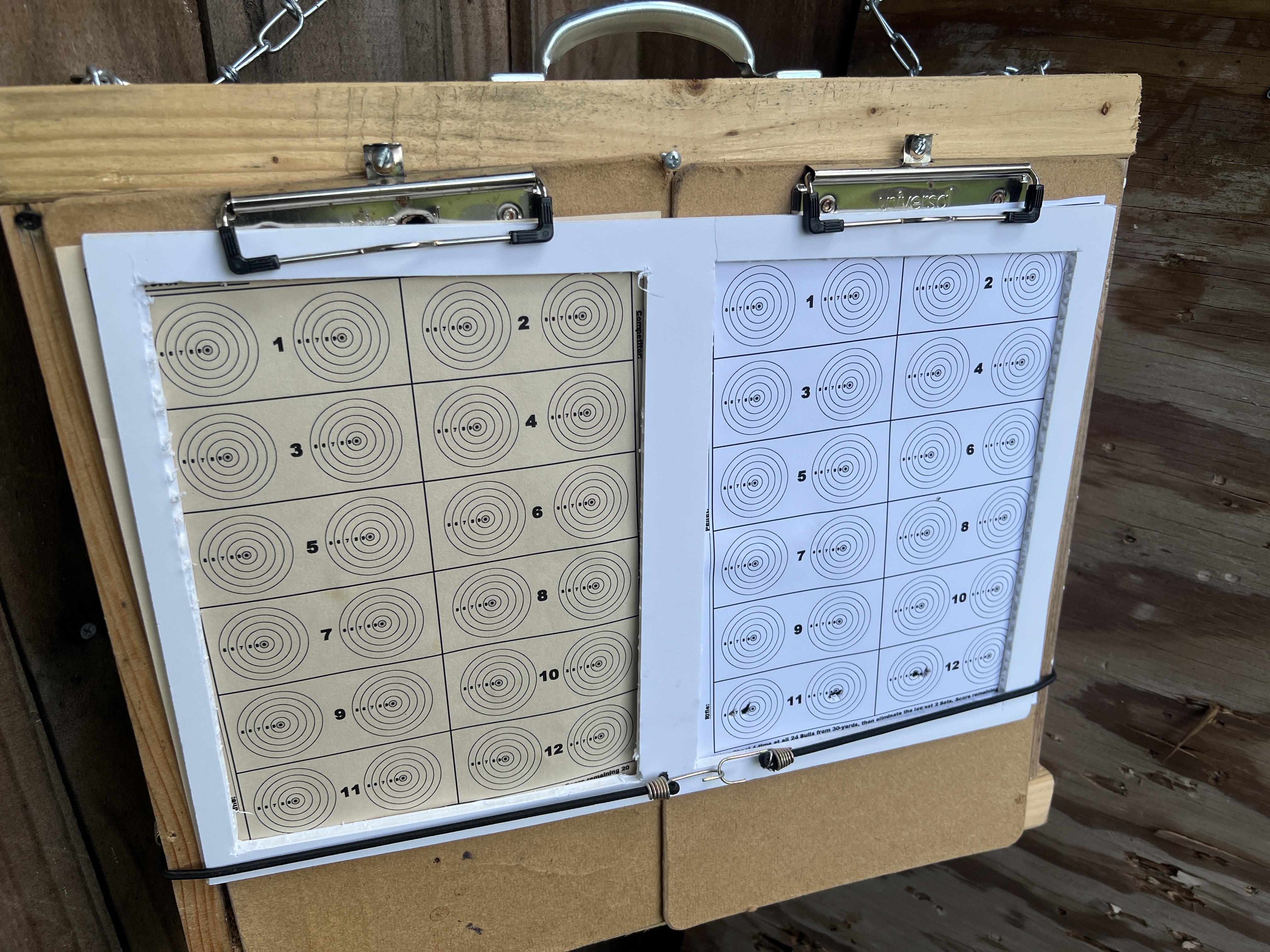

So, before I started to understand how tough the 40-Yard Challenge was, I was shooting an average of over 198 with the Wolverine HP for 10+ cards. It was almost boring so I shot stuck a TYC card at 40 yards and shot a 190 9X on my first try.
Not bad I thought, so I put up another card at forty and shot this 197 12X (!).
Scored 189 and 185 on my next couple 40 yard cards with the Wolverine and then stopped shooting it. It’s awesome for accuracy and pretty, but just isn’t my favorite rifle to shoot.
Damn, I didn’t realize at the time just how insane a 197 at 40 yards is. Conditions were really nice on those nights. Now its cold and always breezy here.
This 197 may stand as my best score till next spring. Wish I could go back to those nights now - I’d get in more 40 cards with Wolfie.
-Ed

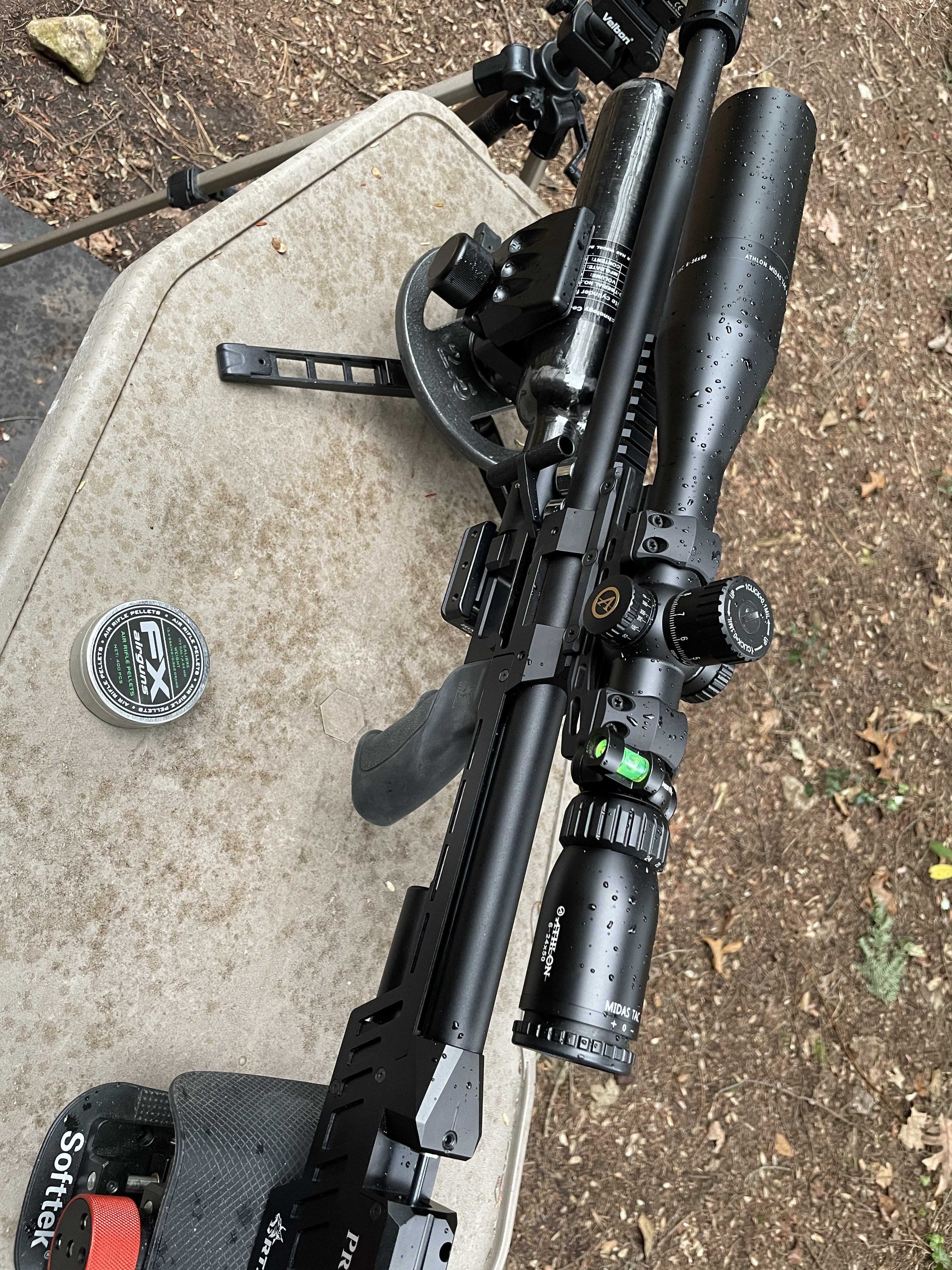

My 1st 30-Yard Masters card of today with .177 Prophet and 13.4g was a 190 8X – nice. I had been shooting the 13.4s at about 855fps.
I started the 2nd Masters card and bumped the velocity up slightly (to about 870) after the first couple targets – thinking that might help. Immediately the next 3 targets were worse. So, I turned the hammer spring adjuster about ¼ turn out to lower velocity to about 825fps – immediately I started hitting Xs and 10s !
Card #2 wound up as 192 11X – really nice!! Especially since I was cranking the hammer spring up & down during the card, lol.
The last 12 targets were so good on Card 2 that I had a shoot a couple more cards:
196 13X - Card 3
196 14X - Card 4
Back to back 196 30-Masters cards !!
So, it appears that the 13.4g “monster” pellets in .177 seem to like lower velocity – where the 25.4g Monsters in .22 caliber seem to like higher (950+ fps) velocity.
Don’t know if anyone else here has experience with the FX / JSB 13.4g. I’ll check the leaderboard to see if anyone posted a high score with the 13.4s and what velocity they were using.
So, it appears sometimes slower is better with the “monsters”…
The last 196 14X it started raining – the Prophet got wet, but kept on hitting Xs !
-Ed

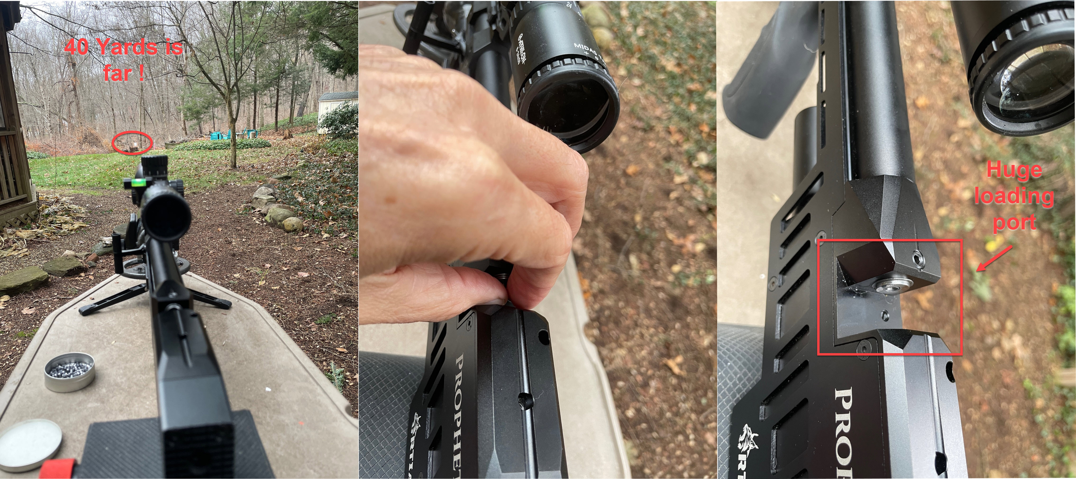

First target today with .177 Prophet was 30-Masters. Scored a 190 10X – not bad after the two 196s yesterday.
Since the .177 Prophet was scoring consistently in the 190s at 30-Masters with the new 820fps velocity, I decided to try 40-Masters.
40-Masters Results:
Card 1 = 185 7X
Card 2 – 188 9X
Note that I had a great chance to get 190 on Card #2, but shot an 8 on the final target. I didn’t choke, I was tiring from concentrating. Bottom line is that a Midas Tac at 24X is barely enough scope for me at 40 yards with these cards.
Conclusion:
I’m shooting straight from the tin and loading by hand (love the Prophet loading port). I took no sighters on these 40-Masters cards once the card started. Based on these results, I’d say that 190+ is definitely achievable with a .177 at 40-Masters. I’m gonna keep at it.
