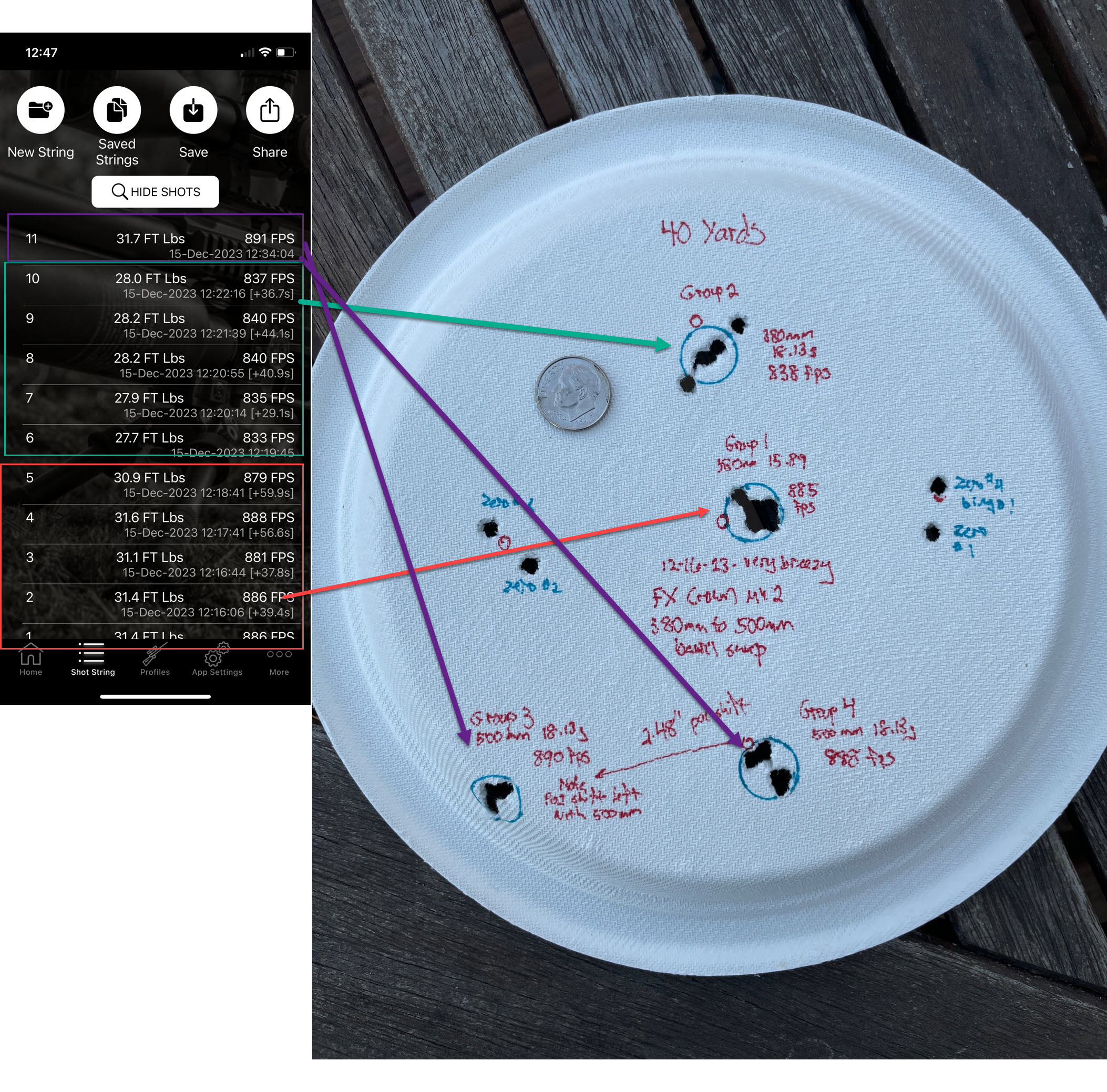

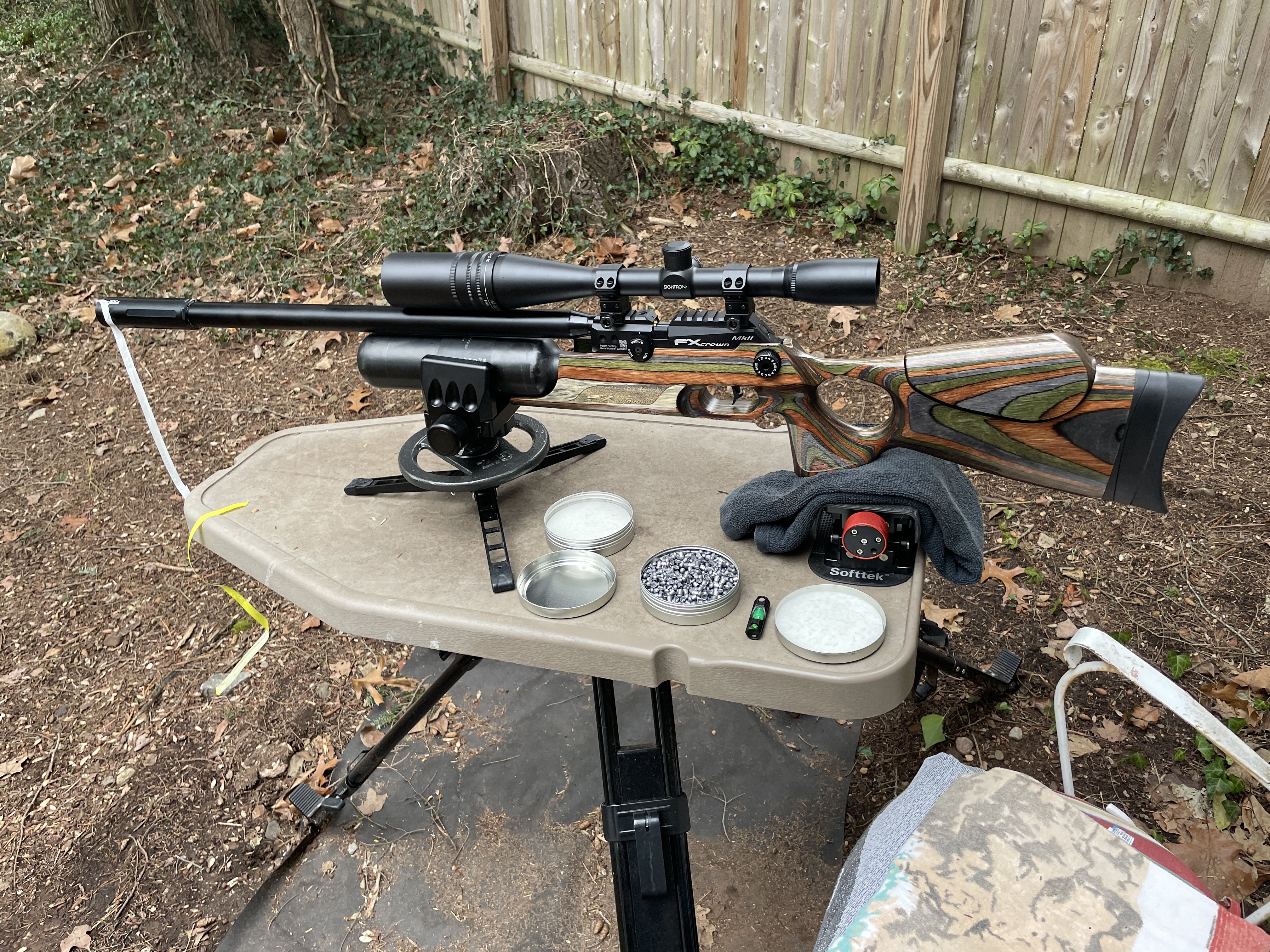

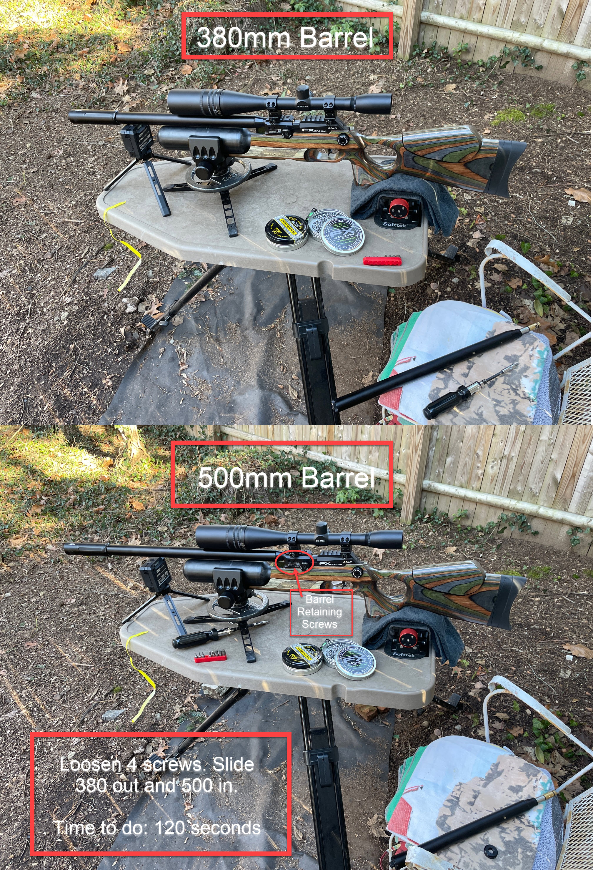

FX Crown Mark 2 Barrel Swap – Tuning Info:
Today I removed 380mm barrel and installed 500mm.
How to do: Loosen 4 retaining screws, pull out barrel, install new barrel, tighten 4 screws – takes 2 minutes. No need to remove rifle from shooting bench.
Regulator Pressure = 140 bar.
380mm Barrel:
15.89g @ 885fps
18.13g @ 838fps
500mm Barrel:
18.13g @ 885-890fps
So, simply by swapping 380mm to 500mm – NO other adjustments, the velocity of the 380mm with 15.89s = the velocity of the 500mm with 18.13s. Isn’t that super convenient !? Use the 380mm to shoot 15.89s and the 500mm to shoot 18.13s.
See the paper plate for 40 Yard 5-shot groups. These 5-shot groups are the blue ½” circles. Note that both barrels can shoot ½” 40-yard groups (in breezy conditions!)
Note that the 500mm barrel shifted PoI 2.48 inches to the left from the 380mm barrel – but immediately shot a tiny sub-1/2’ group at 40 yards.
I did the barrel swap because I had the afternoon off and it seemed too breezy to target shoot.
Once I saw the groups, I shot two 40-Masters Cards (and one more late in the day):
Card #1: 186 5X (very breezy)
Card #2: 191 11X (less breezy – holy smokes, 11X – it felt like 30 yards I was hitting so many bulls)
Card #3: 187 7X (very breezy – shot late in the day in fading light)
This 500mm / 18.13g combination holds promise. The 191 11X card felt awesome as I was shooting it.
I believe the 18.13g are going to be better than the 15.89 at 40 yards with any wind. I did shoot 3 straight 190+ 40 Cards with the Crown and 15.89s in still conditions the other day – but any wind the the 15.89s move around more than the 18.13s do.
I hope this info is helpful to folks thinking about adding a barrel to their FX Crown. The 380mm with 15.89 and the 500mm with 18.13g seem an excellent setup. I’ll eventually do some testing with the 700mm barrel and 21g & 25g.
-Ed

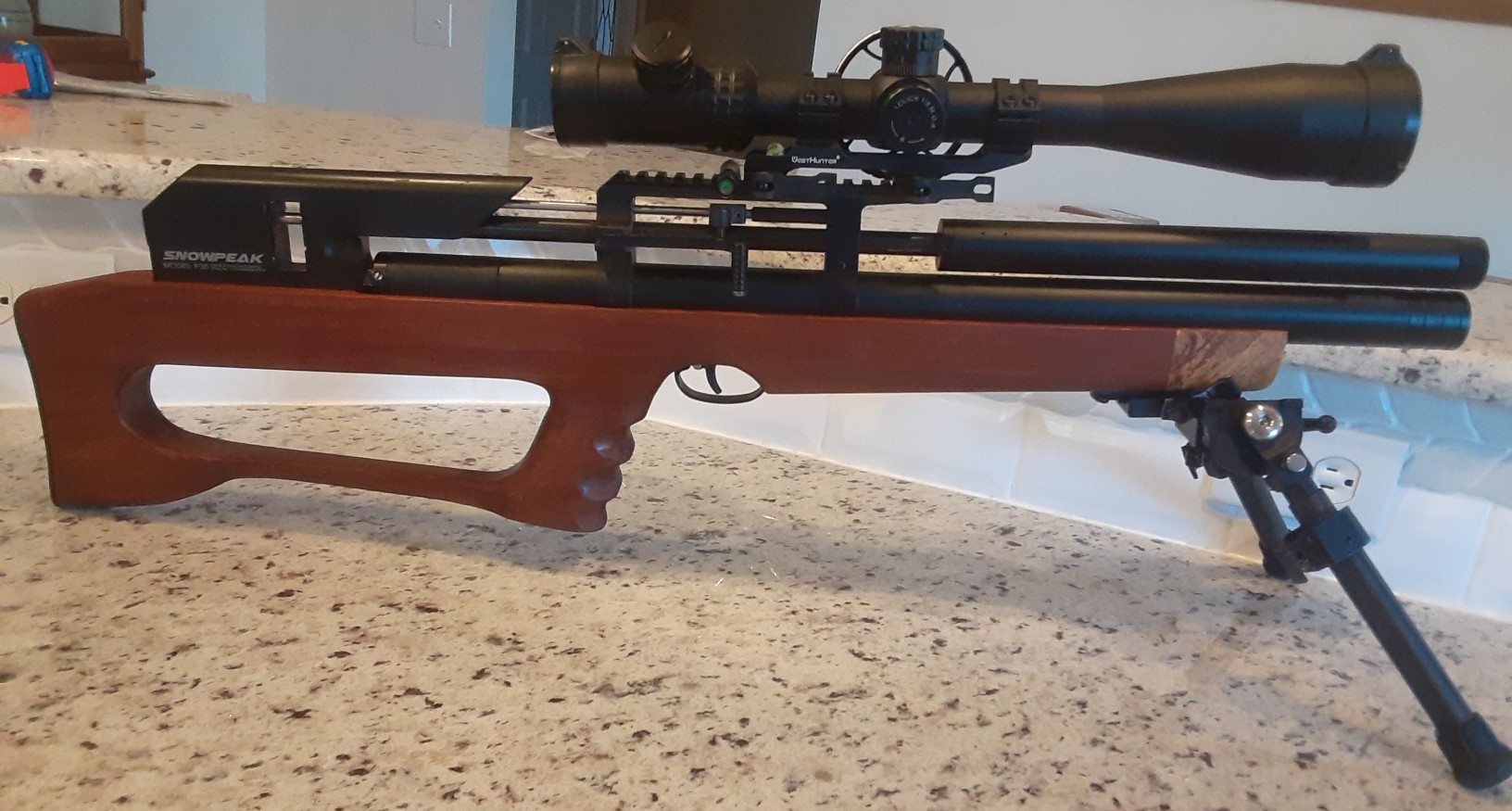

This is a status update. I hoped to get a period with very low wind today to shoot a better target but it did not happen. I shot this target yesterday a bit early. I shot it about 3:30 and the wind died down after 4pm. Wind direction was changing but mostly 9-10. Towards me and left to right. A lot of my poor shots are low and right. So I think it was wind affected but I am undoubtedly a bit rusty too. I spent significant time earlier last week finishing this stock. It is mostly Luan from church pews. I rescued the wood from a dumpster at my church and planed it down flat, glued up a blank, and added the nose piece from my small stash of figured oak from my now deceased killing tree. The P35-25 has been retuned up about 50% in fpe which I did not expect to affect accuracy but it definitely has in a positive way. You may be able to detect the new larger plenum at the rear of the air tube. I also drilled out the transfer port, barrel port, pellet probe and the path in the block between the transfer port and the barrel port from 75% of bore diameter to 85%. I have some FX 33.95s on the way. This was shot by JSB 33.95 (MKII) going about 805 fps. I'm pretty sure I can get a 190+ out of this gun now if I can get the wind to cooperate. I need to determine if it shoots JSBs or FX better too. I don't expect there to be much difference but the FX are a couple dollars a tin cheaper so it would be nice if it likes them.
