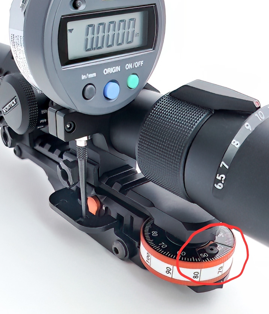

The Coldshot base is pretty good but I still like the Ravin Jack Plate better. Keep in mind that you'll NEED the Absolute MOA Digital Readout Kit for the Ravin and you'll WANT the Absolute MOA kit for the Coldshot. Plus it helps that the Ravin is also half the price of the Coldshot.
on the Ravin I saw the lever for the clicks to make them quiet or lock.. on the adjustment wheel it looks like another lever, is that a lock for the adjustment?
mark
mark
That lever is removable and comes with small wheel piece that replaces it. When the lever is attached to the wheel, it only allows for less than one revolution worth of adjustment. Probably fine for most crossbows but not for ELR with airguns.
Reactions: markhooper
great 👍 thanks for the pictures. it makes it easy to understand..
so I you go more than a revolution you either have to have the digital dial indicator or remember how many turns.. too bad there's not a veneer scale on the side indicating a number for how many turns..
that would work for me since I haven't used any ballistic calculator..
