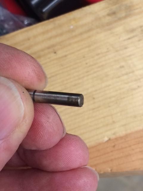

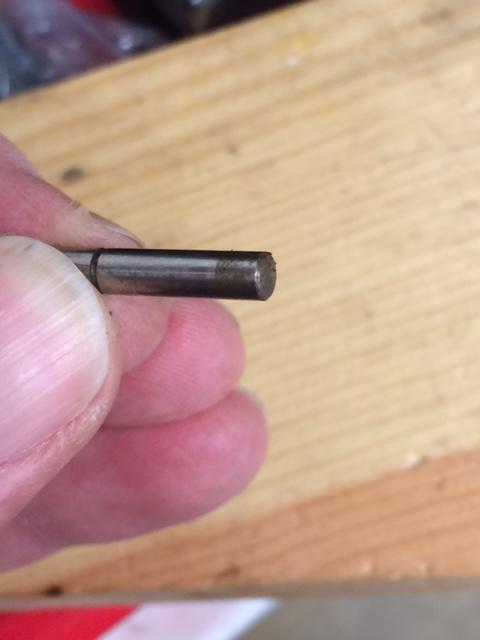

I finally got it, heat, spray with Kroil, rinse and repeat. Even after it started moving it didn't want to come out easy.
The culprit.

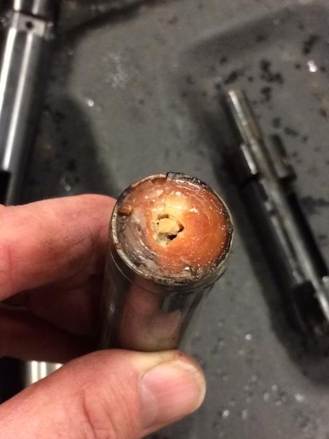

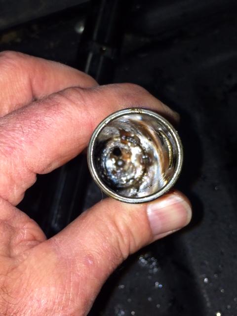

A question for you: How were you able to tell the buffer was shot before opening it up? Is there some way to check its condition without disassembly? My rifle continues to chronograph around 640 fps, so I assume everything is still OK in there.
It sounds like your gun is very healthy, mine are in the 560fps range with 8.02gr pellets.
When you cock the rifle look through hole in the breech seal and you can see the buffer. All three of mine had cream colored buffers which as I understand is the color they came with from the factory. If you start seeing chunks in the bore or chamber it's time to change it.
The reason I took it apart.
