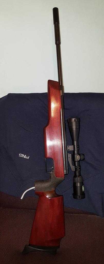

Picked this one up from German gun ebay. It's a 77 vintage and was in a sorry state - Pellets would barely come out the end of the barrell and the stock had the scratches and scrapes you expect to find on what must have been a club gun. So after a full repair kit and a somewhat ham fisted refinish it's ready to shoot. Bizarrely when I took it apart I found the piston buffer wasn't there at alll just a very small amount of dust. Looking forward to getting out on saturday and seeing how it shoots.
