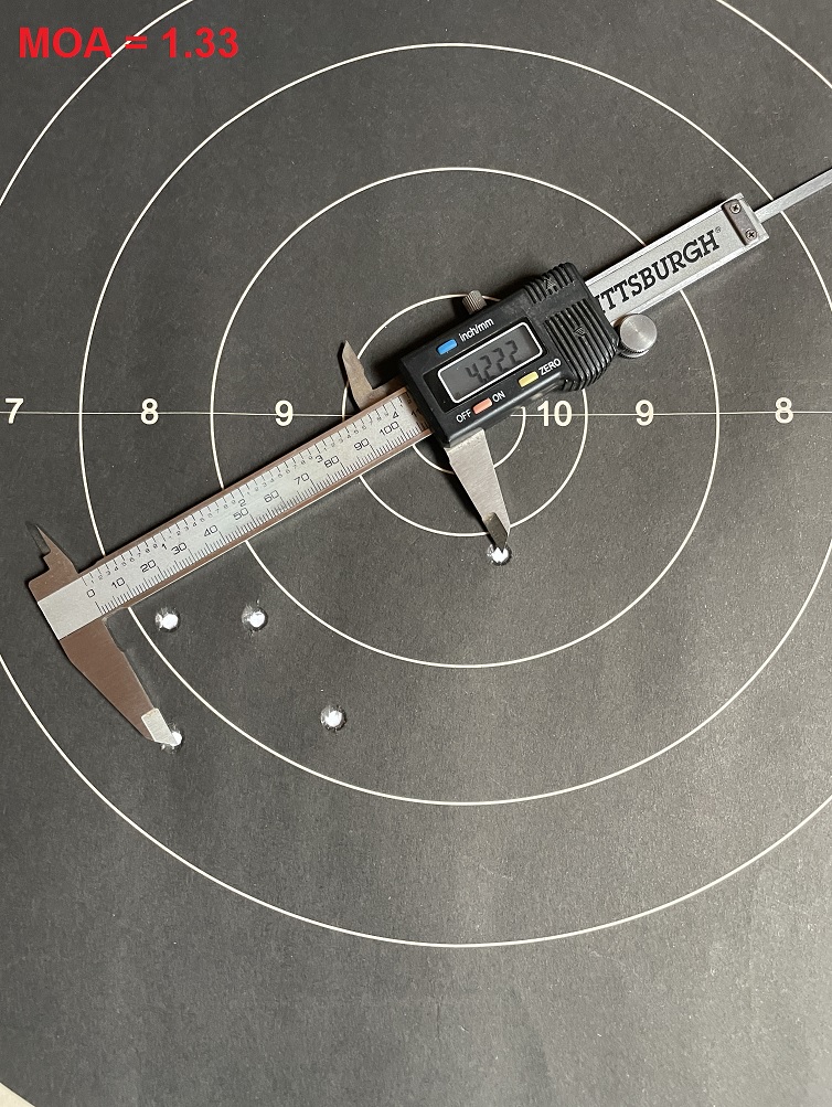

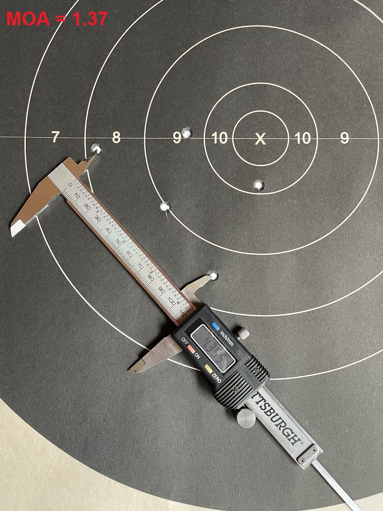

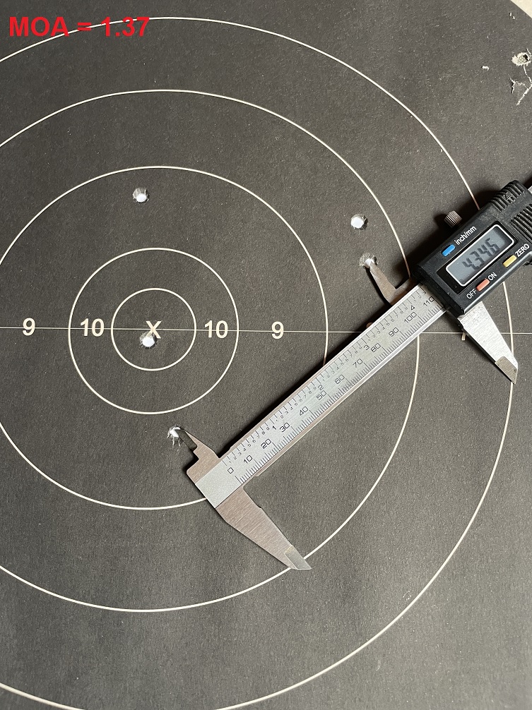

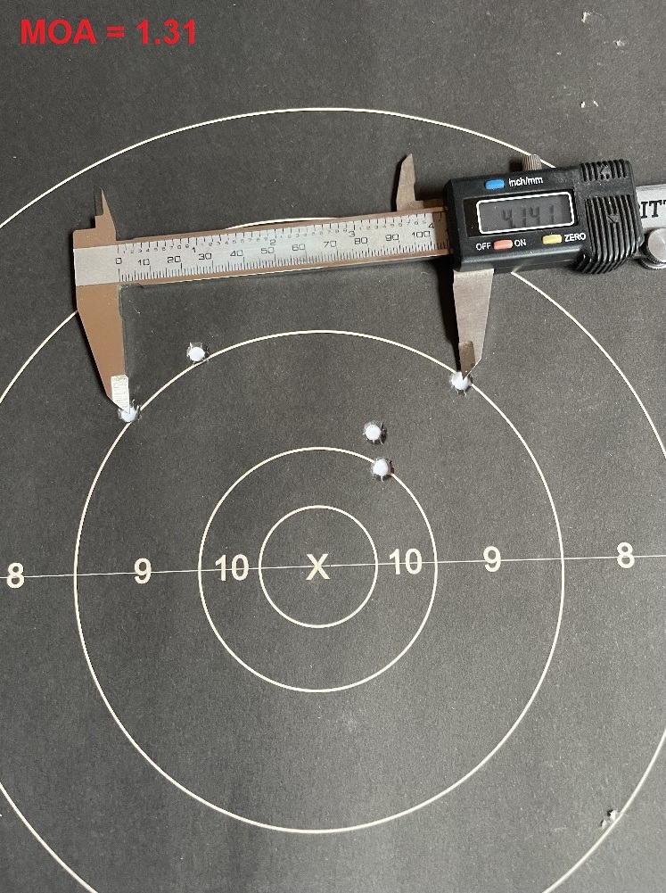

In reparation for the 2023 EBR Open big bore match, I shot some 300yd F-class targets for score today. No practice shots. 4 targets, 5 shots at each target.
Scores for each target were: 44, 40, 44, 46. For a total of 174 pts.
Here is the best of the four targets. I plugged the holes with 7mm slugs.
Winds were light. 3 or 4 mph.
Heck of a cold bore target !!!(y)
Also, what I was most happy with was the consistency in accuracy. It's fun to get the occasional sub moa group, but for matches, this is what I like to see instead. I couldn't see any of the hits from the firing line, so I walked down range after the first two groups to check them out. They both looked a little low and left. I came back and clicked up two and right two. And the next two groups moved about to those new settings. Very predictable. I was fortunate to have a calm day to do this.
After checking the targets and lasering the distance (it was 303yds, not 300yds), I adjusted the clicks slightly.
