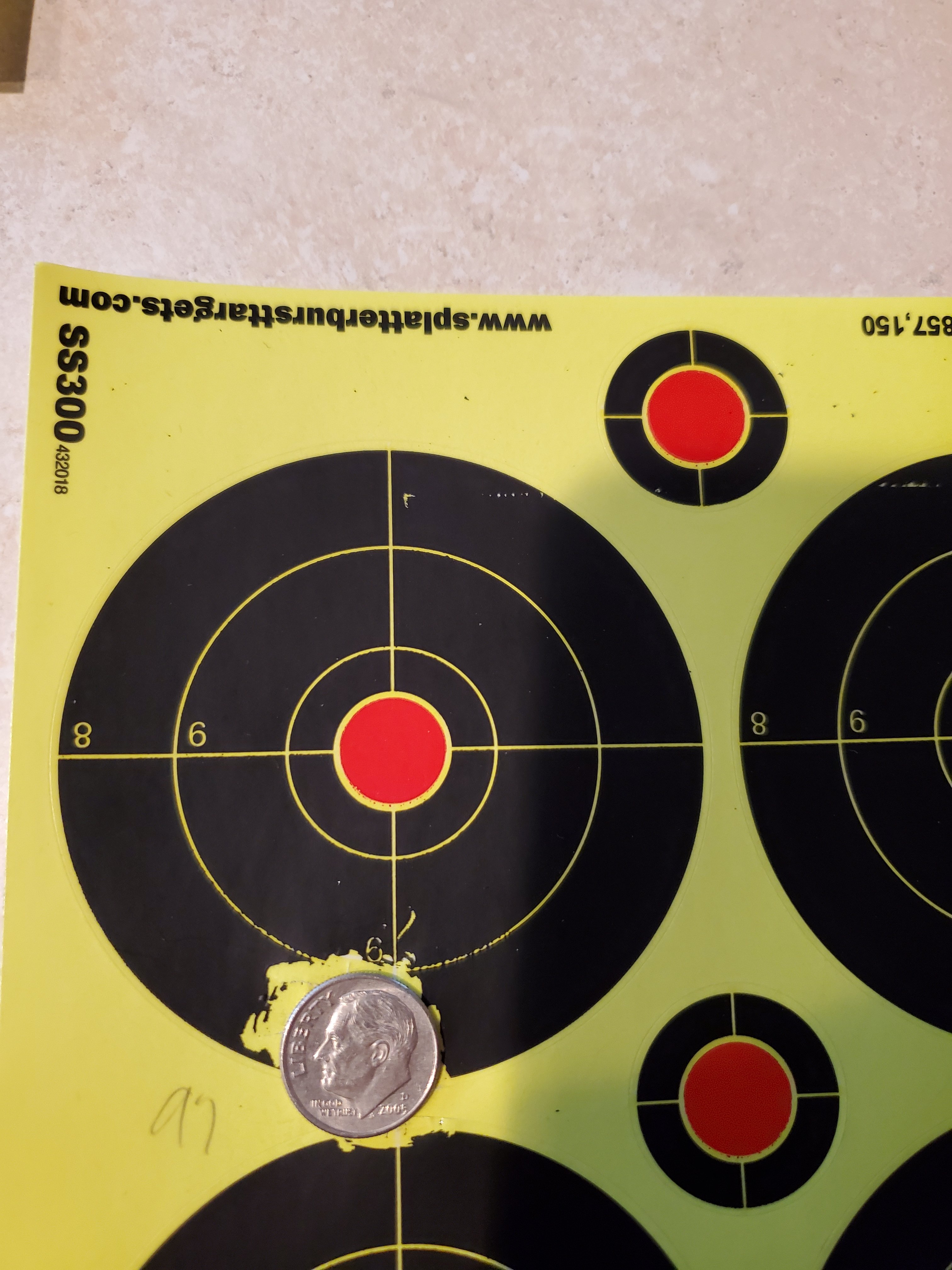

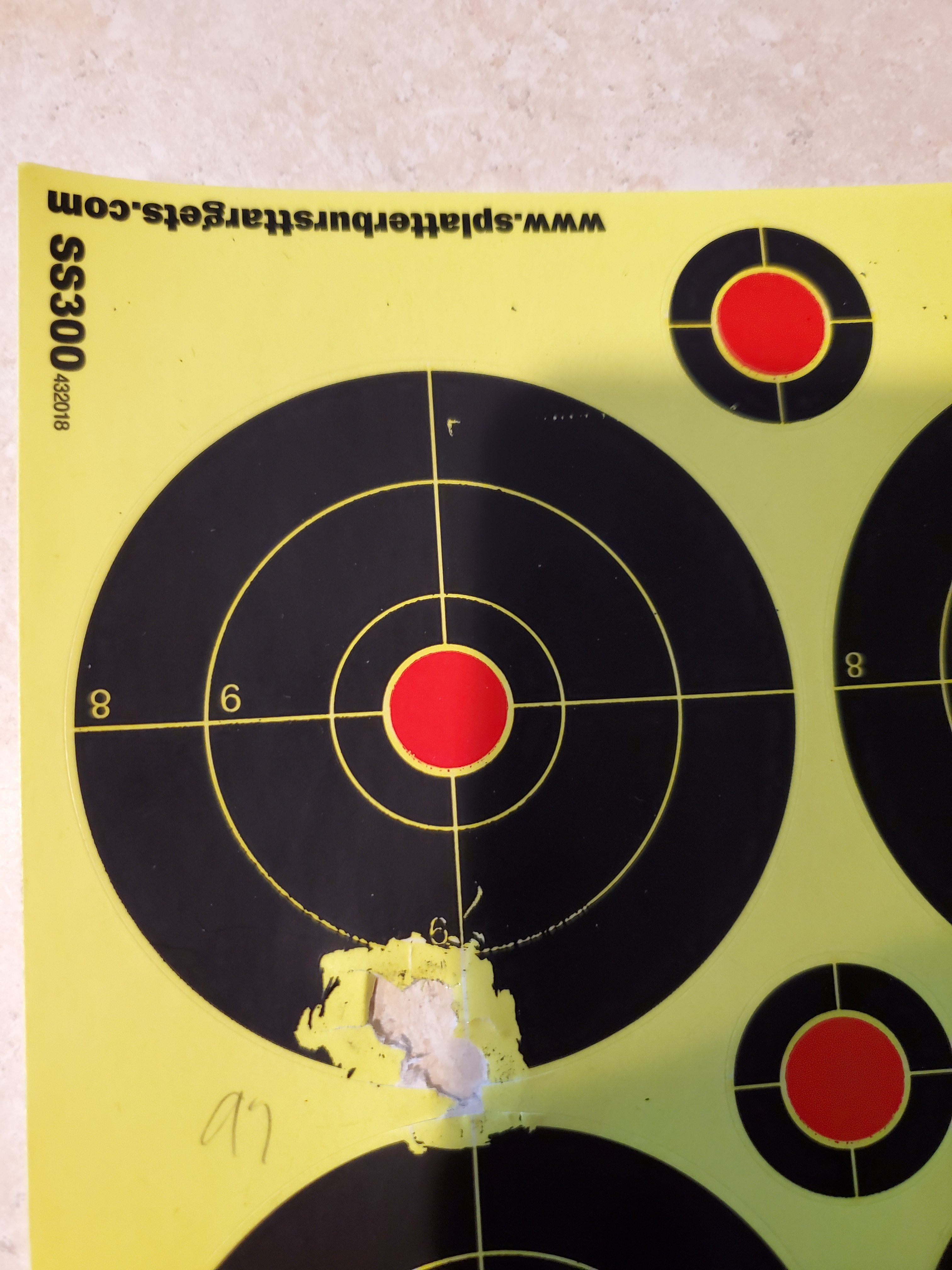

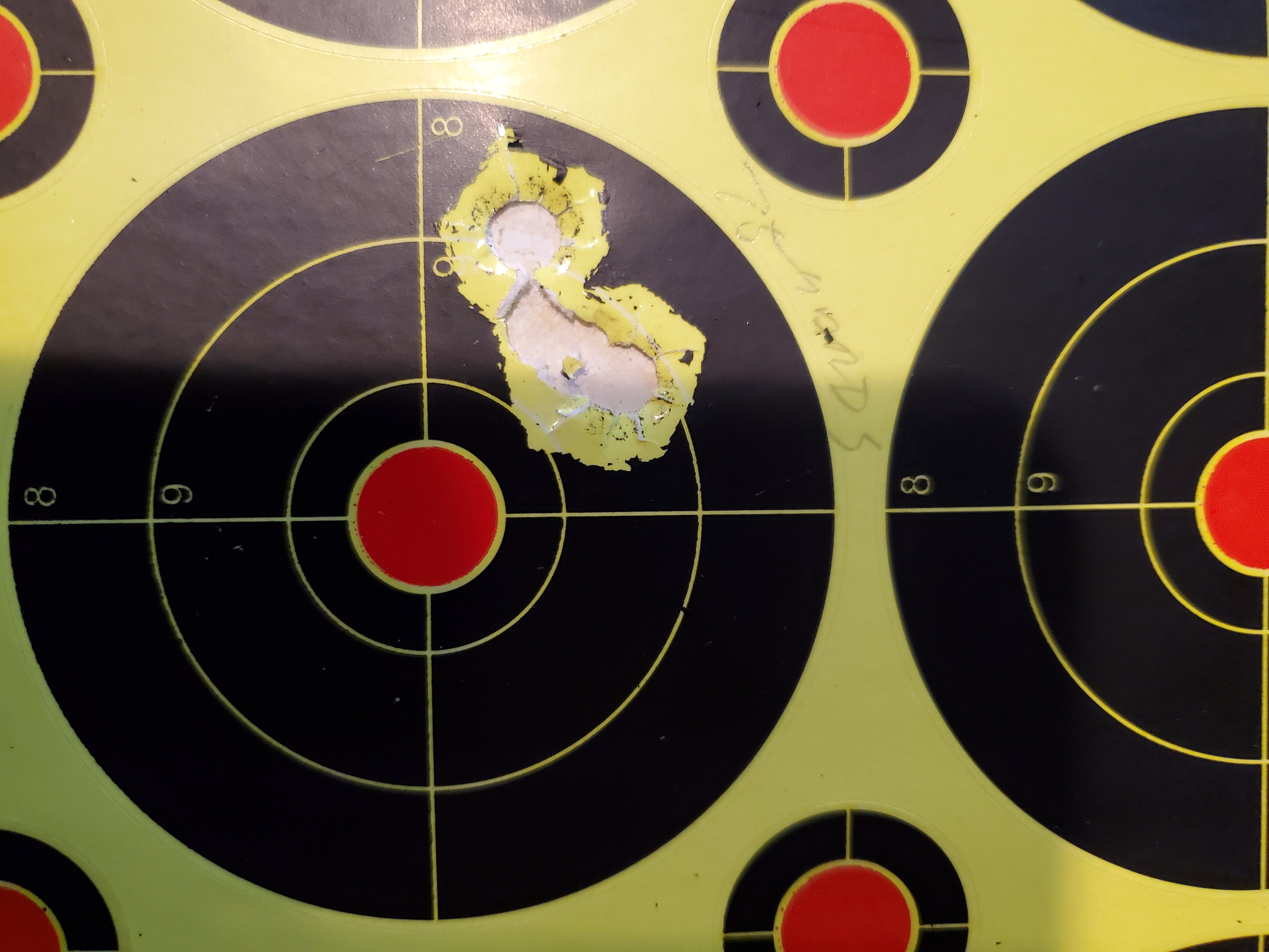

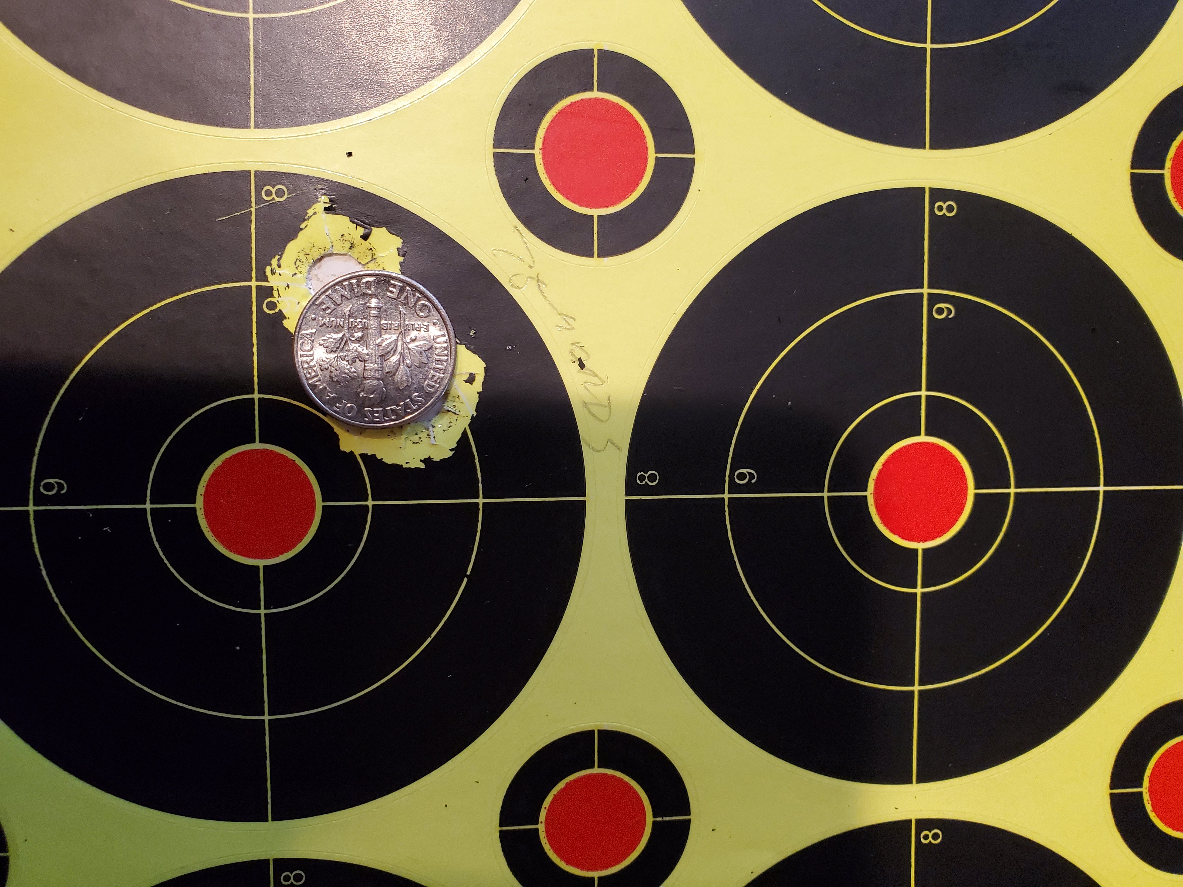

As Mike said, I switched to the .457 and I love it! Attached is two, 3 shot groups I did right out of the box... one at 75 yards, the other at 100 (I was shooting for groups, not accuracy).
I'm having some work done on it now but I'm really looking forward to shooting it at the Ashland, RMAC and EBR tournaments this year. -Dave
BTW... for the ref test above, I was shooting at 3,000 PSI with the wheel in the middle. NSA 350gr HPBT @ about 800 ish fps
