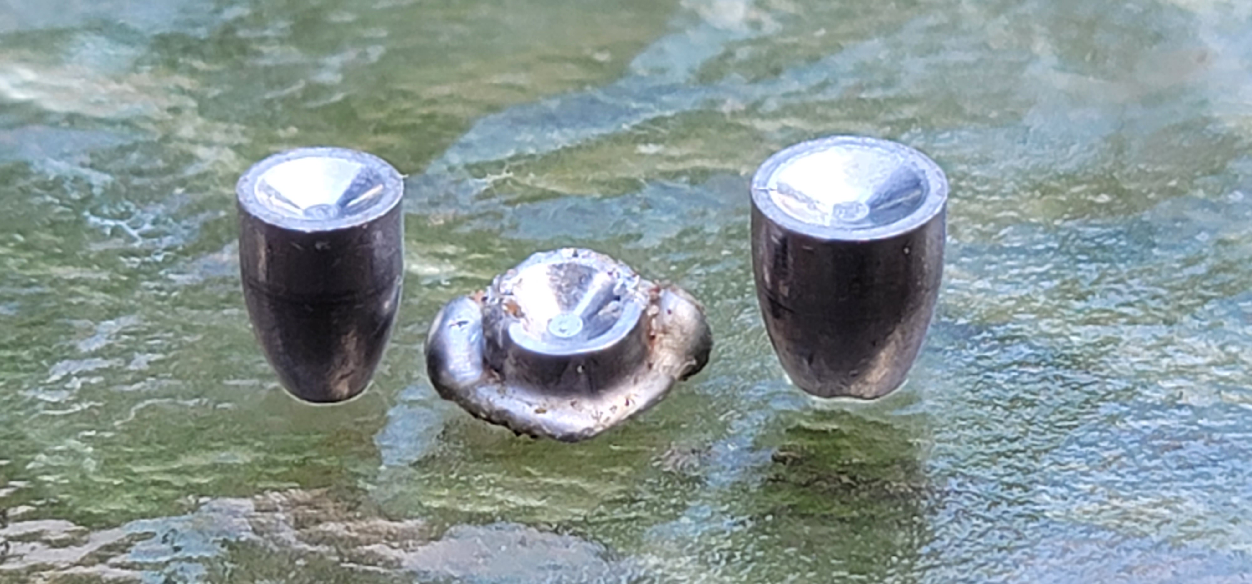

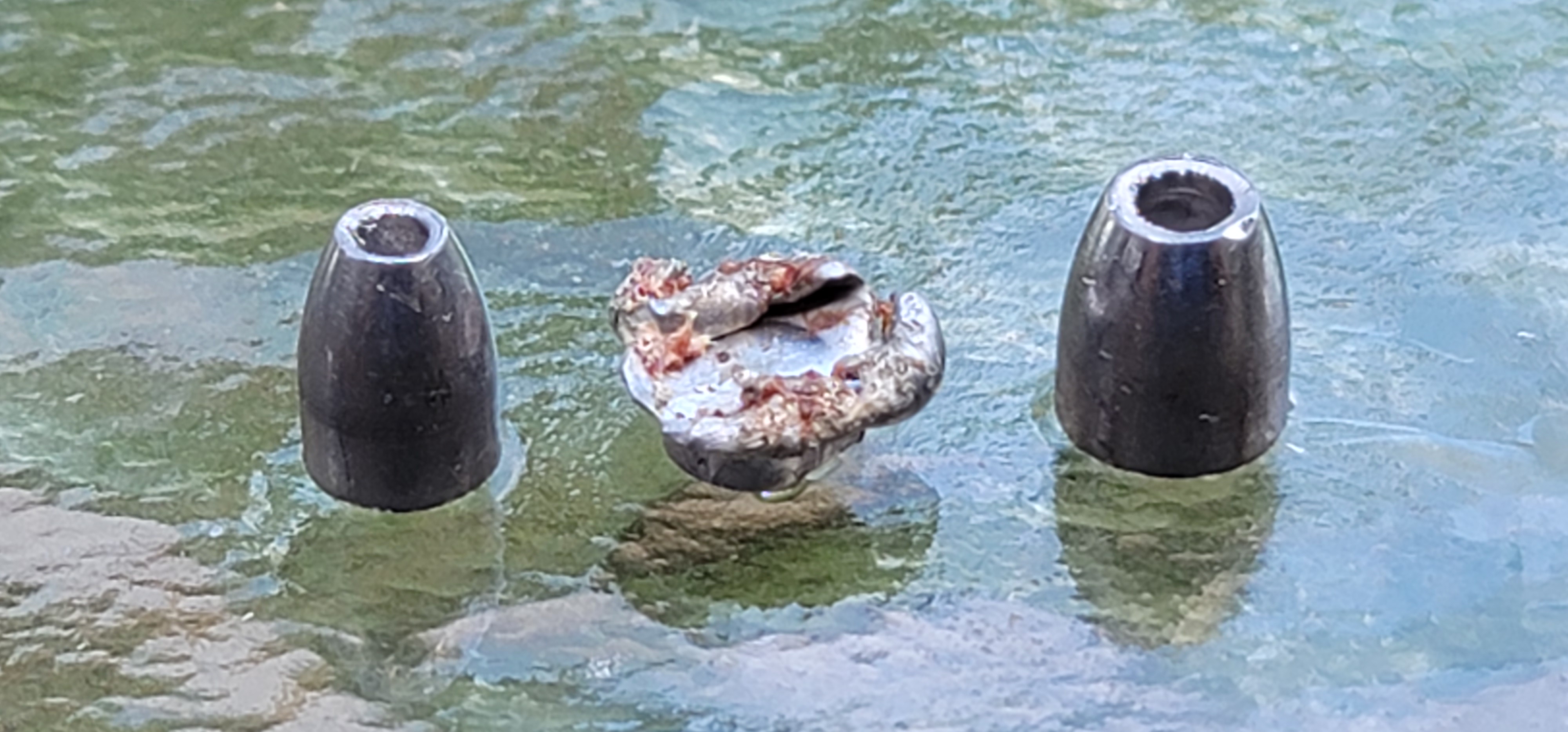

If you want a great .30 cal slug in an FX airgun, definitely try the FX Hybrid Slugs. I get sub MOA accuracy shooting them at 930 out of the 600mm Superior X Liner, along with devastating expansion on game.
This photo below shows the FX Hybrid Slugs .30 cal before and after recovery, and an FX Hybrid Slugs .357 cal far right for reference.
If you want to see the video of that shot, just look here.
