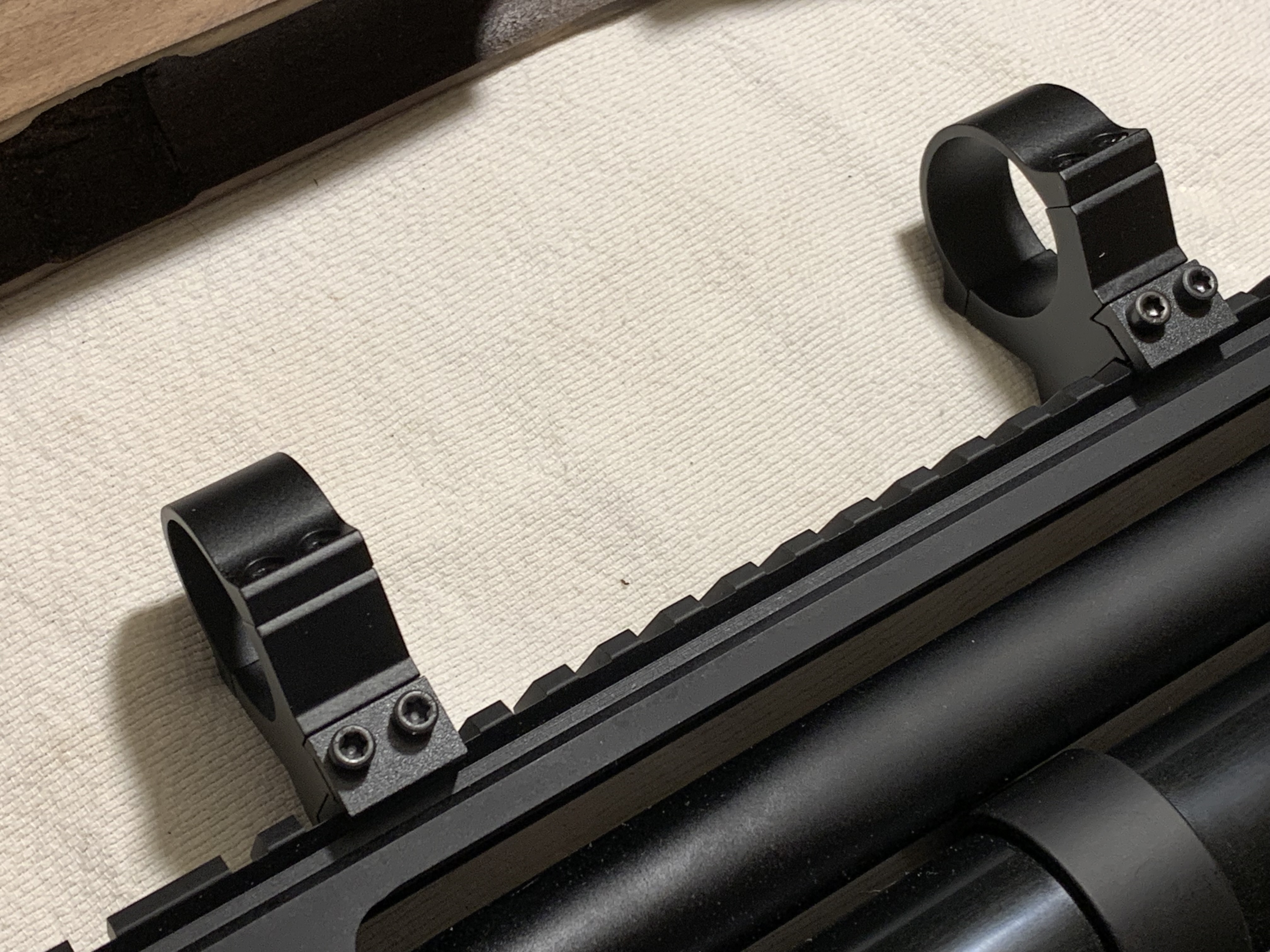

30mm scope rings for an Akela
I'm looking for some 30mm scope rings for my Akela. I purchased some UTG PRO high profile rings, and they don't fit. The metal bit that's supposed to fit in between the grooves on the Picatinny rail is too wide. Might just avoid this brand in the future. Any high profile rings that are confirmed to fit?

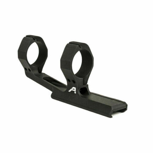

This SWFA high profile one piece mount works well in the Akela - and it is on sale:

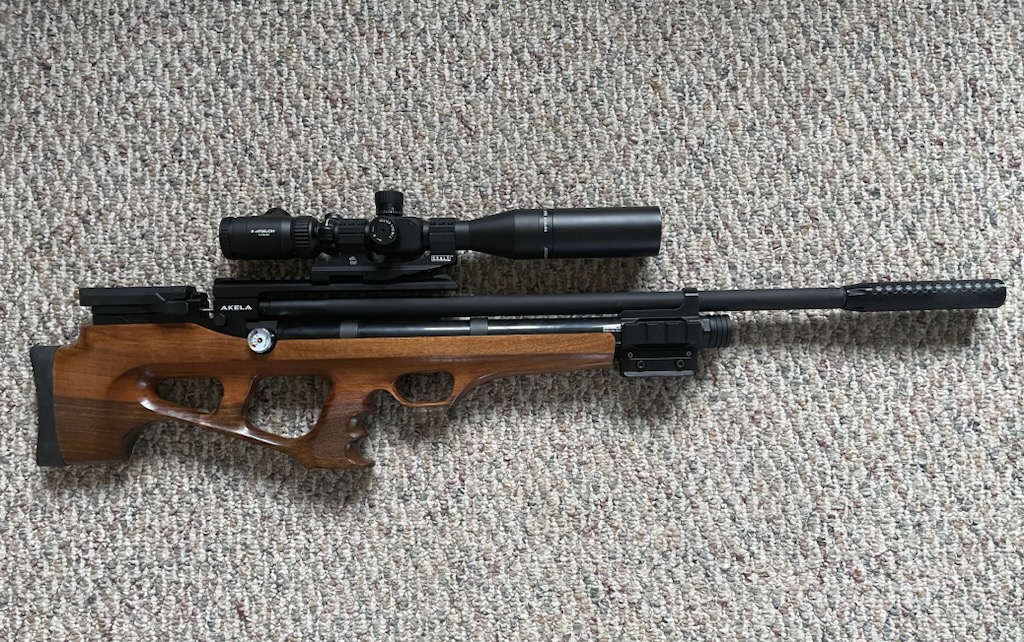

Here is a picture of the SWFA SSALT mount on my Akela with an Athlon 30mm tube scope.

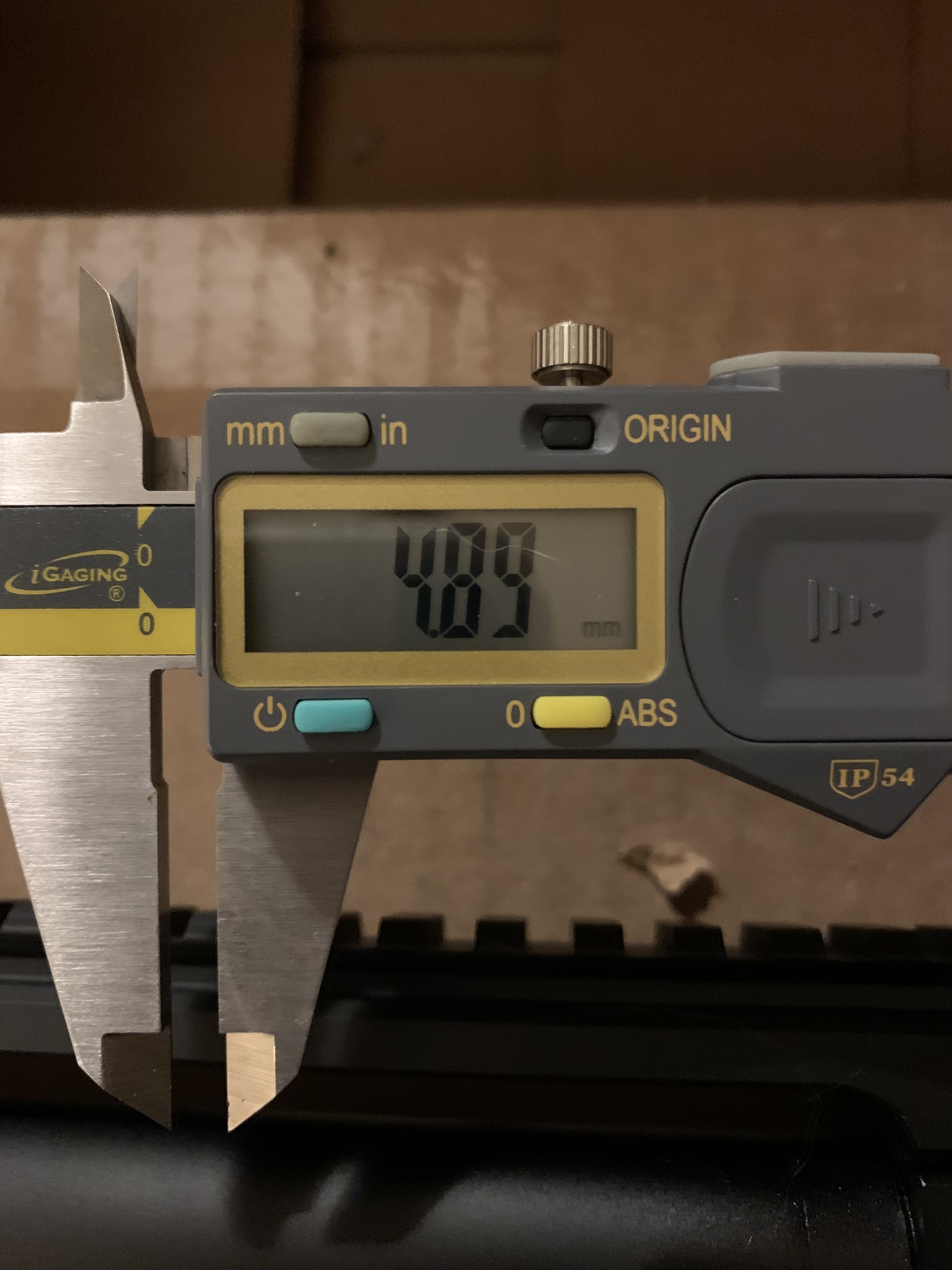

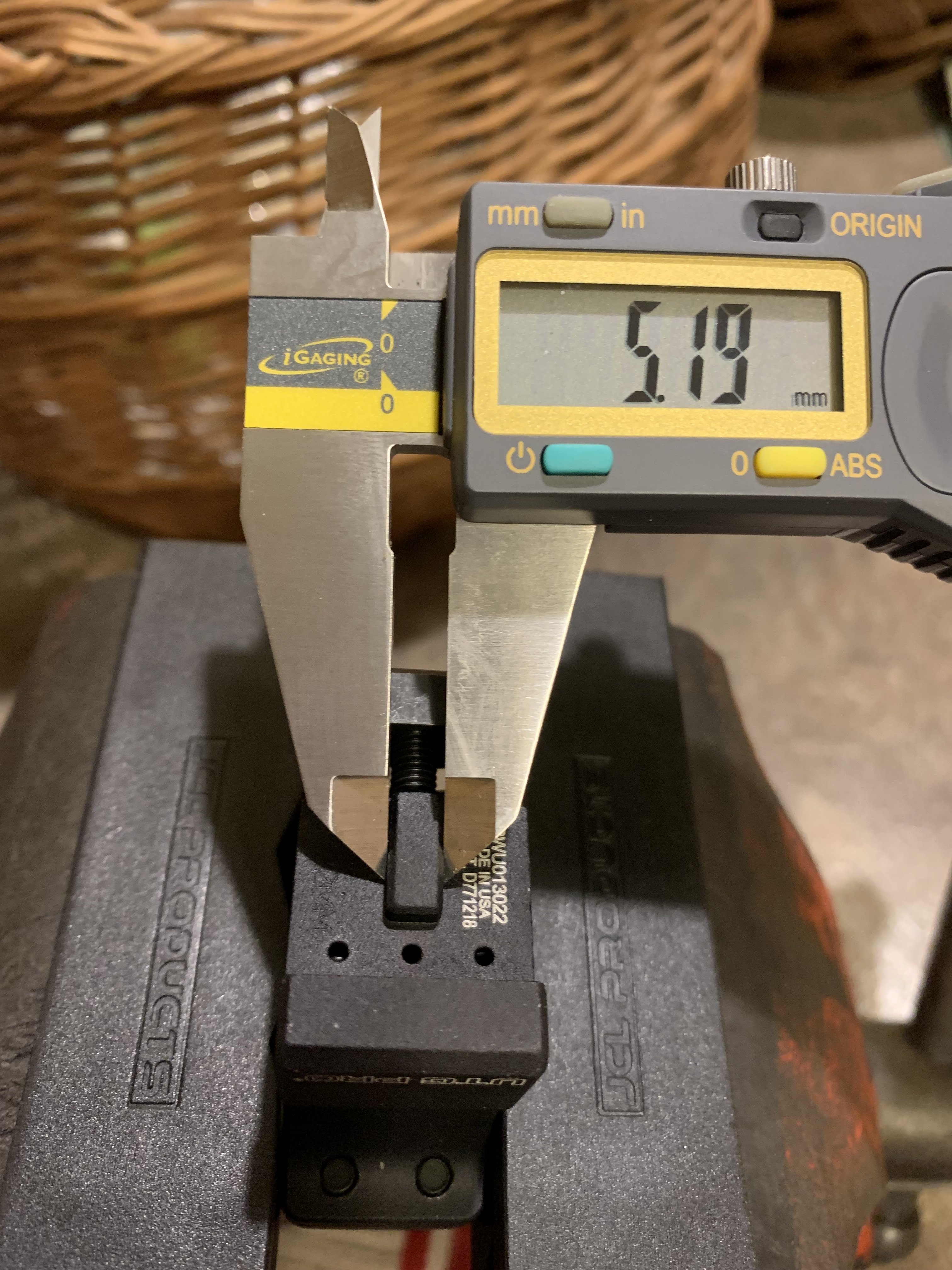

It took a while, but I finally solved the problem. The grooves on the Akelas' scope rail are indeed narrower than spec. A little research tells me that the grooves for a Picatinny rail should be 5.25mm in width. The Akelas' grooves are only ~4.89mm wide with the cross bar on the UTG rings being ~5.19mm in width, so of course they didn't fit. I ended up returning the UTGs and purchasing some Leupold Weaver rings. There is, of course, more slop than there should be, but pushing them forward as far as they go and tightening things down fixes that.
So, yeah, buyer beware. And unless Akela scope rail dimensions vary wildly (both my first and second Akelas have the same problem), none of them are properly specced Picatinny rails.
