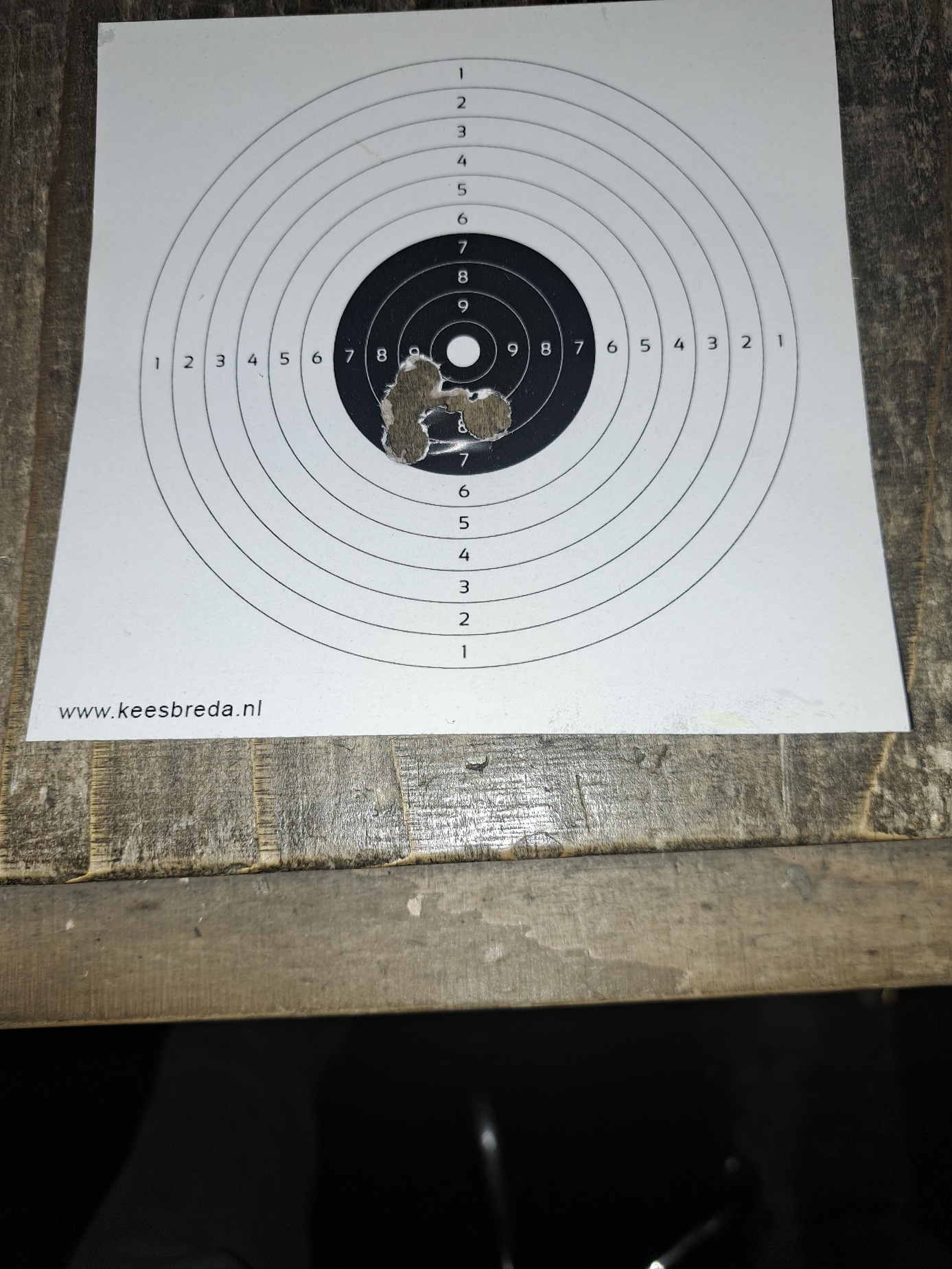

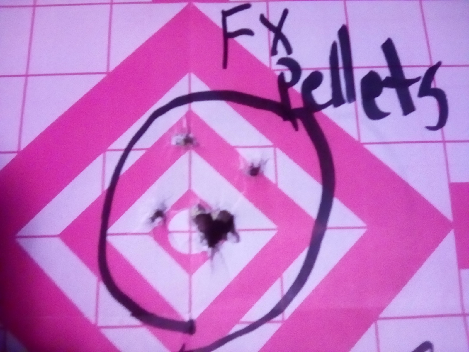

I picked up one from the same deal as @bearair. Here's a quick report on it as it came out of the box. All I did was run a few patches through the barrel and mount a scope to get it on paper.
It is sending the 82gr Snowpeak domes out at 830fps (126fpe). The report makes me think it's wasting air so that will probably be the first thing I address.
Here's the first attempt with the Snowpeak domes at 50 yards.
While that's not an impressive group, given the reputation of Snowpeak pellets, I'm actually pretty optimistic about it. Better pellets will be here next week, and it can only improve with some barrel work.

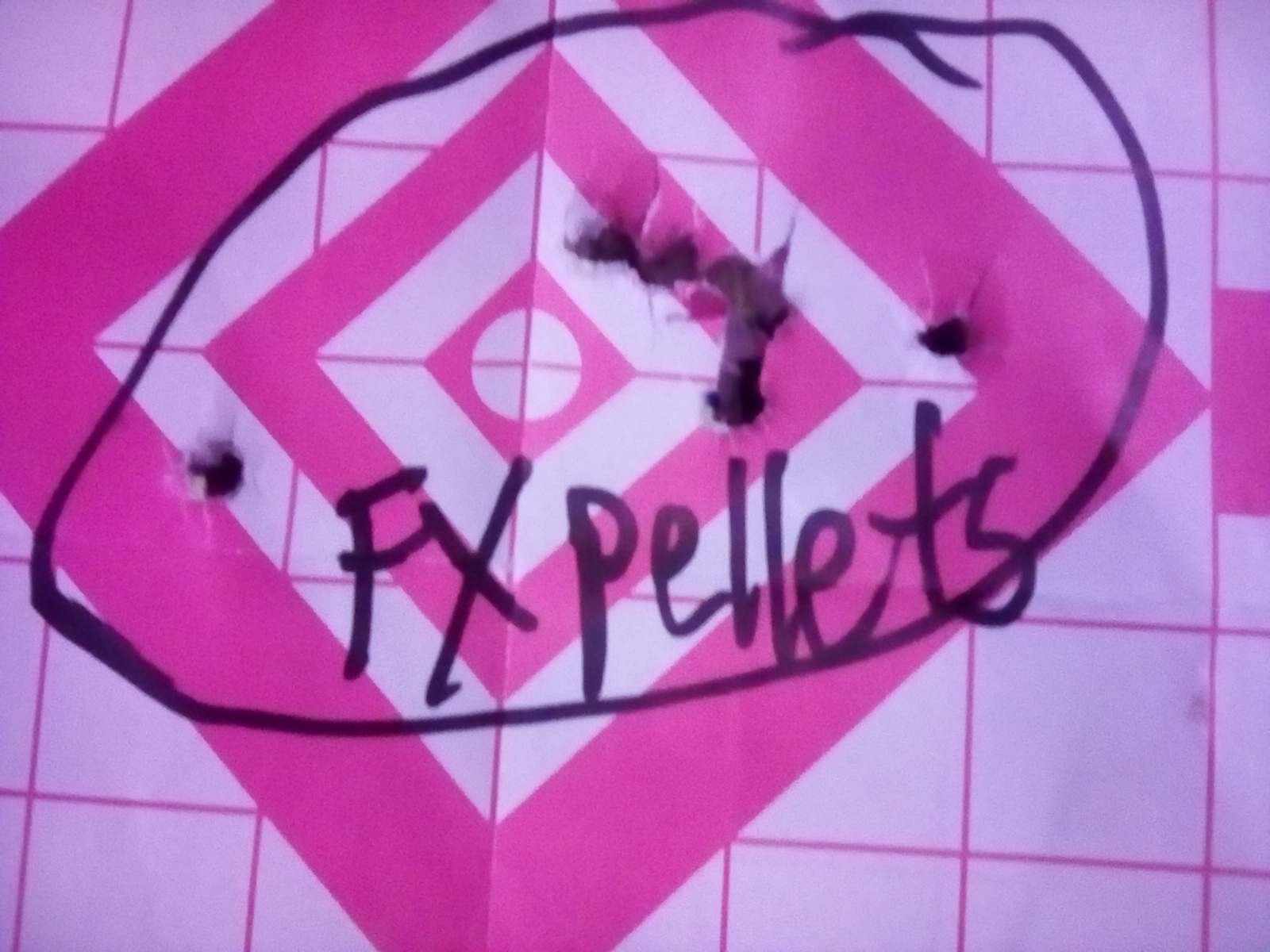

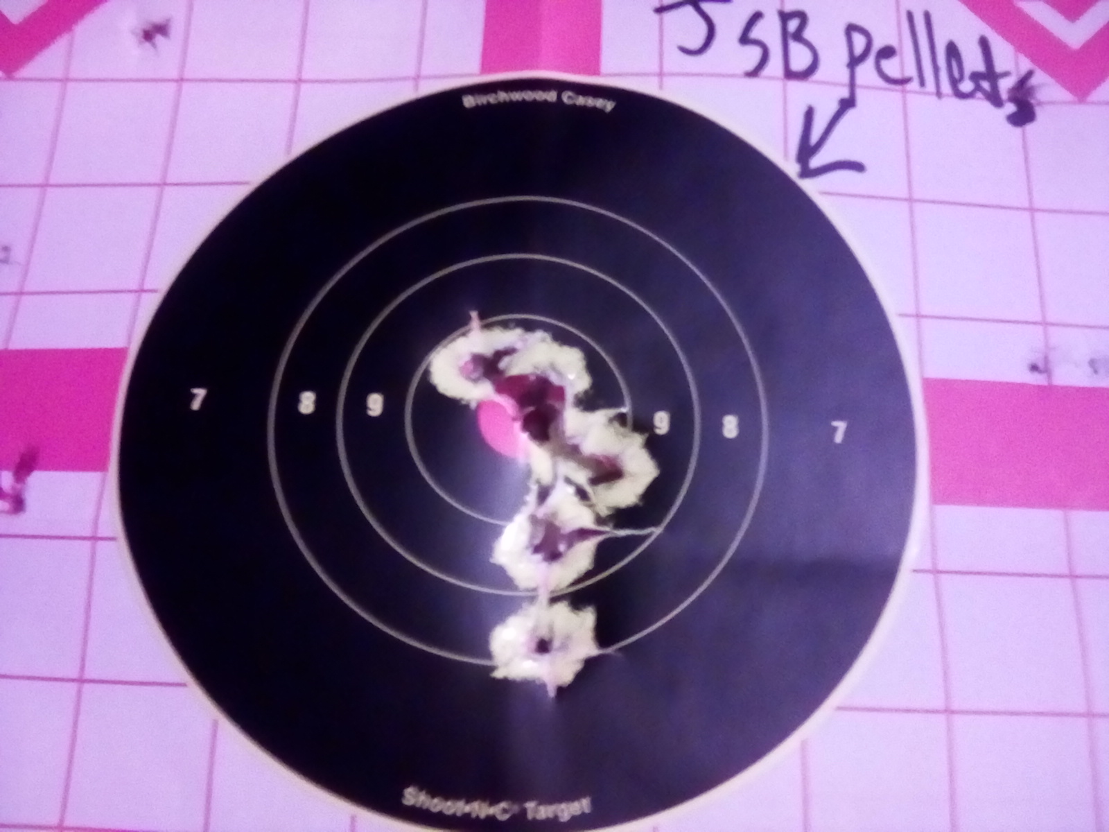

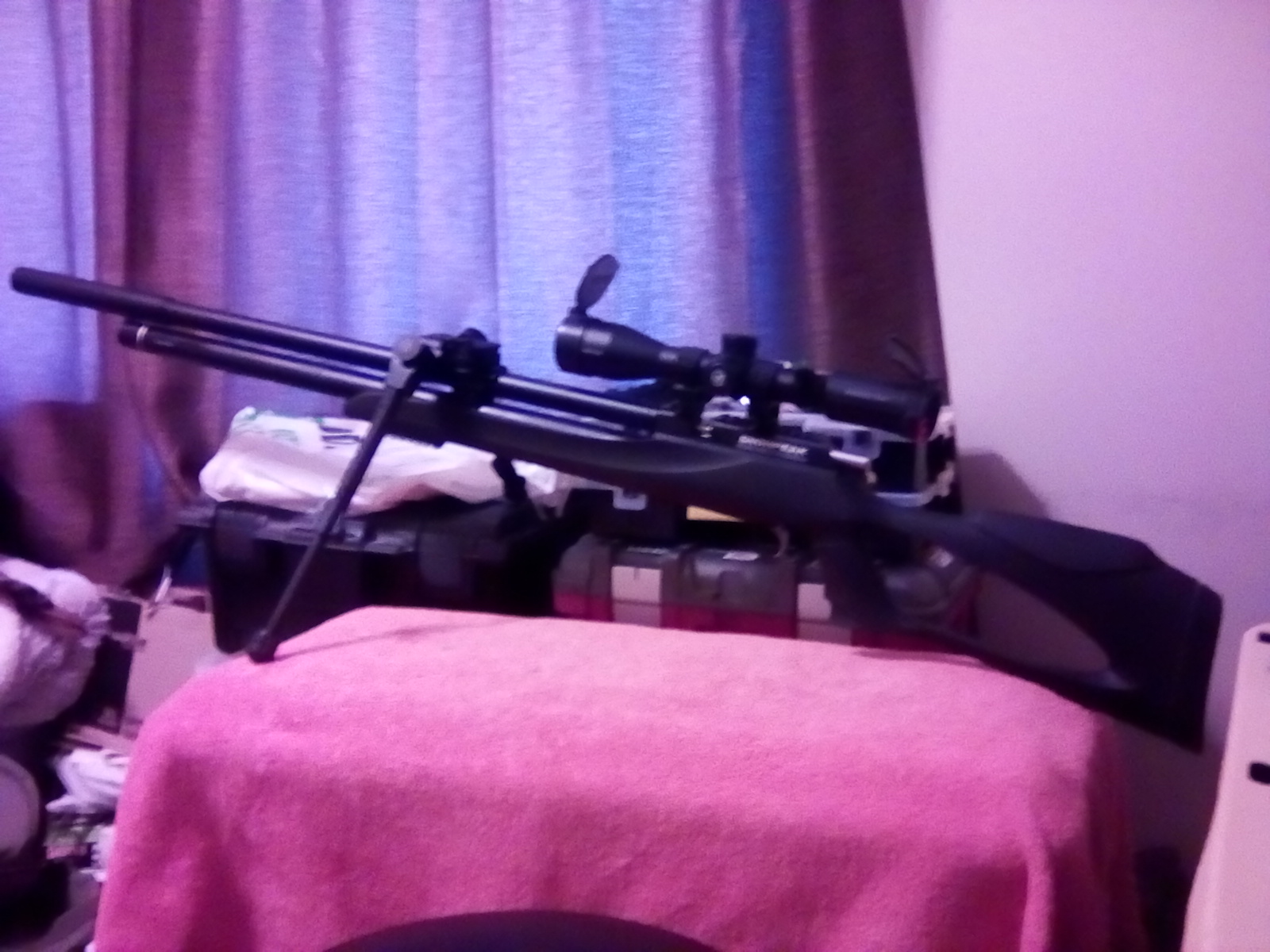

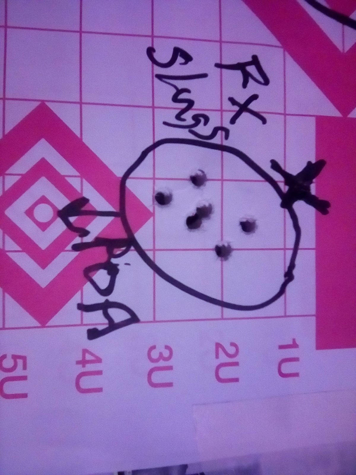

I got the Utg overbore bipod and vector optics 10x44 on it today. I had to open the channels on the barrel picatinny rail with a file to be able to attach the bipod attachment. I'll either blue the bare spots or get a paint marker. Not that it matters because I plan on leaving the part on there all the time. This gun is way too big for me to walk around with lol. I'll get some pictures eventually. Next up is cleaning the barrel and taking it out to sight it in.
Reactions: Florida_Man
Also keep in mind it's new to me so there could have been some operator error too lol. The bipod has such a wide stance it sits nearly on the edge of my Altima trunk lid at sits on the very edge of the rear window. I will have to take my folding table and chair out next time and see if the groups are better. In all reality all three projectiles were moa of yote at 50 yards.
I found out that shooting of a sandbag had better results than with a bipod.

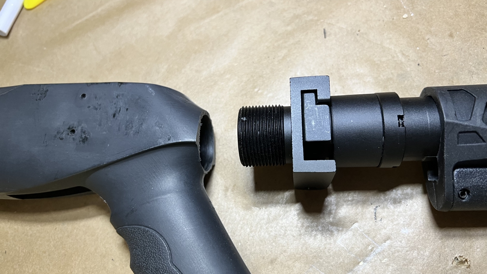

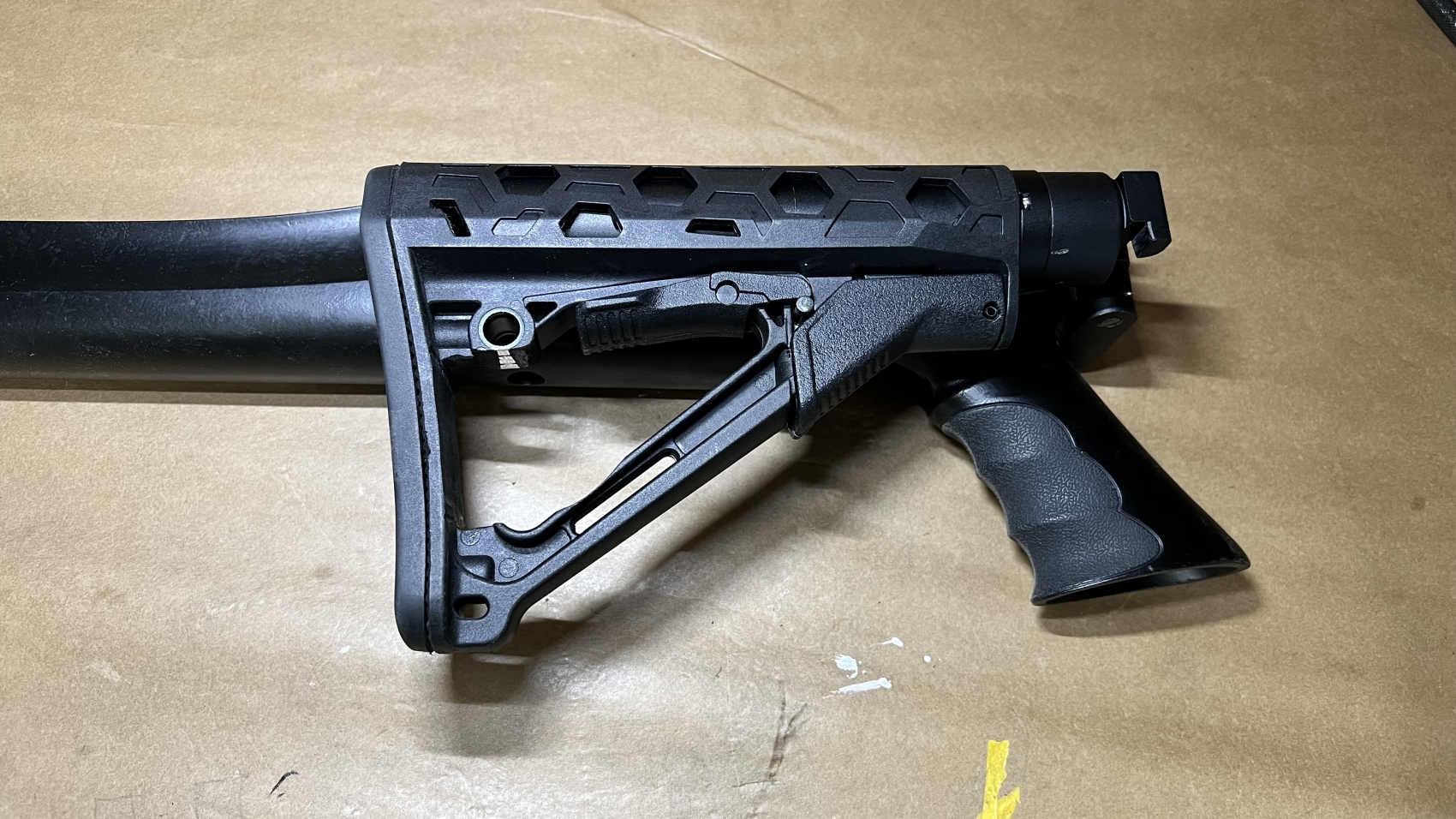

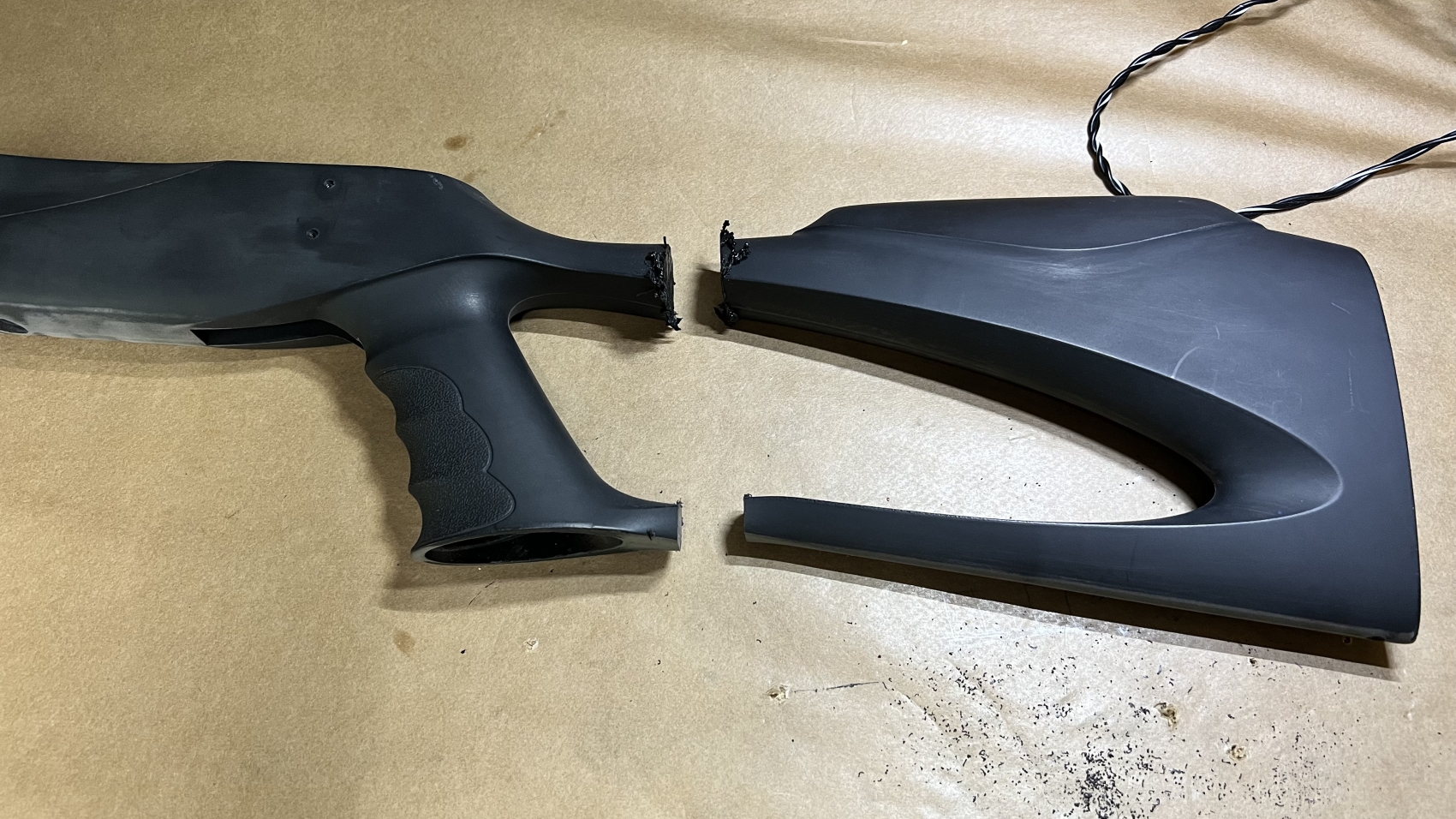

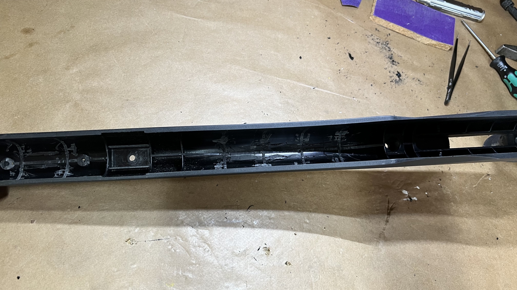

The plastic stock of the m25 feels pretty heavy and wanted it a bit shorter so i grabbed the hacksaw and powerdrill.
Yikes, the first cut always feels wrong

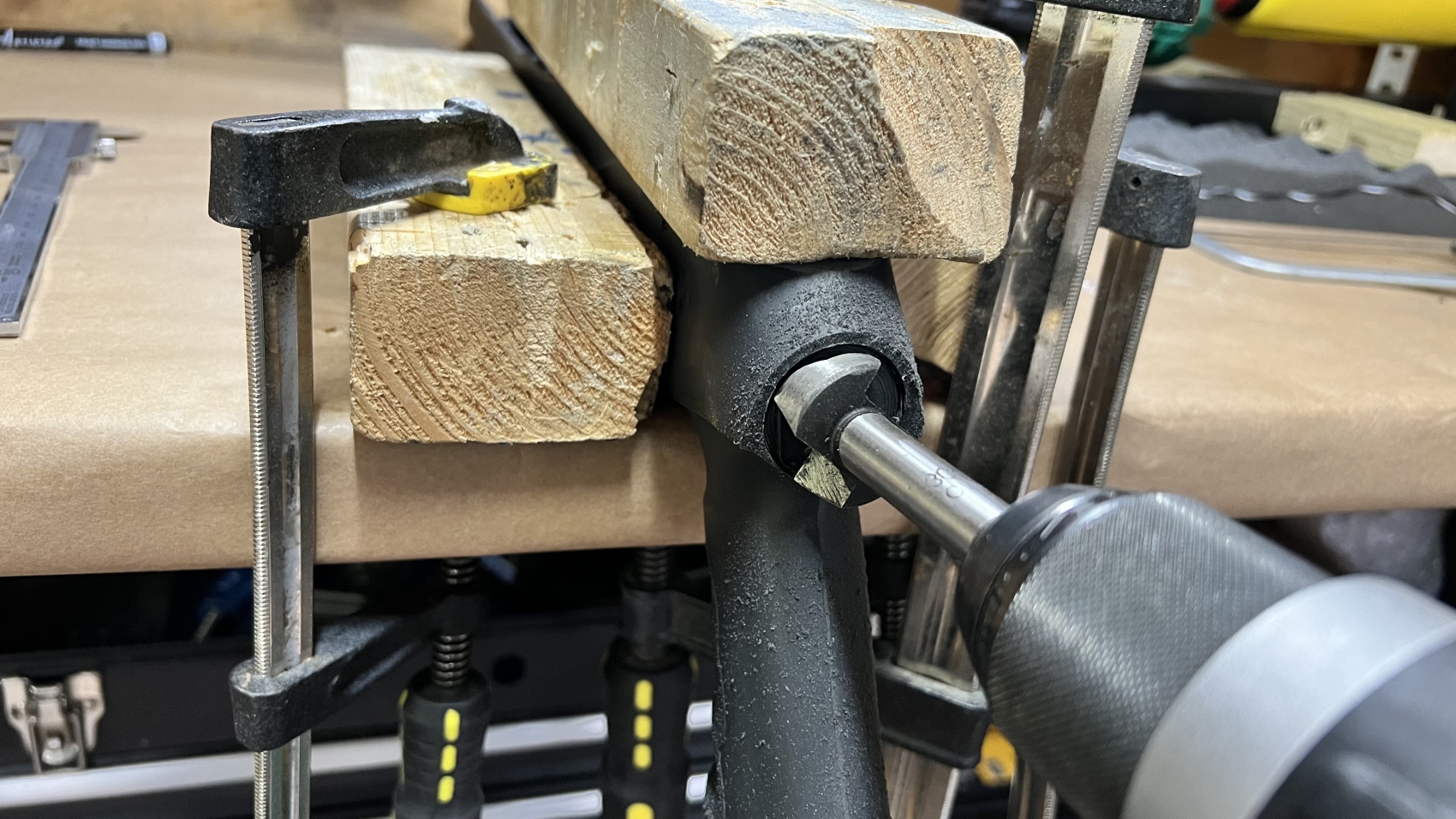

The back of the stock drilled out with a 30mm drill bit to hold a folding adapter
The folding stock came from some Chinese seller, i wish i had paid more for a decent one...
The inside of the stock on most places cleaned out except around the trigger and mounting places

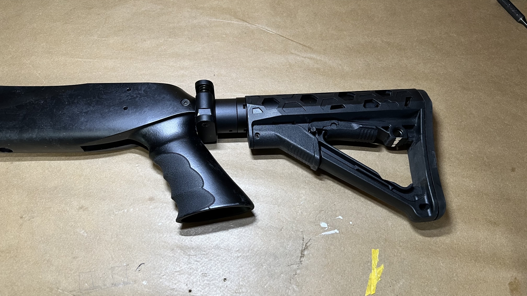

The stock adapter glued into place with some epoxy resin and two m5 screws to keep it in place

i have so many questions mate!
1) did you create some "bolt pass" for the ar15 adapter screw? (i don't know if thats the right term)
2) did you just pushed it in and epoxy glued it? And only used one m5 screw to secure it?
3) i found the ar 15 adapter on aliexpress but it makes me choose between "AGG version and GBB version" so which one?
4) an airsoft ar 15 butt stock is eligible since pcp and airsoft are of the same "family" right?
5) why did you cleaned out the inside of the stock?
6) is it sturdy when aiming?
