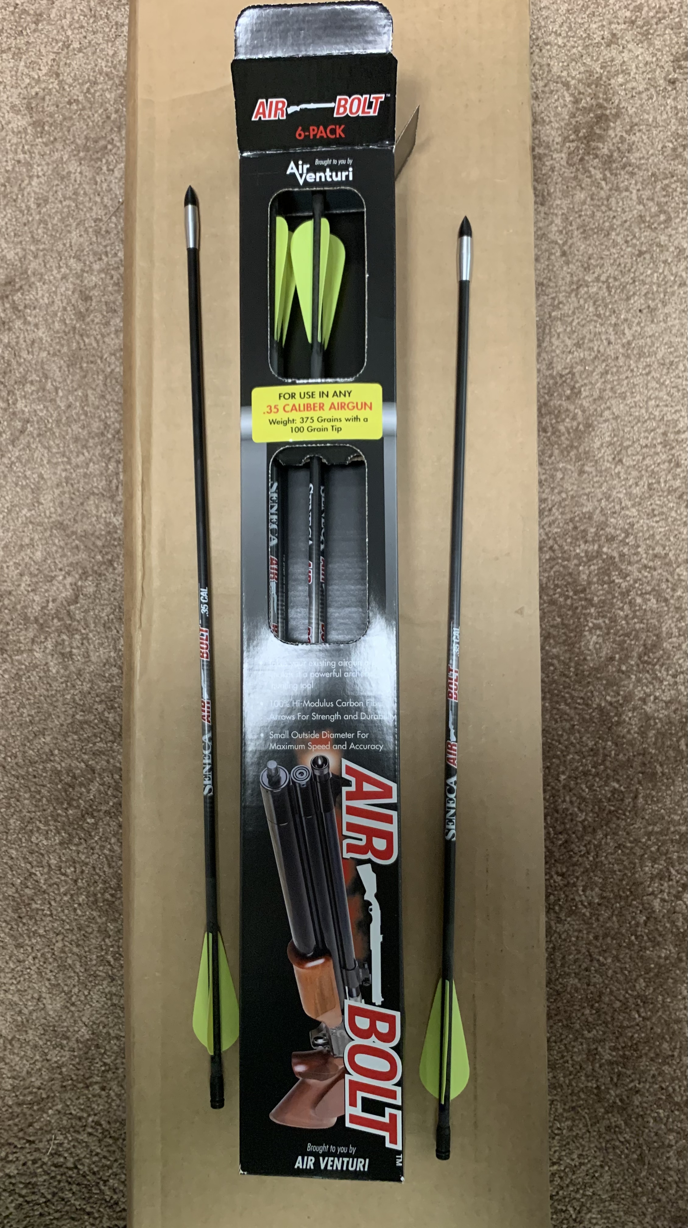

First let me say this….I have no clue what I’m doing with these. I’ve only seen them used on YouTube. I’ve been saying I’m going to grab some for over a year and recently got them. They don’t look like much and I need to grab some broad heads. Do these look sufficient or do I need a different type of airbolt? If I get a rifle to shoot them well, then I’m looking to bag deer and hogs with em. @AirArcher66 I can definitely use your assistance. Figured I’d start a new thread.

Yup these are the ones you want, the 28" barrel on the Bulldog might be a bit to long to get the full potential from the bolts but shouldn' be to bad.
Trust me it will be fun figuring out the right backstop, make sure you don't destroy to many arrows in the process 😄
I highly reccomend building one like I described in the other threads and replace the field points with eithr 100gr or 125gr steel blunts.
