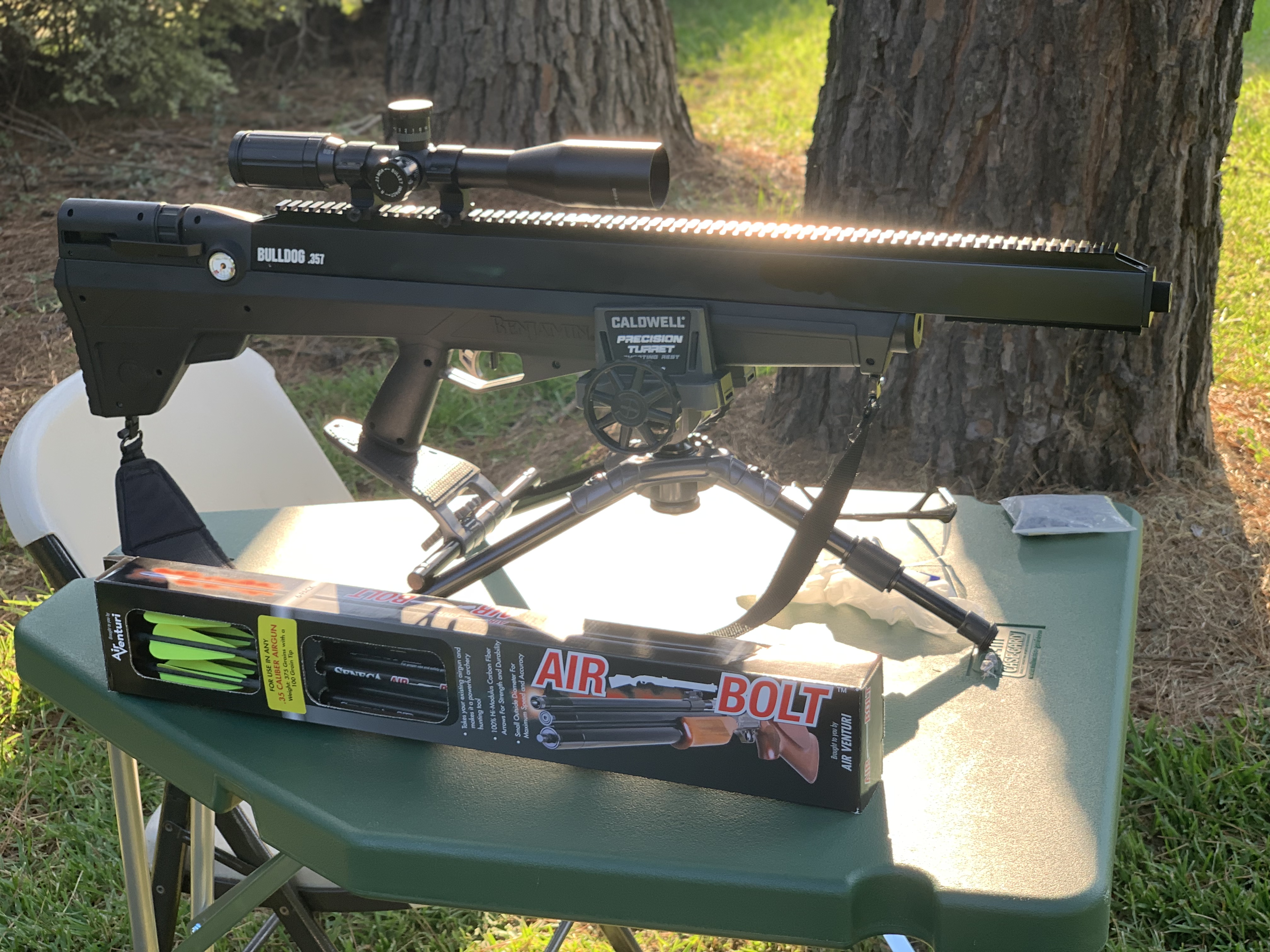

.35 Air Bolts for the .357 Benjamin Bulldog

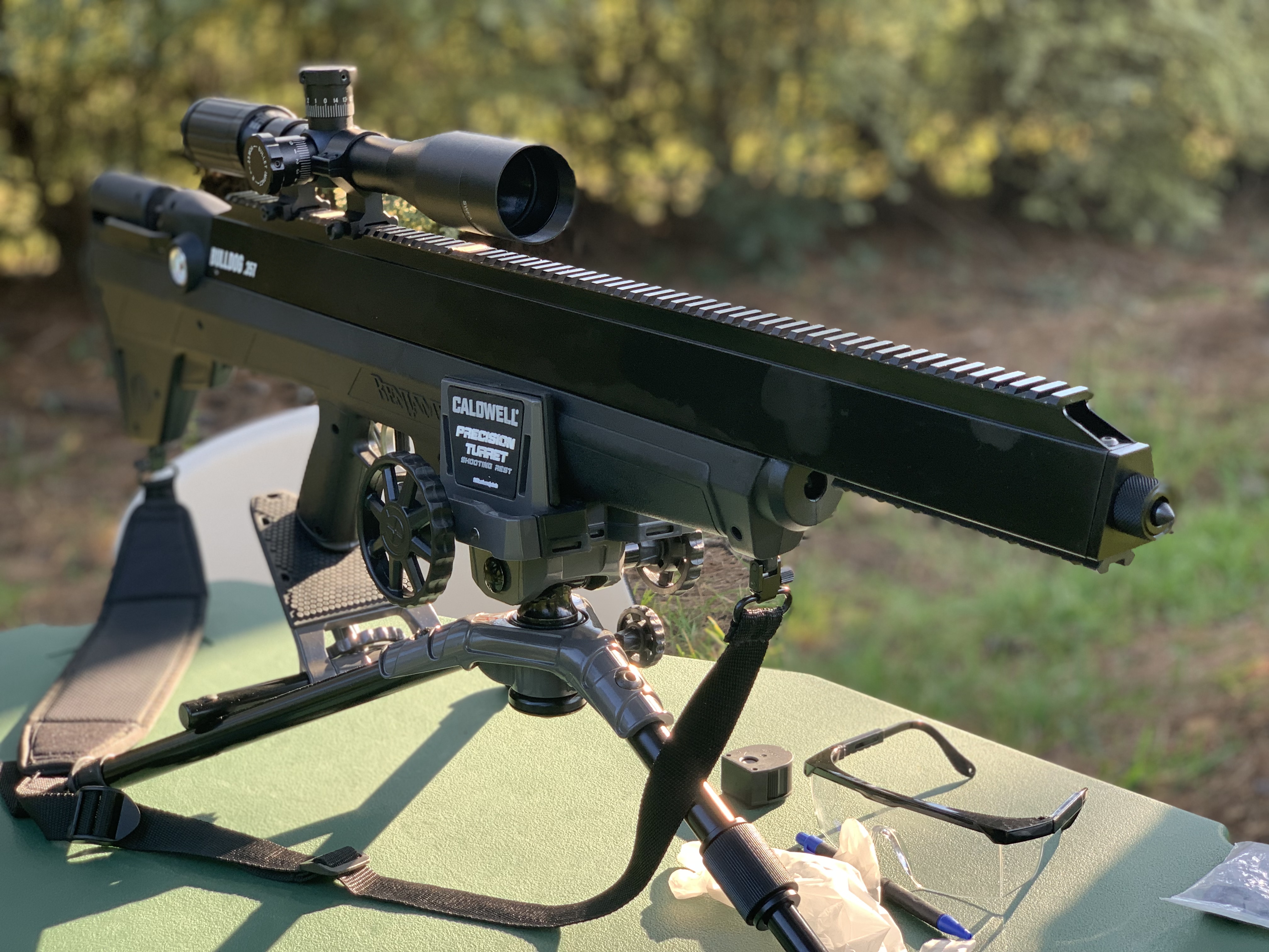

@AirArcher66 I just thought of something. Considering the shape of the Benjamin Bulldog shroud I may be able to get away with removing the end of the shroud that contains the adapter to affix a moderator. I’m not certain, but I wonder if there is a way to rotate the bolt so that the broadhead drops down into the shroud with the end cap removed. I will have to try it and see. I really don’t want to cut the shroud if I can avoid it.

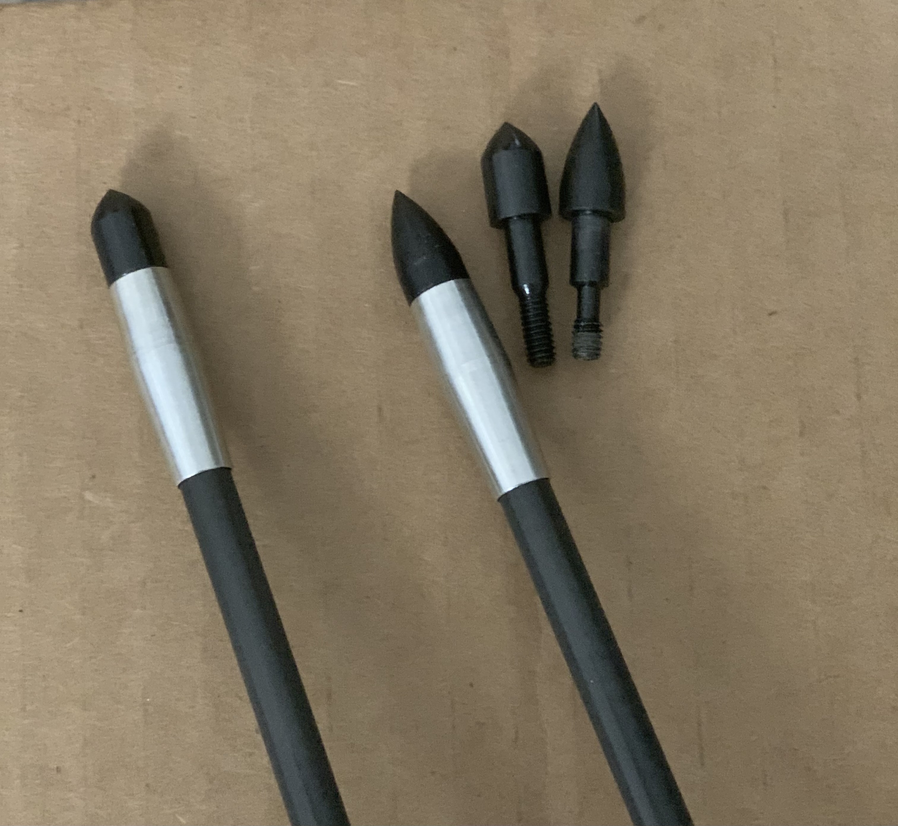

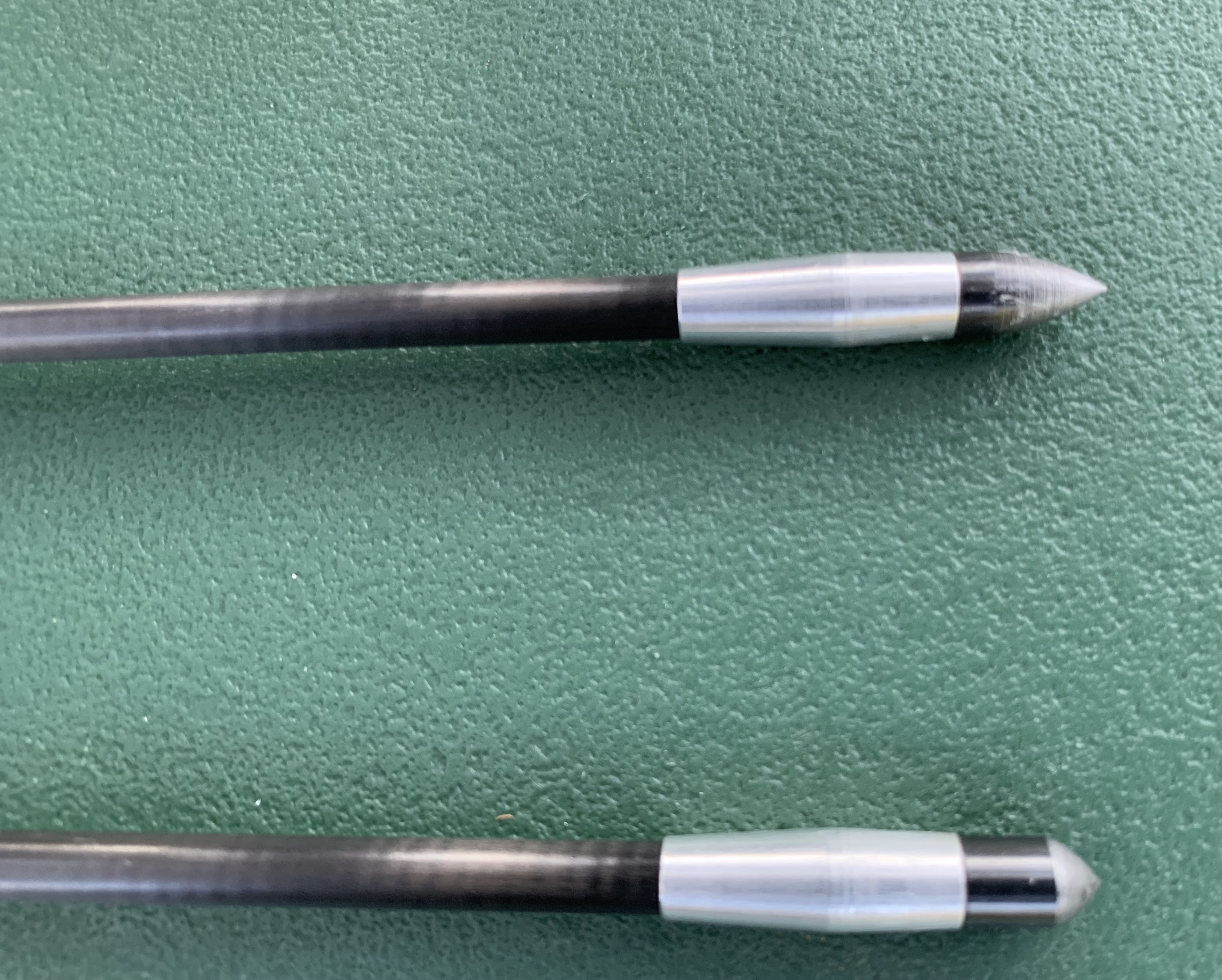

So after grabbing some 100 grain bullet point tips (pictured on the left side) I realized that the field tips that come with the air bolts are also 100 grain (right side). They were cheap so I intend to compare penetration between them on the target. I’m hoping that the bullet tips have less penetration due to their shape. I like that they have more thread than the tips that came with the bolts.

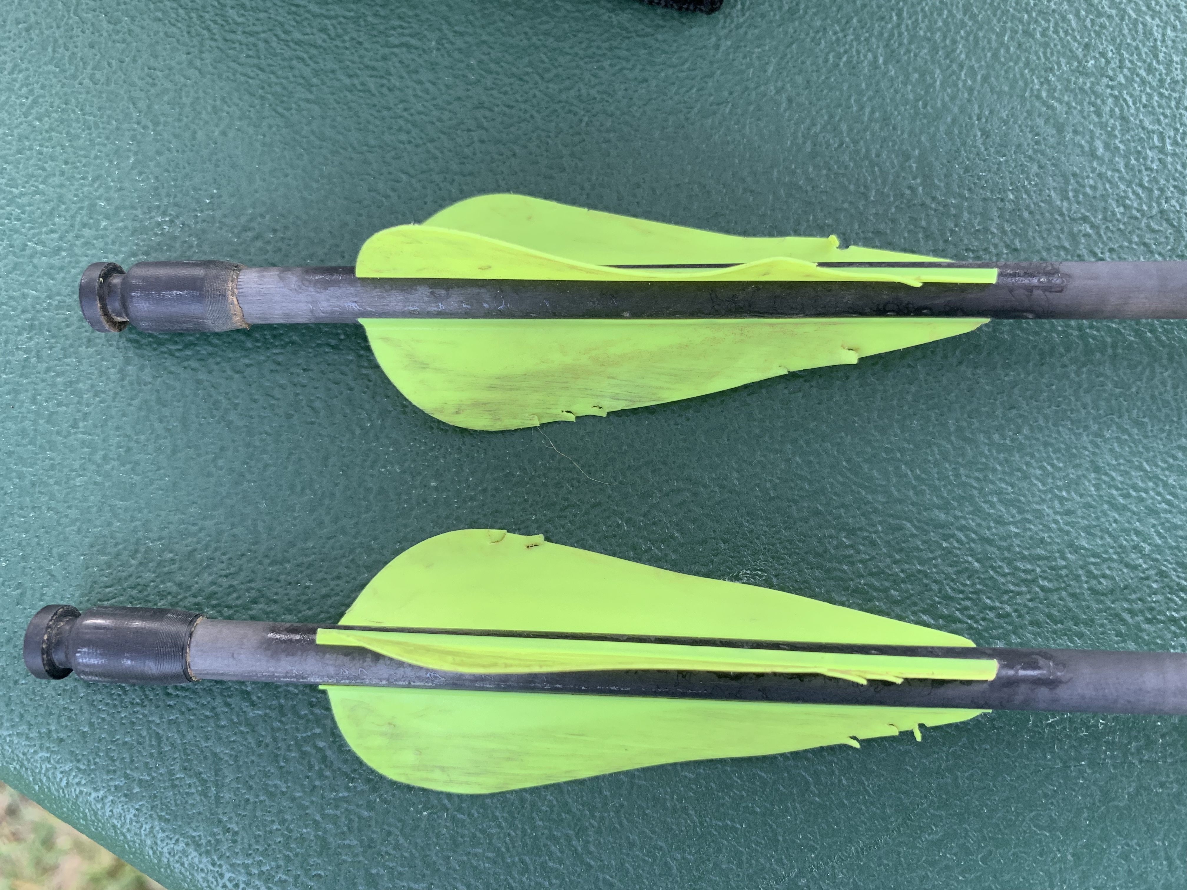

Remember that your arrow will come out the barrel rotating ( like a bullet does ) so both Broadhead and even more the fletching will touch the shroud.

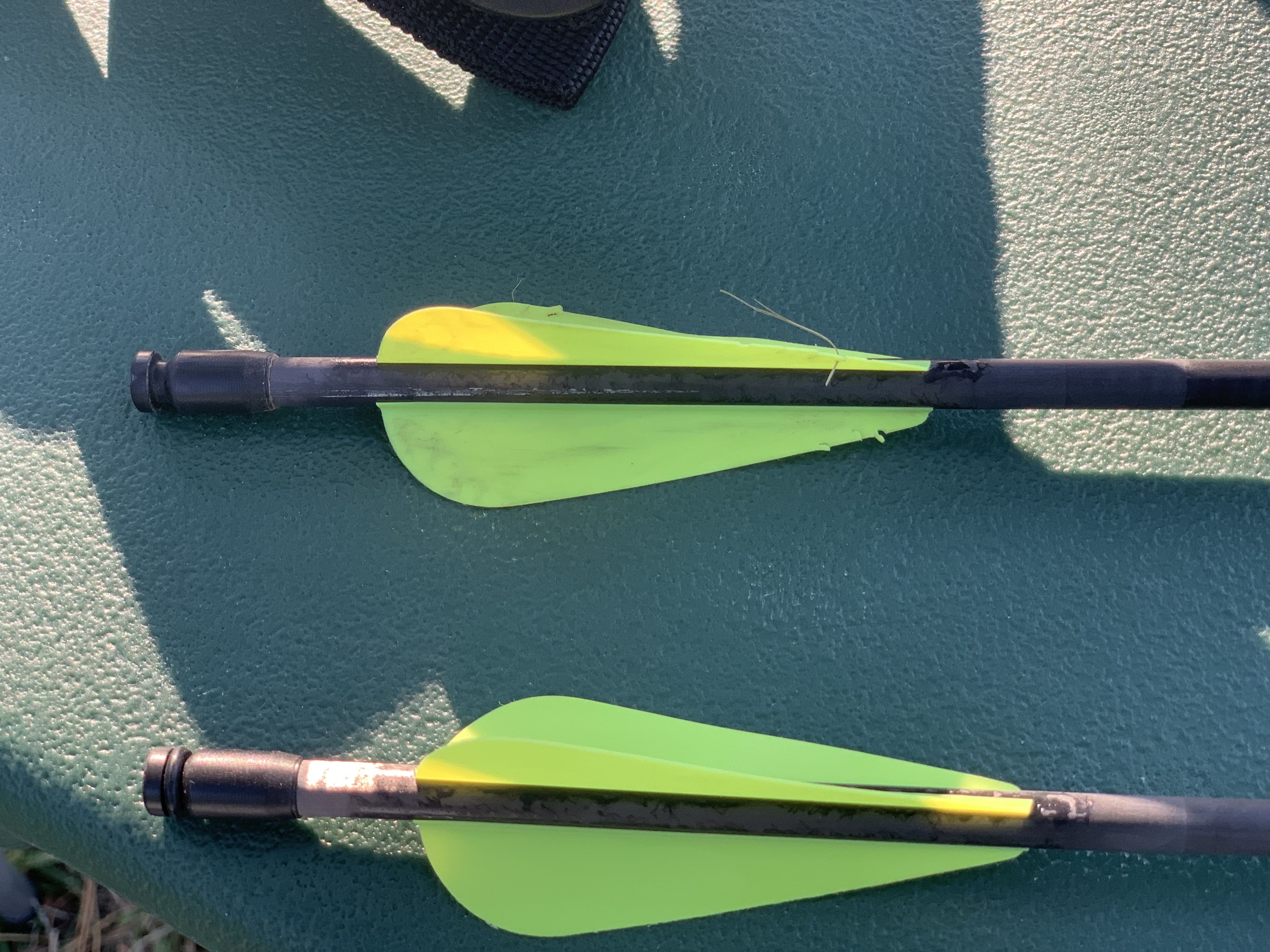

I retrieved the bolt and I noticed that the rifling or maybe the shroud adapter tore into the fletching. I also blew the o-ring off the end of the bolt (I’d read in a review that this would probably happen). Here’s a side-by-side comparison of the used bolt and one that hasn’t been fired yet.

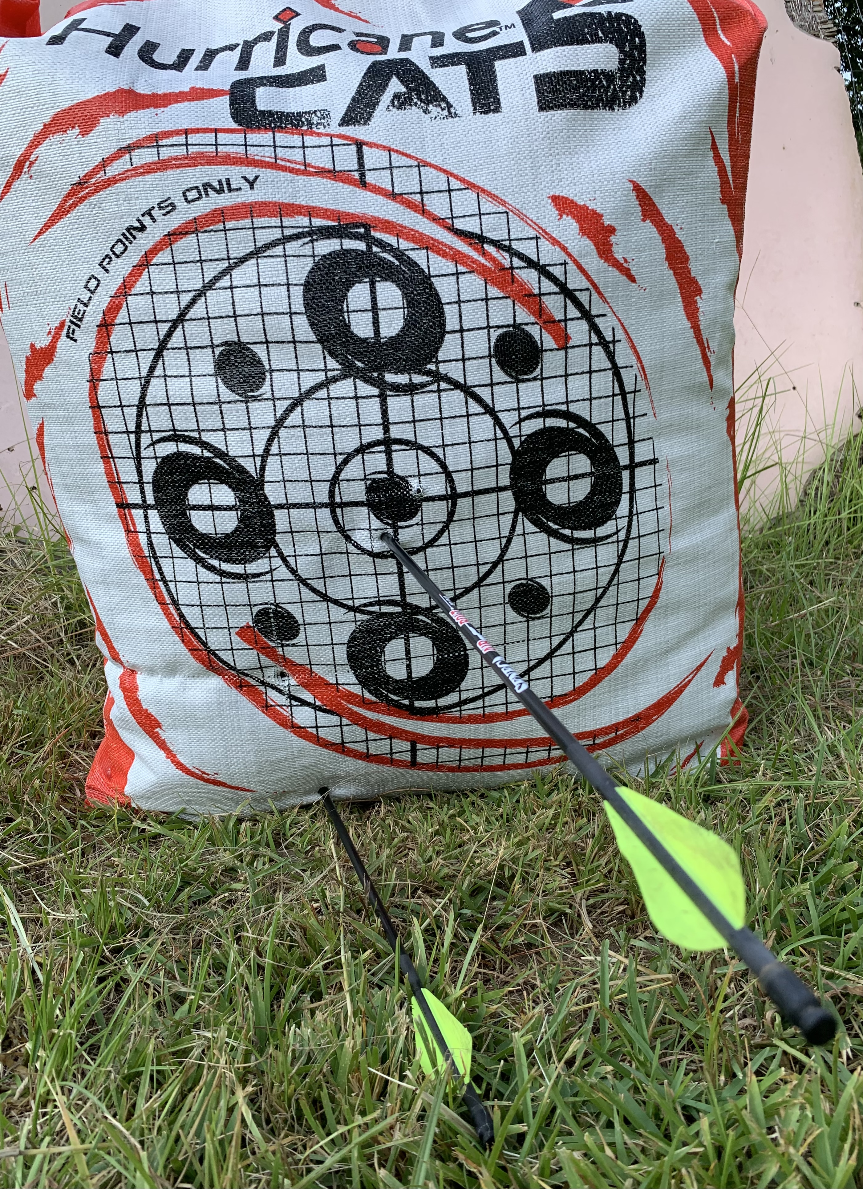

After taking the first shot I filled the reservoir to approx 2800 psi. Here’s the next shot after the fill.

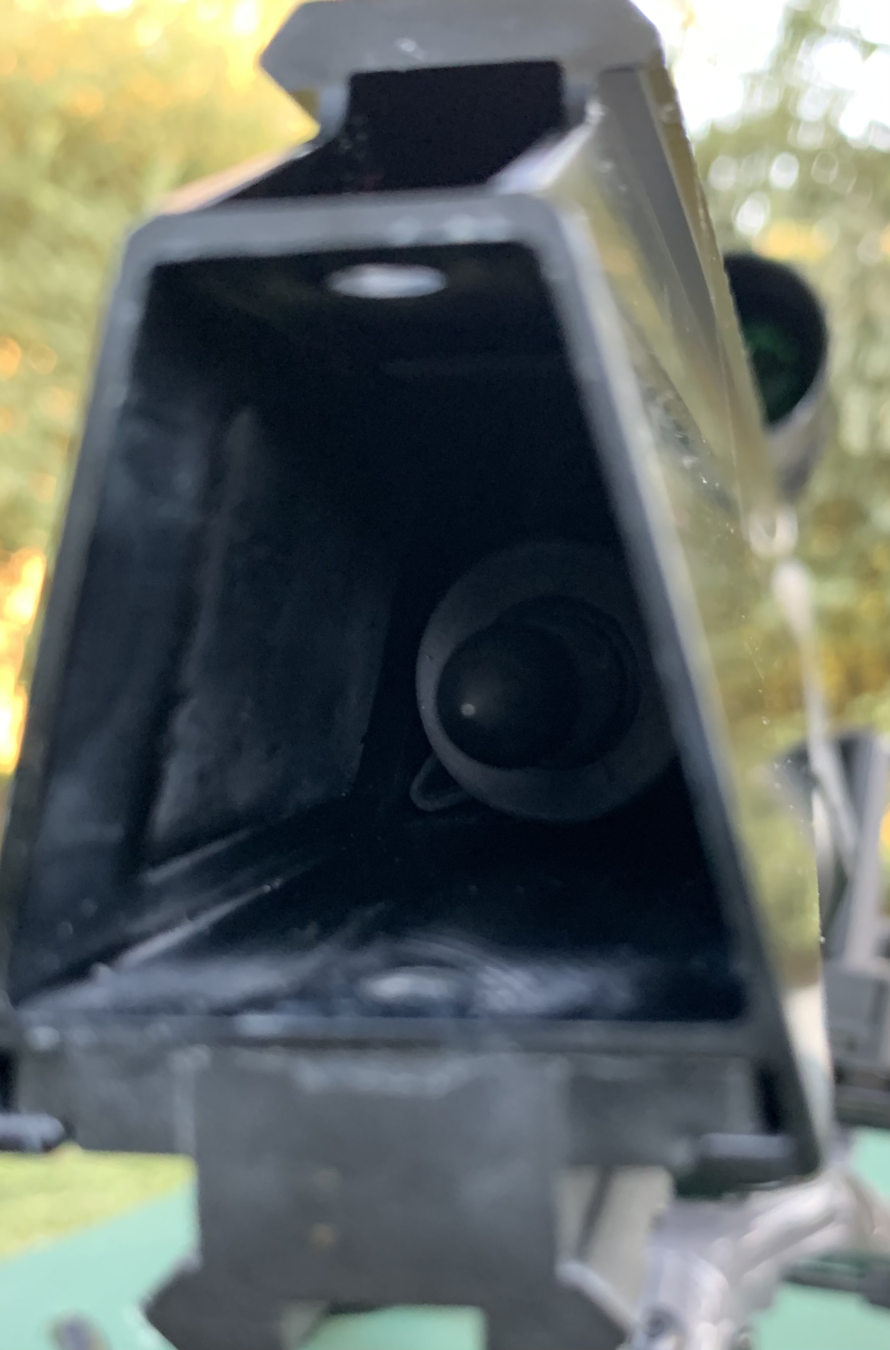

Then I removed the Donny FL shroud adapter endcap which is an aftermarket shroud endcap. I have not shot these bolts using the factory shroud endcap. This allowed me a little more room to work the bolt in about another inch or two. The bolts have to be twisted with the riffling down into the bore starting gently as to avoid tearing the ends of the fletching.

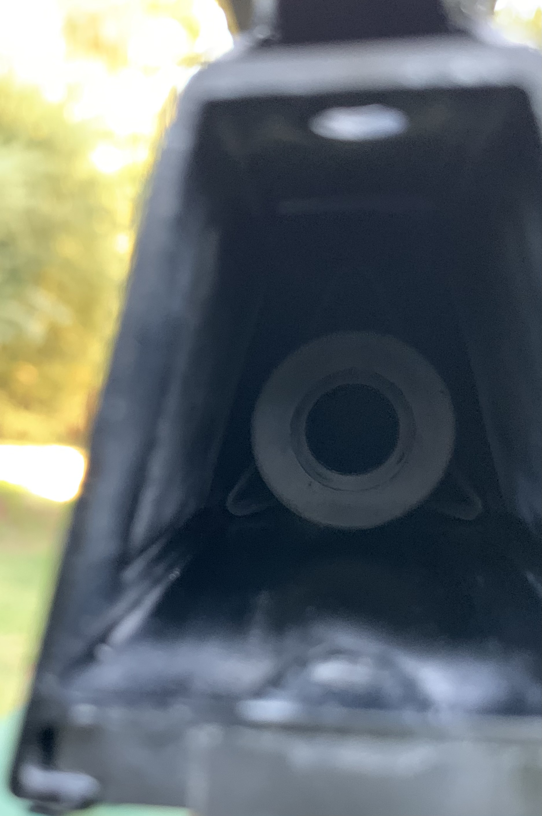

A look at the space between then end of the barrel and the end of the shroud. The rounded ends on the bottom and top is some sort of factory barrel support. Behind it are three additional supports purchased from Pitbull Airguns.
Here’s a look at the bolt pushed all the way down to the nock. It felt like it was resting against the transfer port valve.
I only fired the same two bolts repeatedly because I don’t know how to keep the fletching from getting torn up yet. The bullet styled field tips seem to be better quality than the Air Venturi tips that came with the bolts.

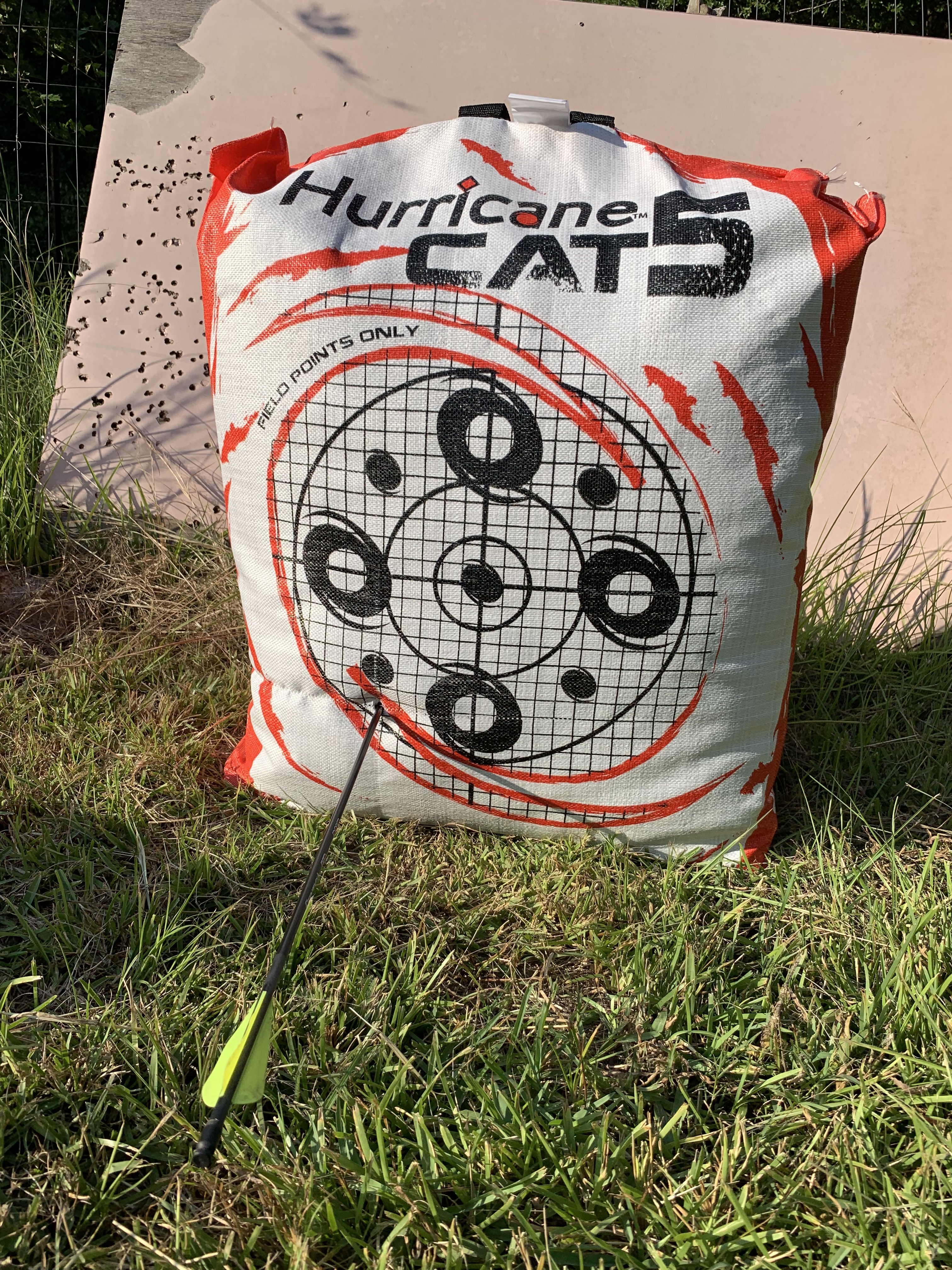

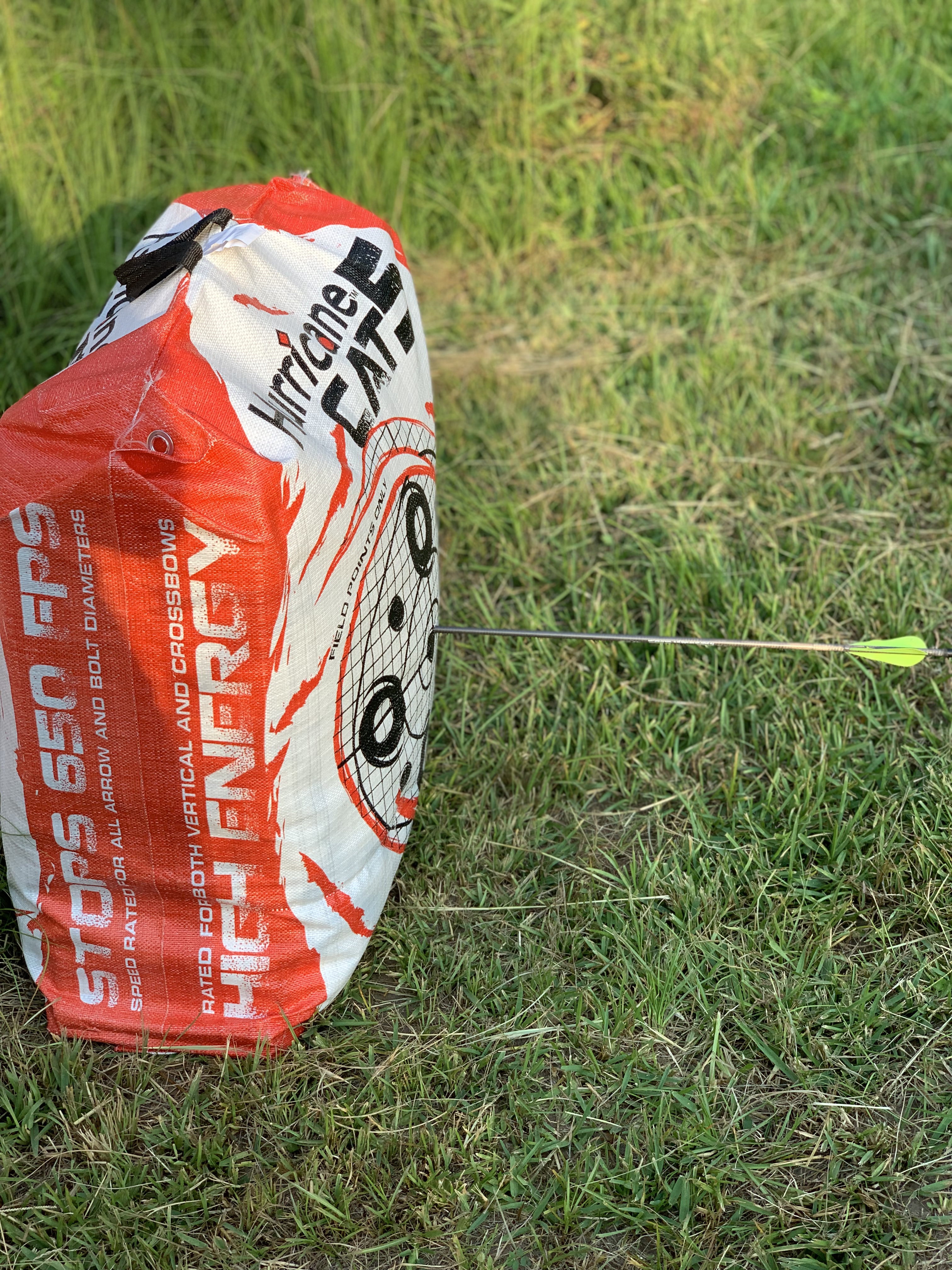

From the looks of things I can get one, maybe two good shots with this stock Bulldog shooting these 375 grain bolts from within 50 yards. I think that’s a sufficient distance to take a deer from a tree stand shooting a broadhead, but I’d like to see what velocities this gun is producing with these bolts before considering shooting one from ground level. I’d also like to practice a lot more.

@AirArcher66 I didn’t even think to look into the breech with a flashlight while a bolt was loaded. If 125 minimum is best with these types of heads, I have to figure out a way to get these bolts closer to 400 grains by adding an additional 25 grains to the tips. I’m wondering if there is some sort of weight that can be added and affixed between the tip and the ferrule. Or should I be looking for heavier field tips? Also is there a way to replace the fletching once these vanes get torn up?

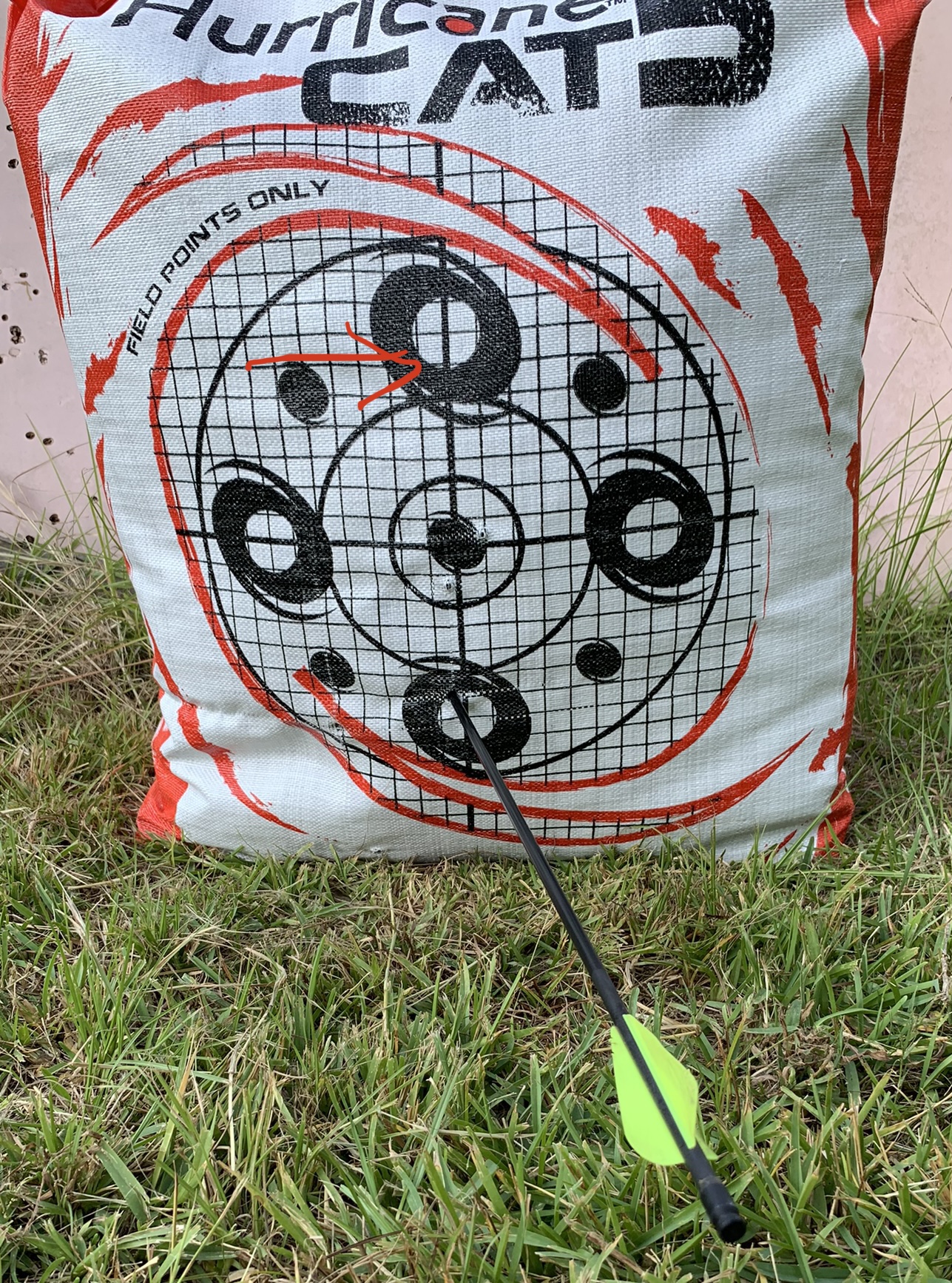

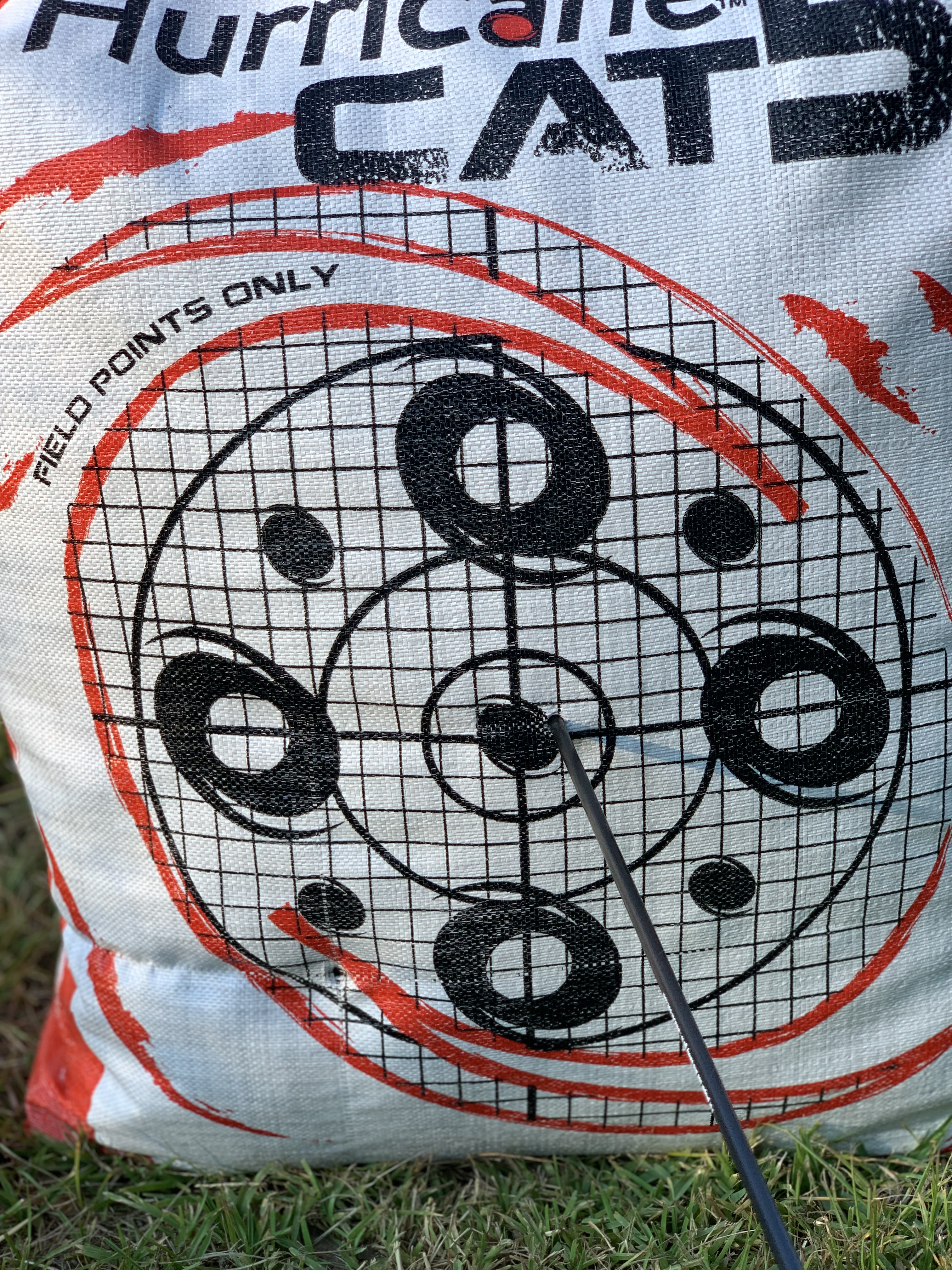

Also just by looking of the poor penetration on that target ( unless you have some kind of wood behind ) I'm guessing these arrows are pretty slow,.........it should blow throught that target like butter, hardly slowing down.
@AirArcher66 I noticed the penetration aspect as well, but since I have no personal context I don’t know what’s going on. I was thinking reduced velocity may have been because the nock was possibly resting on the transfer port valve, but that shouldn’t have been the case before I removed the shroud adaptor (used to affix a moderator). With it installed I think there was at least an inch clearance from the breech.
This was my first time shooting air bolts so I’m pretty ignorant here. One day when I can get out earlier in the day with the sun overhead I’ll be able to chronograph the bolt speeds. The target says it’s rated to stop all width archery arrows and bolts (with field tips) up to 650 fps. I don’t know if that has something to do with the lack of penetration. You think this gun is capable of pushing bolts through this target?

Never seen those targets before so I did some reserarch and seems they are real good quality and great stopping power so disregard my previous penetration comments :ROFLMAO: :ROFLMAO: :ROFLMAO: ........still I would love to shoot some of my arrows from my guns to see what would happen
