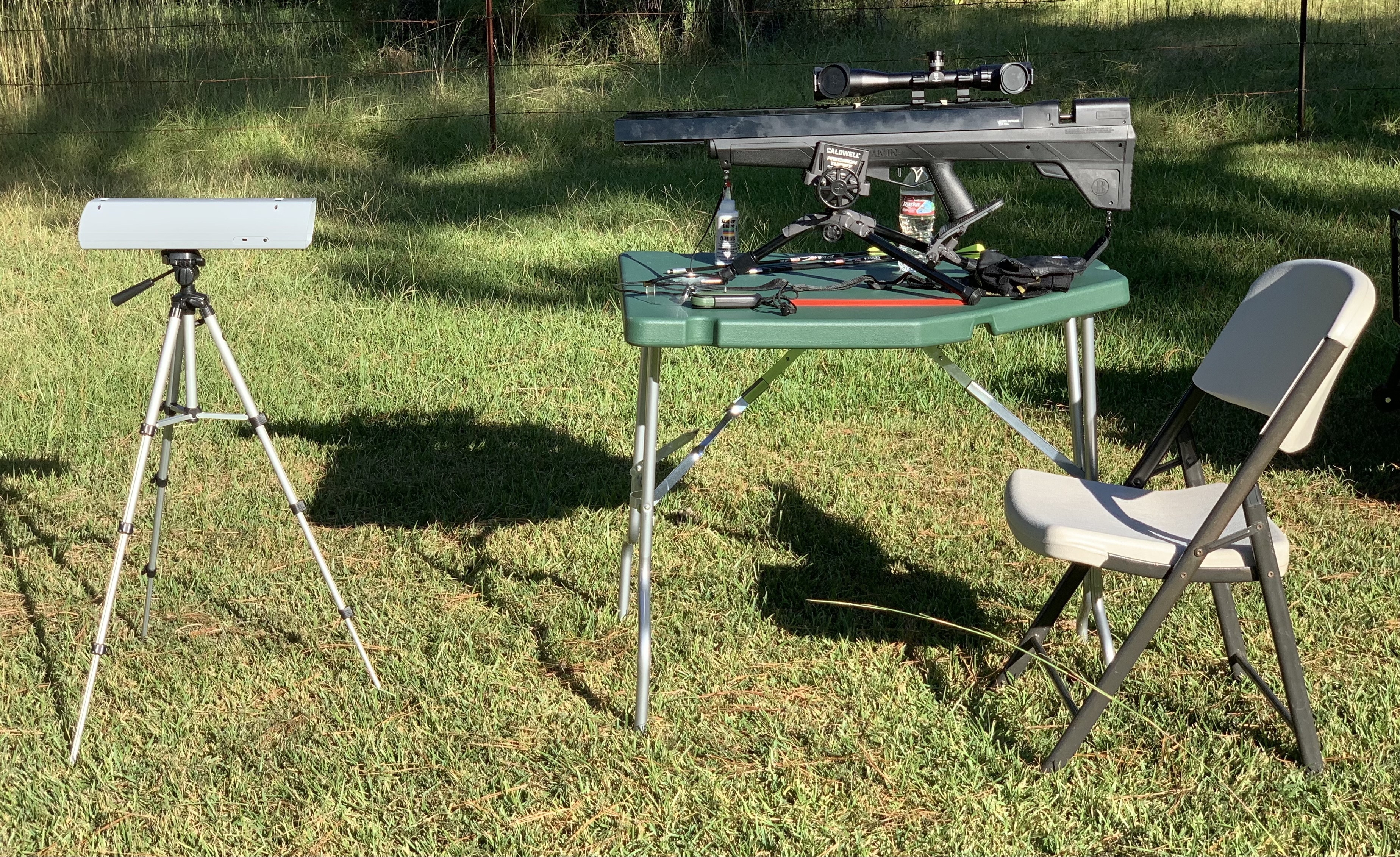

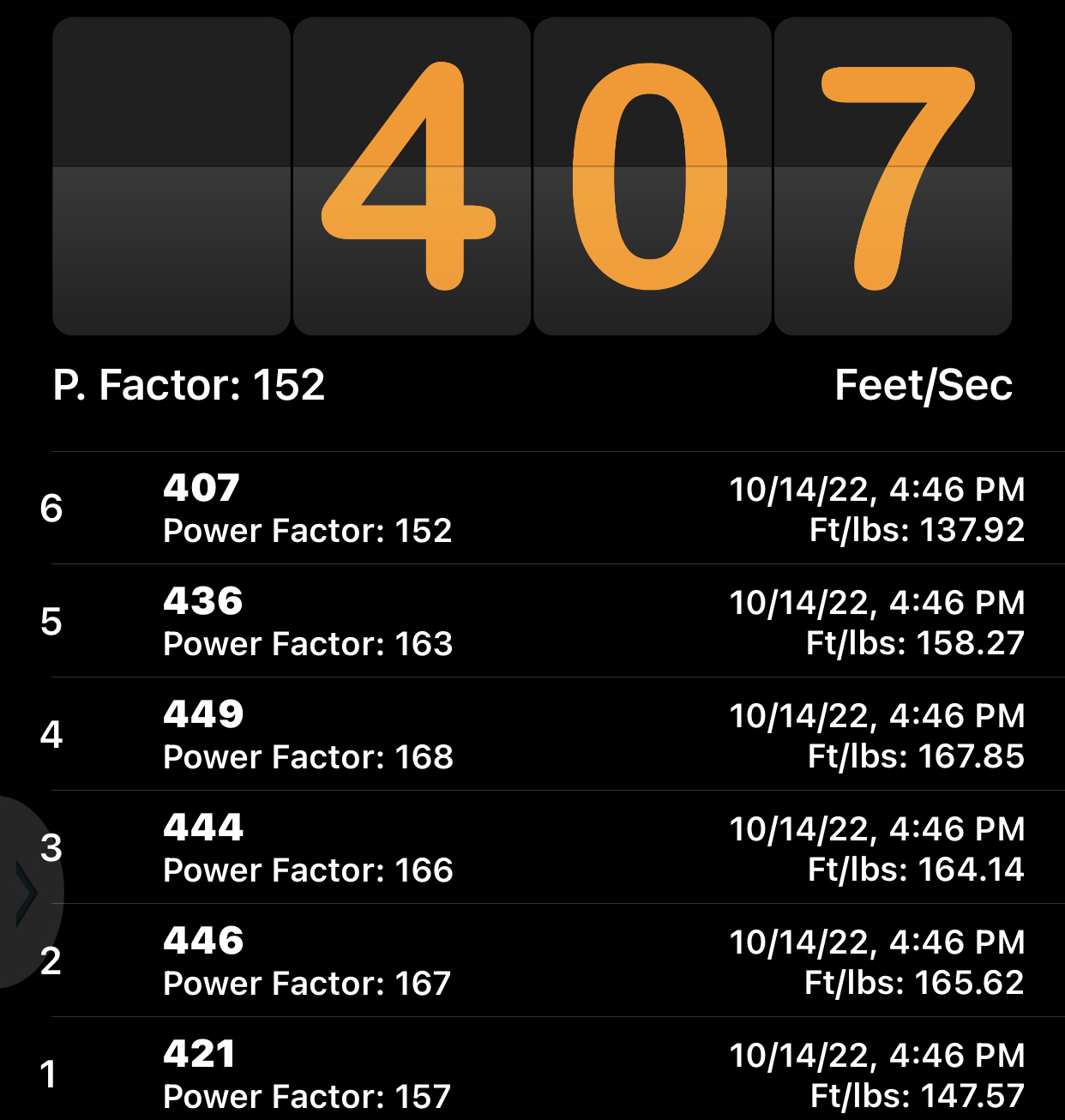

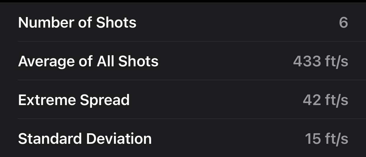

Took some time today to do some testing with the chronograph. Shooting 375 grain Seneca Air Bolts from a .357 Benjamin Bulldog from 40 yards out seated at table with a Caldwell Precision Rest.
Here is some shot string data. 6 shots off of a single fill. The last shot dropped about 5 MOA off of my POA shooting from 40 yards out.

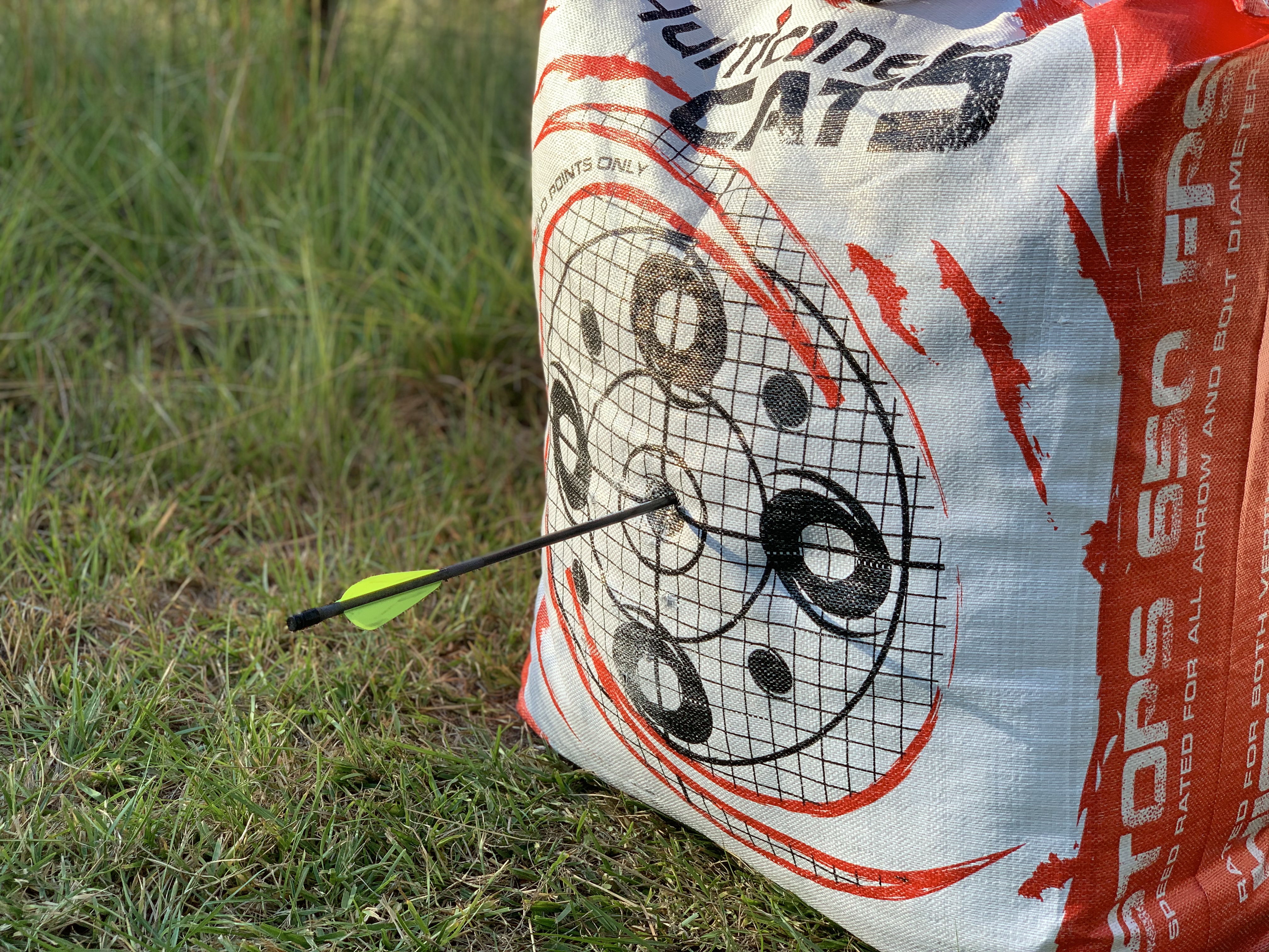

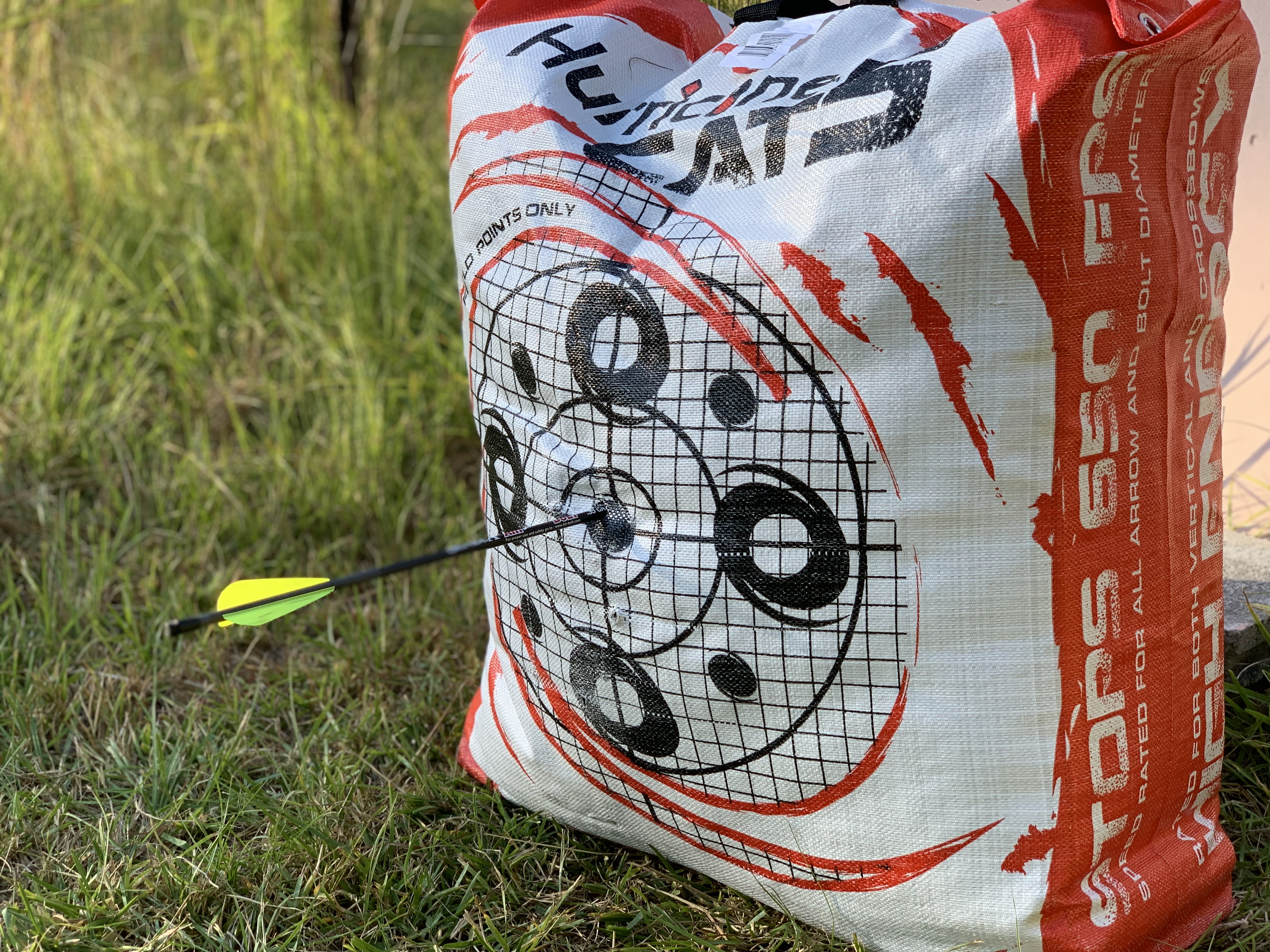

After a few shots using a new 375 grain .35 Seneca air bolt, the plastic vanes held up better than before. No apparent tears in the fletching is good news to me. I shot them from my stock .357 Benjamin Bulldog with the shroud end-cap removed. I also lubed the nock o-rings with Super Lube O-Ring Silicone Lubricant and cleaned my barrel with a Patchworm pull-through cleaning system before shooting. One or a combination of these factors changed the performance of these bolts out of this gun. I used a number of patches cleaning the barrel (I’m guessing, but probably a couple dozen patches).
With a clean barrel, the shroud end cap removed, and using a new lubed bolt I scored a 4-5 bullseyes, although none hit the crosshairs dead-center. Even the two bolts with torn vanes still flew pretty accurately with a lubed nock o-ring.
The first shot hits with authority and it appears that I can get 3-5 accurate shots on a fill. Shooting 375 grain bolts the energy range was 137fpe - 167fpe and the velocity range was 407-453 fps. One of my first shots didn’t register off a fresh top off so I’m sure I can achieve a slightly higher velocity. I will continue to shoot to see what the average number of accurate shots is. However, in theory I think I’d hit the vitals on a deer from 40 yards using a 100 grain broadhead. The issue at hand is, how would a broadhead perform either resting on top of the shroud end-cap or resting upon the barrel crown within the shroud? I’ll continue to update this thread with my findings.
The fletching and nock o-ring pictured below after concluding today’s shooting session. I’m pleased that the o-ring and vanes held up significantly better than they did during my previous outing.
Remember that broadheads do soooooo much more damage then a bullet so if you group 4-5" you still in very good shape,
Good velocity and all you really need is one shot ;) but looks like you have a good 3-4 shots on tap.
take the first shot as practice/check zero before going hunting then use shots 2, 3, 4, 5 for your hunting shots.

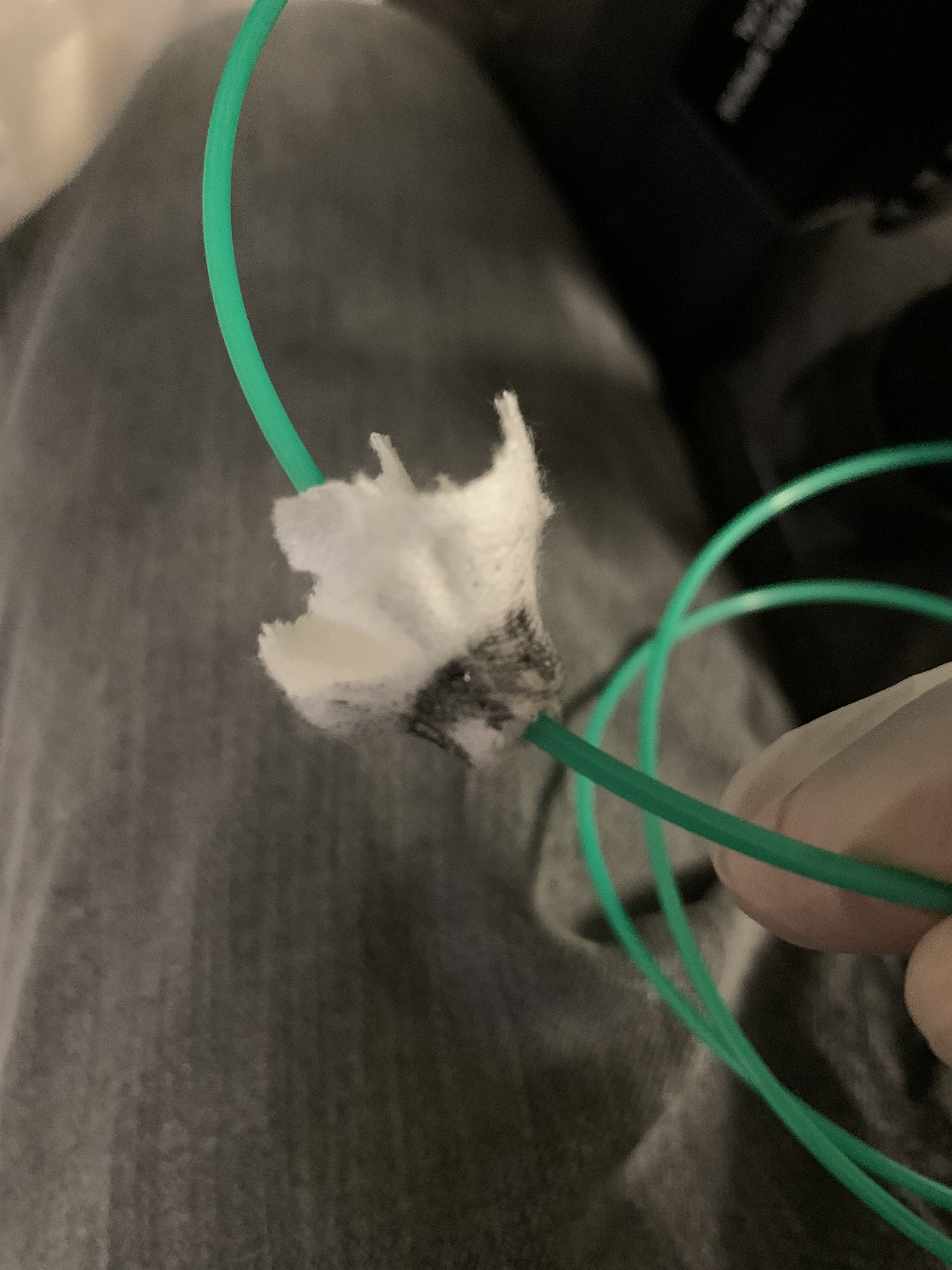

I also forgot to mention that I replaced the nock o-rings that I’d blown off the two bolts the first time I shot them. I used o-rings that fit as close to the factory o-rings that I could find in an o-ring kit I had. Lubing them with silicone made a noticeable difference. Namely, I didn’t lose an o-ring on a single shot.
@AirArcher66 I’m liking the velocities and energy that the gun/bolt combo produce. Looking at my notes I was using approx 100 psi per shot. Once pressure dropped below 2500 psi the POI began dropping 5” -6” as velocity dropped approx 25 fps. I was getting approx 6” - 10” of penetration per shot at 40 yards. I had to lay the bag down on its back to pull a couple bolts out. It appeared that the ferule was getting hung up on some of the material when pulling out a bolt. I got roughly 1.75” - 4” on my best four-shot groups. No photos of groups because I remove the bolt from the target after each shot.
