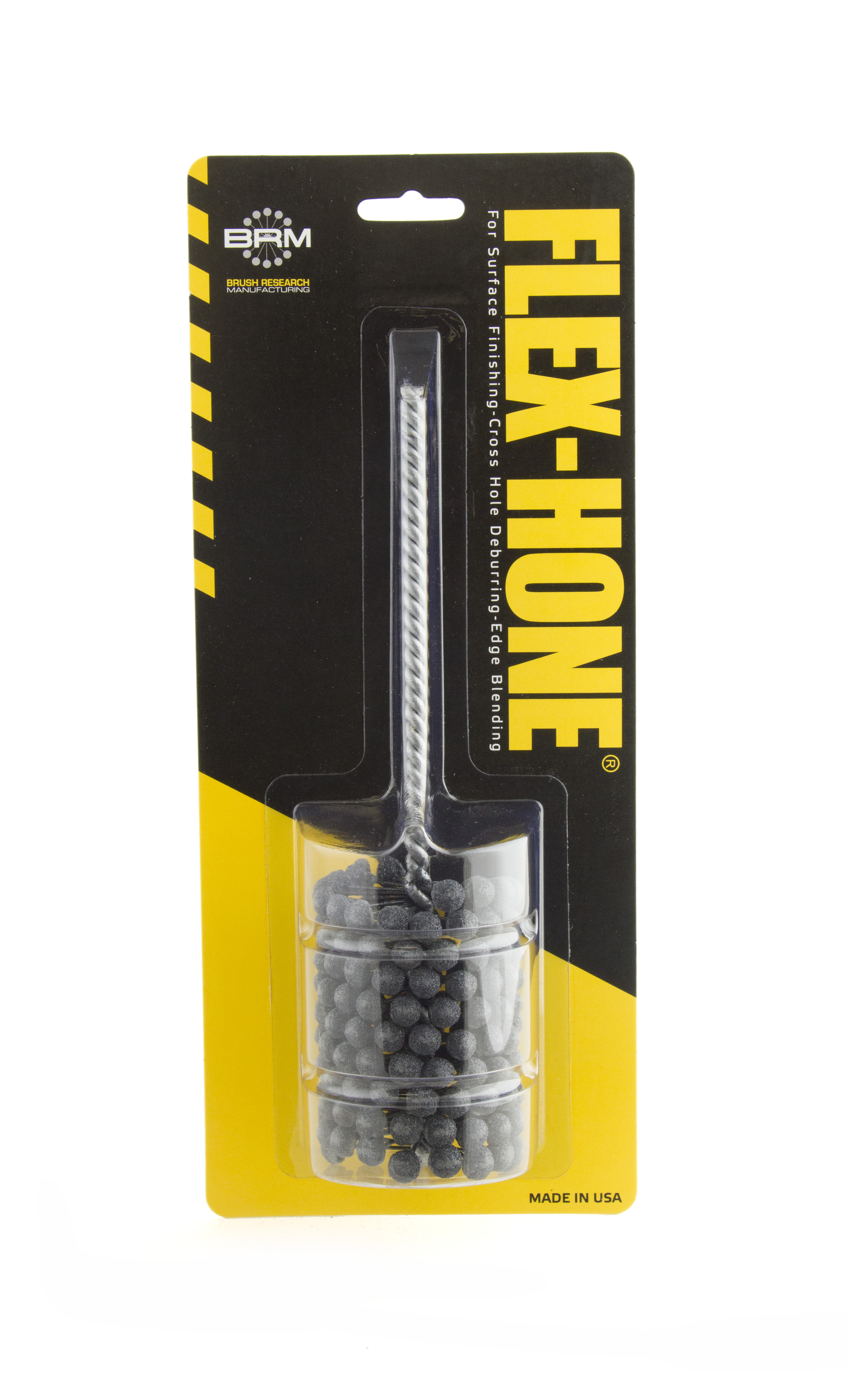

no I didnt. I heard what you needed to do that but what I wanted to do is shoot it see how it breaks first. Is it something I necessarily should do?
If your seal was sized VERY well you may get away as is on a smooth bore.
But in laymens term, Think of the seal like a windshield wiper blade on the clean windshield .... Chances become it will chatter & squeal due to the the seals lip scraping away all lubricants leaving surface squeaky clean :cautious: .. ever heard a spring piston AG HONK when cocked or fired ?
The Crosshatch surface holds surface lubrication preventing this.
I had one that honked like a dang goose about 30 years ago. I think at that time I put some of Beeman's silicone down the transfer hole and it calmed it down.
