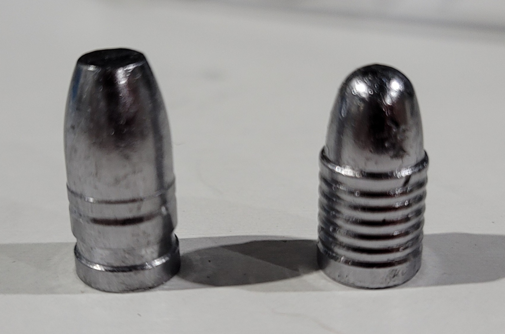

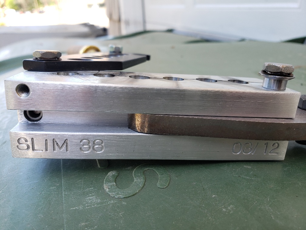

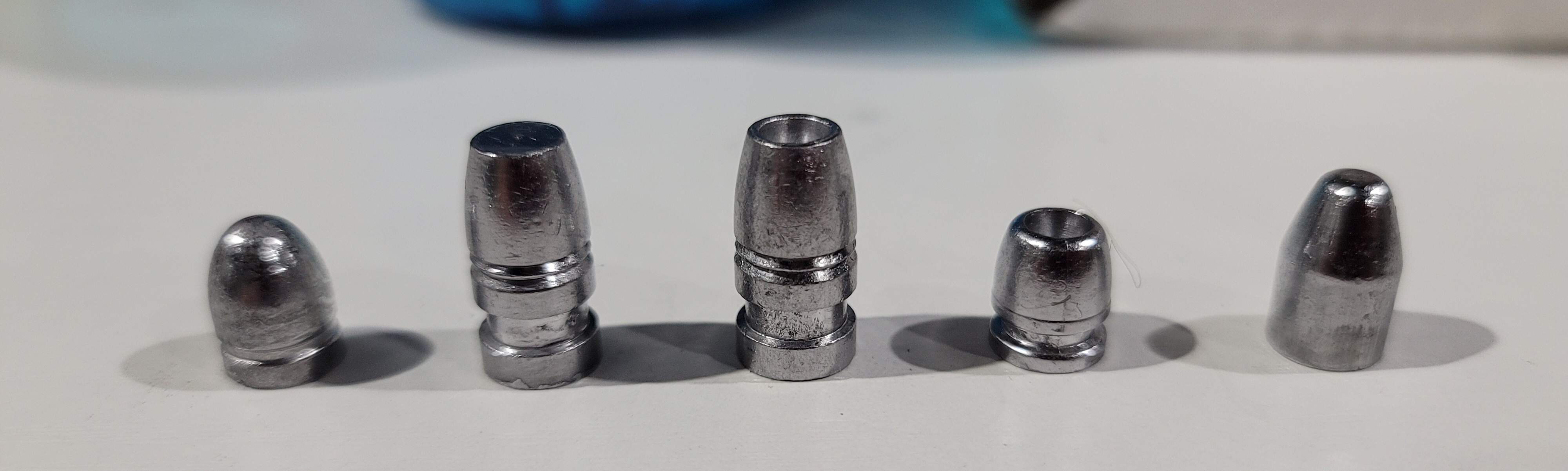

Also... I made another mold. #14 up next for testing. (Left.) 170 grain. 20mm length. I call this:
"It looks like a boolit, I sure hope it flies like one."
Also a .25 39gr that I made at the same time. (Right.)
