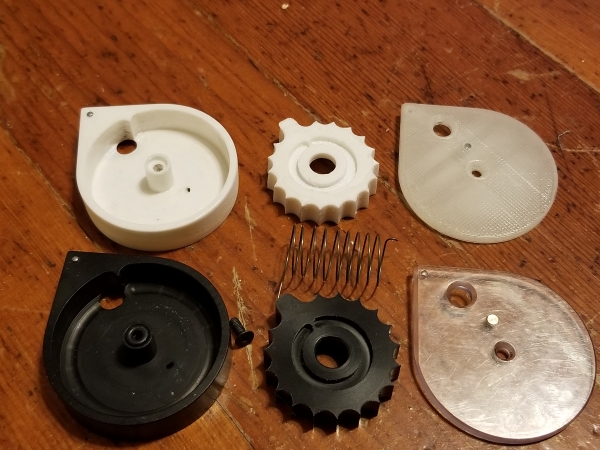

Necro post I know, but aside from giving you major kudos for doing all this work only to give it away, I also wanted to note this should work on the FX Crown if you mirror all the parts in your slicer before printing. My understanding is that the Crown's mags are the perfect mirror of the Impact's, and so I gave this a try. Not all the other parts have arrived yet, however just the printed parts, when mirrored, appear to fit and function in my Crown. :D
*UPDATE* 10.22.18
So I've had some more time to fiddle with the models given here and I want to come back, hat in hand, and say that these are not the same. Some differences are obvious, like the fact that (again when mirrored to work in the Crown) it feeds from the reverse side as the Crown mag, however others are more subtle like the tolerance from the bottom of the magazine to the feed path. If you're good with horseshoes and hand grenades, these can be considered close enough to make function if you 3D print them and clean them up and fiddle with them a bit, however if you toss them on a CNC mill you'll quickly discover that they in fact are NOT the same as the Crown mags when mirrored.
Is this because FX really made Crown and Impact mags different, or is this a tolerance that drifted in the process of replicating them? I don't have an Impact mag to compare so I really can't say.

So for those with Crowns, the Impact magazine is NOT a mirror image. (I think I said this above) I did however finally get around to designing and testing a Crown magazine based off of rj2239's design. It seems to have improved the accuracy issues from FX's original magazine design as well. (mine is not an FX magazine copy)
My design is also free to download for anyone who wants it, you can find it here:
https://www.airgunnation.com/topic/fx-crown-magazine-redesigned/
