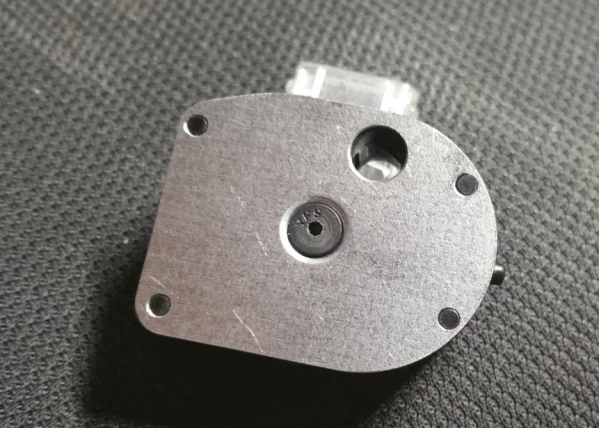

Hey all, I've had an Urban for about a year and love everything about it except for the $50 magazines. The recent acquisition of a 3D printer has opened up new horizons in airgun accessories for me, with the most challenge being designing a replacement magazine. After several prototypes I've settled on one that works very well. Some things of note:
-It only holds 9 rounds, but will not allow you to close the bolt on an empty chamber. With the factory mag, I would frequently loose count of my shots and end up dry-firing on the "11th" shot. This design prevents that from happening.

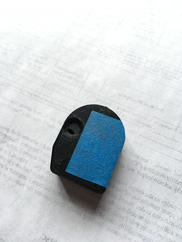

-It currently does not have a magnet. I have some neodymium magnets on order, but until now the blue masking tape provides a secure friction fit. The friction fit works well enough that I'm considering just adding a bit more thickness to the mag and forgetting about the magnet altogether.
-The spring tension is significantly stiffer than the original. This doesn't cause any problems, but is noticeable when loading.
-Loading is a bit different than the original. My design does not use an o-ring to hold in pellets while loading, which means you have to hold a fingertip under the opening to prevent pellets from just dropping all the way through. Also, sometimes you have to give the mag a little shake to get it to rotate to the next opening. With 5 minutes of practice I can load these just as fast as the original.
