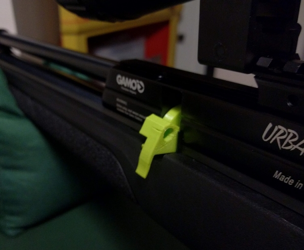

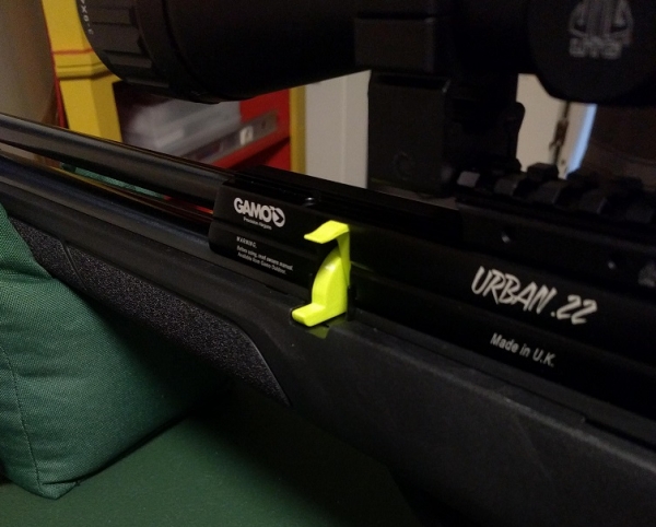

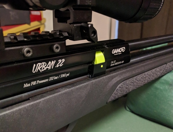

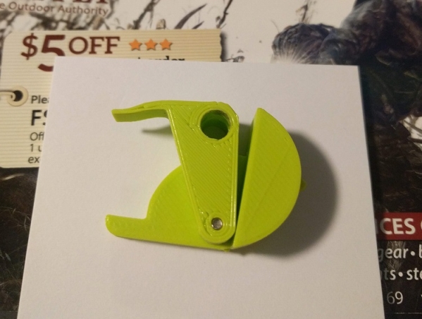

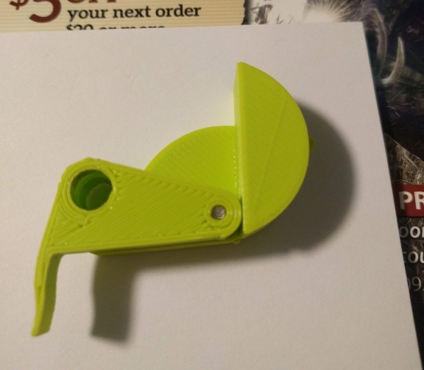

For anybody interested, this is a simplified version of the BSA single shot tray. I'll load the model files (inventor part files) to the grabCAD website tomorrow. I can also put up stl files if anyone wants. It's very simple - I'm not a machinist or CAD jockey. But I've tested it with over 100 pellets (all diabolo style) on 3 different printed copies from 2 different 3d printers, so it's functional. The two pieces are attached by a countersunk 4-40 screw that passes through the magazine and threads into the swing arm.
Martin- Yes, that was the original plan - to catch the magnet with an inset nut. This one was actually the quick and dirty test before improving it. But then I realized that threading the screw into the plastic itself was working great so I never bothered (it ain't broke so I didn't fix it). But I agree that would be an improvement. If you do draw that up, please consider sharing it by putting it up on grabcad and let us know!

Can you show a pic of the screw please
