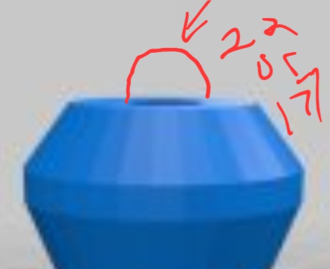

I was watching someone make these 9mm sabot slugs enclosed in a 3d printed case/skirt. Sorry new to airguns so I'm not 100 percent about the terms. But I was wondering if you could do that for a smaller pellet with a larger caliber 3d printed case or skirt. A skirt 3d printed the shape of a 30 cal pellet with a hollow core and fit a .177 or .22 pellet inside. The 3d printed pellet would be the case or skirt for the smaller cal pellet.
