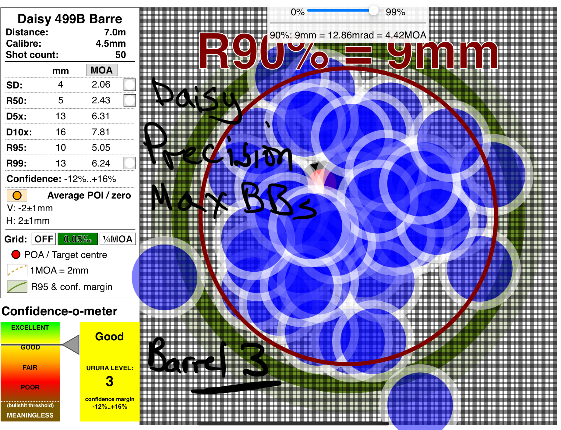

Daisy 499B Barrel 3, Daisy Unplated Precision Shot (the most expensive of the 4 BBs I’m testing, at 1 cent per round, 6x the cost of the cheapest Daisy Precision Max BBs).
In this barrel, the Unplated Shot shoots 1 mm tighter groups, compared with Prec. Max, at 7 meters. At 5 meters, this would translate to 0.5 mm tighter groups (a little over 1/64 inch) — kind of splitting hairs, don’t you think?

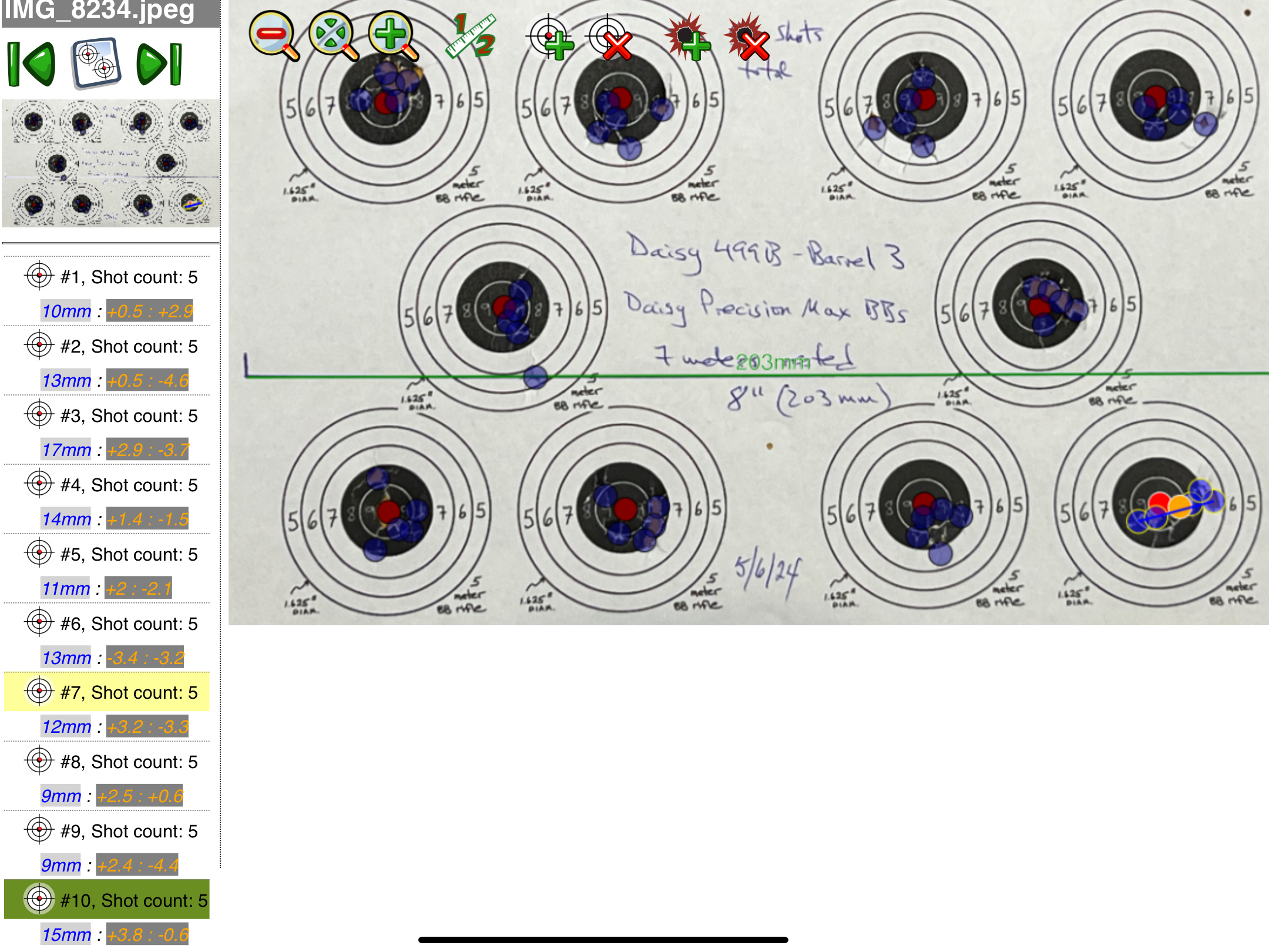

And on the subject of splitting hairs, I usually look at the MOA column rather than mm, since it has finer resolution. If you set the TARAN file up with imperial units, you get 0.01" resolution, about 4x finer than 1mm. I looked at the underlying code to try to get it to display in 0.1mm, but javascript is not a quick learn, and it appears to be generating an SVG graphic, not simple text.

Re-Run (TRIAL 2): Daisy 499B, Barrel 3, Precision Max (least expensive) BBs, 7 meters, rested.
Looks pretty similar to first trial (1 mm tighter groups and equal to Daisy Unplated Shot).
I’m happy with the consistency, and now believe that 50 shots is enough to minimize shooter variability.

That second trial is a real confidence booster that these results are accurate. Average SD of the two is 1.96 moa +/- 0.10, or +/- 5%.
I see the "Ururu" level expects results to be within -12/+16%. Set 2 was -0.20/2.06 of the first set = -10% -- within expectations and about as good as it's expected to get.
I noticed that the average POI shifted quite a bit between the sets, curious if there's a known change causing that? Can you "clock" the barrel to influence POI? One of the CF barrels I tried in my 35 was visibly off center at one end, so I installed it "shooting up" -- to minimize windage shifts and fight gravity a bit.

TorqueMaster:
I need to read about the statistical analyses used by the TARAN software (I have no clue what an URURA LEVEL is, for instance, except higher is better :))
The 499B barrel assemblies finger tighten down pretty snug and consistent, so I doubt it’s a clocking issue. I mess with the sights when I'm shooting offhand (I tend to shoot high offhand, compared with off the bag), so that accounts for the POI change between sets.
