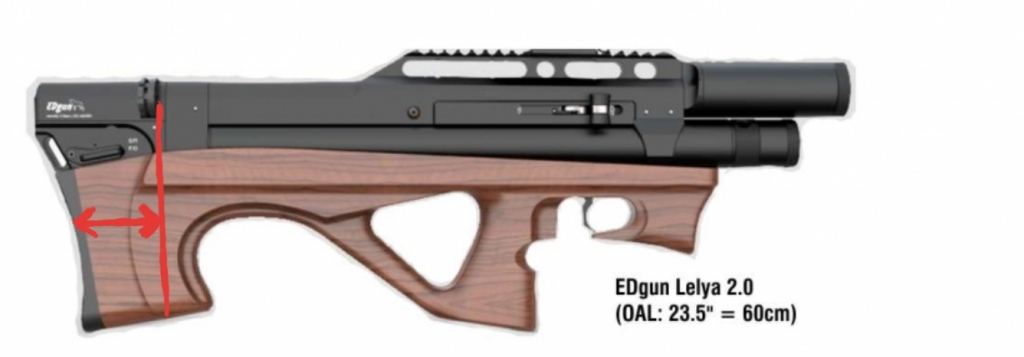

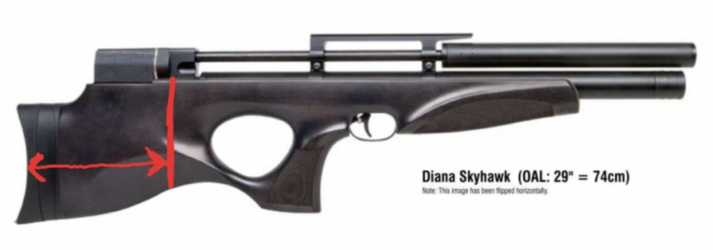

Thank you for putting this together. I'm a newb to PCP and have never handled much less shot a bullpup. But my interest in PCP is due to the combination of compact, quiet and accurate hunting/pesting rifles so naturally bullpups intrigue me. But there is something that confuses me.
If you look at the Lelya 2.0 you see that the butt stock curves underneath towards the breech.
The Skyhawk, on the other hand, appears to have a fair amount of stock hanging off the back of the rifle. So I have a couple of newb questions:
1) Is there some advantage of shooting position comfort to have this much stock hanging off the back? There isn't enough room to have a cheek rest and a lower scope position like a Cricket Mini Carbine so me it's just unnecessary length on what is supposed to be compact rifle configuration.
2) Is it to maintain a decent length of pull and avoid a longer trigger linkage?
Ed and his team purposely designed the breech block on the R5, R5M/Lelya to be positioned as far back to the rear and is also integrated into the butt stock. It's actually a good design if you think about it. It brings the overall length down by a few inches while still having a standard length barrel and a longer moderator. I measured the distance from the breech face to the apex of the butt stock on my R5M and it came out to 2.5 inches. Here is a comparison to the Diana Skyhawk for example...
The Skyhawk looks to be about 6 inches from the apex of the butt stock to the breech face.
I'm regards to the length of pull, gun manufacturers have settled on anywhere between 13 to 14 inches LOP for the average person. I'm not sure if there's a major difference adding 1 to 3 inches in the trigger linkage to notice a difference.
I agree. That's what I was getting at. And not only maintaining a standard length barrel but actually a longer barrel when comparing it to the similar sized Veteran compact. As I recall the Lelya 2.0 has a 1.1" longer barrel while having a longer length of pull and a slightly shorter overall length.
👍🏼 Thanks for pointing out this design feature, Scouty and Peskadot671. 😊
So, let me get this straight:
Skyhawk, Dreamline, Bobcat, Flashpup, P10, etc. put a lot of buttstock between the action and the shoulder.
vs.
EDgun, Taipan, The Priest, Impact, BP17 etc. do not. Pretty much end-of-action = end-of-gun.
The big butt costs an additional 3 to 4 inches of stock, weighing an est. 6 to 8oz (= 7 to 10cm in added length, and 170 to 230g in added weight). 🤔
So, assuming the typical bullpup buyer buys one because he (or she!) wants a rifle that is as short and as light as possible:
What again are the benefits of the big butt for the shooter? 🤔
