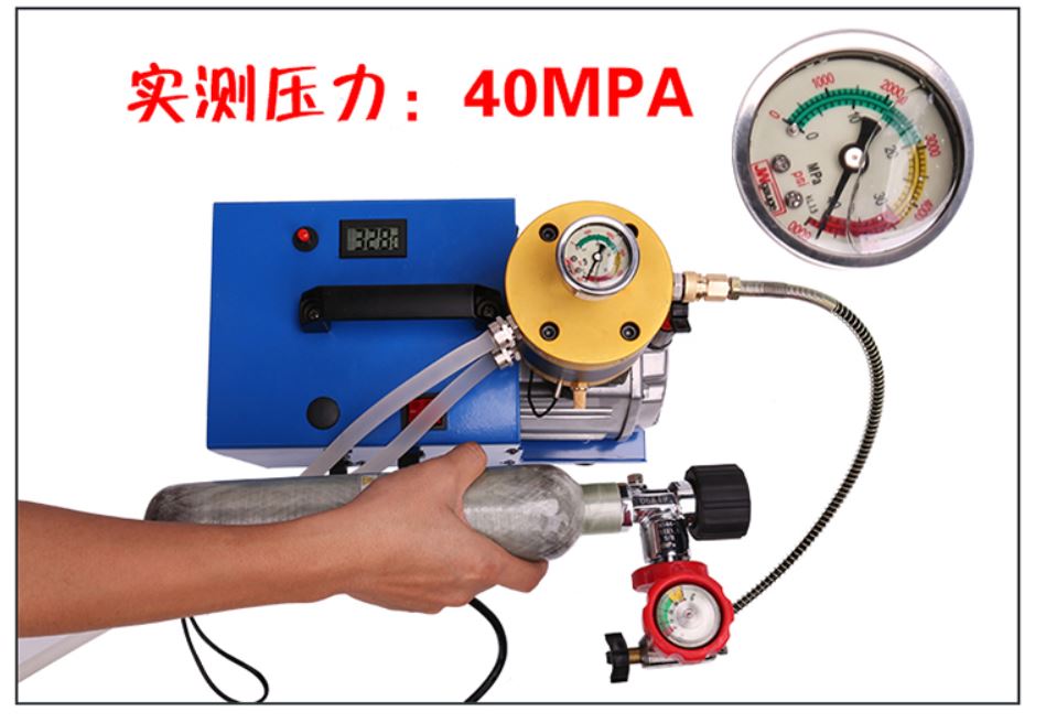

Yong Heng's official specification is just 30 Mpa or 4350 psi although I have been routinely getting 4500 psi out of it without any issues.
For Tuxing, they have a two-part specification: "working pressure 0 - 30 Mpa, max 40 Mpa ( 5800 psi )". I have asked the representative of Tuxing in China whether I can routinely push it to 5800 psi and the answer is affirmative. They claimed that they have tested it but I have some reservation about it.

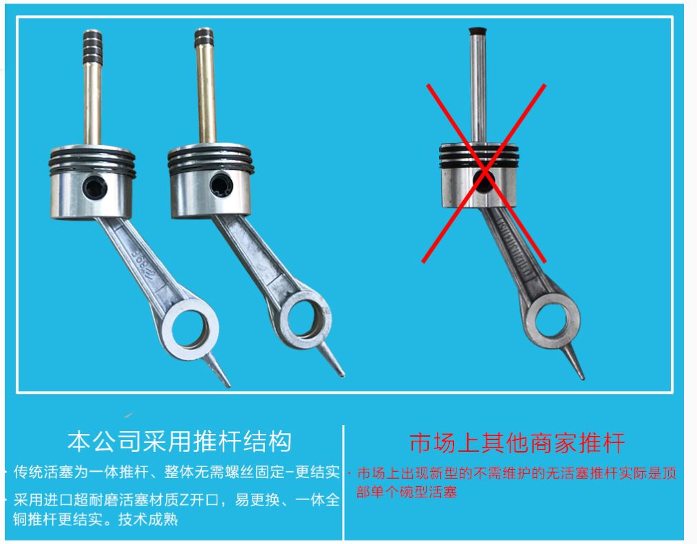

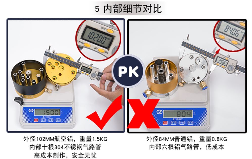

They definitely do not come from the same factory and they do not share all the parts. I believe some are common though. There has been many reports by owners of these compressors getting spare parts that do not fit their machines. At least Tuxing explictely states the difference between their products and the others in their website in China :
Left is Tuxing , right is the others :
