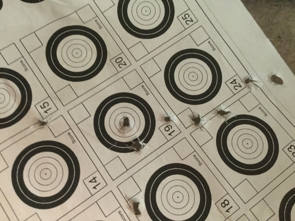

@Atoni, the groups you’re displaying, where is the POA? A lot of guns can “group”, are they grouping at POA? What pellets are you using for these groups? My first PCP is an Urban, solid little rifle. But it cannot be single loaded, which is fine for hunting or plinking. But I find I like single loading when on my home bench, so I wouldn’t purchase another PCP that couldn’t be singly loaded.
I'm not totally sure what you mean but I'm aiming about 5" up at a different circle because I didn't sight my scope in very well.

The question was if you are grouping at point of aim. Meaning grouping at your aim point, not just grouping randomly. POA should equal POI.
OK, I get it now. I’ll try that but I’m not sure what difference that would make.

The difference is you do want to group where you’re aiming, don’t you?

I tried to get this to where I’m aiming at @80 yards but I couldn’t do it successfully and settled on a 9 shot group.
This was on a calm day with very light winds (almost nothing) and I don’t think I pulled any of them. This was with the Baracuda pellets. Somethings wrong..
~4” CTC
Up and down was 7/9 was 1” and 9/9 was 2”
Why didn’t I do 10 shots you ask? I don’t know because I thought I did 10 shots. My first shot was at circle #14 and I thought it was close enough to try to do a group. Didn’t work out as you can see.
