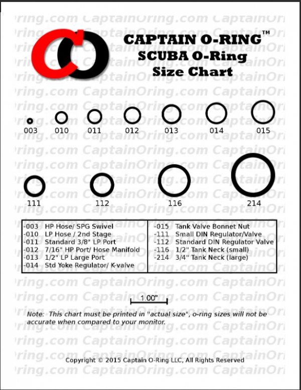

Did you look at the last link with some neck size o'rings? The link claims to be able to print in actual size to match up rings. Just a guess, I never have pulled mine all the way down.

"13brv3"I did miss that link, but unfortunately those sizes don't look like they'll fit. The OD of the valve is 0.87" and the ID of the tank is 1.136". The best I can measure thickness of the o-ring from old o-rings is 0.133". Standard dash size o-rings jump from 1/8" to 3/16" thick, and I don't think either of those is close enough.
Thanks,
Rusty
Sorry.....
Those must be for standard tanks.
