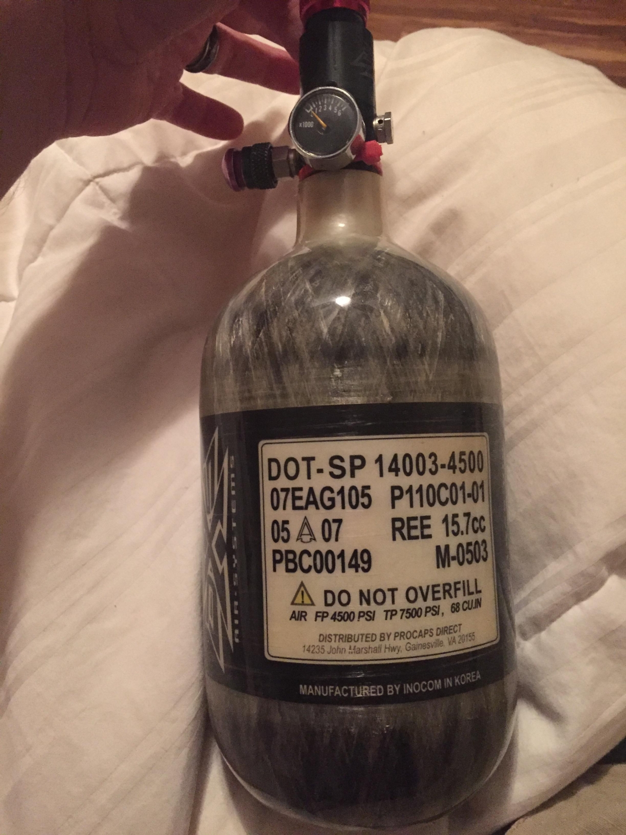

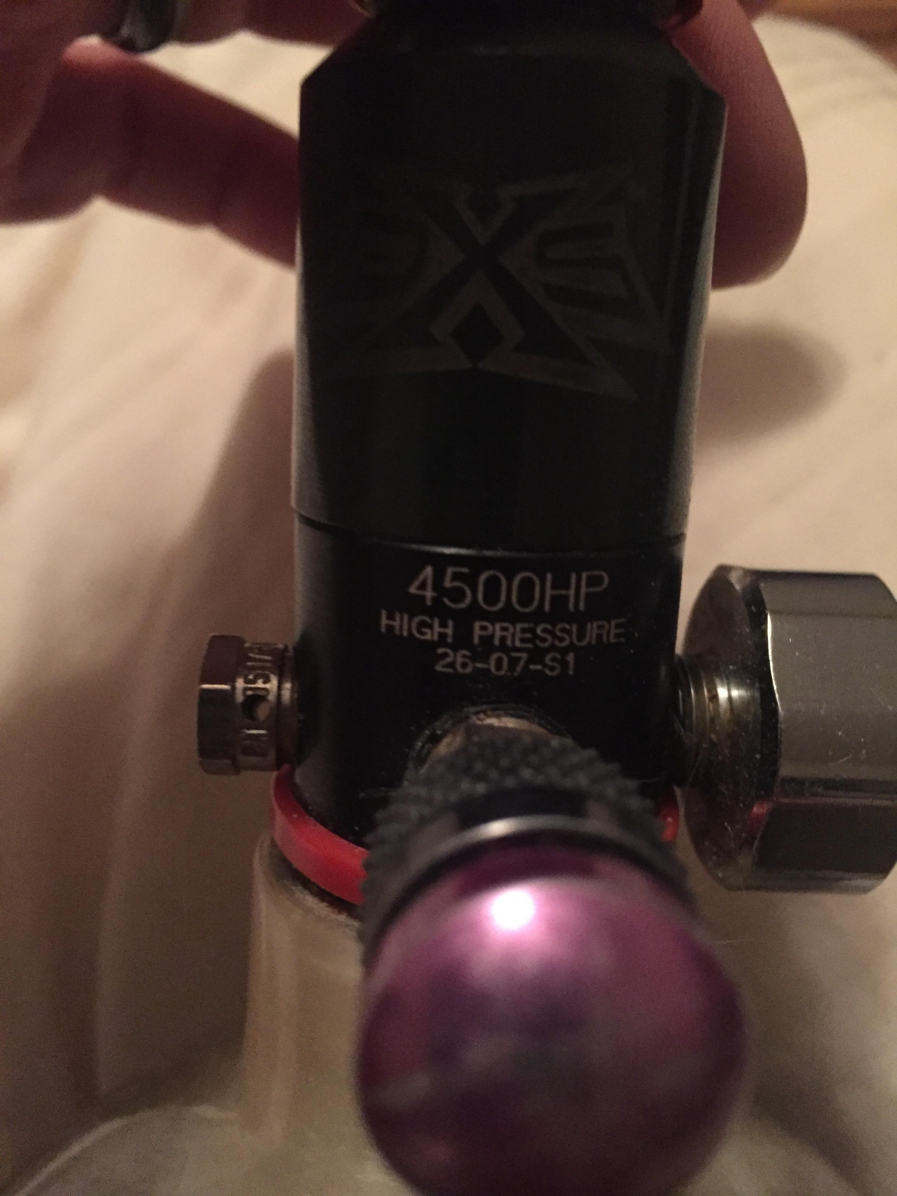

I have seen some comments saying PB tanks are no good. I am looking to get my first PCP, a Benjamin Marauder pistol, and was hoping to use a 68ci 4500psi tank, shown above, to start. I know I would need a fill adapter and probably a regulator also but am I to understand that this tank will not fill a PCP properly at all? If it will work I would love any recommendations you have for a fill adapter/regulator.
