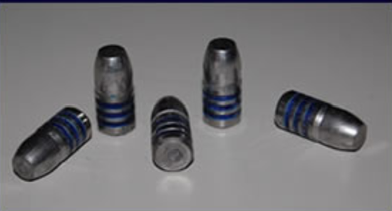

Tested some Missouri Bullets #1 buffalo in my 457 Texan LSS and thought I'd share if anyone was thinking of trying these. I called the company and asked them to size these from .459 down to .458
Rifle Settings: Power Wheel maxed towards butt stock. Carbon bottle filled to 3500psi, taking 2 shots, then topping off at 3500psi for the 3rd shot. 50 yards, so nothing to brag about, but it is still .26" center to center (1/2MOA) for 3 shots. Velocity is 2780-2810fps depending on the shot number. (I am pleased with these!!!). My rest position was: sitting on a rock, rifle perched over fallen tree, with each elbow on a knee. This position is pretty steady, but not the max steadiness I can achieve with a proper bench or prone. I believe these bullets would do 1 hole groups if my shooting was perfect and I topped off every shot. Next I'll have to see if they hold that precision at 100 yards. I also tried shooting them backwards for a wider meplat. The wound channel in river bottom mud was twice as big as shooting them nose first, but the accuracy was not there, I suspect because I was unable to seat them into the chamber consistently, base first. (and unfortunately I did not chronograph them backwards to see if there was any velocity difference). Looks like this gun likes 405gr
