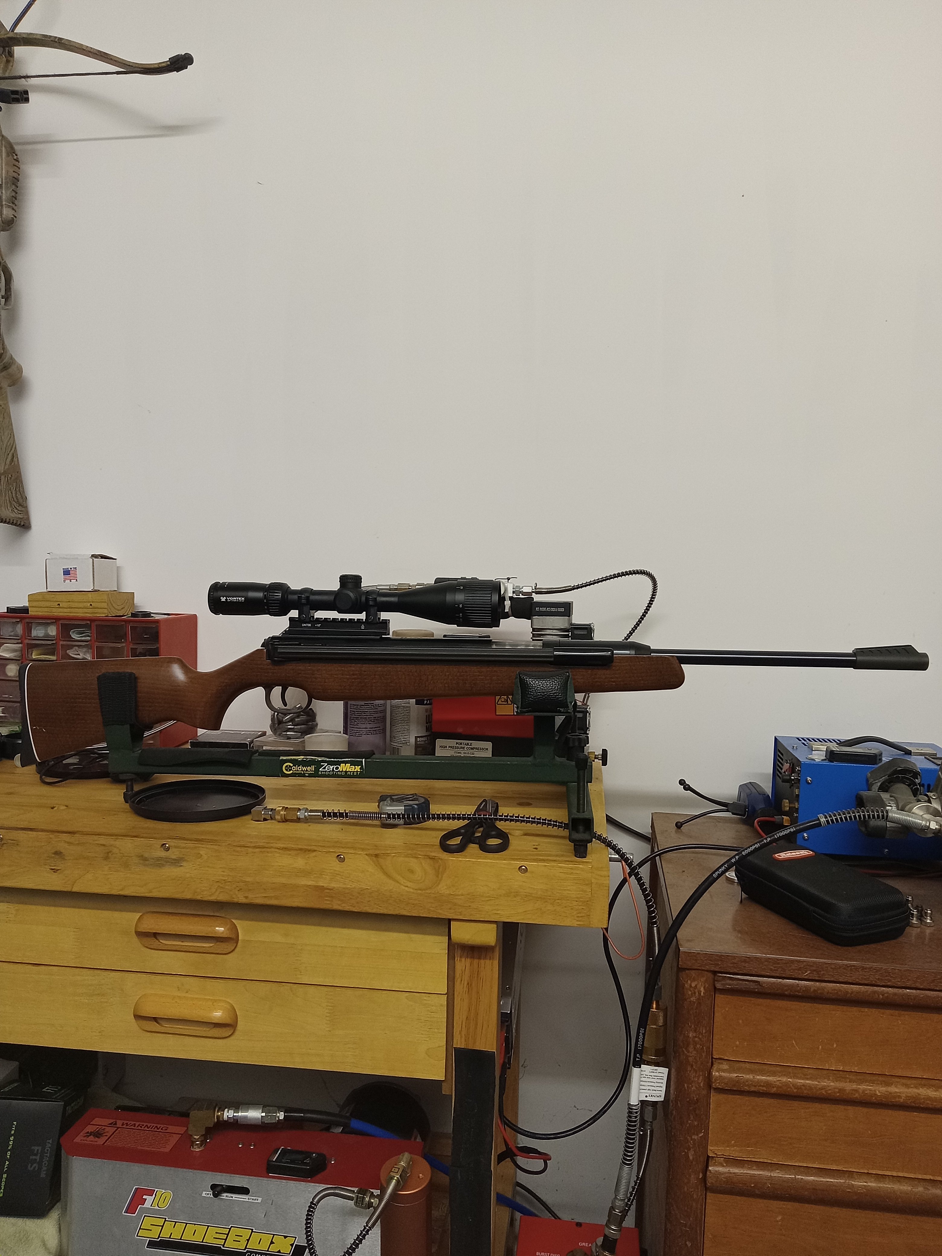

droop mount have been the go to mount for years
they used to have TO1 and TO5 i believe and that had a piece that dropped down in front of the dovetail so it could never move back
the TO6 mount does not have that and you can move it back as needed
there is nothing wrong with the RWS mount but there is nothing wrong with adding rings that you what either
there is more than one way to mount a scope to a Diana 48-52-54

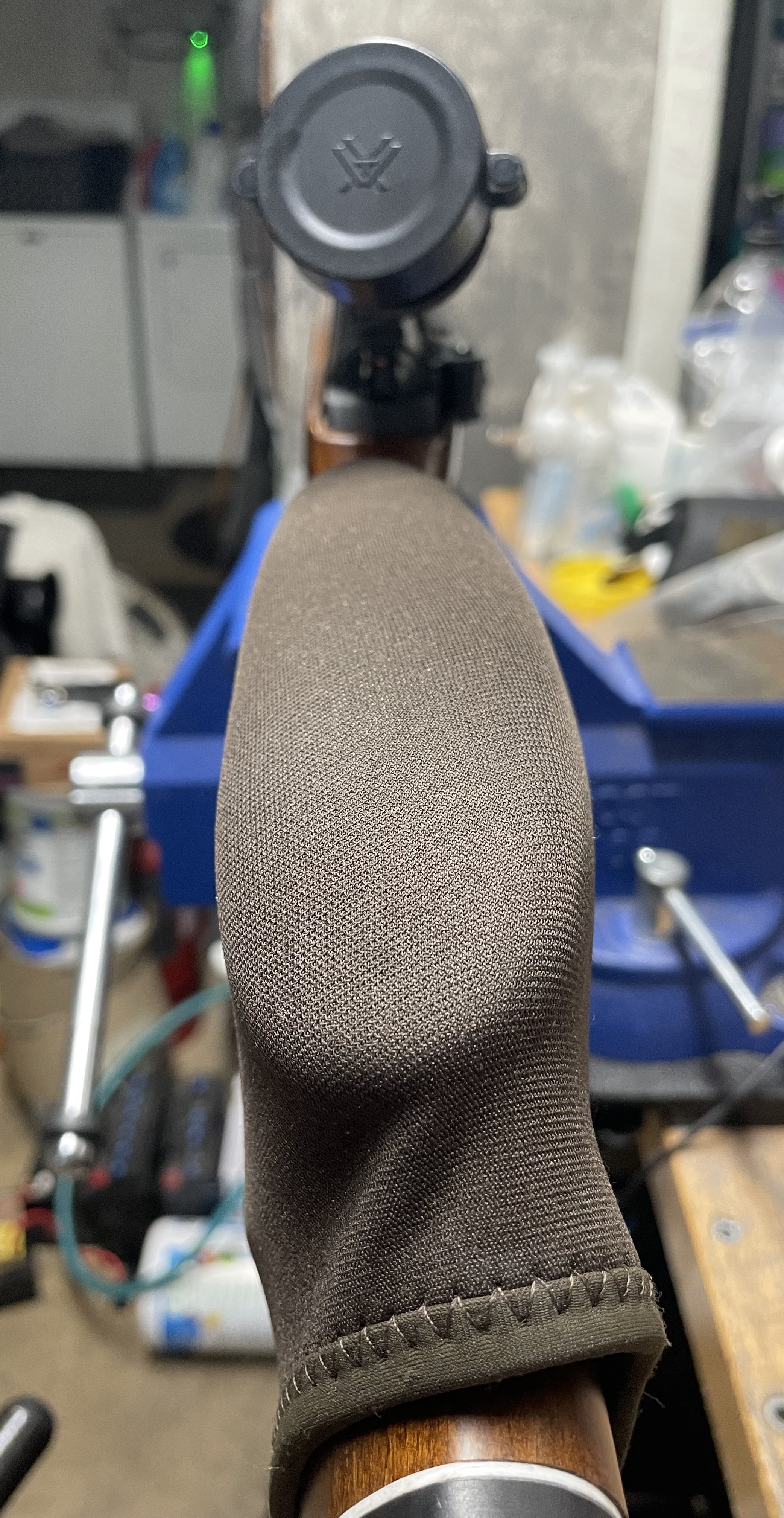

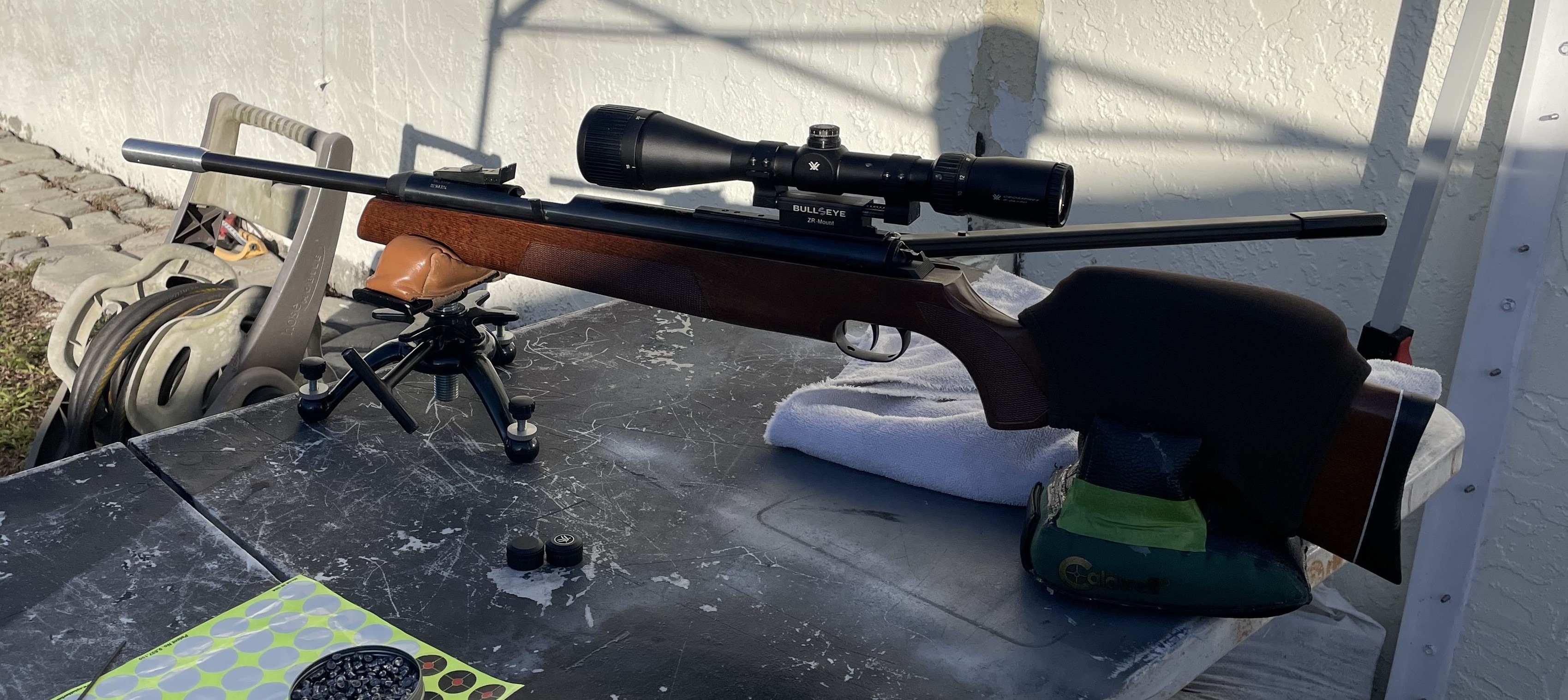

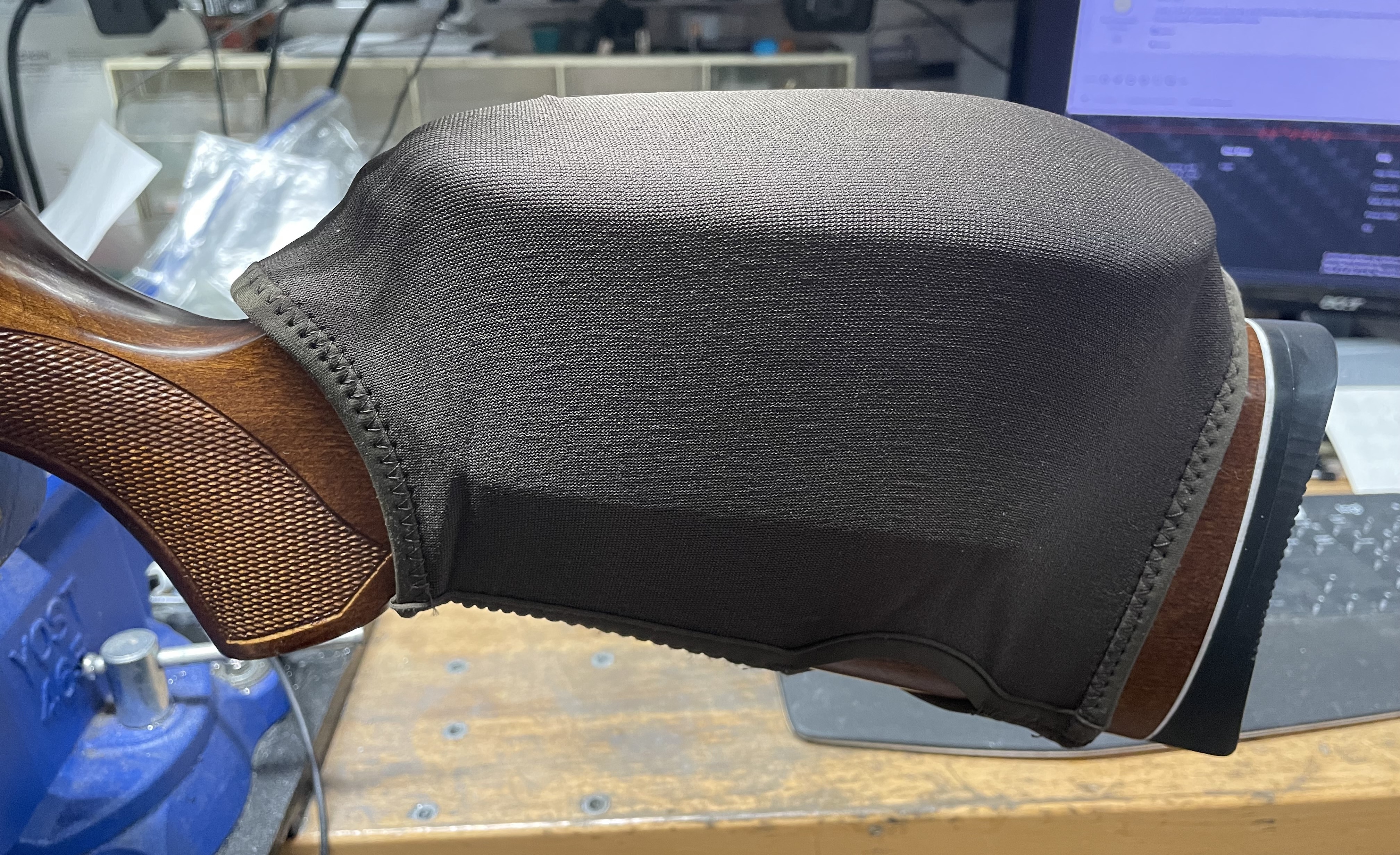

now on the stock i have a BEC Eurolux Air Thunder rifle model 21 and it is a copy of the 48 and the stock is not even close to the same but saying that it doesn't mean other model 21's would not work, i can only compare what i have
i have a voodoo tactical cheek riser and i has a lot of option to it and they can be removed it could work i can try to mount it on a 48 stock and see for you
