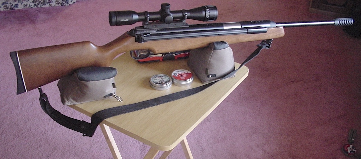

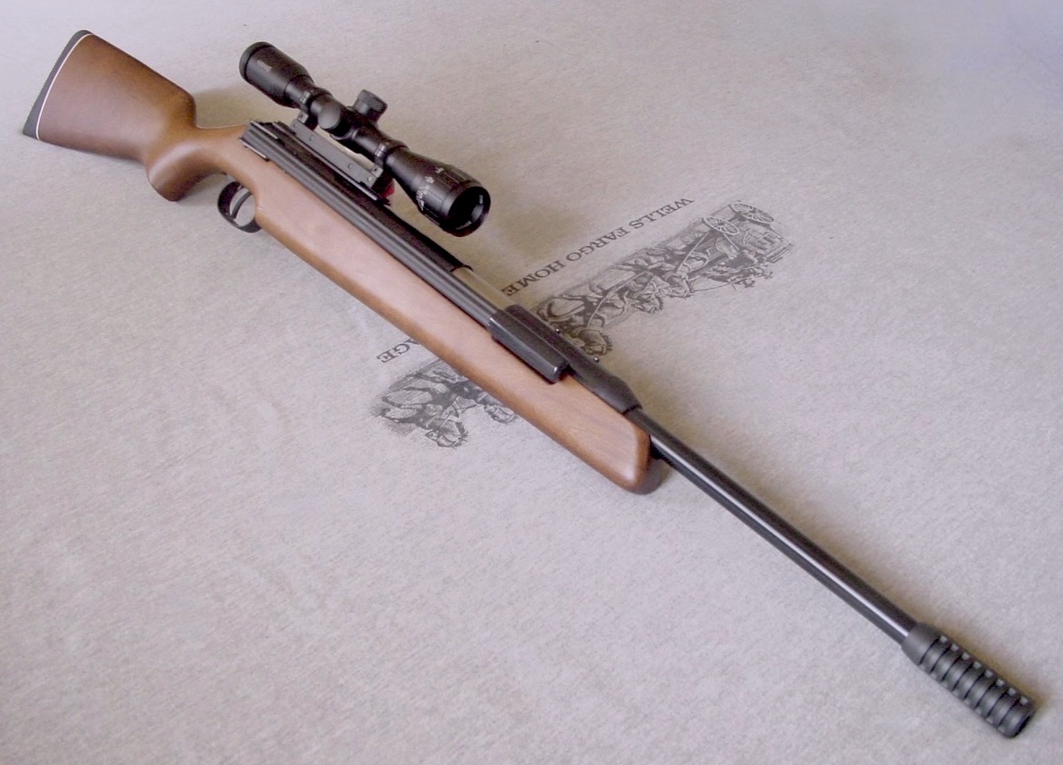

I didn't like the plastic front sight base on my 48 either. I ended up pulling the iron sights completely and installed an old Dianawerk 48/52 steel muzzle weight I had kicking around. I also had an old RWS adjustable steel C mount made specifically for the Diana 48/52. It has dual recoil stop pins. Rock solid.
Mine is a .177 T06. Great shooting rifle. As far as I know the muzzle weight is no longer made, but I do see them for sale on Ebay from time to time. If you end up getting something to replace the plastic front sight base, whatever that may be, make sure it's fully seated against the barrel sleeve and locked on tight. And when you have the front sight base removed, don't pick the gun up by the barrel sleeve, as it will slide right off, and you'll risk dropping the gun. (Don't ask me how I know this).

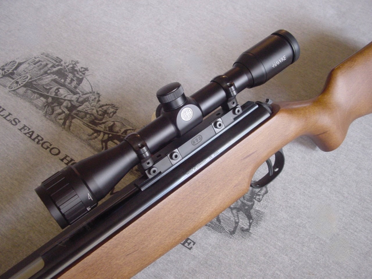

The gun has a reputation as a scope eater, but after 1000+ rounds through mine the Hawke Vantage 4x32 AO scope I mounted is holding up fine.

Congrats on the 48! You are 100% correct on that front sight, astronomically high cheese factor.
As was pointed out, that barrel sleeve is held in place by the front sight, do not let it get loose, you will have a wandering poi.
The barrel sleeve is sized to fit snugly on a 16mm barrel, but the 48 barrel is a smaller od, so there is a full length shim.
Macari at ARH from time to time sells 10 & 12" shrouds for 16mm springer barrels.
They work very well on the 48, 52, & 54. An added benefit is a slightly less front end heavy balance.

Too bad they don't make an optics only D48 with a clean receiver and full length steel shroud like the HW98. I like the look of the shroud SteveV posted. Can't stand the look of that plastic front sight base. First thing I did with mine was replace that eyesore with the old Dianawerk muzzle weight.

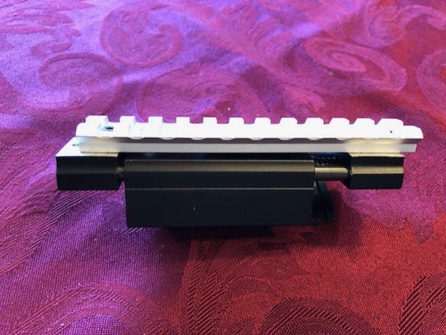

I did try modifying these cheap Chinese anti-recoil mounts with limited success. I cut off the top and bolted on a Picatinny rail. I then shim either the front or the back with washers to get the droop I needed. I guess in theory...if your off set the attachment screws on the rail...you could account for the left- right adjustments too. I was thinking of epoxying everything in ...once adjusted.
Very crude...I know...I'm not a trained machinist...just a hacker with too many ideas and tools and not enough experience and time (my dad would have been horrified if he saw this...that man was a mechanical genius)
Next attempt would be to flip the two mounts upside down, unscrew the top half of the mount and leave them off. That way you don't need to cut the mounts off. Drill holes to attach a flat plate. Then mount the Picatinny rail to the flat plate.... That's going have to wait till I finish my Honeydolist...got a retaining wall that needs my attention.
lateral and vertical play? just drill more holes and put in centering set screws.

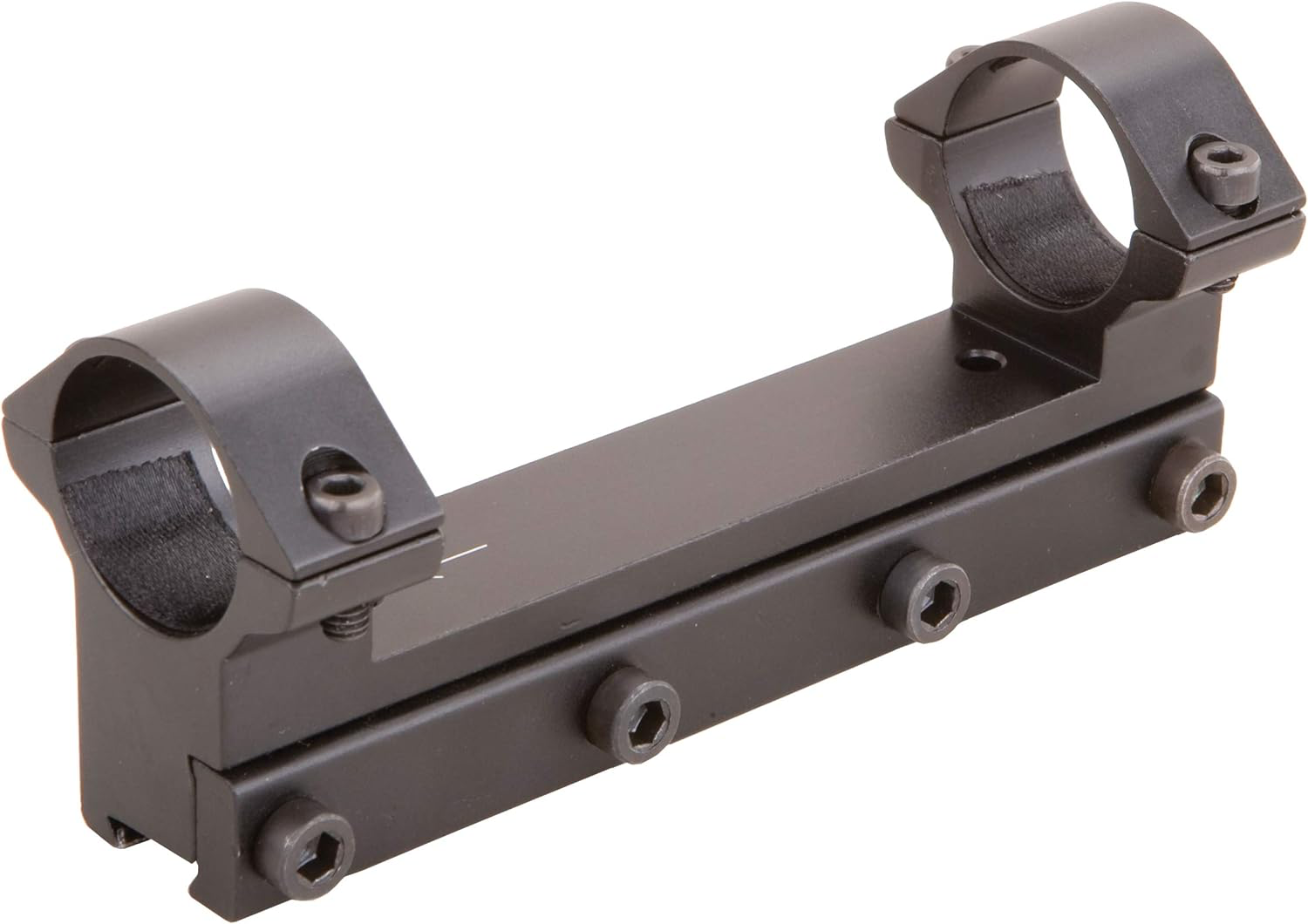

It's a shame they don't make the RWS C Mount anymore. All steel, dual recoil stop screws designed specifically for the 48/52, plenty of elevation and windage adjustment, and rock solid once set. I see them come up on Ebay from time to time. Well worth the investment.
Are you talking about this product?
If you are, they are still selling the RWS C mount at Amazon.
