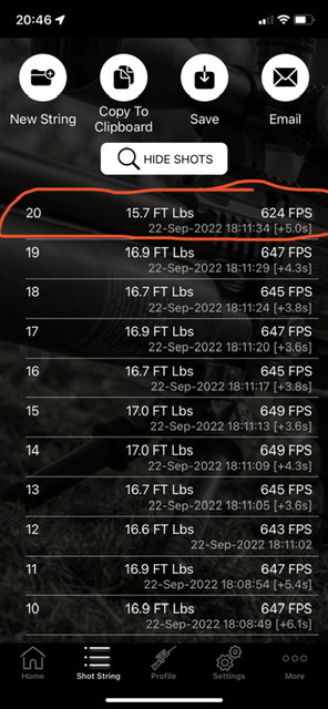

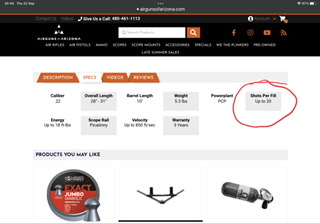

However, I can still use the gun and I have been looking at some shot to shot consistency and how many actual shots I can get fro a charge within the “optimal” shot curve. AOA says up to 20 shots, well yup it is 20 in the rated range from a full charge, maybe 22 before the FPS of the pellets starts to dive.

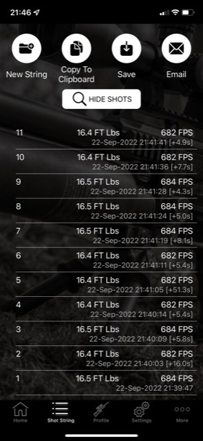

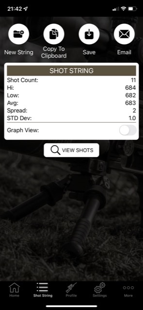

So here is my findings: Power range hovered in the 15 FPE for the Crossman and 16-17 FPE for the JSB and H&N pellets.
The JSB Jumbo Heavies were the most consistent with STD for 20 3.7 FPS. Hades and 18s 5-6 ish FPS and Crossman a STD 12 FPS. Will this match up on the target grouping Saturday, NO IDEA. I am praying the gun likes the hades because I like using them so much in the field.

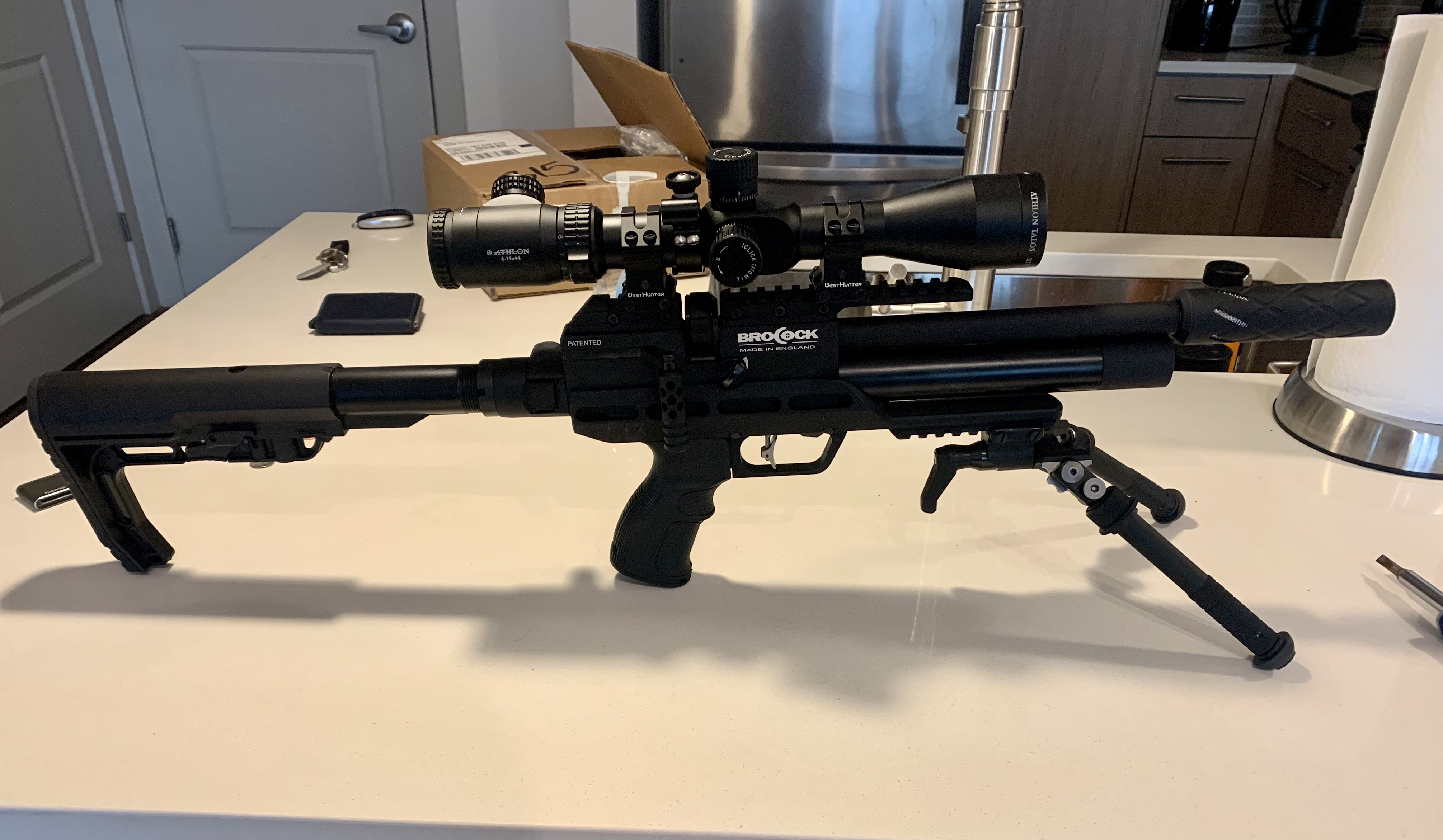

The ranger with its new digs. Also, can’t remember but I swear the cocking handle on 22 ranger is longer than the 177 ranger. It is super nice too having the length.
