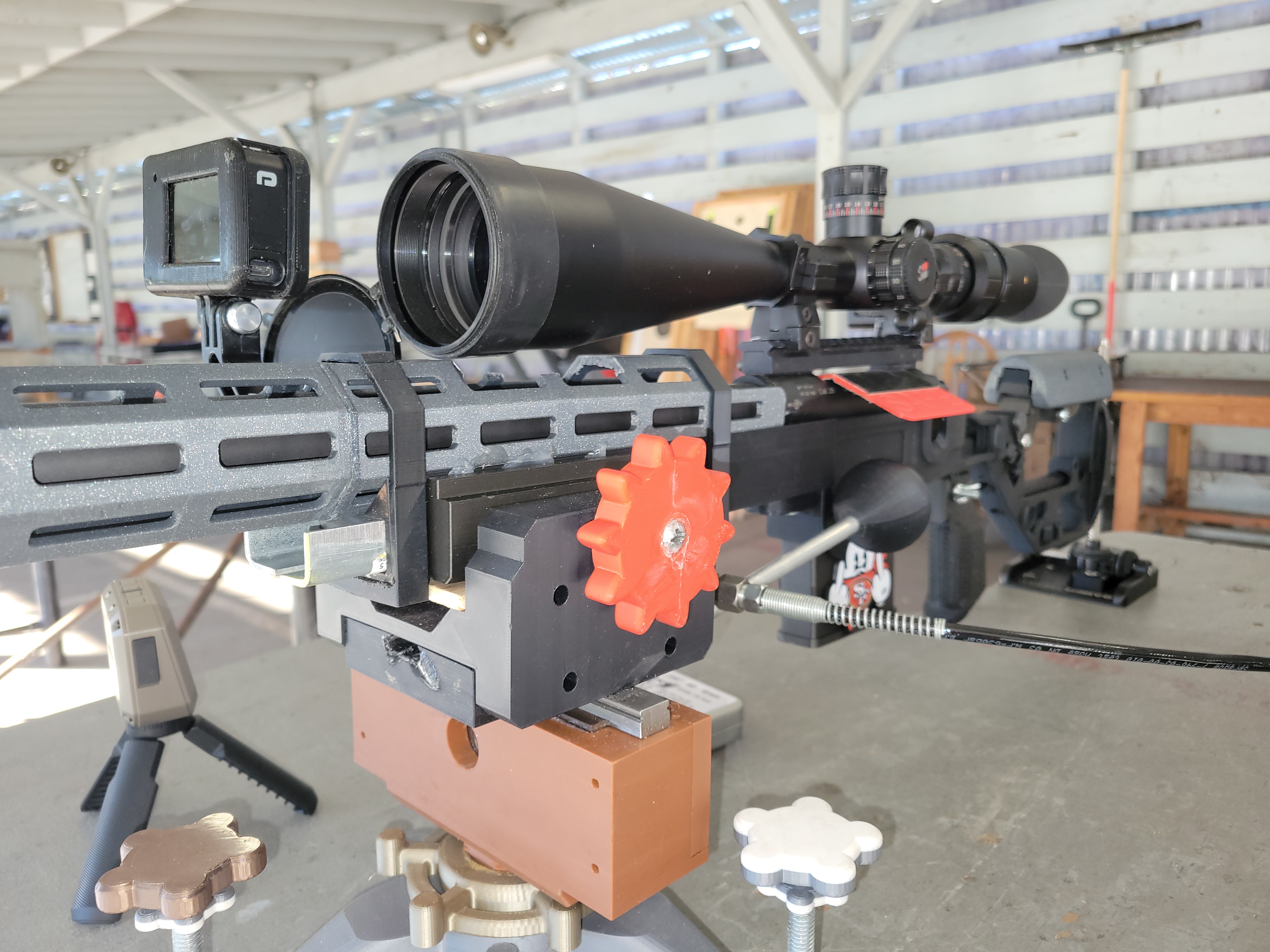

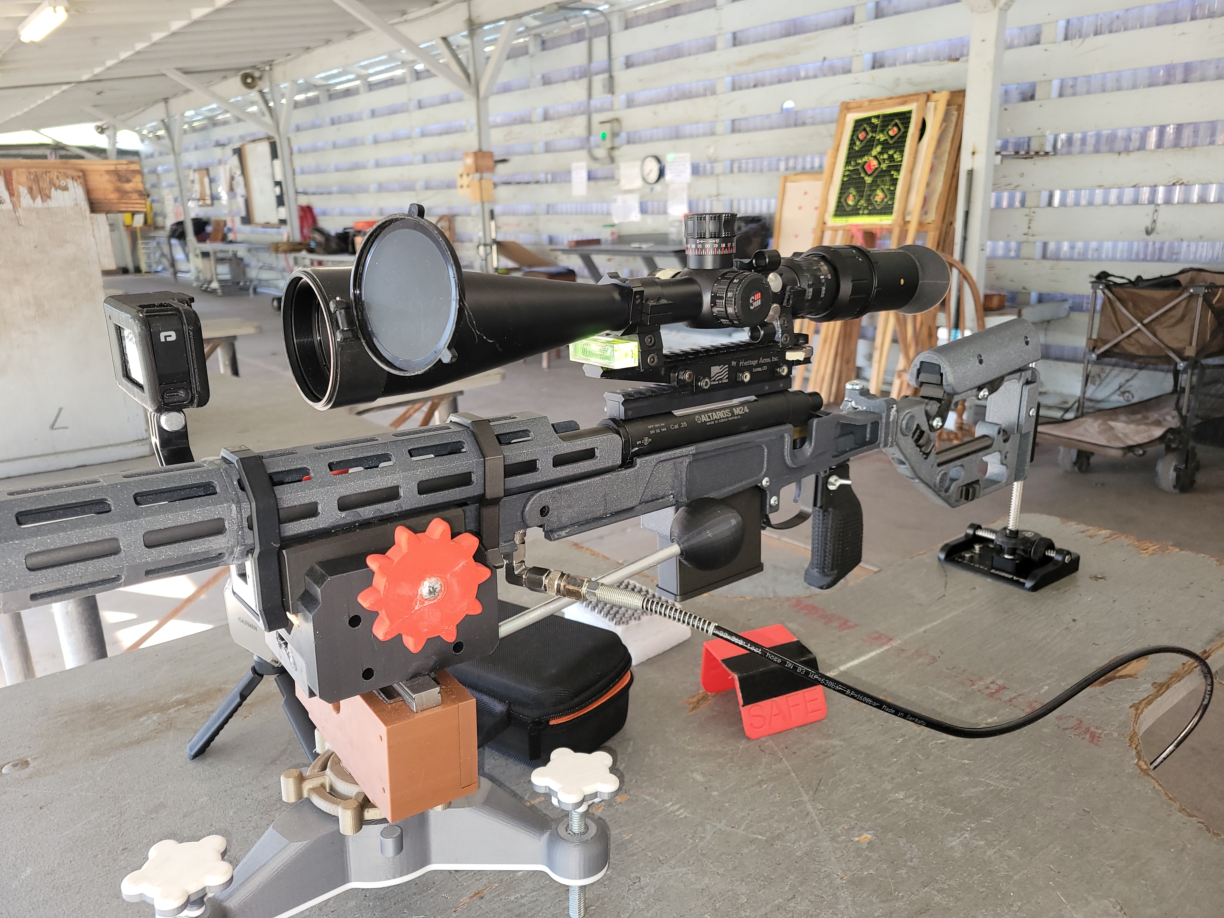

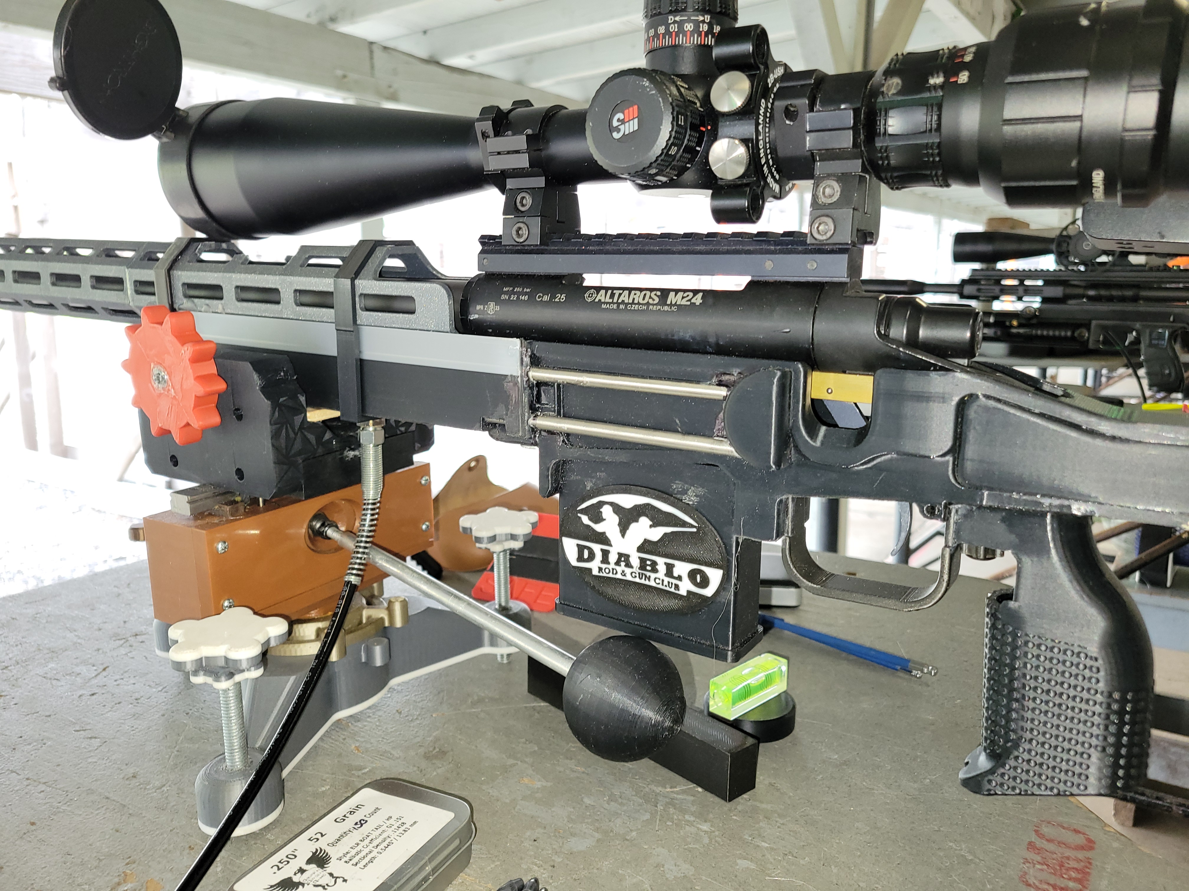

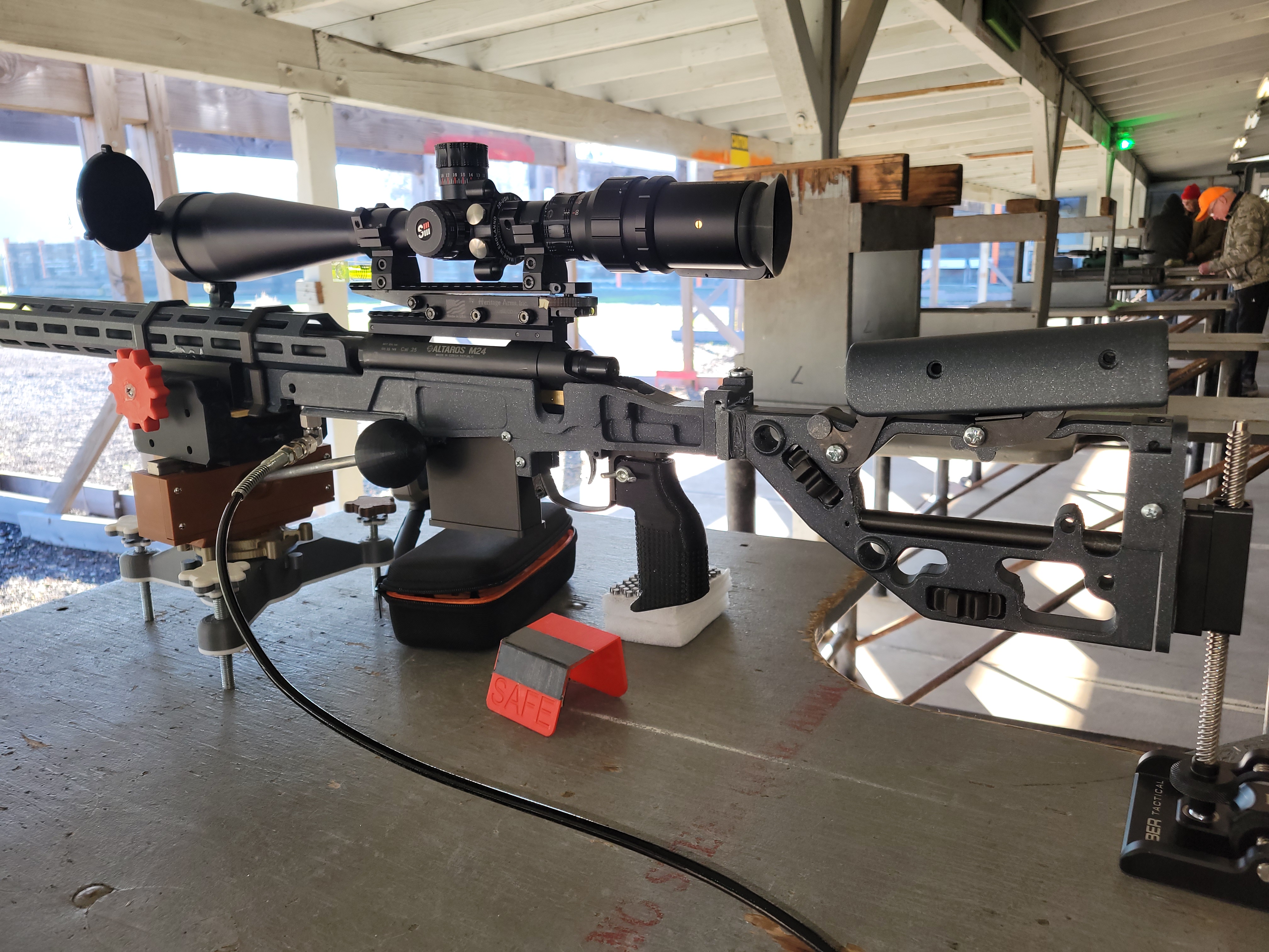

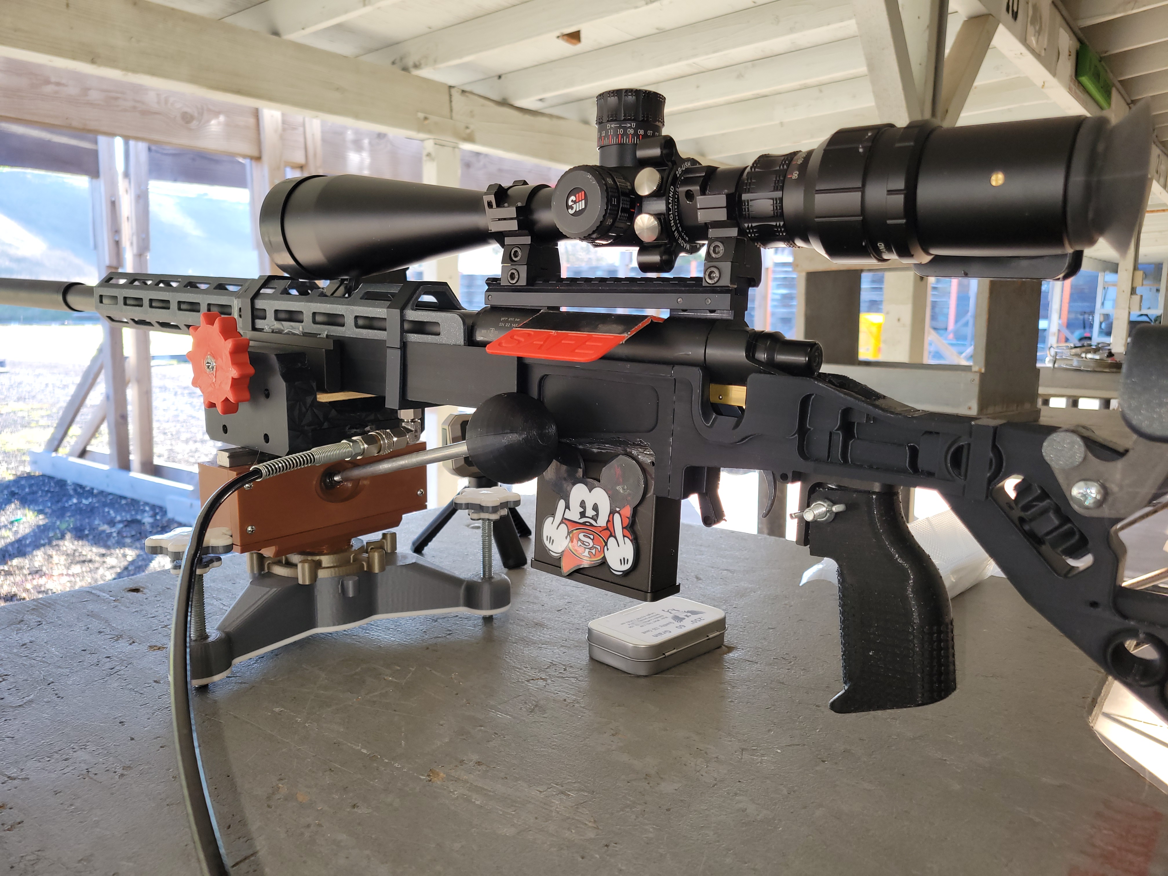

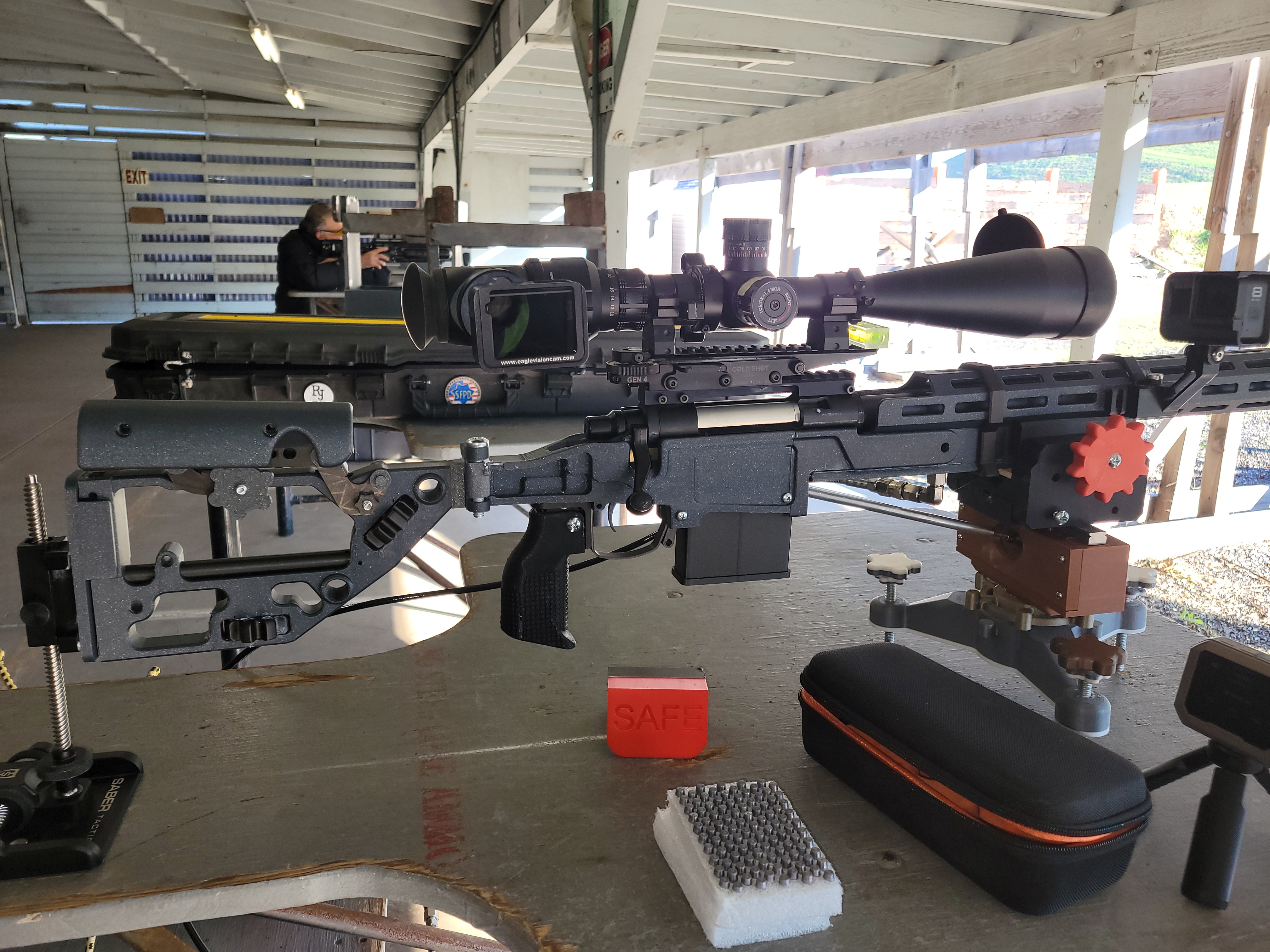

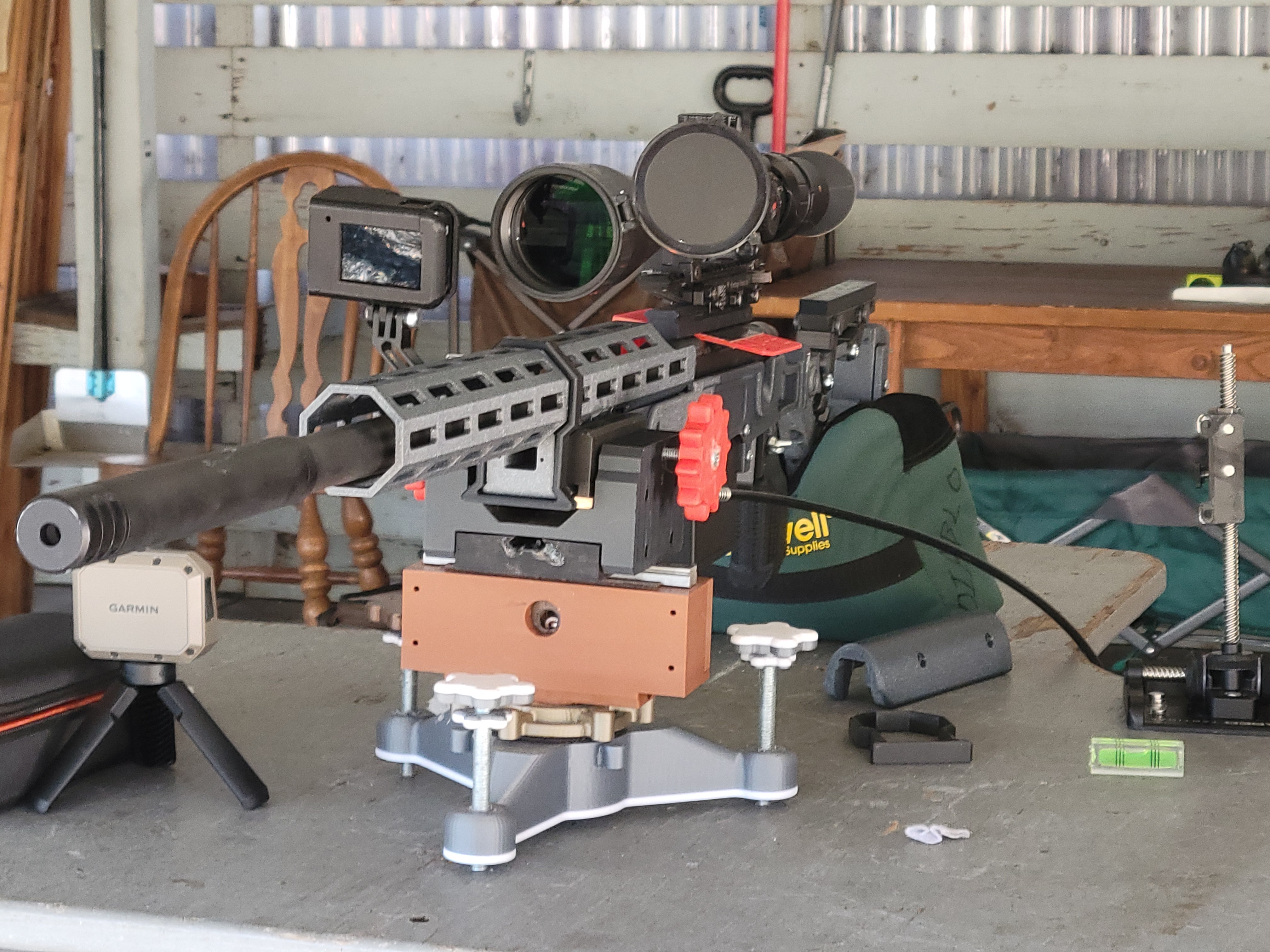

4th 3d printed technical stock for the Altars M24 just completed.
The 4th and final version of the Altars M24. 25 cal 3d printed technical stock is now finished. For now its printed metallic pla pro.
The M24 is dedicated for 200 yard bench rest.

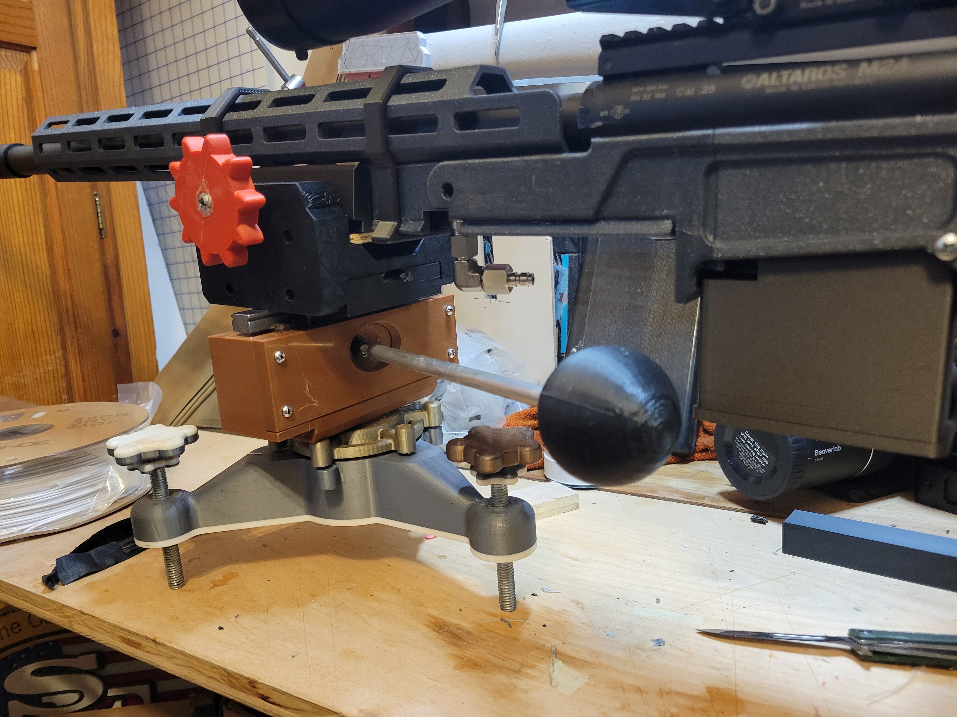

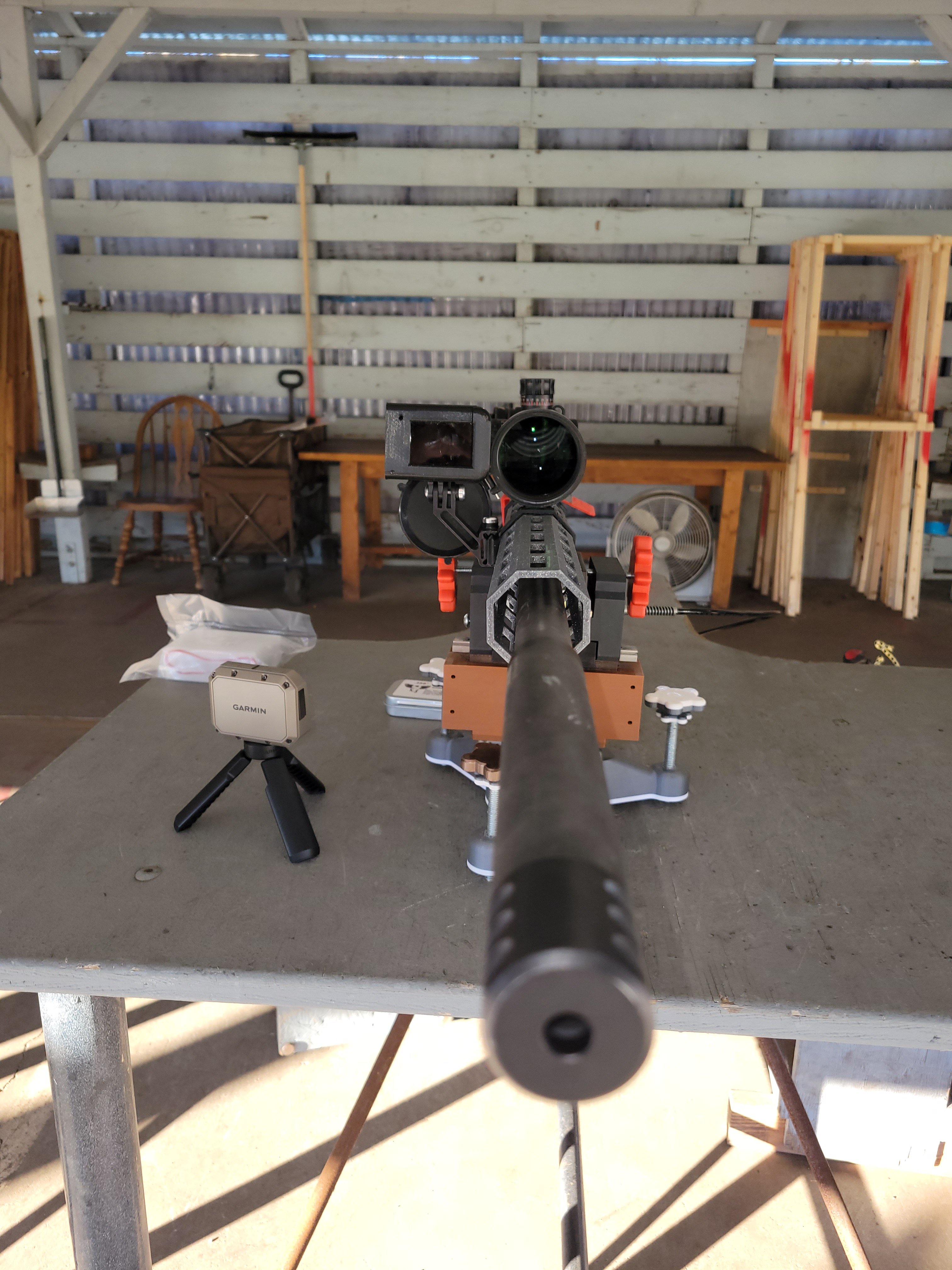

The 3d printed co-axial front rest is working perfectly.
I well report back after I shoot next Wednesday.

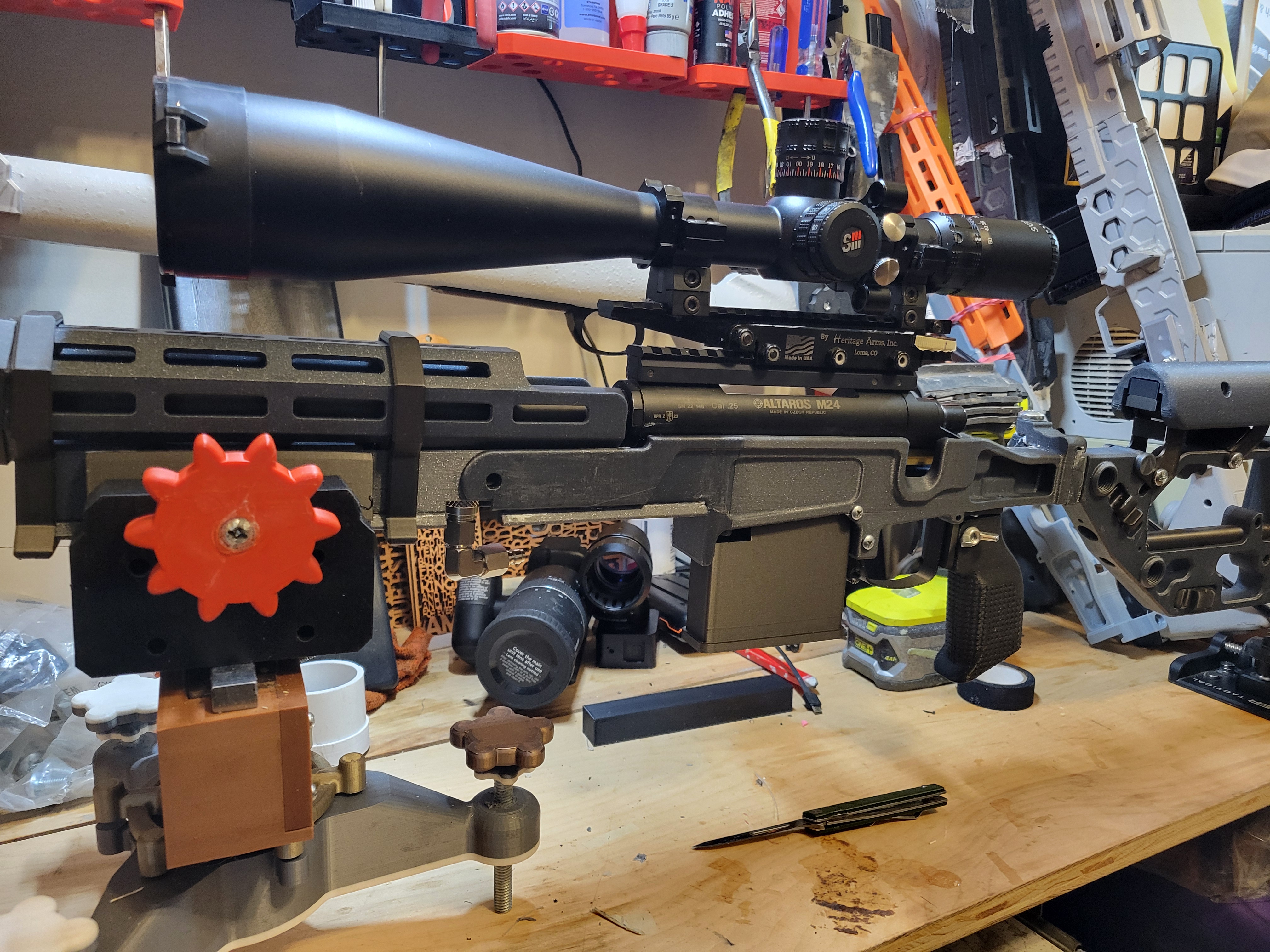

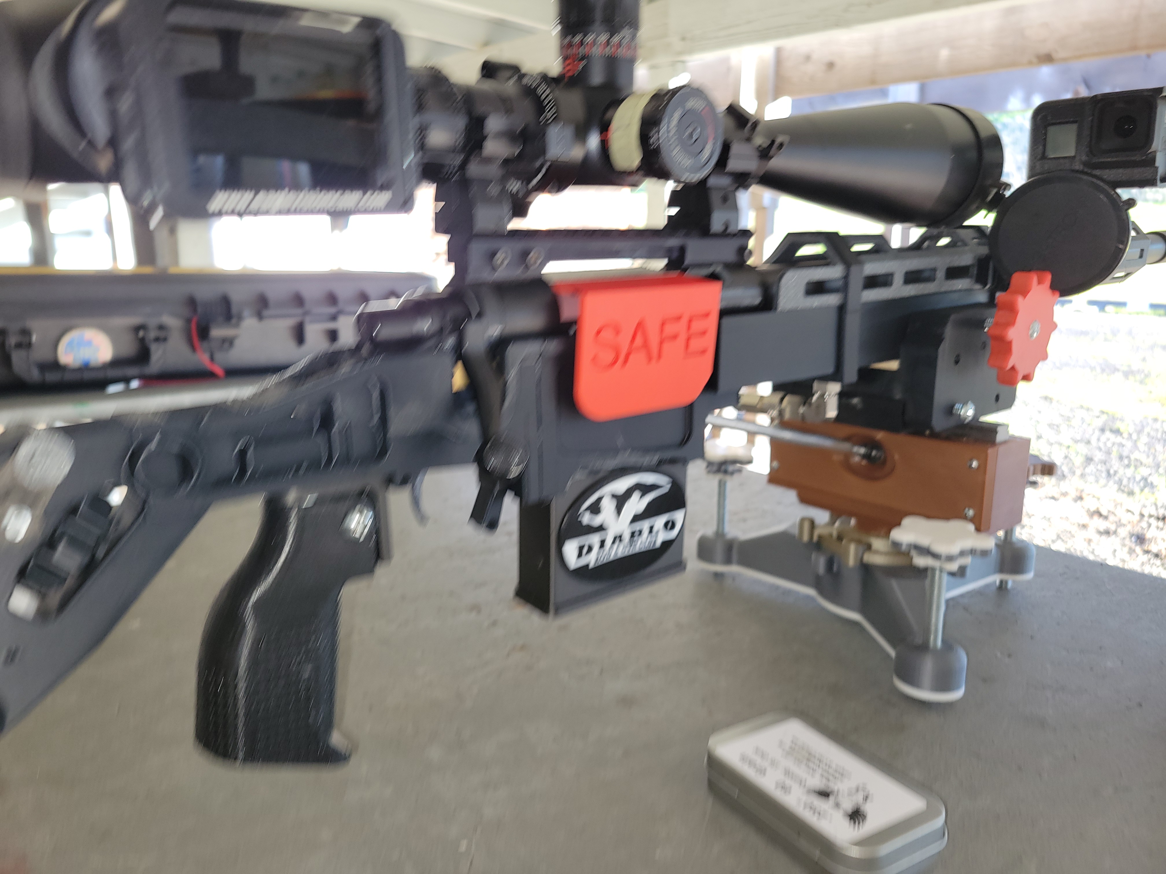

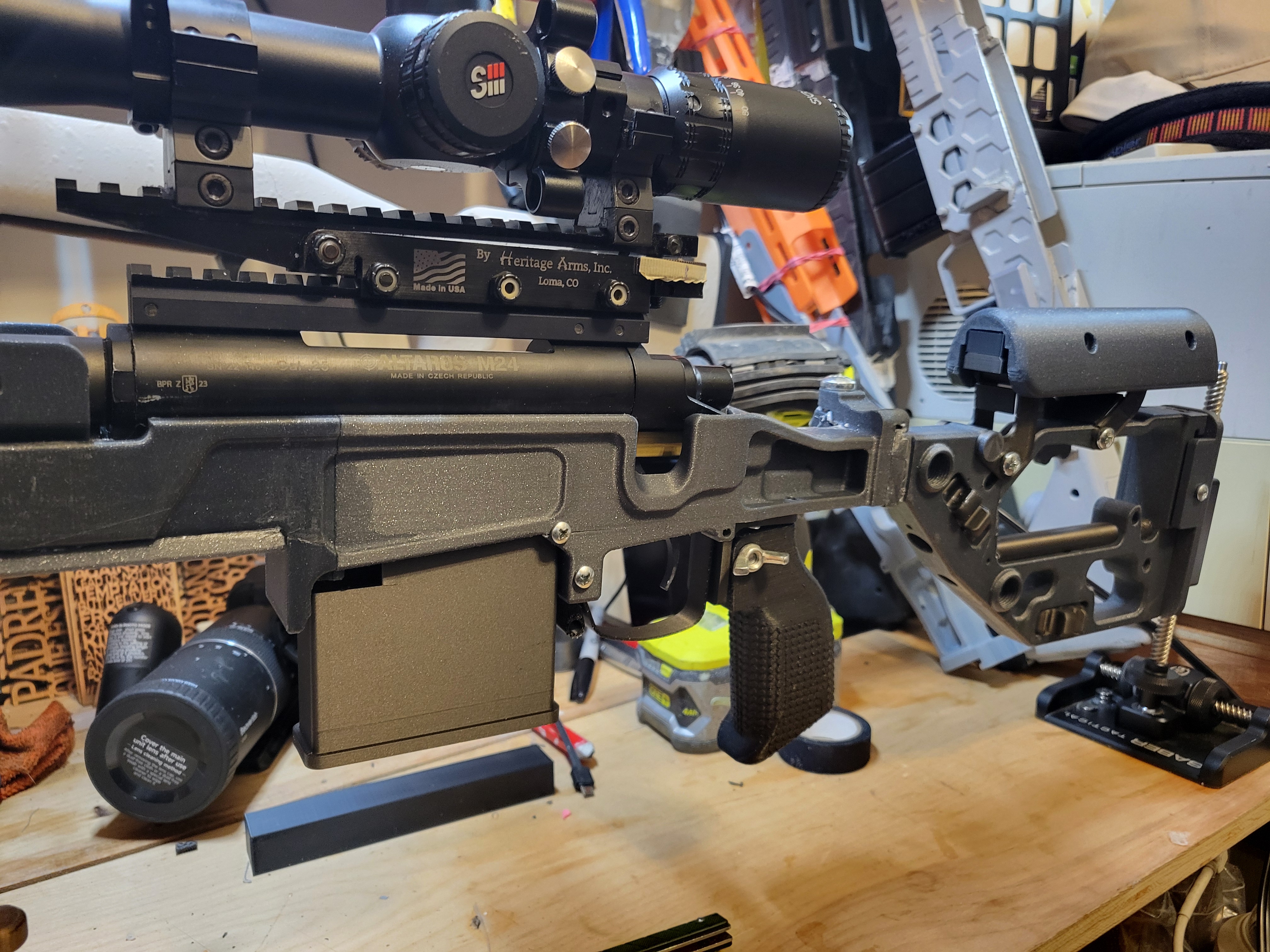

HI Mark, you are correct on all points. I added the dummy magazine so that I can add some lead weights to make the stock heavier. With some additional weights in different places, I'm hoping for around 24 total pounds which improves my benchrest shooting..

If anybody is interested in printing this stock, I downloaded the free CAD files from:
I can also share my Fusion 360 files.

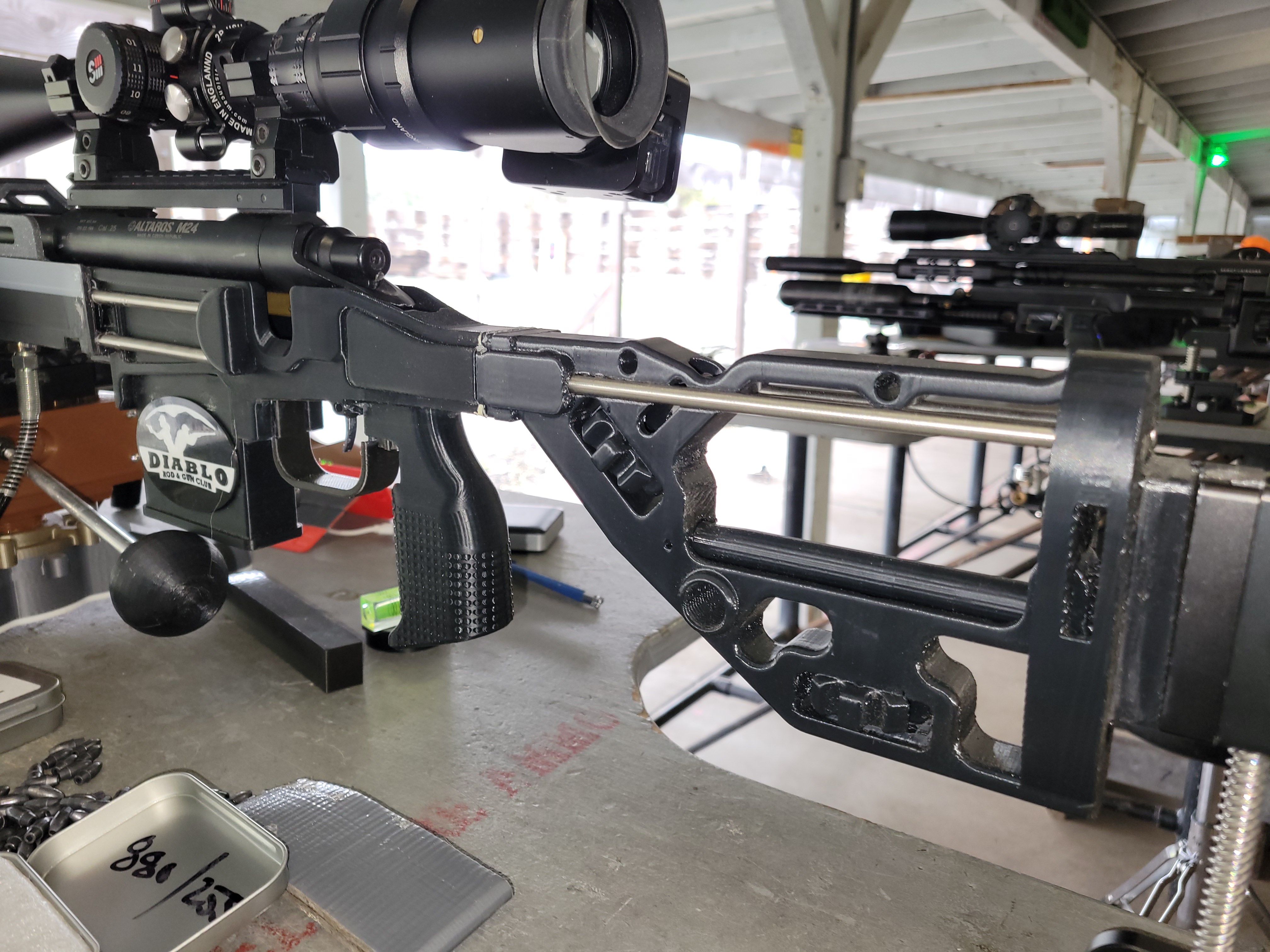

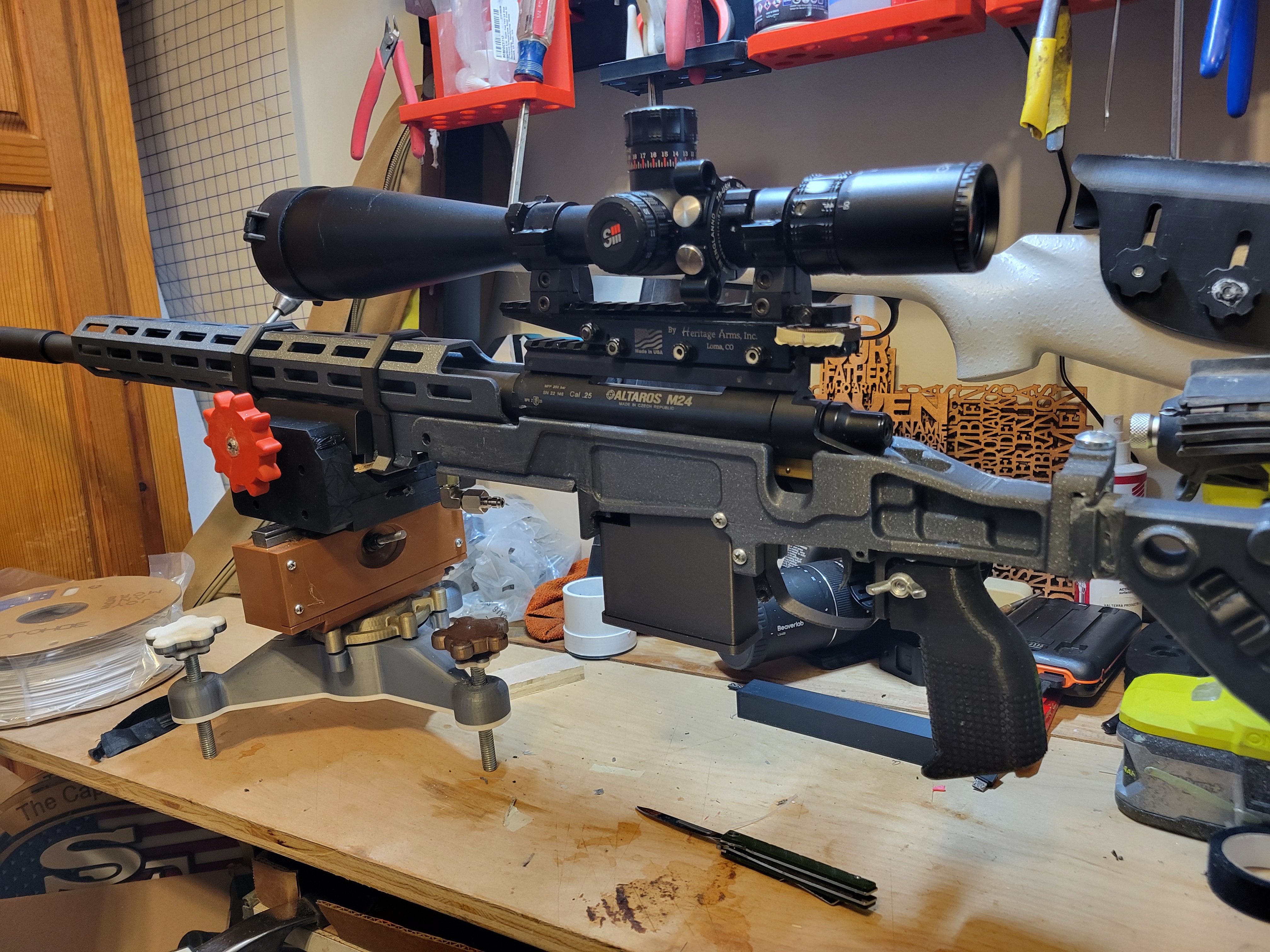

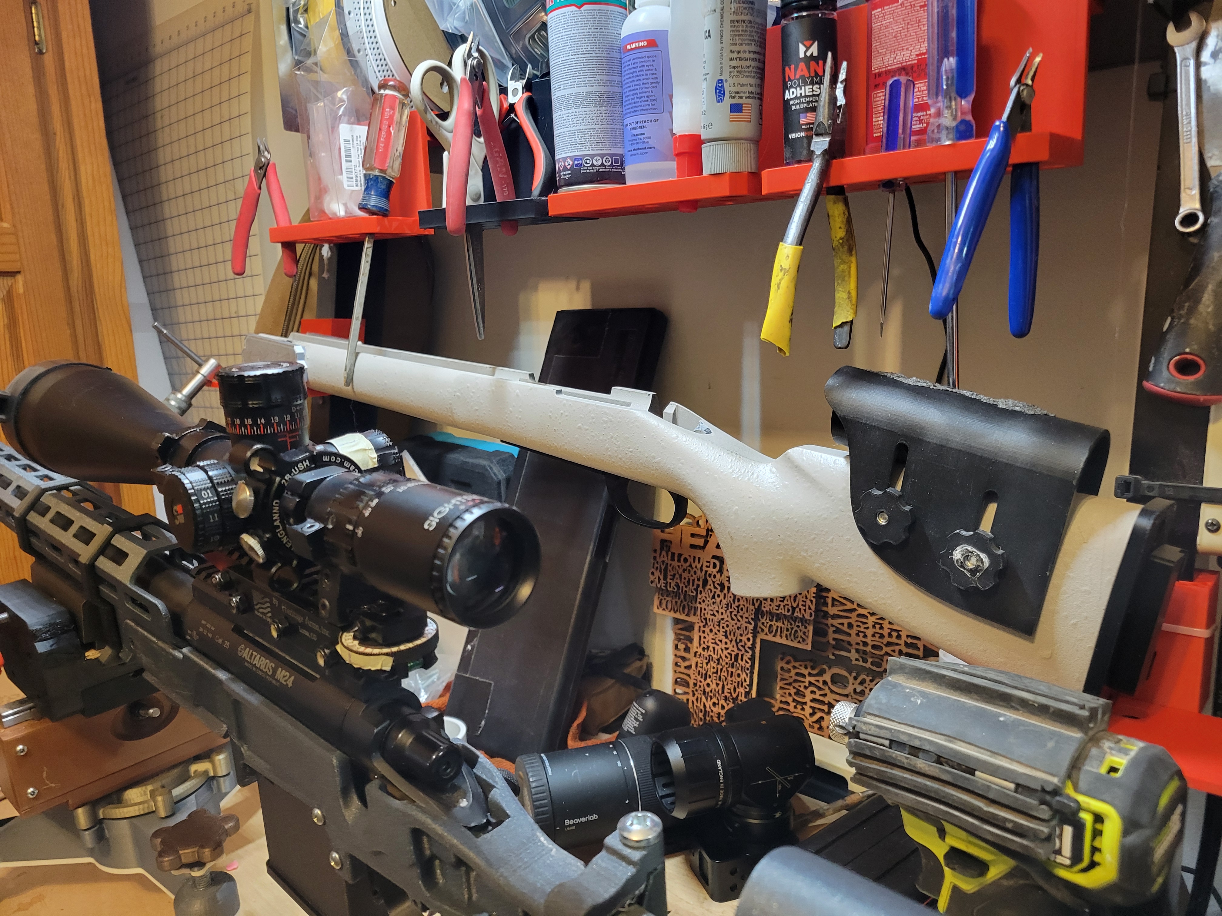

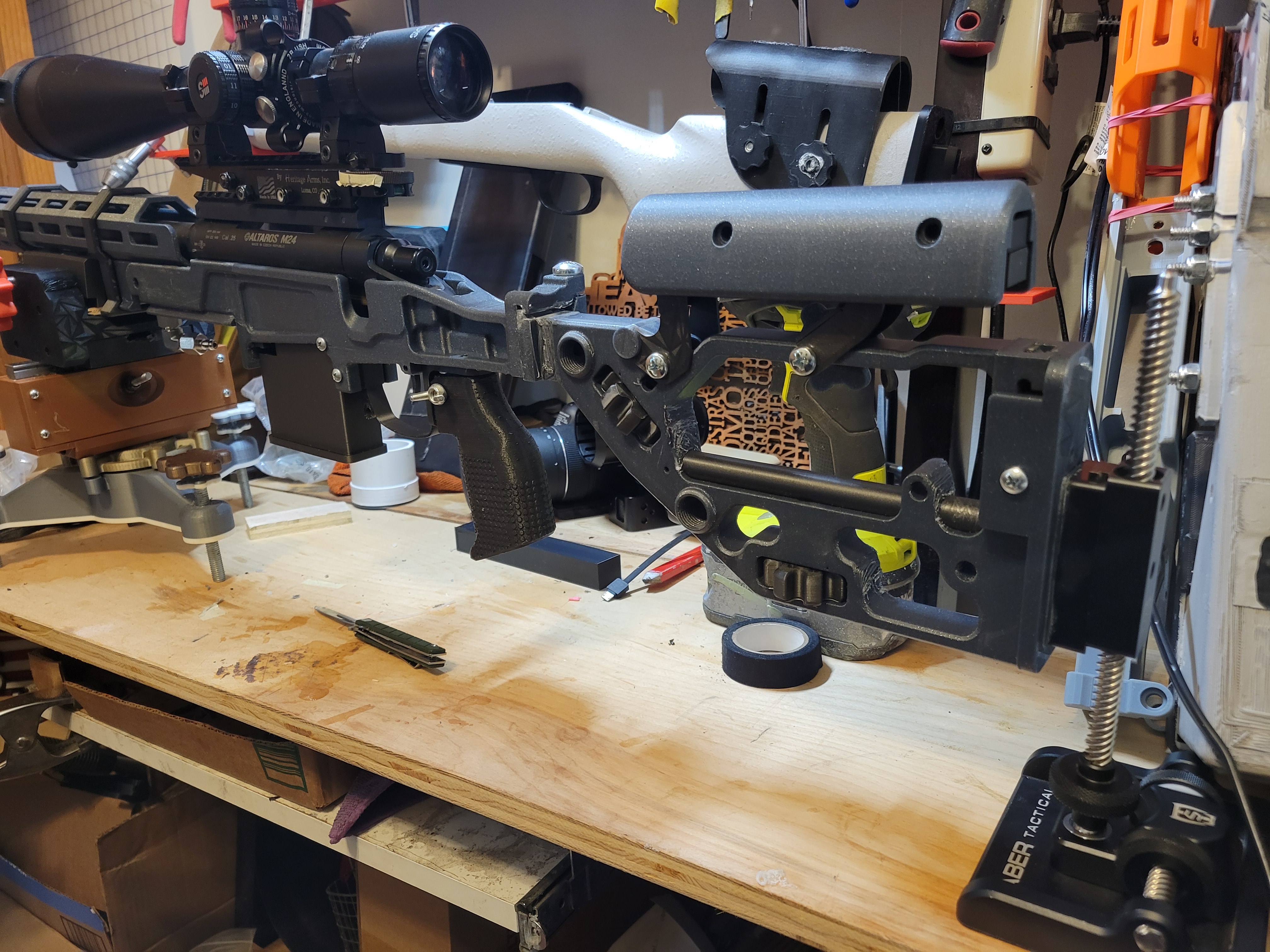

I finally got to the range to work out all the bugs with this new tech stock. I discovered a couple of problems which includes the butt stock being too long for my style of benchrest shooting.
These are simple fixes to made in Fusion 360. I plan to 3d print another tech stock this week. Stay tuned.

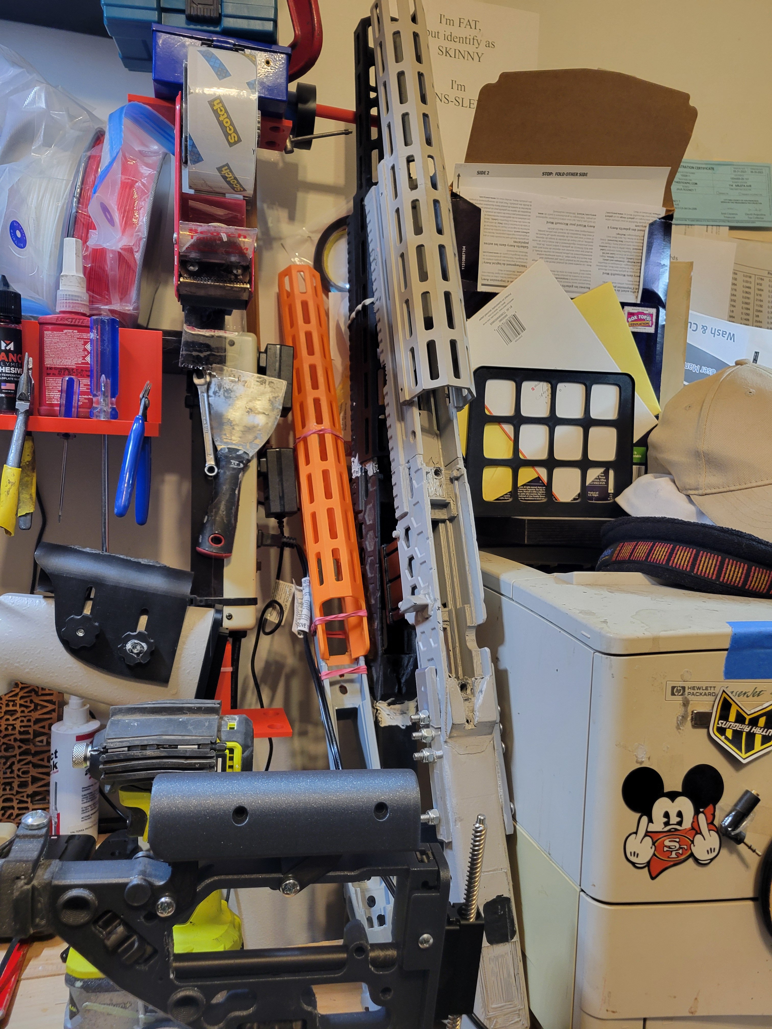

I think I have the final version of my 3d printed technical stock for my Alltaros M24. I added 4 stainless steel rods in the front end of the stock and 2 rods at the butt stock end. Printed with a 50% infill and with the additional support rods, it feels very strong and firm for bench rest shooting. I will eventually print the final version with ASA. My Bambu X1c prints this stock in 3 parts. My new Qidi Plus 4 will print in only 2 pieces.
