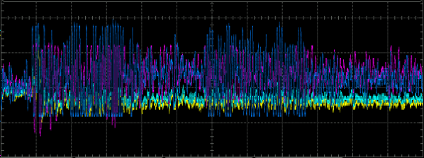

Here is what a typical sound data sampling looks like:
Aside from having exceptional sampling resolution, 250MSa/s that is to say 250000000 samples per second making it able to sample very very brief sound occurrence, it also can provide other interpreted data such as the most prevalent frequency, the overall length and shape of the event, etc. It is very handy, particularly when developing moderators rather than just comparing them. As you can see each sample has a LOT of data in it, multiple channels, the full spicy chalupa. The result is that, rather than a typical sound meter which is sampling one event one time, each value I present below represents multiple simultaneous samplings of each event (a shot), that event is then repeated (five times per configuration, five shots), and it all is recorded. The result is that there is an immense amount of data generated here, and then has to be post-processed, which is all ultimately distilled down into a single average of the multiple samplings of multiple events. Because my calibration is well out of date, rather than then converting to decibels which would be wrong, I just left them as unit-less numbers. This is perfectly fine for the purposes of this comparison, since I doubt anyone else is running a Bruel & Kjaer to produce assuredly accurate numbers anyway. I realize it is all a bit complicated, but hopefully the single value makes it easy and simple. Side note, these aren't powder burners, so there is no first round pop, and because regs are imperfect on the first shot after storage the gun was cycled to “warm it up” prior to testing.

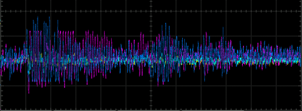

Shroud Collapsed - 728 Pretty much what you'd expect here, or rather if you own a Crown, exactly what you've come to know and love. That predictable loud bark. This is easily the loudest test in this series. And it is quite messy, again as you'd expect, because there really is no damping or anything of the sort. Presumably that pressure wave can ricochet up and down the shroud as many times as it wants puffing out the muzzle bit by bit. I'm guessing, just guessing, that the brake and shroud cap act as one in the collapsed position, so there really is nothing here just a reflective tube at both ends. It is possible that by modifying the action end of the shroud stop some significant gains could be seen here, so it isn't just a big sounding tube. Dampers like this could be designed for dual effect, to both eat barrel vibration (improve accuracy) and sound. This might be worth exploring, along with perhaps venting the rear of the Crown shroud...... or alternately replacing the stock shroud entirely with a lighter weight carbon fiber one that is an integral part of the entire sound dampening and accurizing strategy.

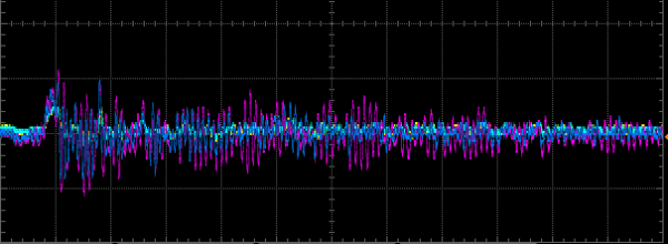

Shroud Extended - 312 Again what you'd expect. It is considerably quieter than the shroud collapsed both because of greater muzzle-forward volume, and it tapers more rapidly because the brake now can act as a choke point between the two chambers as the pressure wave bounces forward and backward. Notice the secondary spike in there. A little napkin math correlates this with the speed of sound traveling the length of the shroud. Cool stuff huh? It is possible, given a longer sampling time, we'd have seen more descending spikes tapering off.

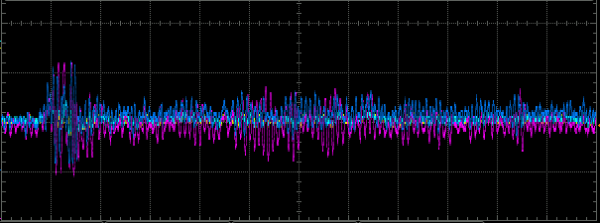

Foam Fill - 204 Now things are getting interesting. This is my attempt at good performance analogue for the all-too-common foam/felt hair curlers and washer baffles design. It is a relatively thin layer of foam constrained toward the outer surface of the suppressor and exposes maximum surface area, more than the Weilrauch's design. The muzzle end uses the same cap design as all the others, and the threaded rear uses the same flow-through design. To the ear, both my friend and I agreed this design could be the quietest of all six tests. It is hard to tell with these things, so we both were eager to see the numbers, but we both bet that this would win.... somewhat to my chagrin. Looking at the pressure wave, it is very obvious how it peaks very strongly and cleanly initially, and tapers off very quickly. This could be thought of as the visual equivalent of a clean sound moderator, pop and done. We'll get back to this, it becomes important later.
