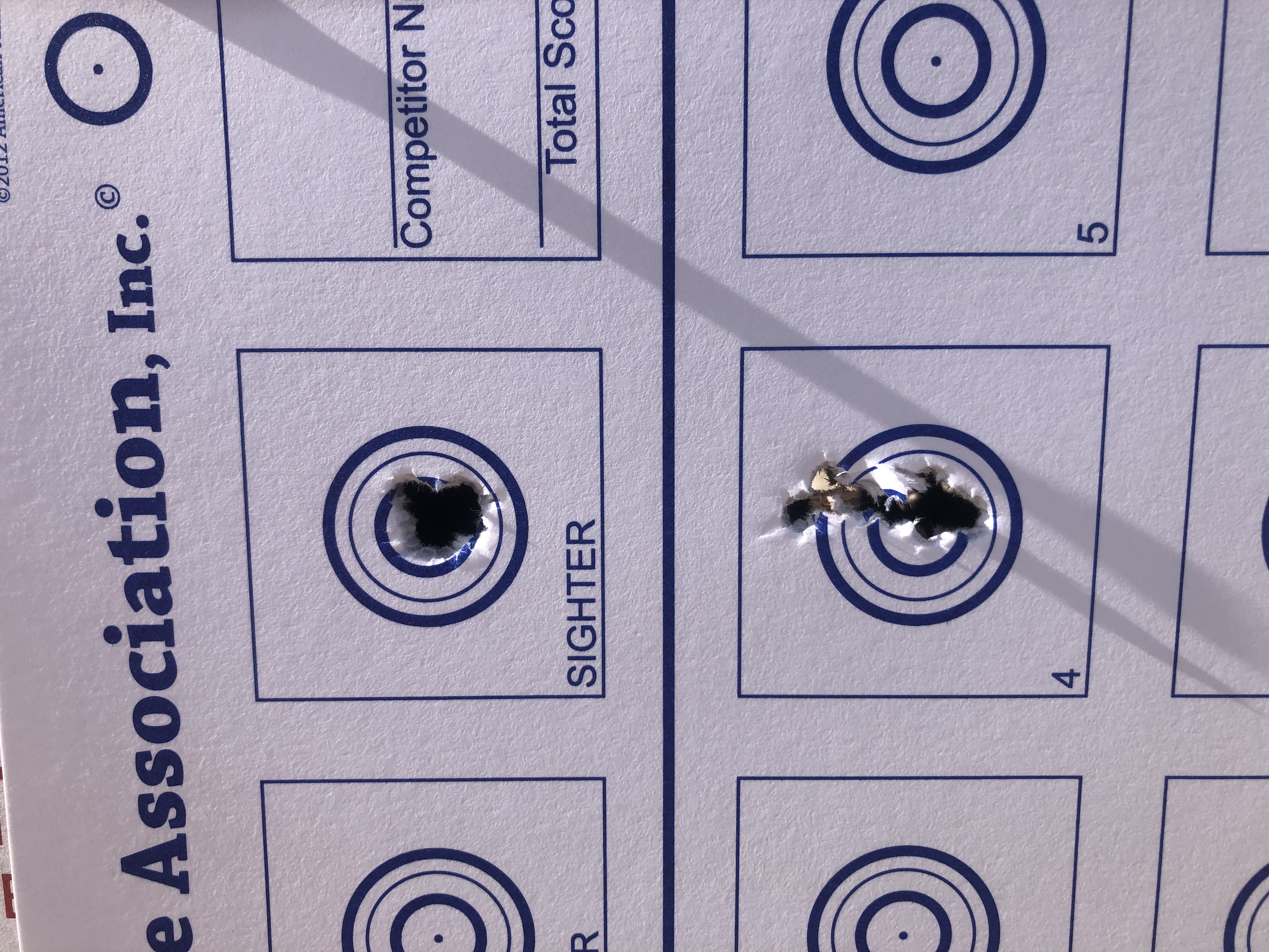

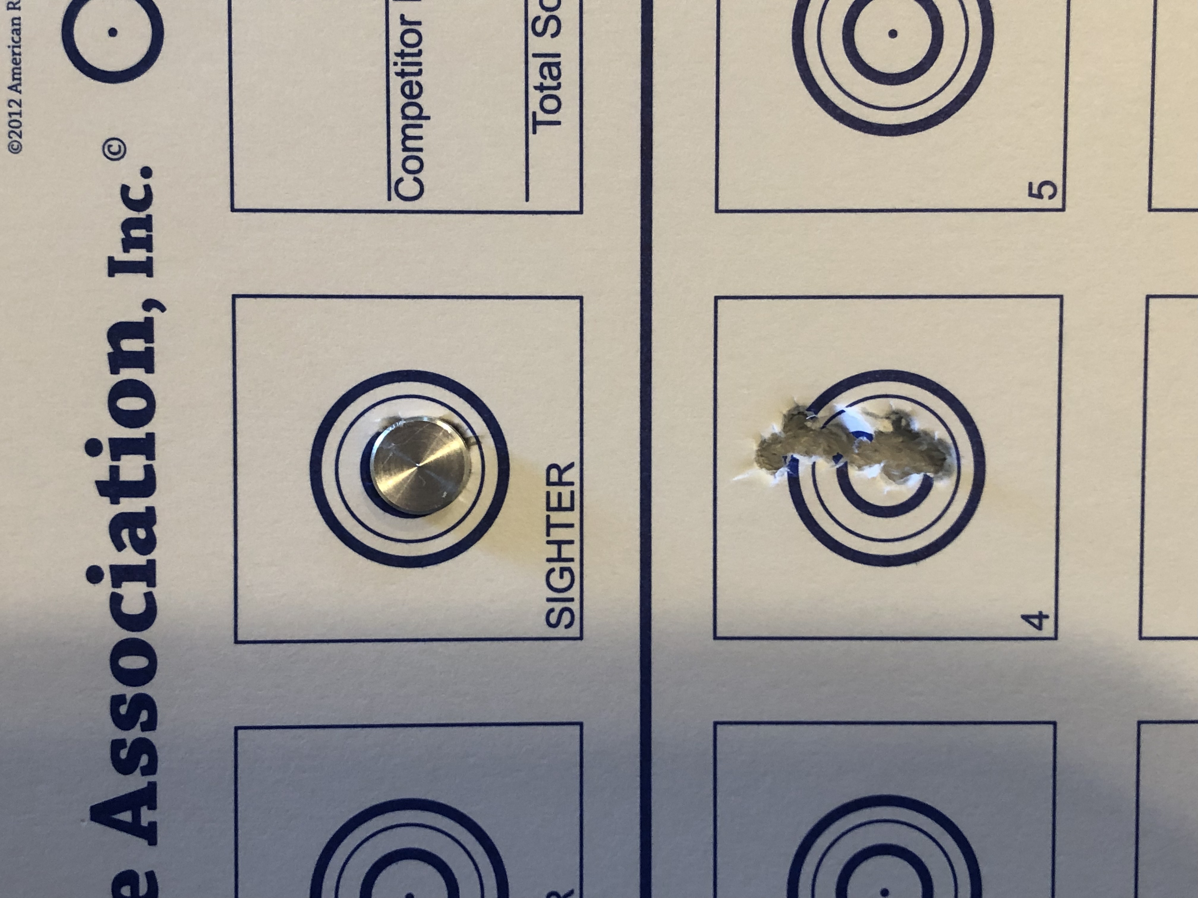

Was weeding through my pellets and rather than throw away a massively beat up tin….I decided to shoot a group with all of them. Probably 75% of the pellets had badly misshapen skirts. Took me about 20 minutes for this 200 shot group at 50y. I think the one all by itself must have been a bad pellet. 😀

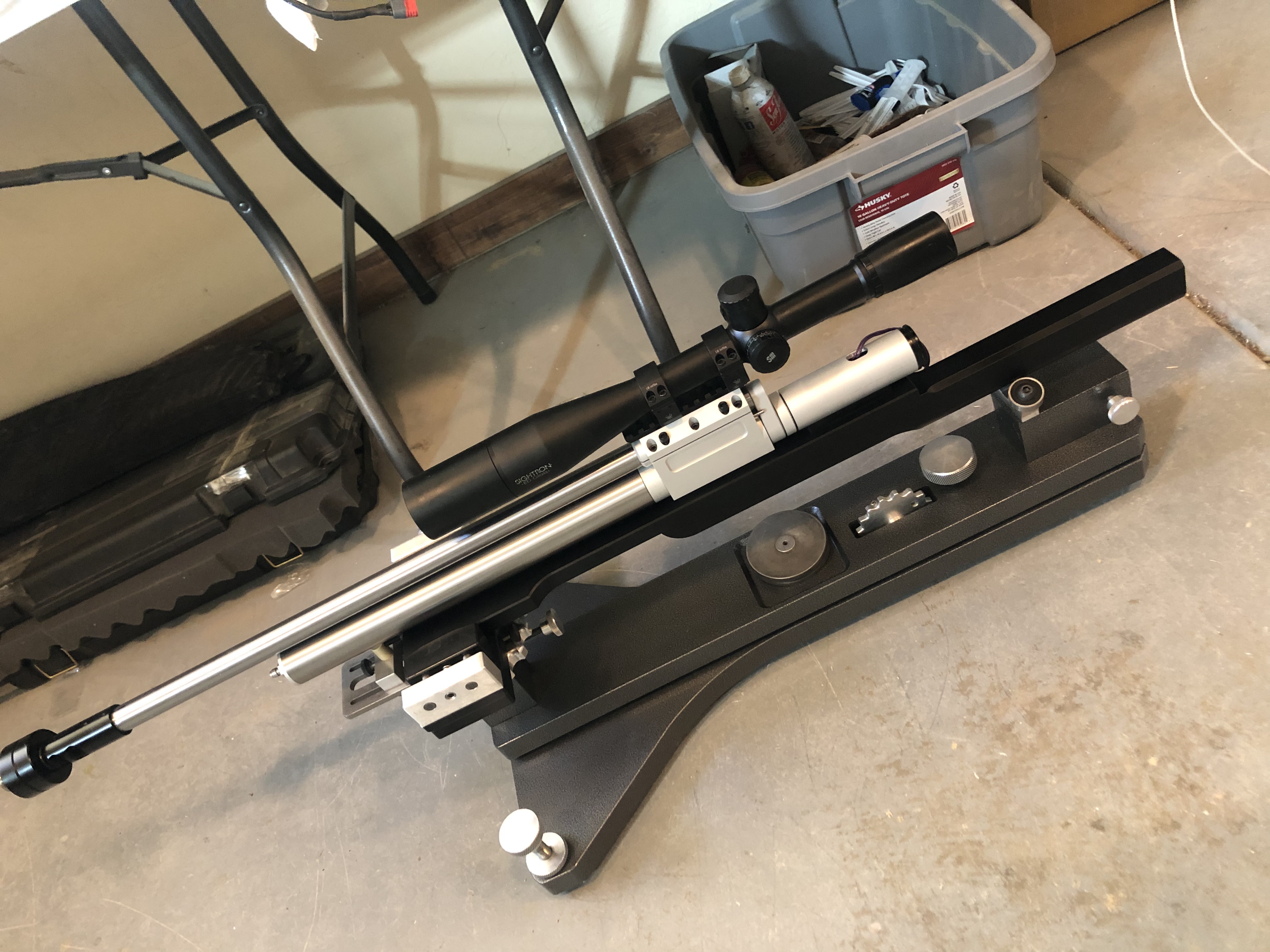

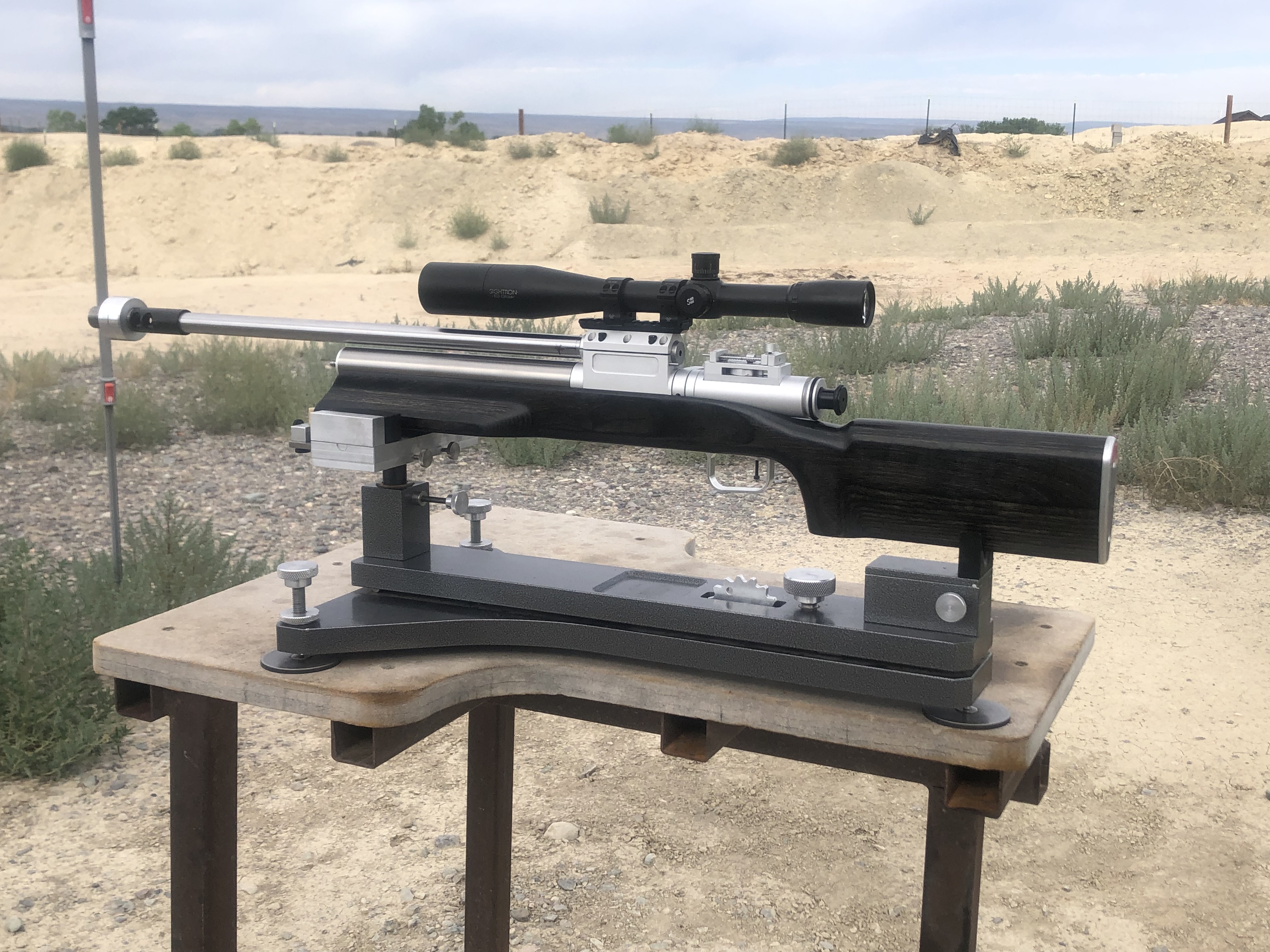

I have a request, could you please tell us in detail how a guy can immobilize a PCP for testing. If memory serves, you use sand bags. Sure would be nice to see a photo of where you place the bags and some details. Perhaps my memory of using bags is incorrect. Please inform us interested guys that want to learn from your expert experience.

Most guns do better if they are allowed to move. I mostly use a one piece rest made by Randolph. I use a ball bearing roller front top, and a ball bearing rear V. The gun is held in the horizontal plane but rolls rearward about an inch before hitting a stop each shot. There is a cleat under the front of the gun that prevents the rifle from rolling off the back of the rest. Clamping a rifle in a “vise” is usually poor for accuracy. Here is a pic of my slug gun on the rest. The pellet gun is essentially the same.
