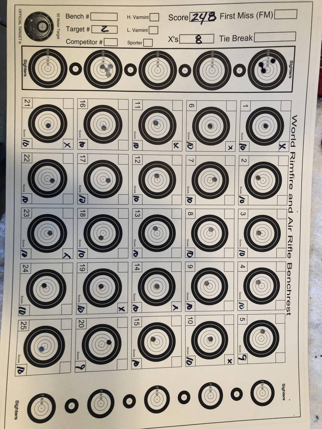

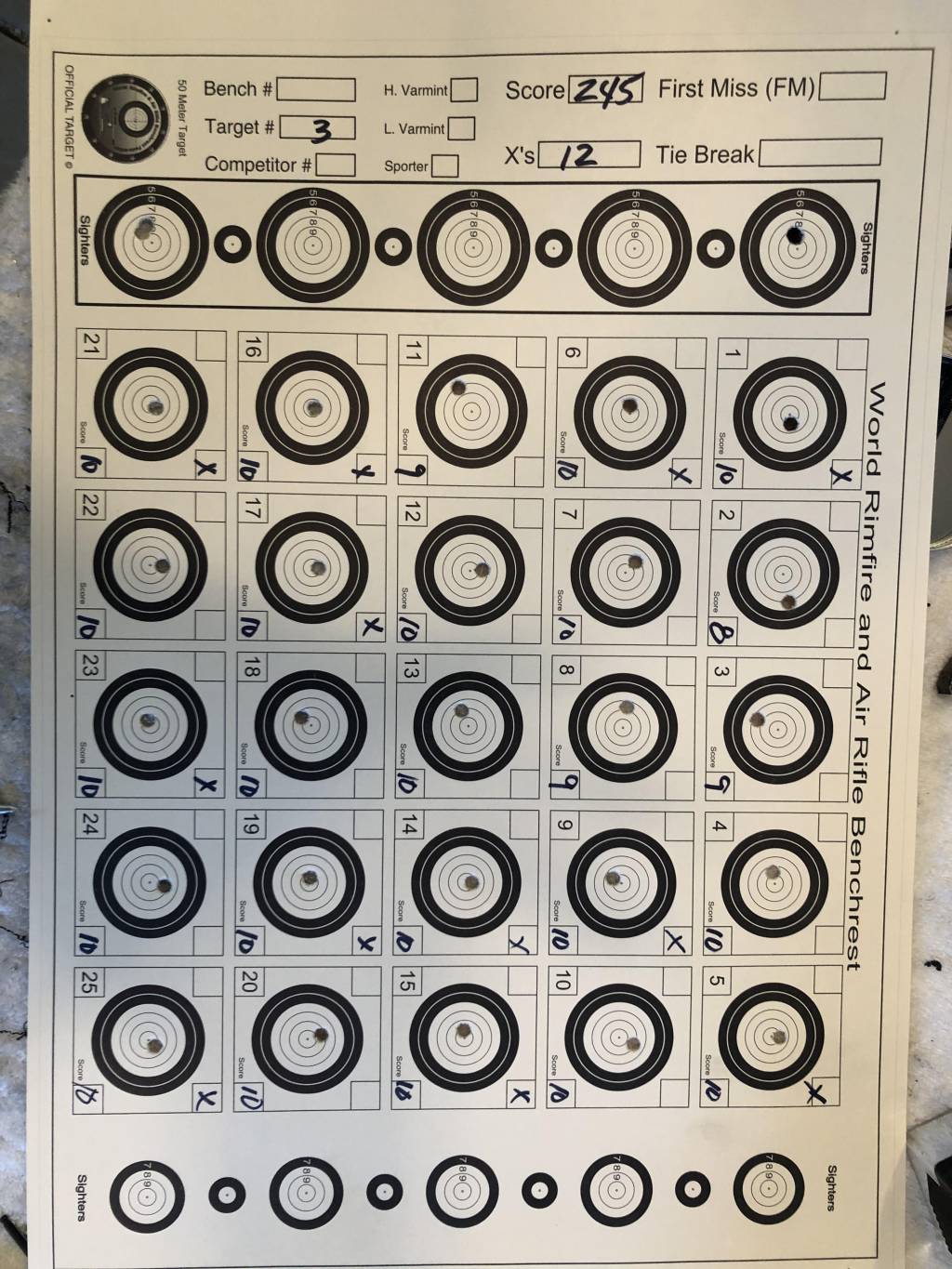

Been working after hours on this for a while. The ultimate goal is to compete head to head with the unlimited Rimfire guns. Not there yet, but really happy with the current results.
Here is 3 cards at 50y shot in horrible conditions with gusts to 15mph.
This is my 40.2 gr 3s ogive boattail slug from a Muller 4 groove MI rimfire barrel.
Hopefuliy it will let me post the video of the conditions. They actually got worse on the last card...but the gun hung in there.
740 29x 😀
Mike
Thanks...this was 850fps. Tried all the way up to 1000....850 is the best for me.
Yes, despite having 8 pins on the target it blew off more than a couple times.
If i shoot a sighter and it goes close to where I thought it should ...I get moving before something changes. 😀
If I get a shot that doesn’t go near where I expect...I’ll take another sighter and see if it does the same thing. I hate wasting a good shot on a sighter. Haha
I was smiling ear to ear shooting these.

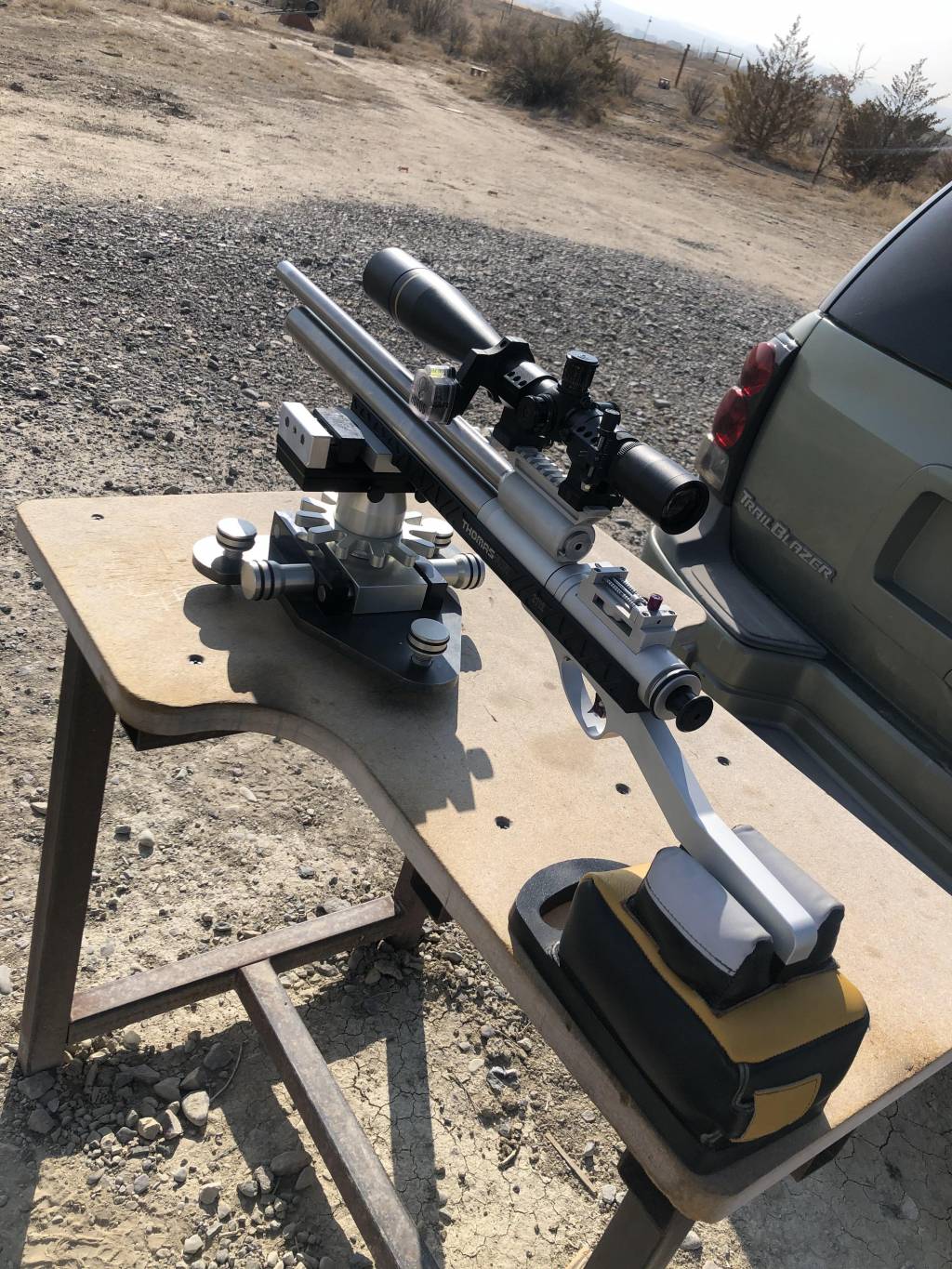

Wow dude that's really great. I could not do that good with my cz 455 American and premium ammo. That's some really good shooting. Very interesting gun you got there. What is it? I saw what barrel was on it but did you make that thing? I've never seen anything like it. I don't shoot competition so forgive my ignorance but that looks like a rail gun on a video game or something lol.
That is a WOW 3 card'r you did there Mike! Congrats on the progress you've made with those slugs! Looks like you are breaking the code of slugs = how well they fit in the chamber, twists, rifling profiles, fps, etc!
BTW I love that thick match barrel, serious heavy metal there! Must of made a special receiver???
My Anschutz 1827F 22rf shot a 10 shot .87" group at 100M in the Lapua test facility and I'm sure I couldn't shoot that high of a score with the same ammo.
Thanks again.
The rifle is about 15lbs with the .900” barrel....and yes it’s a special barrel block.
Joe...I tethered this rifle with no internal reg so I could make easier changes to velocity. I’m only shooting at 2350...so it could just as easily run on the internal reg dual plenum setup.
I’m pushing the slugs slightly into the lands. It does not like any jump.
Mike
I can get 40 shots at this power without tethering....but I think allowing guys to tether can get a lot more participation because you won’t need as much specialized equipment.
Im proposing a simple 3300 psi burst disc block in between the tank and the gun to counter any tethering safety concerns due to accidentally dumping full bottle pressure into a gun not built for it. Would cost less than 20 bucks and would allow a lot more people to get into the game with simple rigs.
Yes, slugs are now legal for USARB unlimited class.
I’m interested in this because the unlimited class rimfire guys are king of the hill at 50y. Going head to head with the top guys and being competitive is a goal for me. I don’t care about long range...because air will never compete with centerfire on any real level, and there isn’t much interest in shooting Rimfire BR at ranges beyond 50y.
