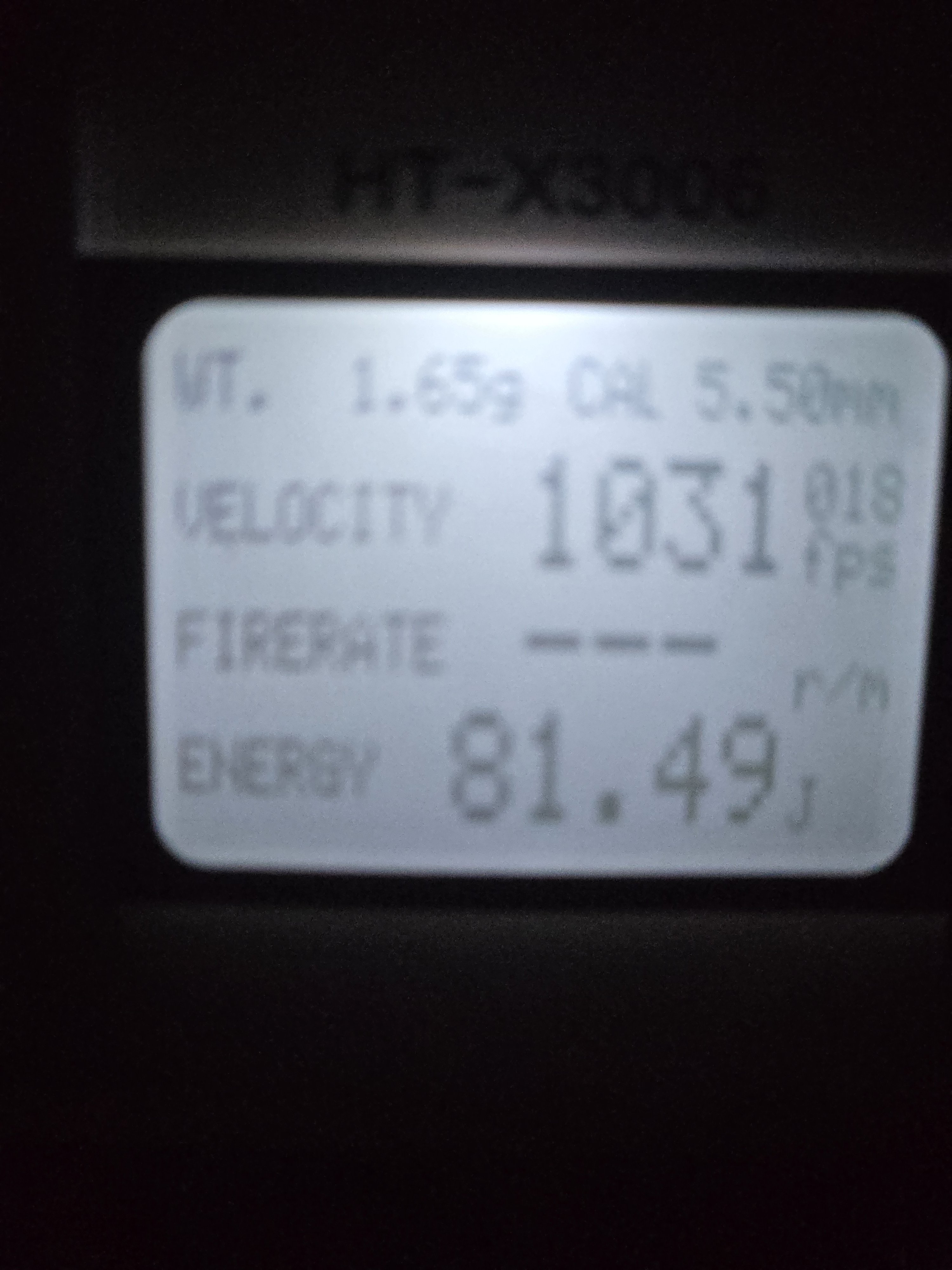

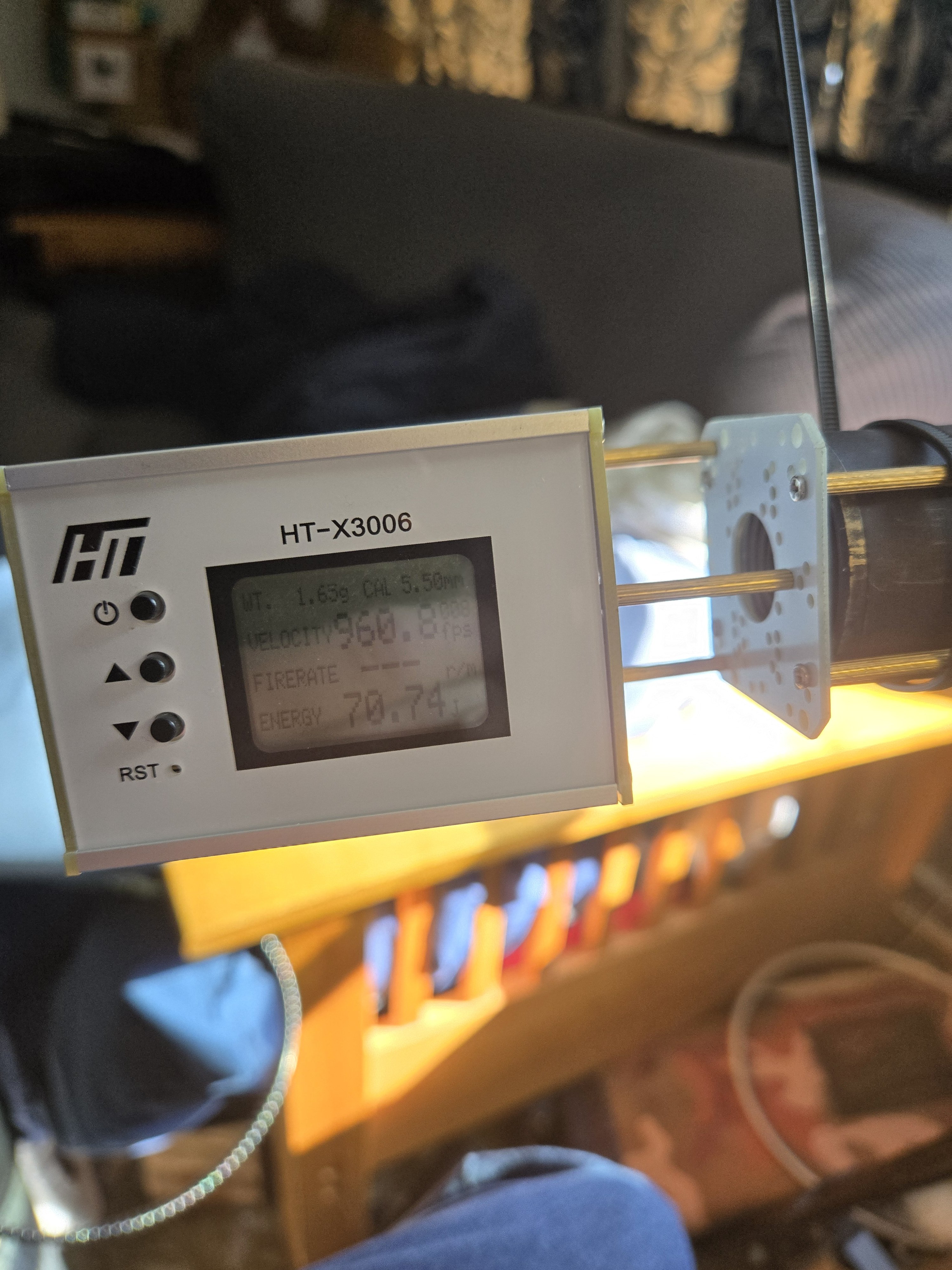

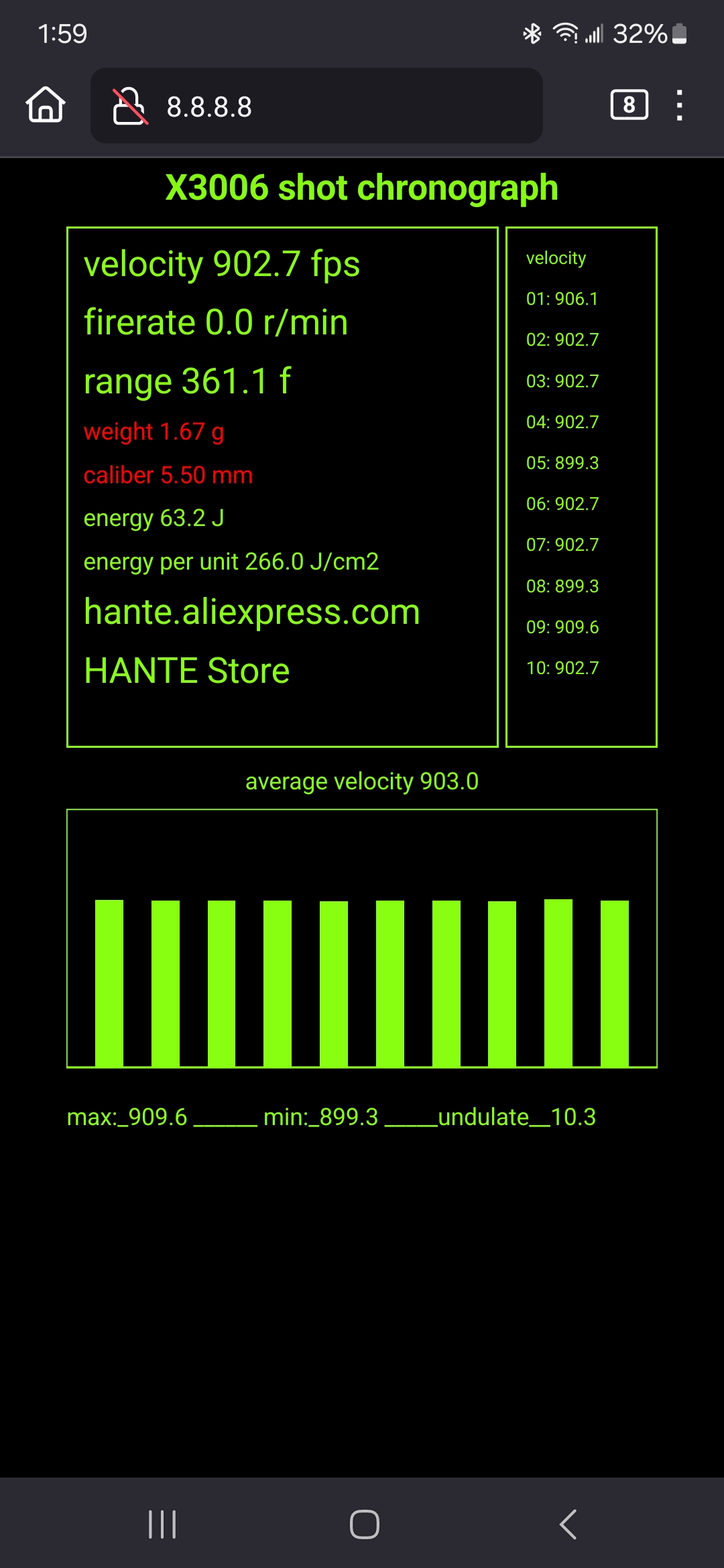

My AirForce Talon SS (sans moderator) is 32 inches. Modified, a bit, 19 inch barrel, 1.1L bottle, Huben Power Cricket drop block regulator, Trajectron 90g hammer and heavy spring.
63J with Apolo Monster 25.4gr. Power wheel at 4, regulator at 2500psi. I'm guessing I could easily get 70+ J just by cranking the power wheel or upping the regulator pressure.

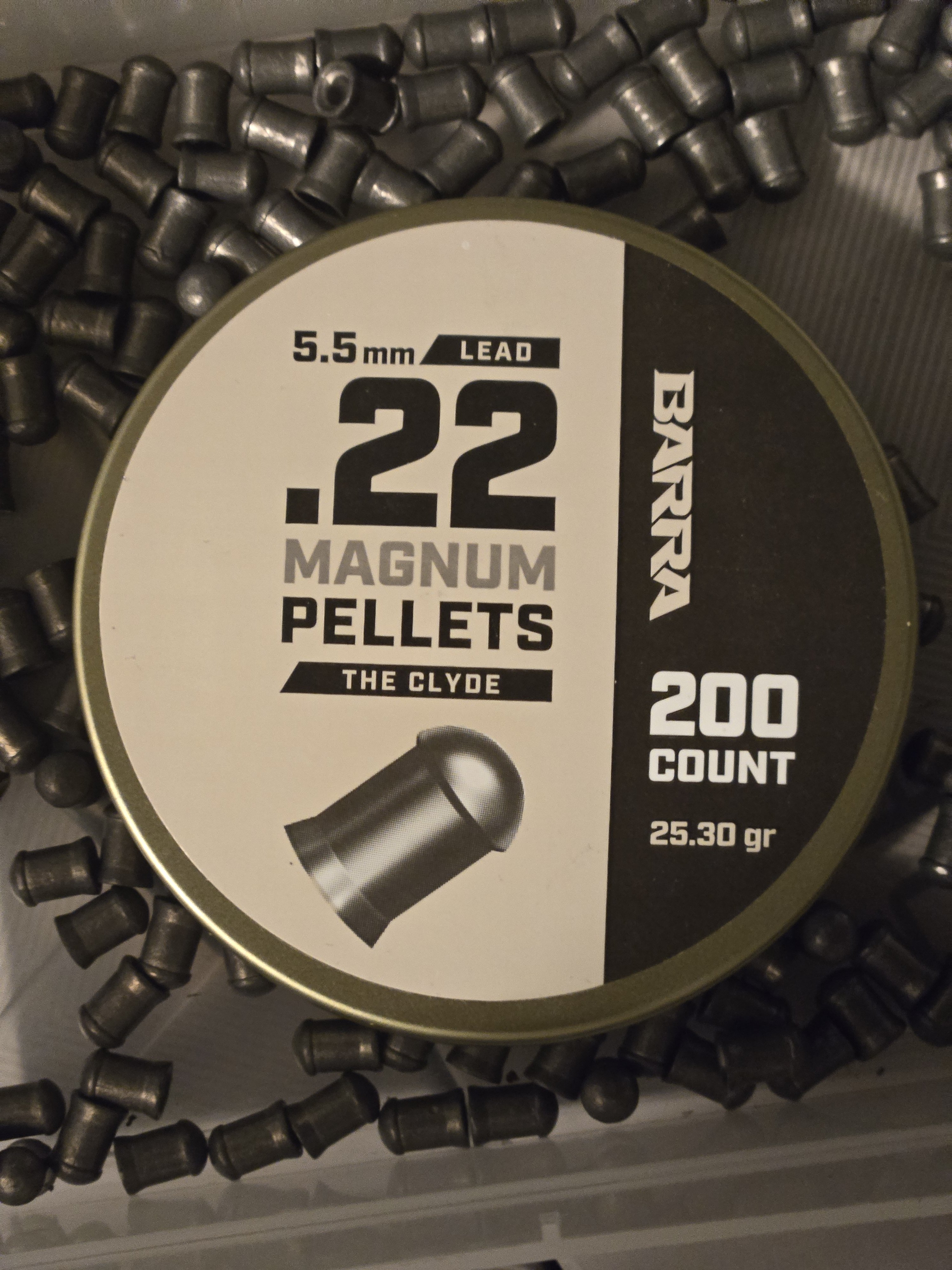

My 600mm Maverick with a 5" mod is 36.5" long and puts out 46.74 fpe at just under 110 bar on the 2nd reg . So a shorter mod would get you close to 34" and wouldn't have a problem with your power requirements either . Mine weighs 6lbs 11oz with a 300cc cf bottle. Its 31.5" long without a mod . It didn't come with a good tune from the factory but with your power requirements it would need to be tuned anyways. My only modification was a heavier hammer weight and is needed for getting 25.3 gr pellets up to speed .
