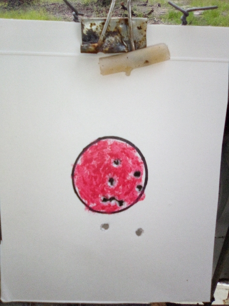

Shot at home at 20 yards with the FWB 124D and got cloverleaf groups with several pellets. Tried the best shooting pellets from home at the gun range at 55 yards (max range for gunslyger) with non windy conditions and got 5 out 20 hits on a 8" paper plate. I shot over a sand bag close to the trigger guard with a sock over it and tried to duplicate what I did at home. I did notice after the shot that the barrel swung to the right. Do not member that much movement at home. I heard you need to keep the guns steady on target till the shot cycle is over. Any advice what I am doing wrong? I think I am going to pretend I am blind with a crippled right hand when I compete in the Gunslynger competition at the Pyramid Cup.

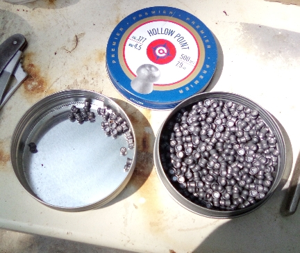

Try some cphp.. do fine for me. 😉
Thats kinda drastic spread from 20 to 50y .. them cheap sad daisy pointed i get a 7" flyers , but ...
Shooting stock irons @50y. Cphp.177

Shooting premiers, JSB exacts, H&N silver jets and H&N FT 4.51, 5 shot each at a different circle on the plate. Could not check each group as a guy with a firearm would not take a break. Maybe it was just one of them that hit all 5 but doubt it. I will try again at different ranges and use a splatter target so I can see the hits. . I did check the screws. I did not shoot closer ranges that day so that would have helped. I think it must be my hold but maybe my sand bag/sock arrangement was different. Not doing the GunSlynger competion so I got more time till 2024 cup. Thanks for the replies.

Just chrono the gun...hmmm cheap Chinese chrono...(sorry m/s only, 8.64 grain H&N) 227.1, 227.1, 223.7, 226.3, 225.5, 230.2, 225, 224.2, 227.2, 223.7, 224.7. Extreme spread = 6.5 m/s = 21.35 ft/s...hmm SD = 1.9...not really sure what all these mean...sure hate to see extreme spread at 21.35 ft/s coupled with POI shifts (could be shooter error...or other things). very unusual to see such a hight extreme spread with a Tony Leach set up...unless it was high outside temp...(I need an infra red thermometer).
Should have checked all the screws first...will update next time. (conclusion...probably not done tracking down the culprits yet...most likely shooter error)
Edit 2
Checked the screws. All tight/snug.
Swap out the scope. Sighted-in another scope and the POI shifts disappeared. Problem solved? We'll see... more shooting tomorrow.
You might just be right in post #11...We'll shoot some more and see if the POI shifts returns.
