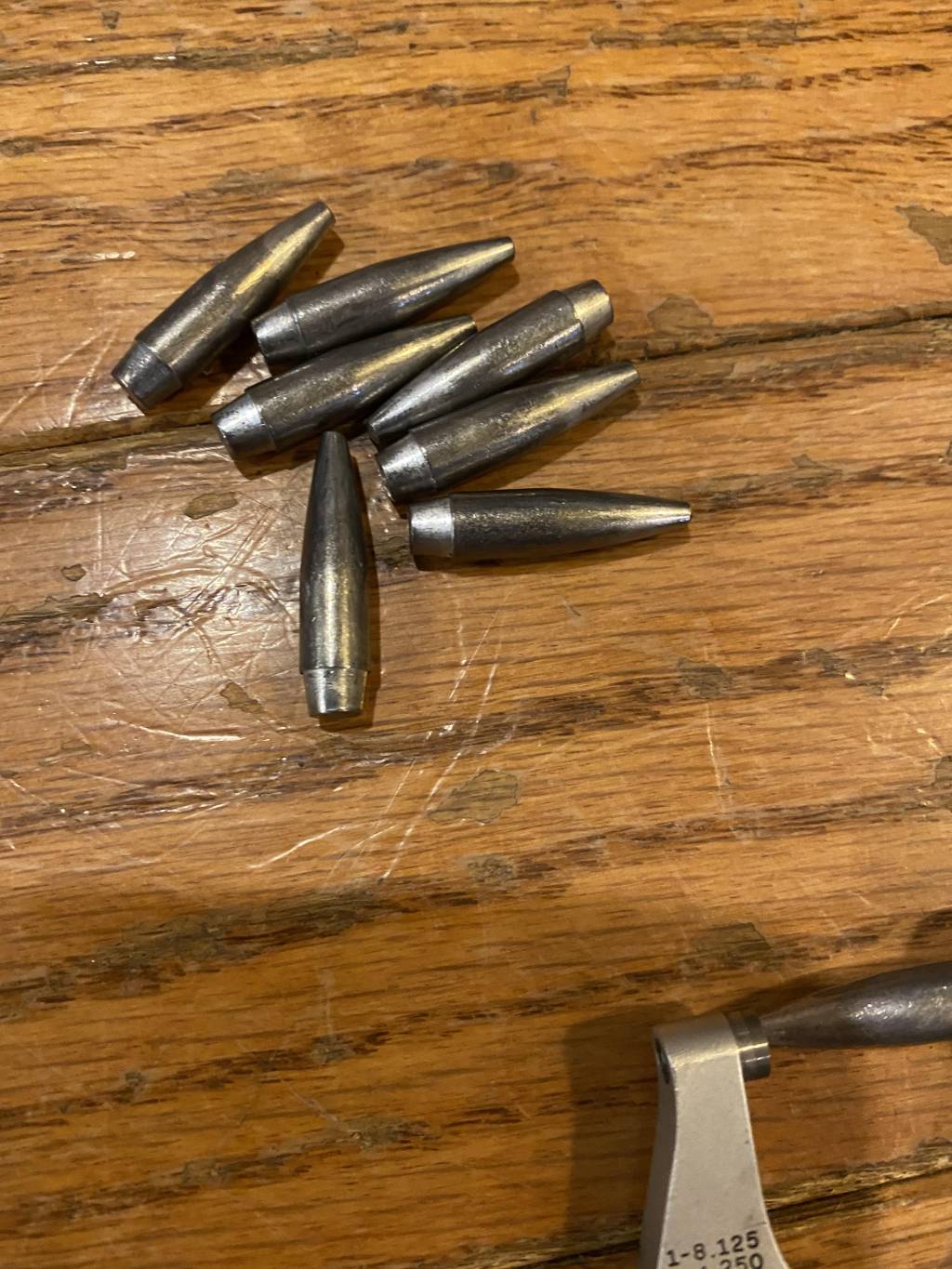

58-115 grain RBT slugs to try out from something interesting.
72's are .614" OAL .2573" not lubed yet but I see that I probably will from fast leading up. 1095fps. 32" 0.880" Lilja Bull 1:10

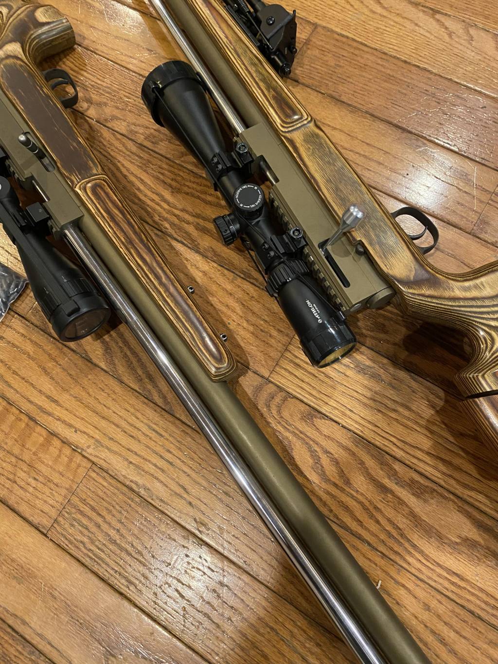

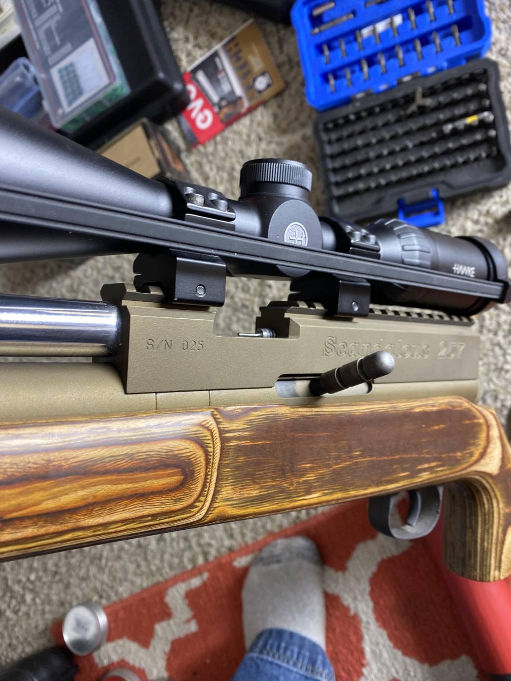

Two .257 Scandalous rifles from Santa.

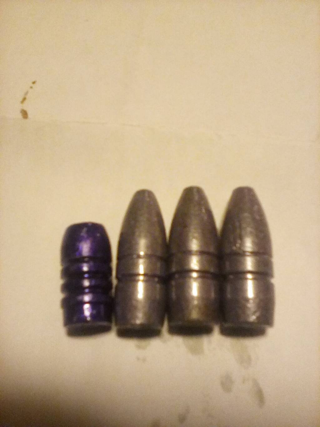

 These are my .510 650 grain spire point boat tail. They are 1.375 inchs long. I have only shot to 300 yards but a b.c of .5 is getting me on target. For comparison is a .510 475 grain massive hollow point has a b.c of .250. They both shoot well outta my Texan. Noe and accurate molds. You should give powder coating your slugs a try. 750 fps with 650 grain in stock Texan tx2 valve. I saw some accurate molds for a 7mm 190 grain boat tail that might be a start for a long ranger air gun😀 The limit is length accurate molds maximum length is 1.375 inch long for.cast bullets length. I think the lee design .308 230 grain spire PT boat tail is a b.c of .6 something. So for now a lee .308 230 grain is the ballistic king for cast ammo in airguns.
