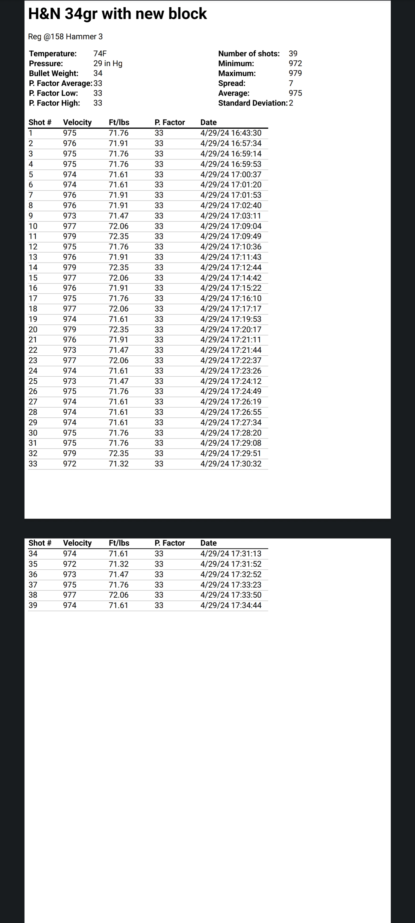

Not setting any records here, but it has potential. I definitely pulled a few along with the winds. 50 yards. I refilled at shot #9. All 5 shot groups, except the center target. Was on the reg there.
View attachment 4-29-24 H&N 34gr.PDF
