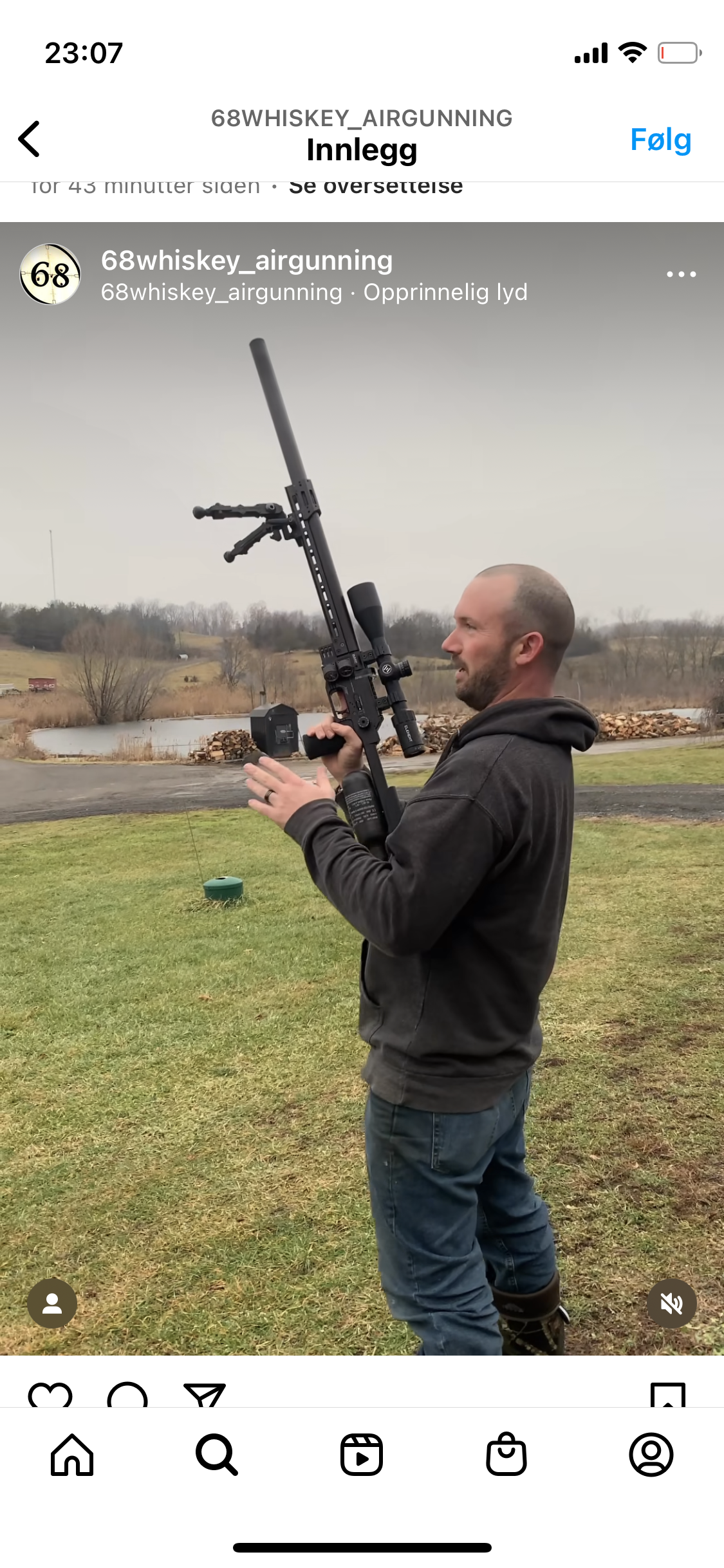

Did anyone see the short video done by 68 Whiskey where Keith shoots a .25 caliber FX Panthera (700mm?) off hand at 300 yards and hits a steel plate (unknown size)? He says 41 grain ZAN at 960 fps, then says his gun gets "12 to 16 shots" per fill... I know I saw it, but it seems to have been taken down not too long after posting. Perhaps the honest shot count didn't show the Panthera in a good light? Things that make you go hmmm.... :unsure:
It’s on Instagram.

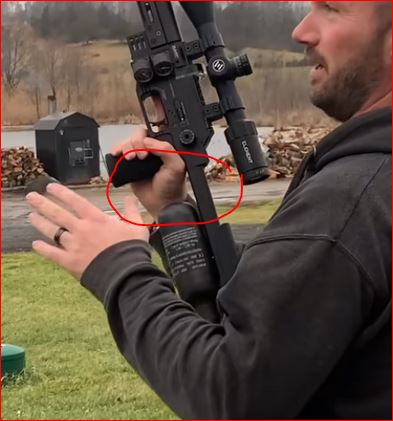

Looking at that distance between the grip and the bottle, it is a same situation as with L2 if you want to mount a larger bottle. But Edgun came up with a solution and selling different length "extensions" whixh are actually the extension of a air volume before the Reg.
Maybe FX .... ? will somewhere in the future extend that bar on the stock? Maybe rebuild the stock connector to allow a 1-2" longer=larger bottle ???
I think the LOP is already too long for many shooters as is. Adding length would allow more room for a bigger bottle, but would not be good for fitment. I think FX could have ditched the adjustable butt pad, and trimmed down the actual "pad" and made more room for more air. Seems like a ~400cc bottle at 300Bar would have been a good move imo.
