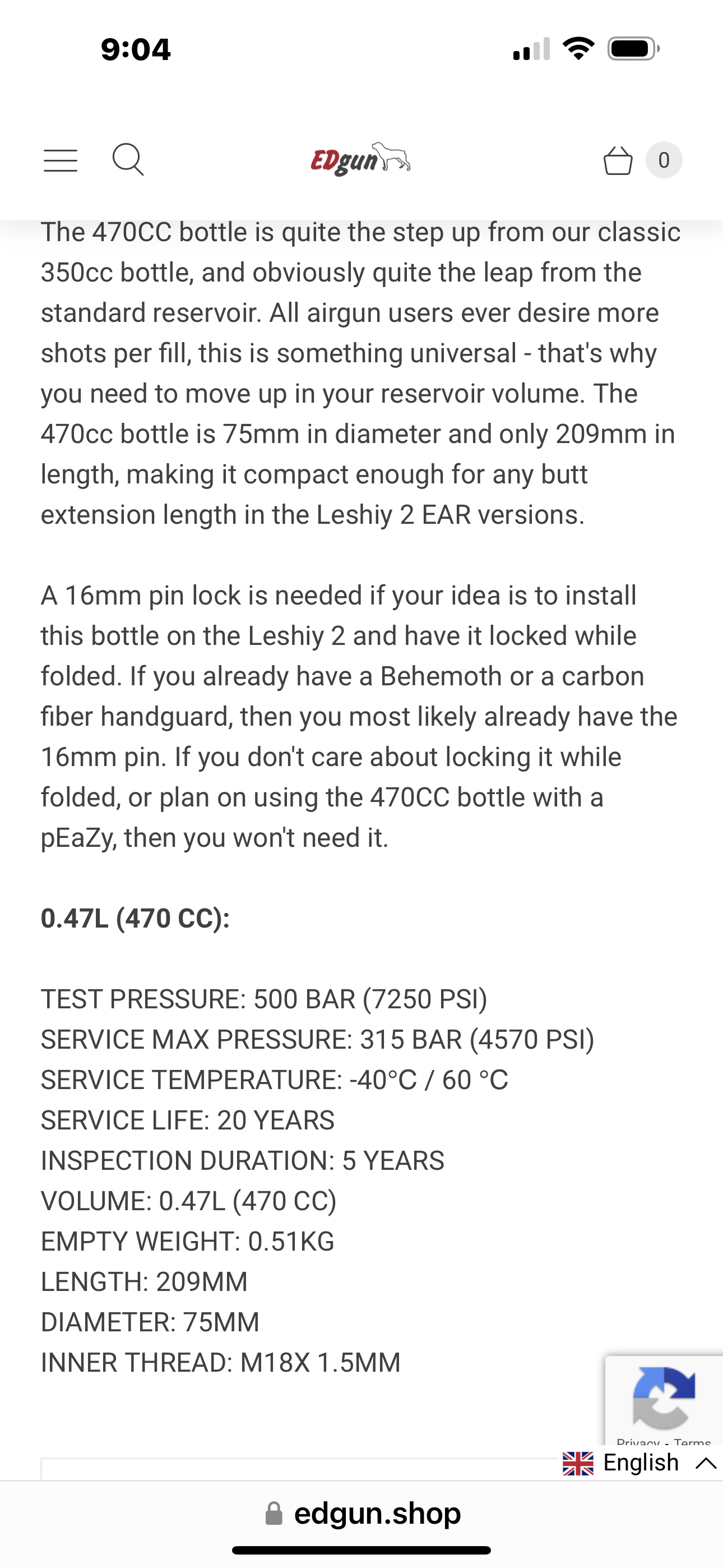

Have you seen the new 470cc 300bar bottle that is out for the Leshiy2? It should fit just fine on the Panthera since it was made for all butt lengths of the L2.
I have a L2 and thinking of getting the bottle and using it on the Panthera; would increase shot count significantly for those worried about not having enough air on board. I’ve seen the guys from Utah using a 300bar bottle and before anyone says it I know just because you can doesn’t mean you should. Just looking at additional possibilities for extended shot strings.

Looking at that distance between the grip and the bottle, it is a same situation as with L2 if you want to mount a larger bottle. But Edgun came up with a solution and selling different length "extensions" whixh are actually the extension of a air volume before the Reg.
Maybe FX .... ? will somewhere in the future extend that bar on the stock? Maybe rebuild the stock connector to allow a 1-2" longer=larger bottle ???
